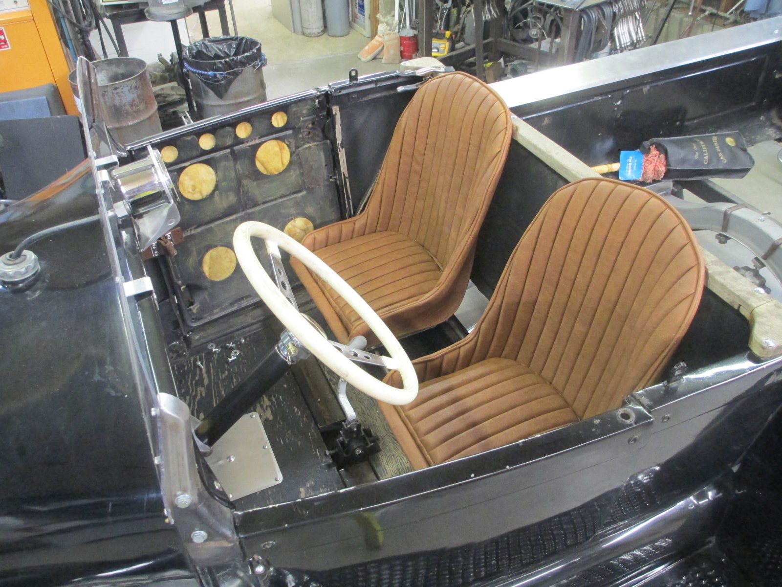

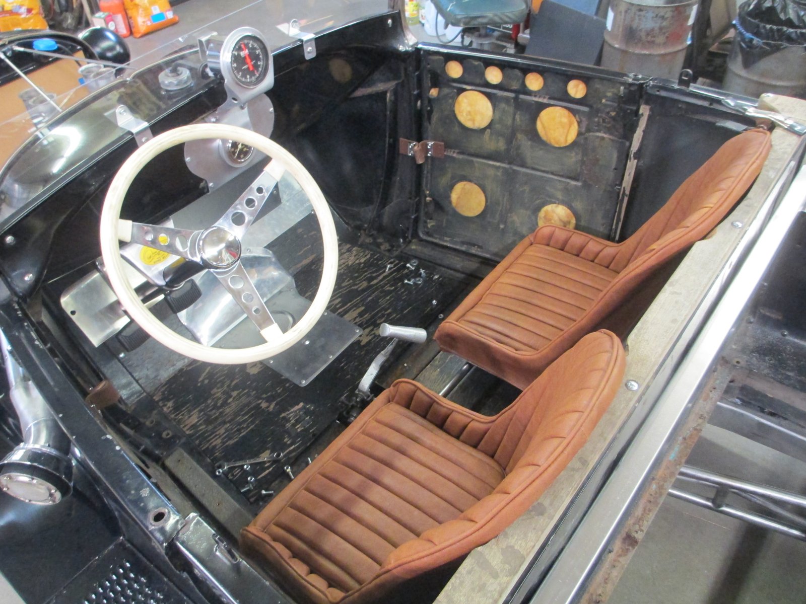

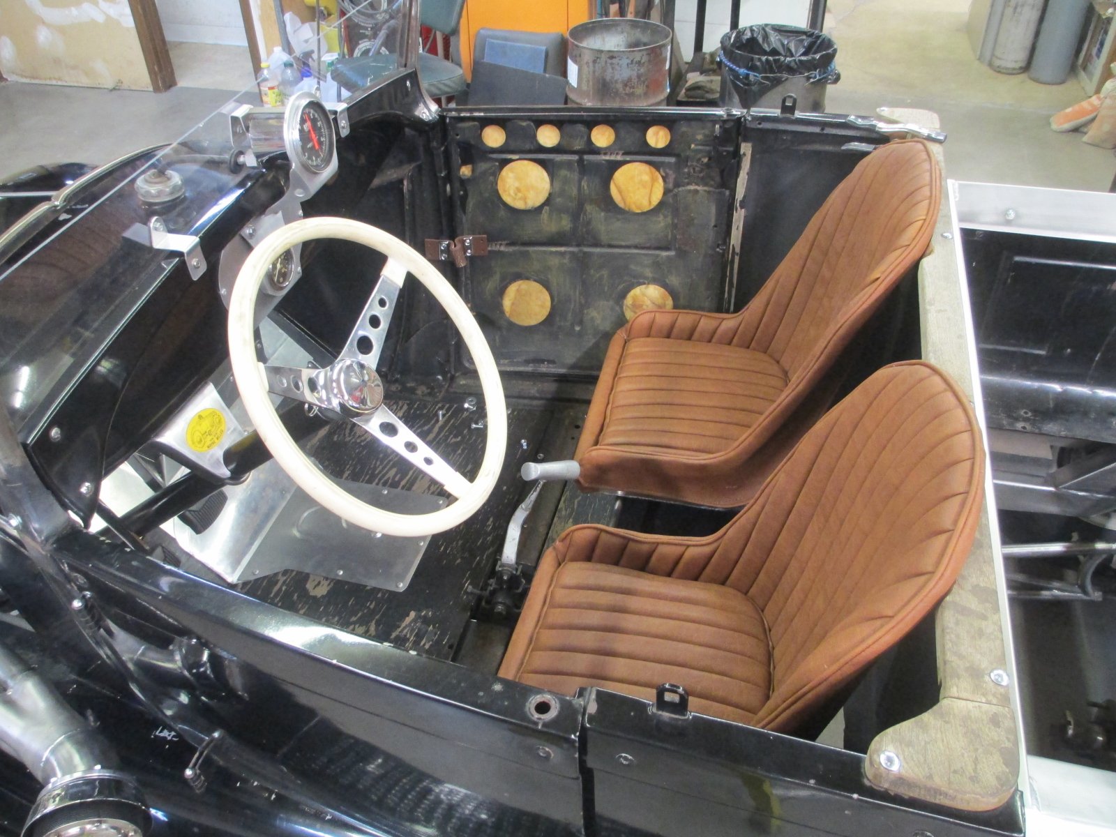

    Sam, @bskustoms delivered the seats for the Track Roadster, which are the same as the ones for the 29, except for the bolt pattern. He took the 29 seats with him to install the covers on them. I set these in the 29, just to see how they look, and am very satisfied with the the look, color, and quality of work. Thanks Sam, for taking this on for me. Just one more reason to get back on this project ! IMG_0157.JPG IMG_0158.JPG IMG_0159.JPG

    Marty, are those Speedway's seats? I like the pattern. I'm going to have to plaigerize that too when I get mine upholstered.

    Yes they are, have two sets, one for the 29, and another for the Track Roadster.

    I might have missed something, what's the yellow colour on the inner surfaces of the doors?

    Some old insulation.

    IMG_0162.JPG IMG_0163.JPG IMG_0164.JPG In a cab as small as a 28-29 RPU, little things can make a big difference, like steering wheel placement. Also, having the seat and upholstery you are going to use, helps insure the best fitment. When using a quick disconnect coupler, I try to install the column a little on the short side, and adjust to fit the driver. In this case, the steering wheel was borderline tight to my legs, and I needed just a tad bit more room. I looked in my aluminum s**** box, and found a plug that was hole sawed out of 3/8" plate. Just had to square up the OD and drill 3 mounting holes, now I am comfortable.
