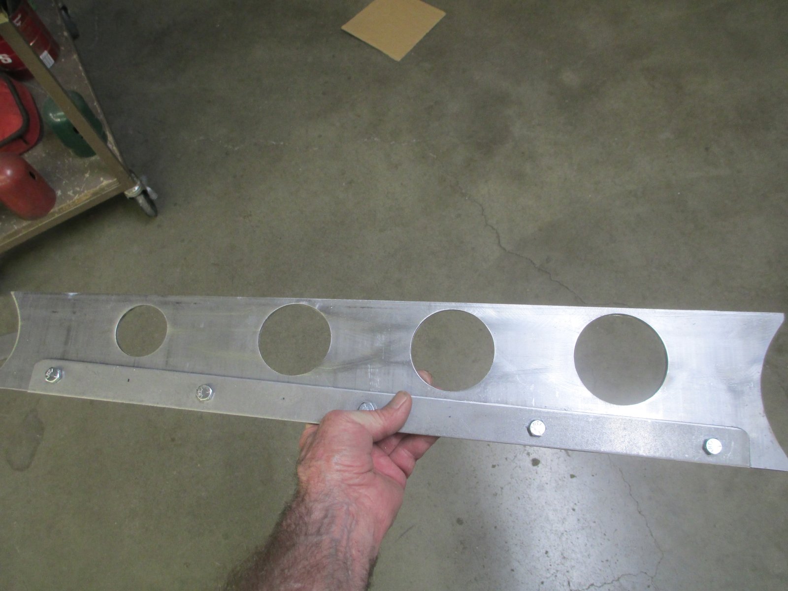

    The last couple of days went pretty well, with the upper and lower side panels in place, and held by Dzus ****ons. Next will come the curved top section that will taper down a couple inches to the rear. This is tedious work, keeping the panels aligned without a solid frame to connect to. When it's all closed up, then I can extend the frame, and tie it all together. IMG_0200.JPG IMG_0201.JPG IMG_0204.JPG IMG_0206.JPG IMG_0208.JPG IMG_0209.JPG

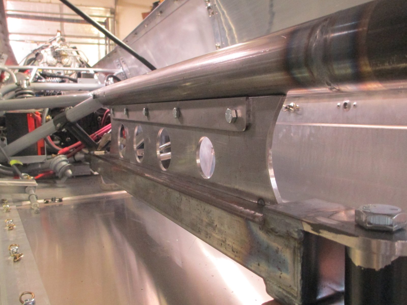

    Now that the body panels are nearly finished, I had to move to the task of extending the shroud line hook up, push wheel, and chute canister. Tying on to the the existing structure, making it strong enough to push off, on a sometimes rough track, along with being extended 36", was one thing, and it all had to come apart. Not wanting, to use a buddy of mine's phrase "that looks agricultural", I went with a mix of 2" square and round tube, combined with some 3/16" cold rolled plate. IMG_0278.JPG IMG_0282.JPG IMG_0284.JPG IMG_0287.JPG IMG_0288.JPG

    Frenchtown, did you notice, that I didn't build a frame, just extended the 3 items in the middle? Sometimes it works that way for me.
