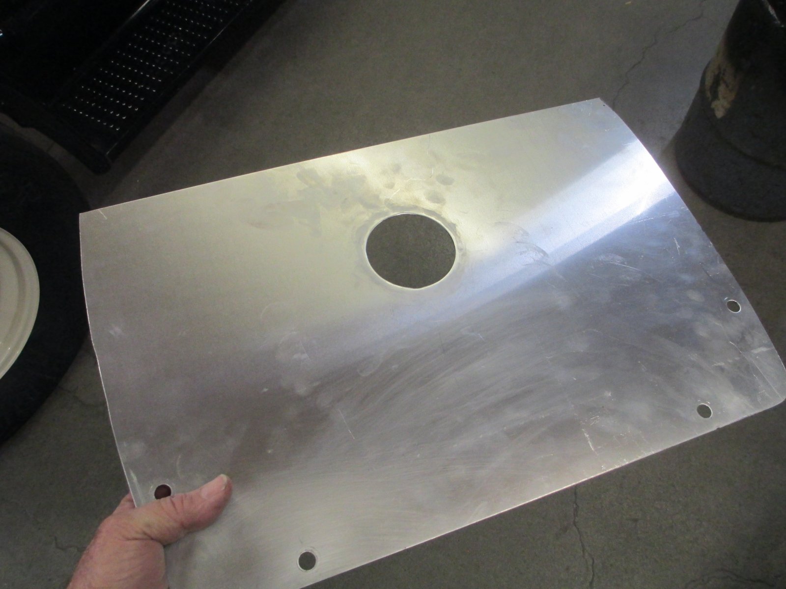

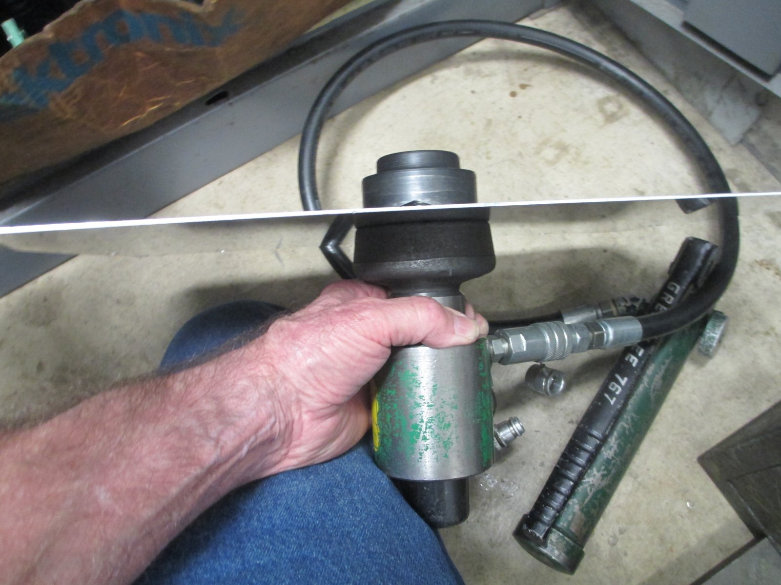

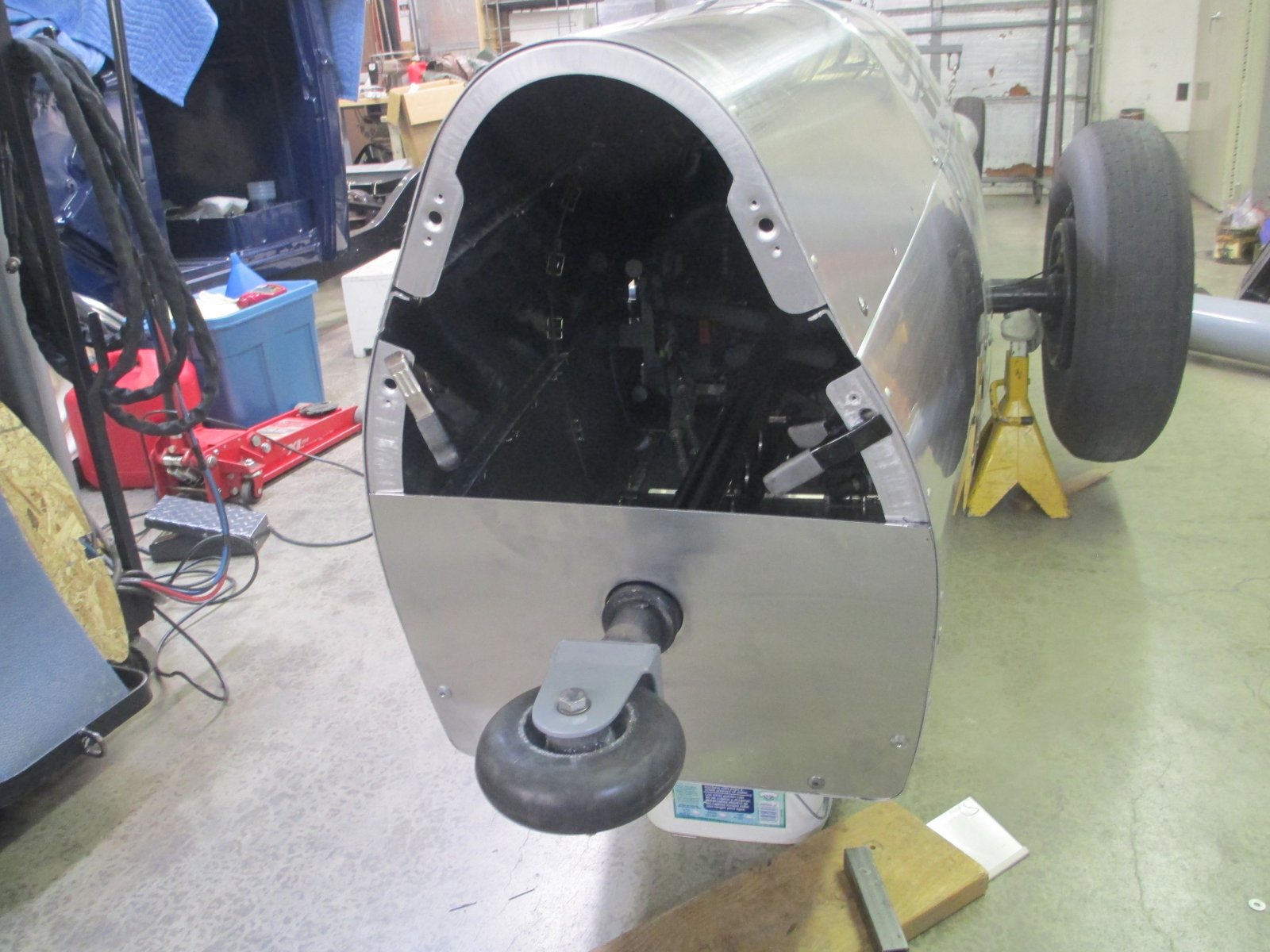

    I got the Lakester finished this morning, and it is loaded up and gone. After a days cleaning up the shop I will resume on the 29 . IMG_0319.JPG IMG_0320.JPG IMG_0323.JPG IMG_0326.JPG

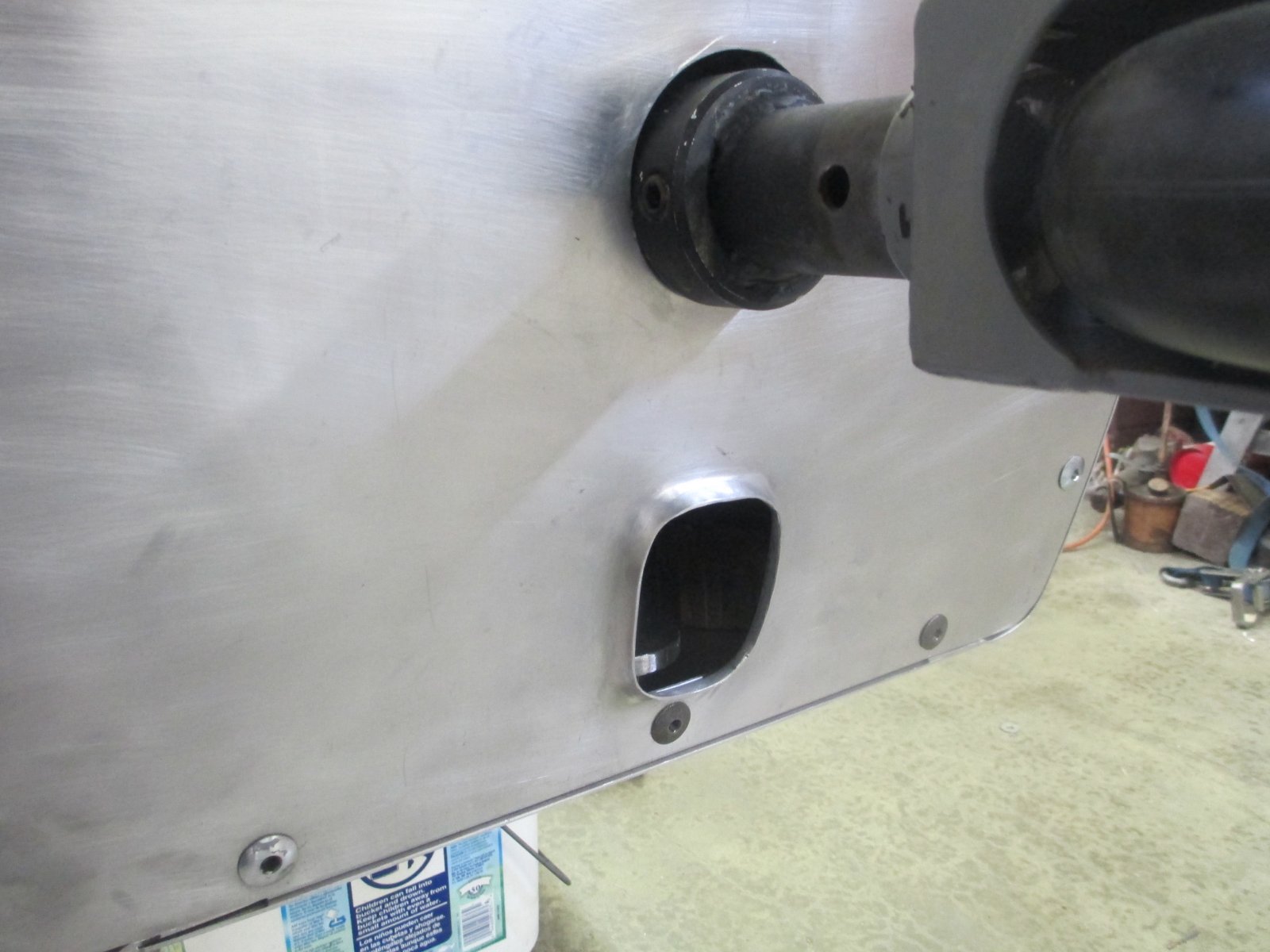

    Last night I had a visitor in the shop, those bugs always fascinate me. Today I decided to finish the rear shock mounts, and bump stops. I have mentioned this before, about my preferred lower shock mounts from full size Fords, 1965-68 or so. The have a swoopy shape, and a nice offset to the rear. Mounting them on tapered early housings, always takes more time, but I am happy with the results. With the rear section complete, when I get the driveline back, the containment loops will be next. On some cars, I fab a mini cage for the driveline, we will see. IMG_0396.JPG IMG_0398.JPG IMG_0410.JPG IMG_0412.JPG IMG_0400.JPG IMG_0405.JPG IMG_0406.JPG IMG_0408.JPG IMG_0409.JPG
