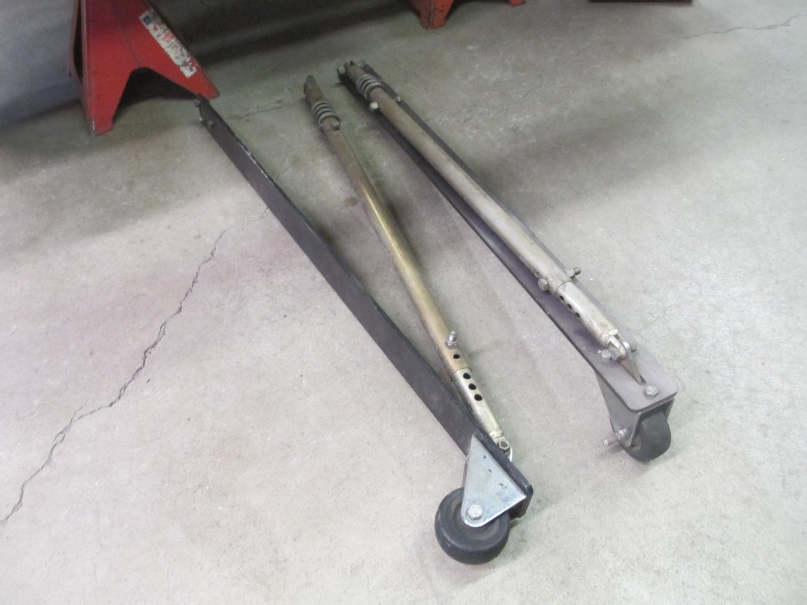

    While under the back of the truck, I am not happy with the shroud line mounting, and am going to try something different. Also, I have been thinking about wheelie bars, and remembered I had a pair in the attic. They are off a Super Gas Luv pickup I built back in 1980. They are the perfect length, old and used, just like the truck and me ! IMG_0550.JPG

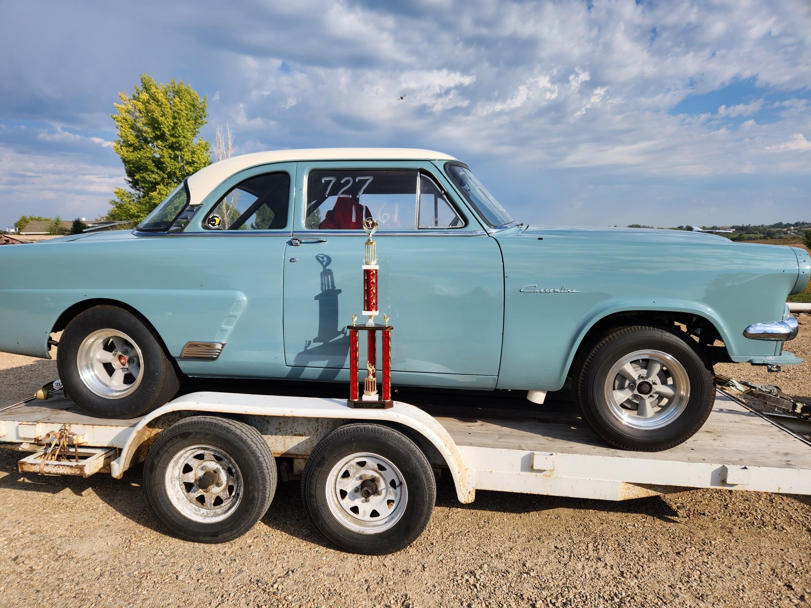

    Happy B'Day, Marty !!!! I'm still a ways ahead of you, and kinda hope you don't catch up with me... That would mean I stopped git'n older, and that's not a good thing...... Actually, I just won the Ford Cup at the Best of Detroit race at Firebird, so there's still fun to be had, even for us old farts !!! Ford Cup win.jpg

    That's a good looking Ford Bruce ! Thanks.
