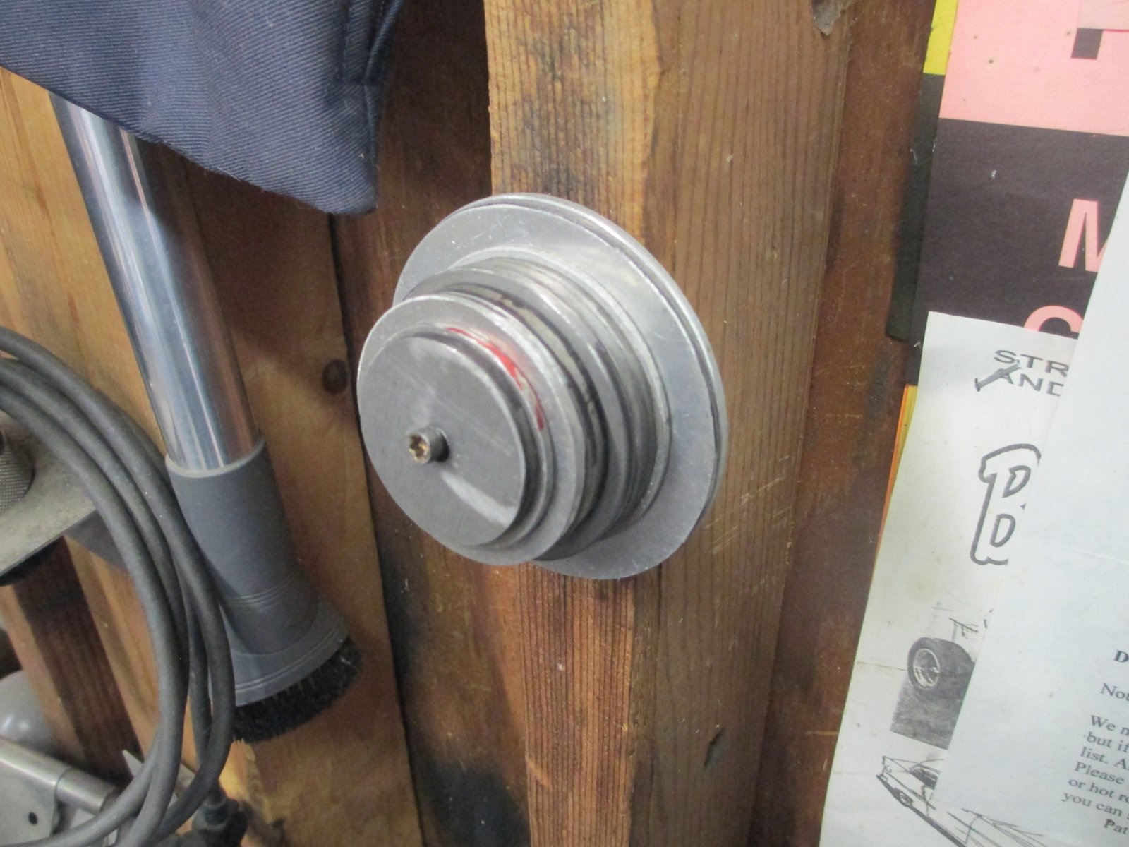

    I laid out and bent the cross bar behind the seats today. I used 1-1/4, .120 wall tube, rules state it needs to be level to 4" below the driver's shoulders. This one should come out around 2" below mine. Now, when someone comes by, to hold the other end, I will tack it on. IMG_0629.JPG IMG_0630.JPG IMG_0631.JPG IMG_0632.JPG IMG_0633.JPG IMG_0635.JPG IMG_0637.JPG IMG_0640.JPG IMG_0645.JPG IMG_0647.JPG

    Nice! I've probably missed it previously, but that washer trick is the cats pajamas.

    Dave, I save the blanks when I hole saw, have many sizes and they come in real handy for laying out lots of things. And I forgot to mention, when hole sawing the ends, don't cut all the way through, for safety sake. I finish the cuts with a Sawsall. IMG_0639.JPG

    Well, I keep those slugs as well. But never thought about using them like that. Usually they end up being turned into something, just not a layout tool. Guess you can teach old dogs new tricks.
    And great tip on the recip saw. I use one of those heavy duty fishmouthing devices, and it works great up to the last little bit. Then if not careful, oops break out another hole saw, because there's going to be some teeth missing. You've just saved me some money.
