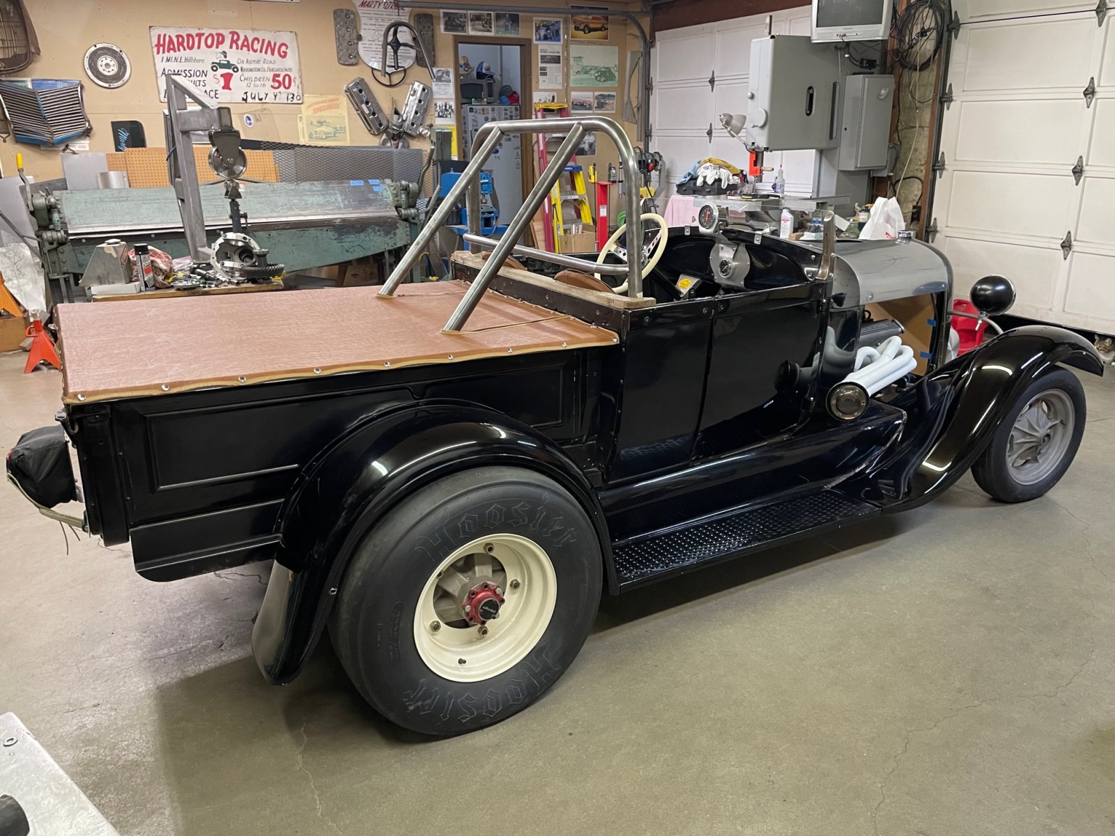

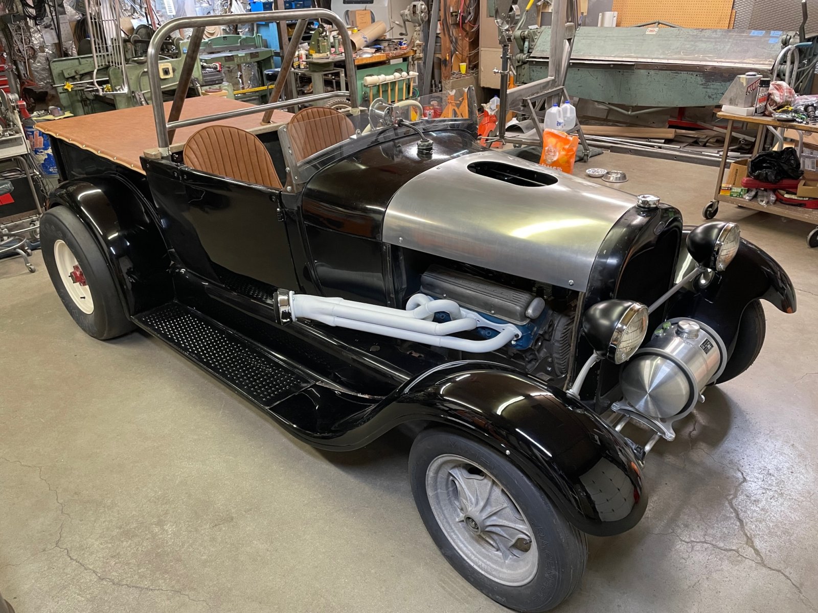

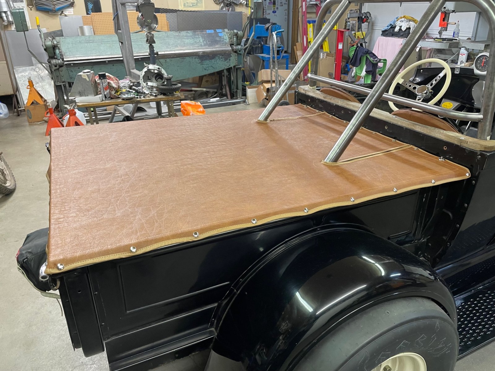

    Sam @bskustoms brought the tonneau back today with the binding and Velcro in place. I couldn't be happier, thanks Sam ! Now to mount the wheelie bars, and fab the throttle linkage. IMG_4137.jpg IMG_4136.jpg

    Looking good Marty! Every time you post a whole truck picture, makes me want to throw the fenders back on mine, pull the Ardun and put my injected Boss 302 in!

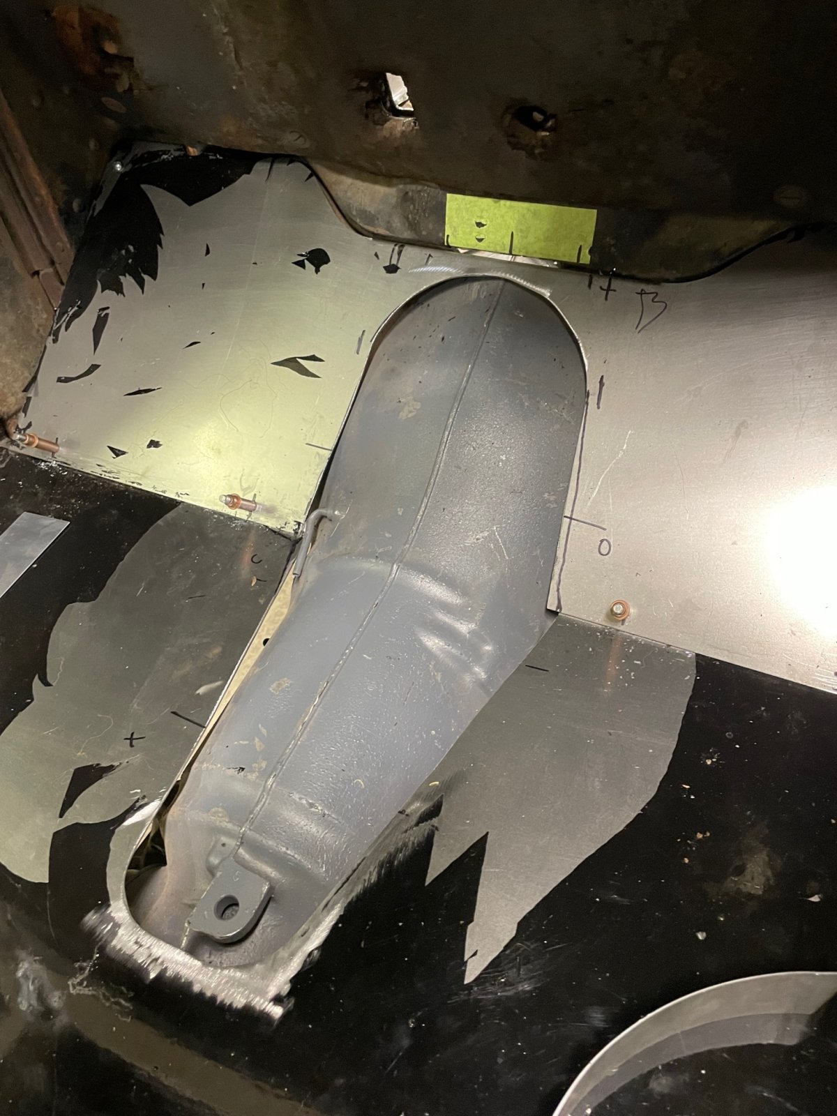

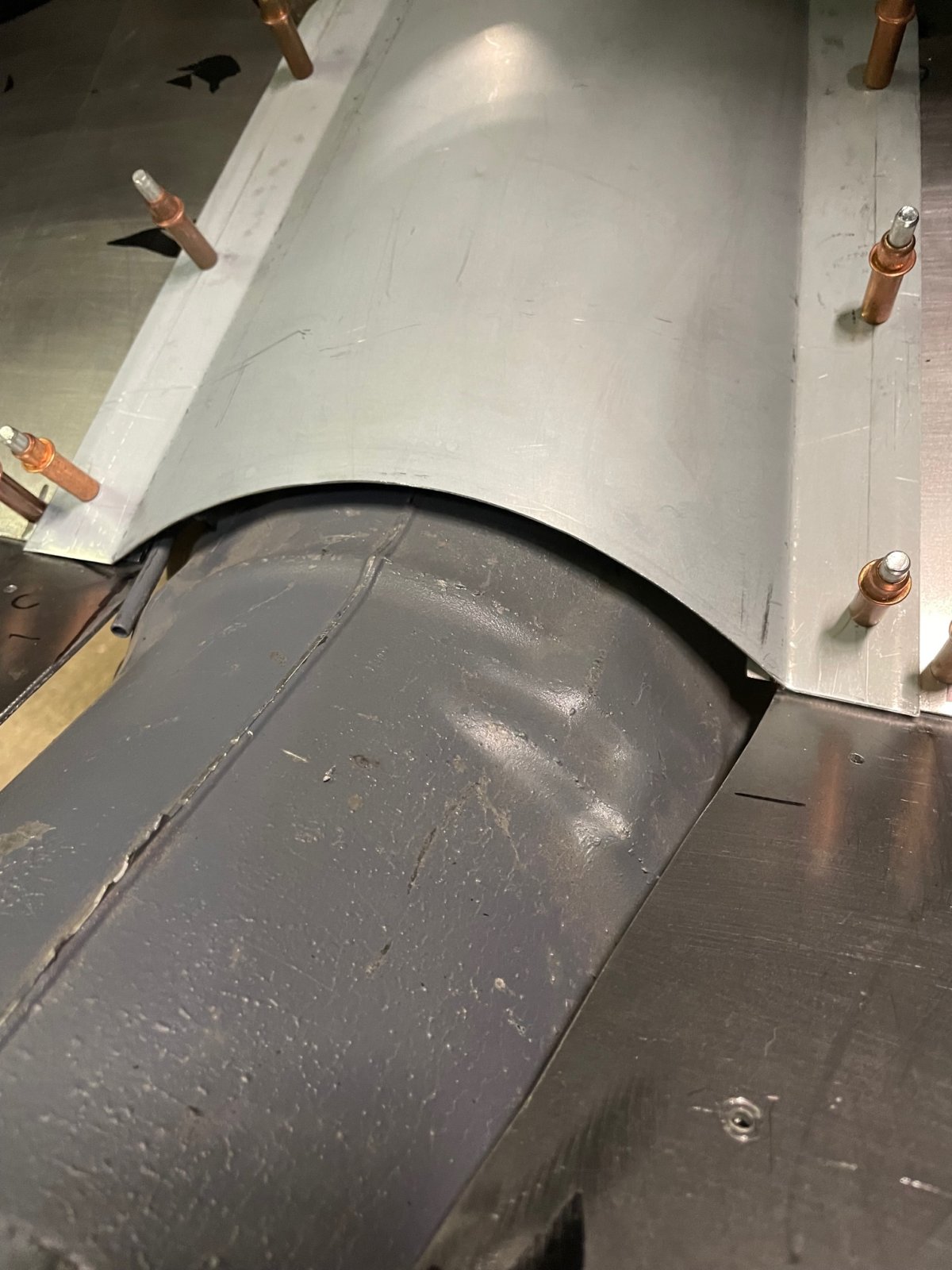

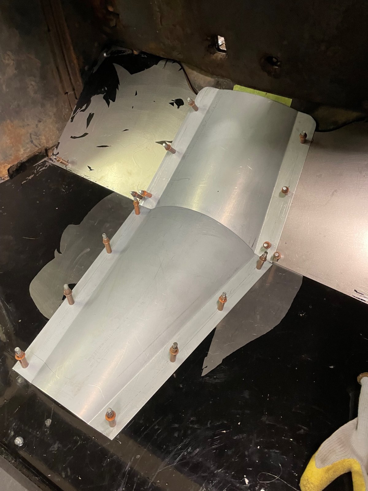

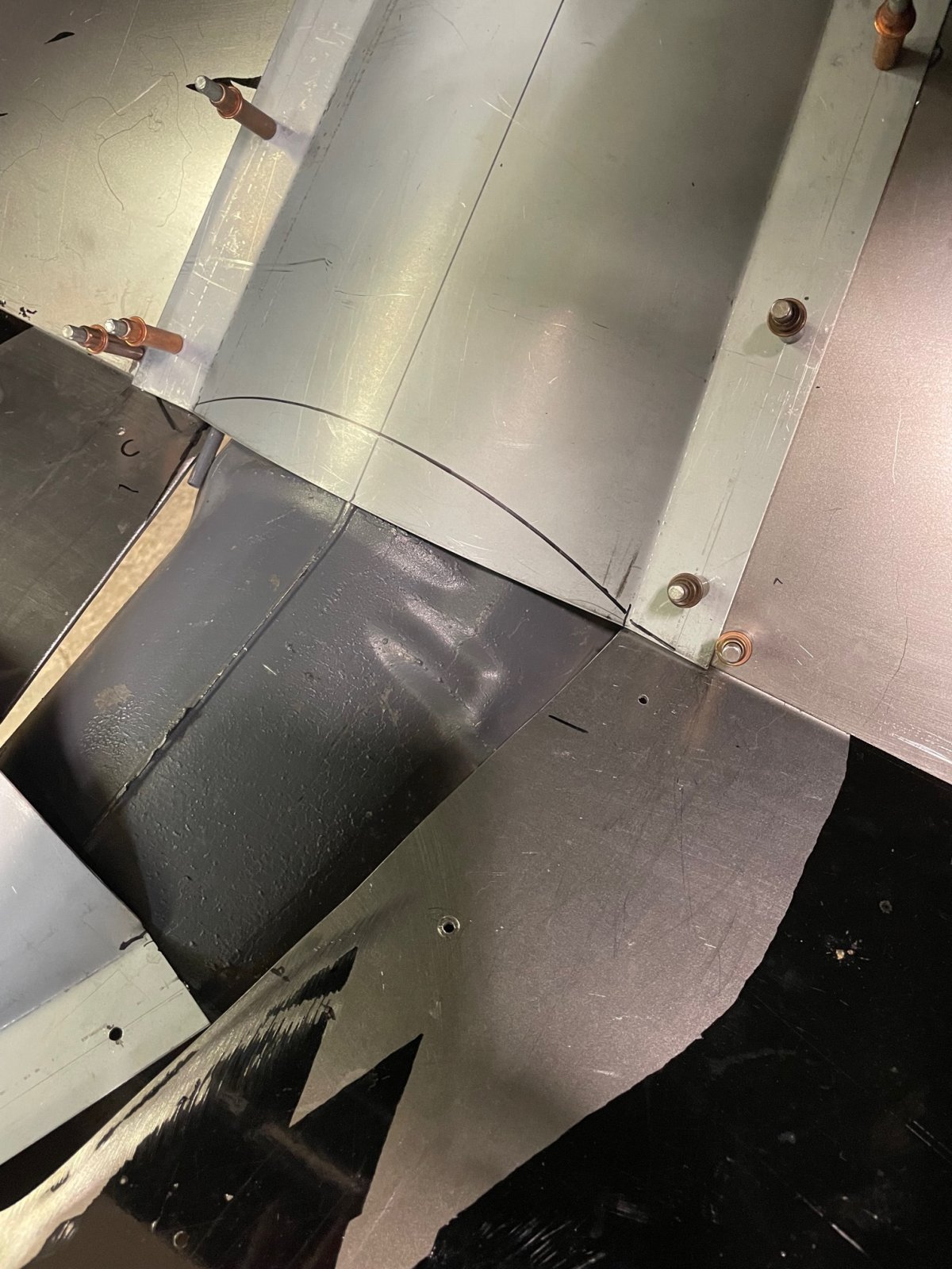

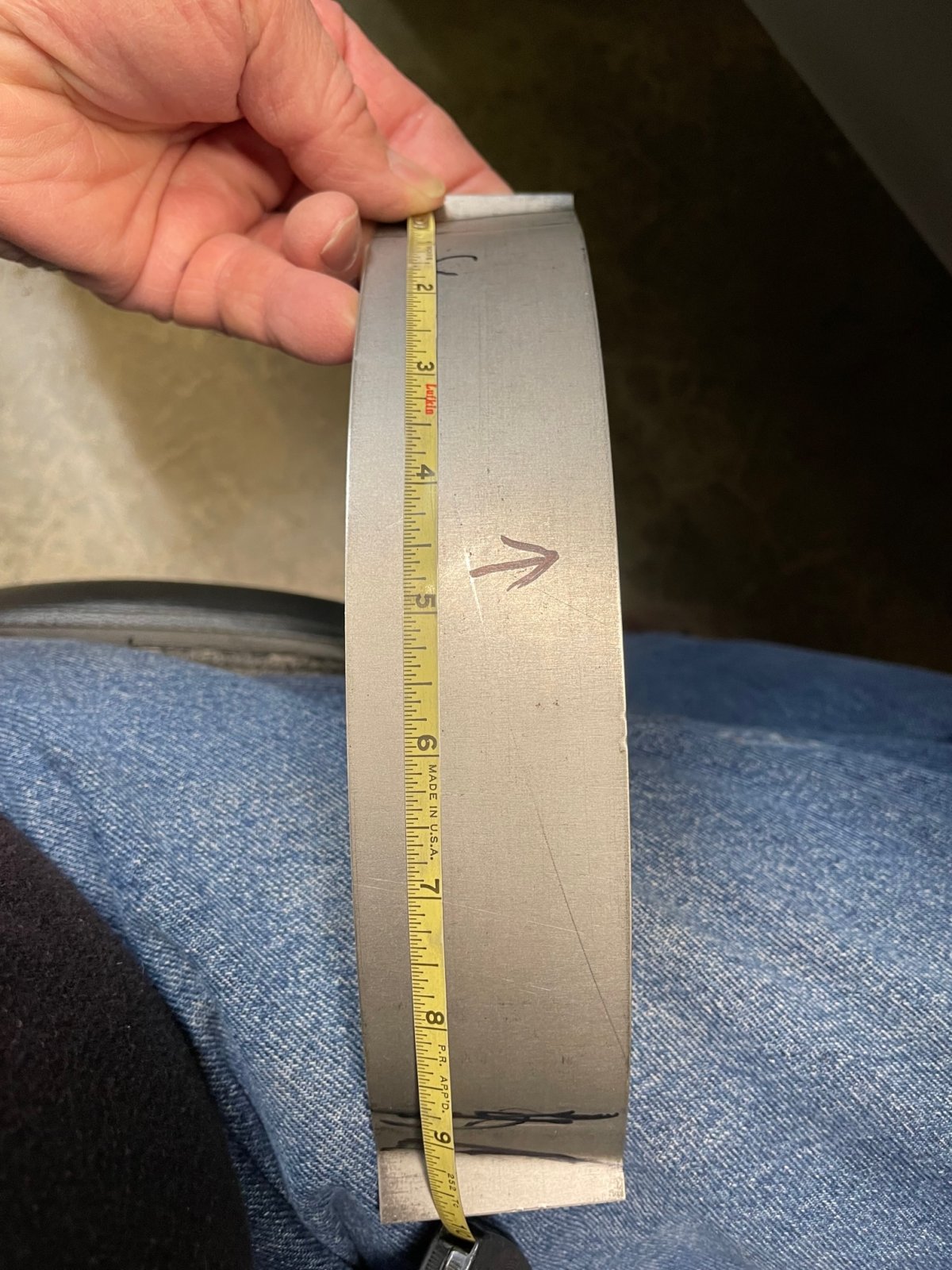

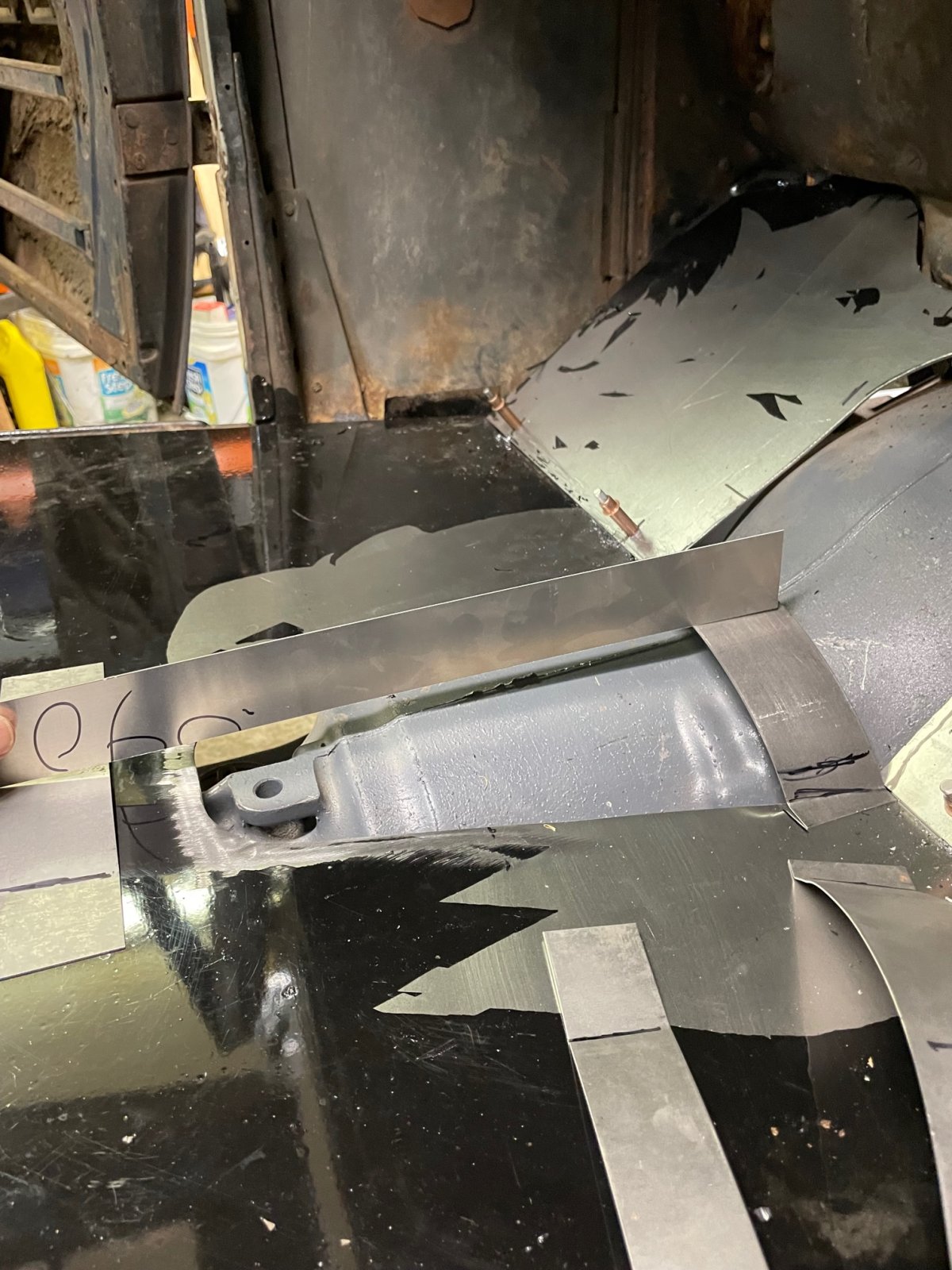

    Since I last posted on here, I did a quick job on a 32 coupe that needed a tunnel cover. I have since been sidelined with some health issues, but am on the mend. My pal Louie has been guarding the RPU, until I can get back on it. IMG_4185.jpg IMG_4186.jpg IMG_4187.jpg IMG_4188.jpg IMG_4189.jpg IMG_4192.jpg IMG_4194.jpg IMG_4195.jpg IMG_0650.JPG

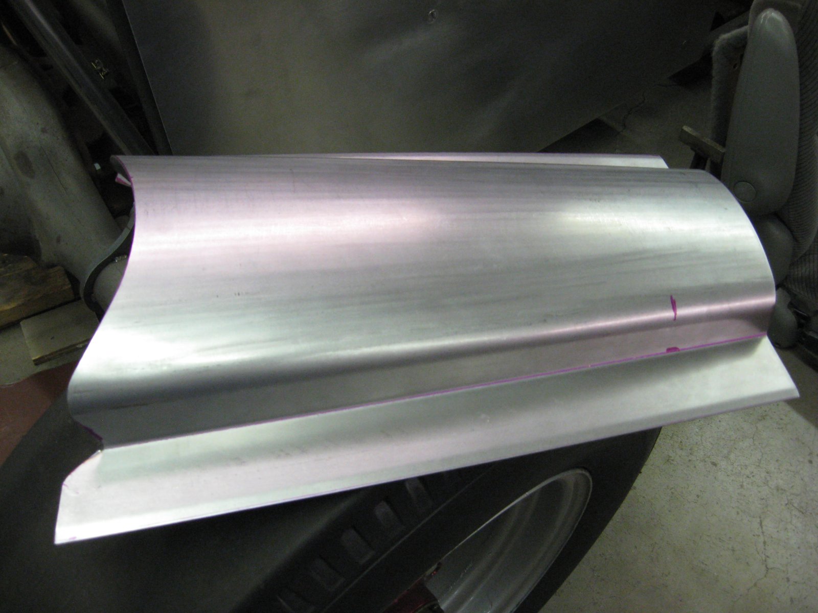

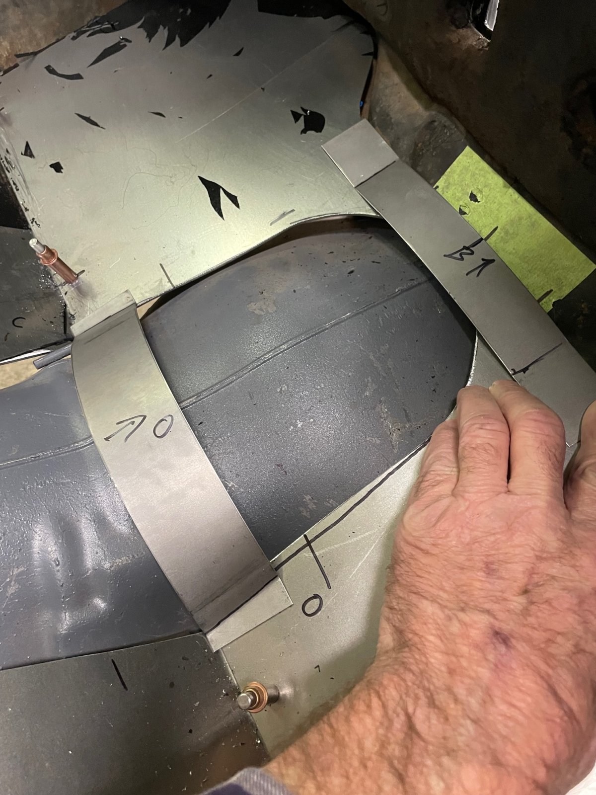

    Tim, thanks, I like to keep tunnel covers to a minimal height. So, by rolling up narrow strips and bending the feet flat, and laying a straight edge on top to tell where the ends will wind up. Then using a floppy 1/4” wide tape measure, it gives me the stretch out dimensions at given points. What I didn’t show was that I tig welded the two pieces together.

    Here is one I did in a 29 roadster, with a flathead and 5 speed. IMG_1413.JPG IMG_1414.JPG

    That’s slick looking. Where the two pieces meet is that little tang coming off the forward piece a full shape or is there just a slit that the longer part slides into? I dig it either way.
    im also curious how you went about capping the back end. I’m paying extra attention lately because the t86/r10 going into my model A is probably going to need some sort of tunnel. Really enjoy your solutions.

    I like that Marty! I want to get to the upper two bell housing bolts so what you did there, going up the fire wall looks just what I need. I started making thin straps to get a shape like you did. But the project has been shelfed again till I get this mustang out of here.
