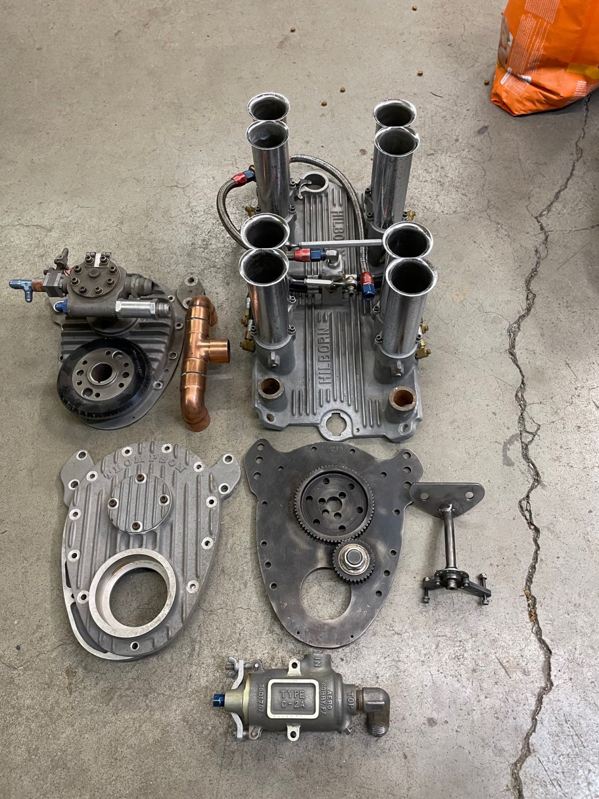

    I must be feeling better, as I went shopping today. I have known about this Hilborn Injector for several years, and it has been in the back of my mind for that time. I called the owner up and paid him a visit today and purchased it. It's smaller than the one I have, by quite a bit, and measures 1.800 inside the stacks, versus 2.0625 on the other one. I have been thinking about building a smaller engine, and have pieces to build a standard bore 327, compared to the long rod 355 I have. Maybe I need 2 race cars ? Made another stop and collected a couple 8-3/4 Chrysler housings, dragster ready. IMG_4228.jpg IMG_4229.jpg IMG_4227.jpg IMG_4230.jpg

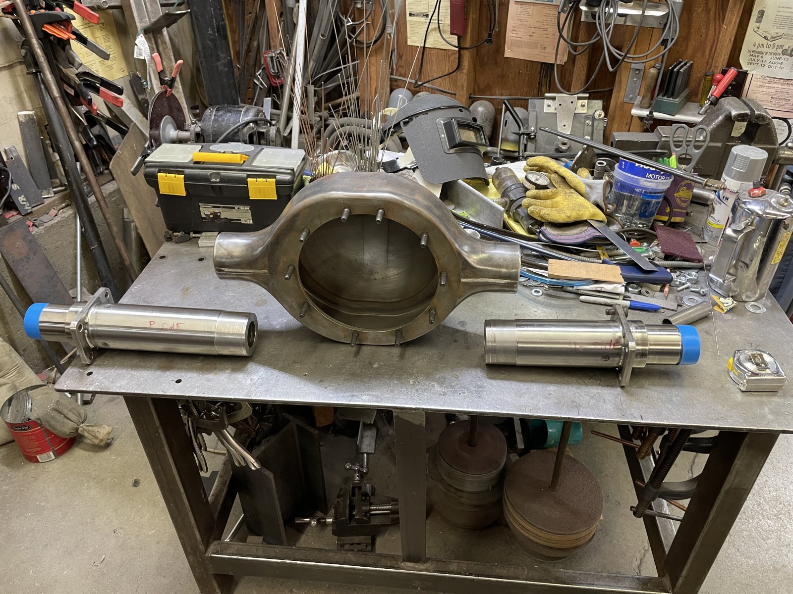

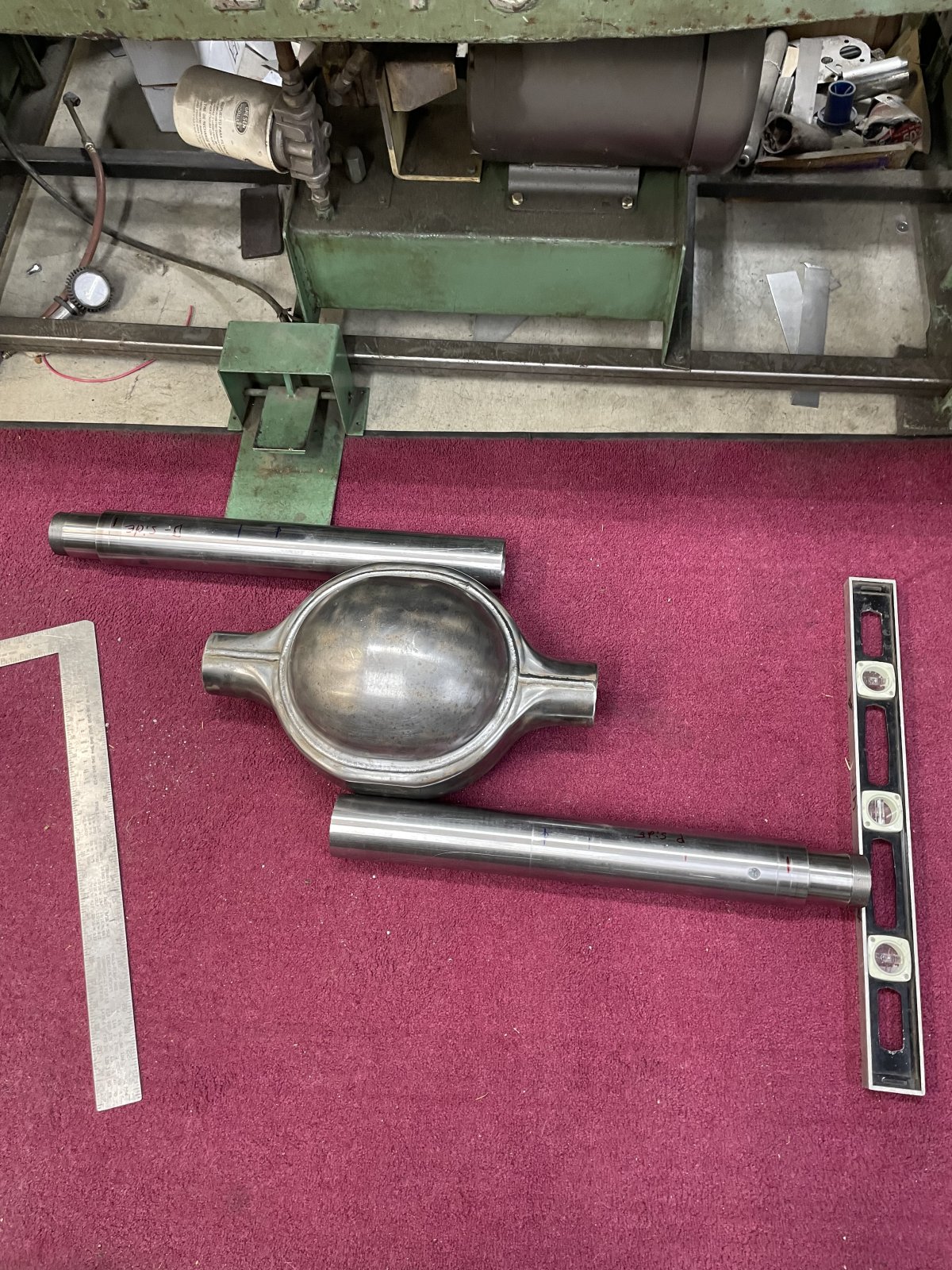

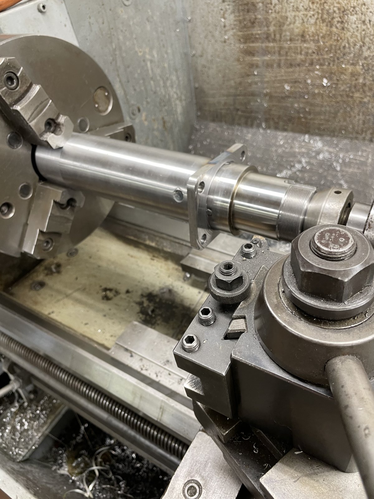

    IMG_4346.jpeg I have been getting back at it, had a few aluminum heads for Chevys that had blown up. I got them welded for my local machine shop. Got a new project on the drawing board, and wanted to use an 8-3/4 Chrysler rear. So I bought a new center housing, along with some Grand National tubes and snouts. Since it will be drum brakes, I had some backing plate brackets laser cut. After getting the brackets welded and faced, I machined steps on the tubes to slide them into the center. Tomorrow it should be in the cradle with the line up bar and tack welded. I am moving a little slower during my recovery, but making progress. IMG_4302.jpeg IMG_4332.jpeg IMG_4333.jpeg

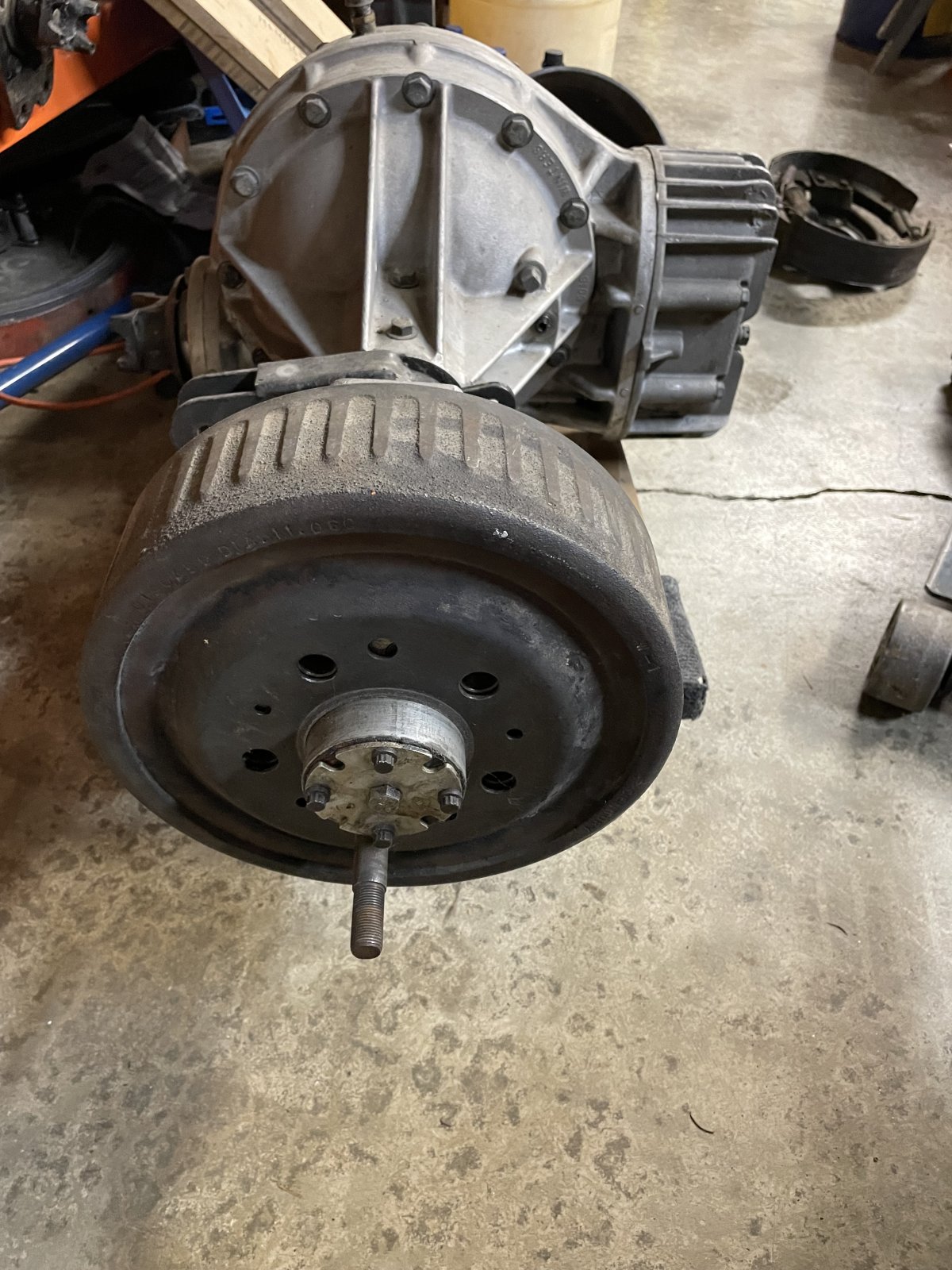

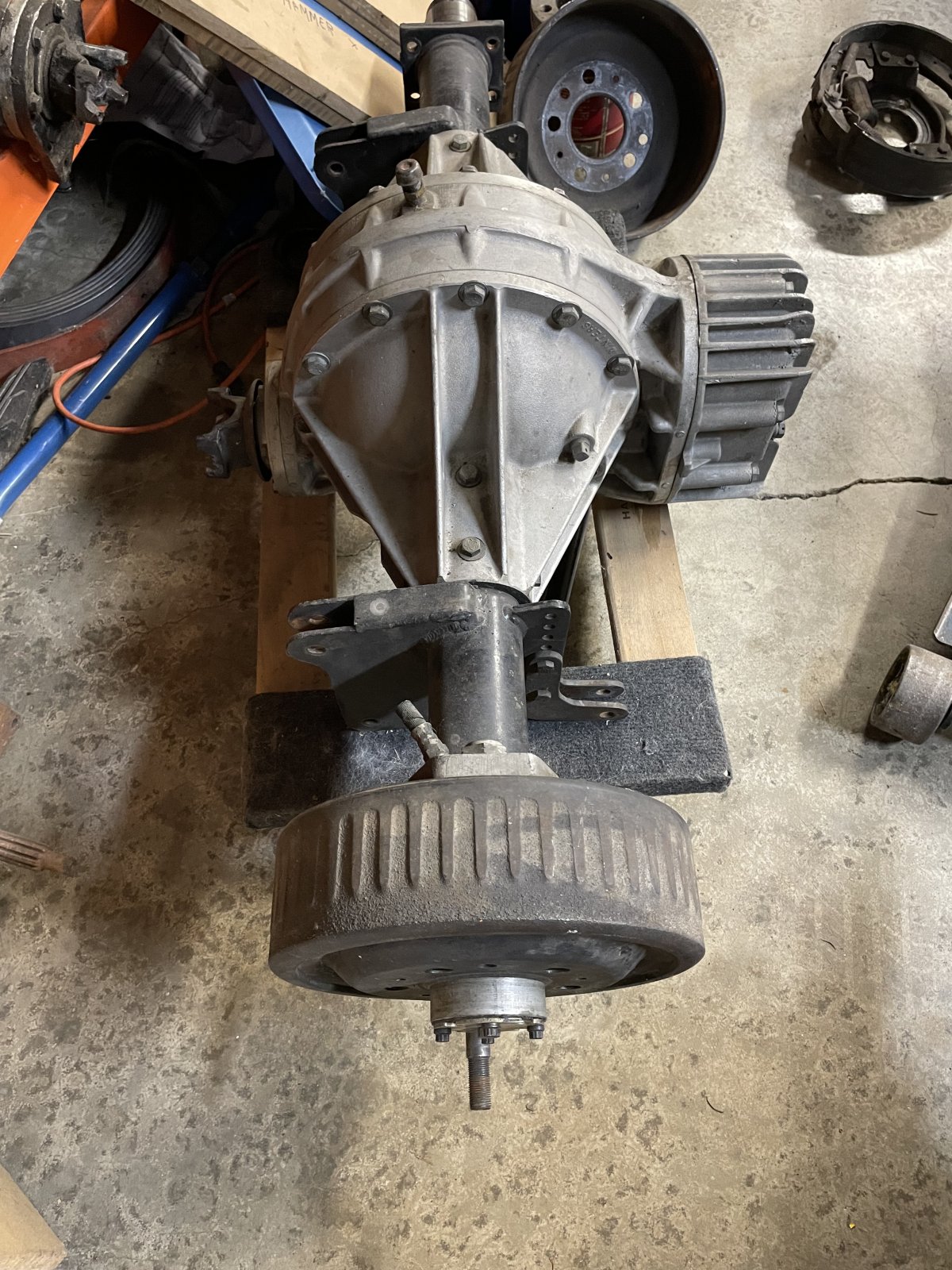

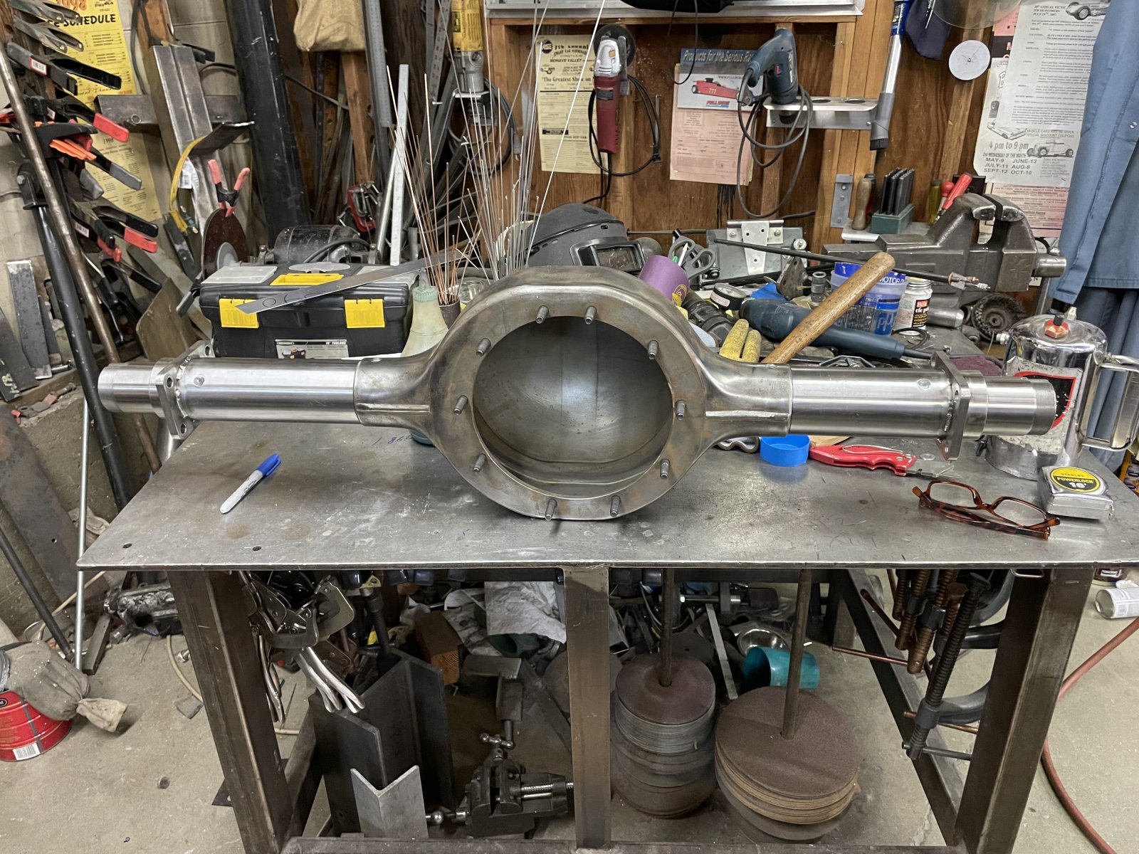

    Today, I got it carefully welded up the tubes keeping the ends within a few thousandths of perfect. Here it is with what I believe to be a Mopar Performance aluminum case. Now I need a 30 spline spool and some custom 24 X 30 spline axles. IMG_4349.jpg IMG_4348.jpg IMG_4352.jpg IMG_4353.jpg IMG_4354.jpg IMG_4355.jpg IMG_4356.jpg

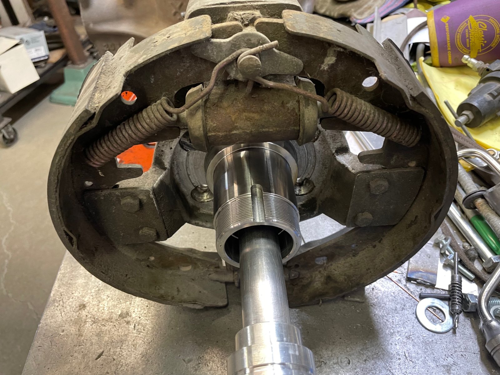

    Say Marty, what exactly are those backing plates off of?
    Stogy likes this.

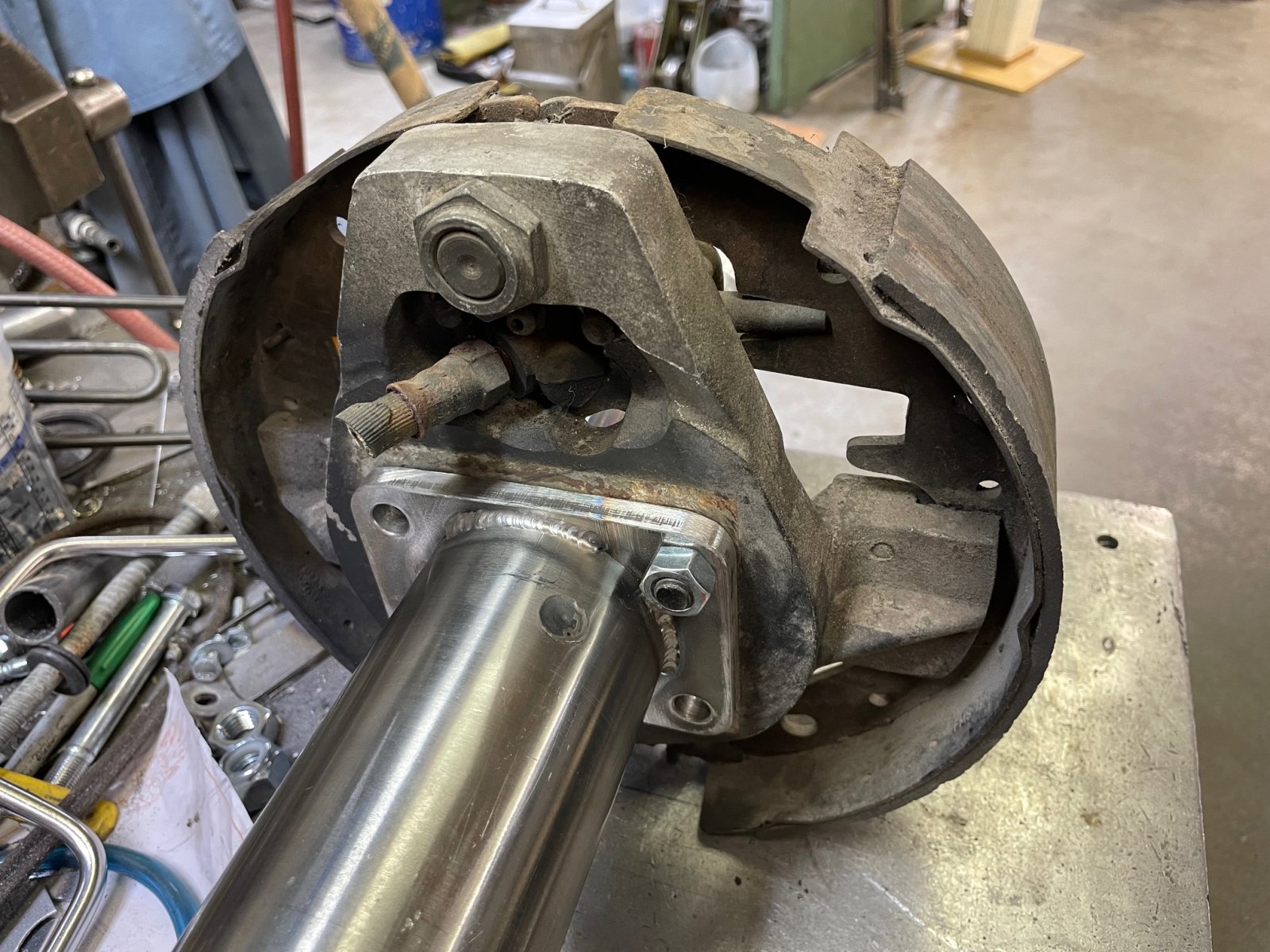

    Dave, they came on a Champ QC, and are 5 on 5 Grand National. Perfect for this application. IMG_4337.jpeg IMG_4336.jpeg

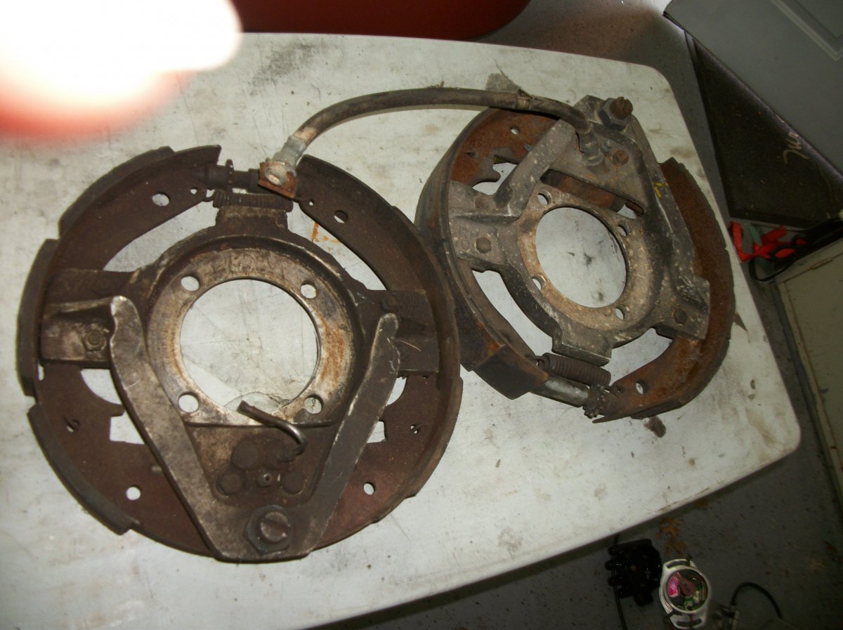

    I am tying to find out, the are certainly old enough to be Stock Car Products.
  28. Dave G in Gansevoort
    Joined: Mar 28, 2019
    Posts: 3,761
    from Upstate NY
    I have never seen that style before. I used the fabricated spider backing plates from Frankland for 3/4 ton spindles both front and rear. And Buick aluminum drums fitted to Frankland hubs. I probably should have kept the 18 or so left over Buick drums when my mom sold the estate in my hometown. But I was in college by then, and no place to store them. Oh well...
  29. alchemy
    Joined: Sep 27, 2002
    Posts: 22,715
    alchemy
    I’ve had some in the past, and currently have a matching pair of similar skeleton plates. I always thought they were Frankland parts, but don’t remember seeing any names on them.
