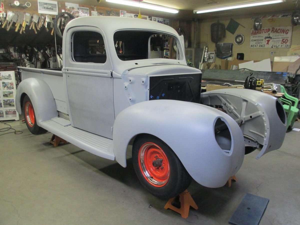

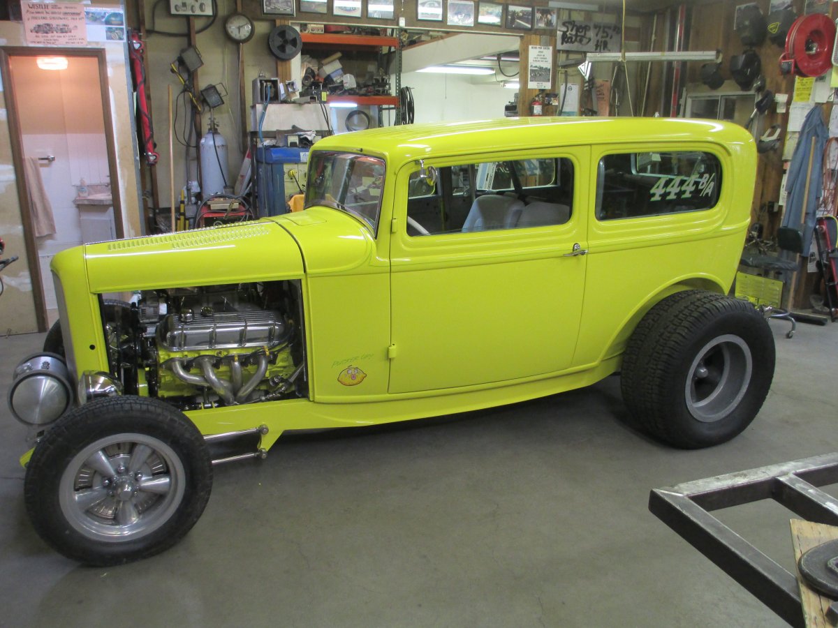

    Hi there Mike, good to have you following along. I have been tying up loose ends on my '40, stripping off accessories and getting it ready to ship off for paint, before jumping back on the '29. The decision on the firewall will come when I get to that point. It might be aluminum, because that's easier for me to form and shape, and looks correct on a race car. I am a fan of clear anodizing, for that spartan look. IMG_3749.JPG

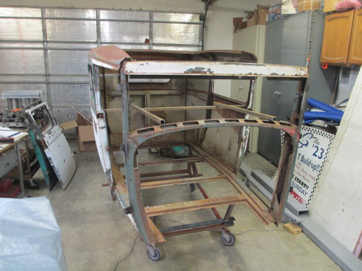

    I have been helping a couple of buddies with projects. Removed some pesky hinge pins, to get the doors off, and sent it to the sandblaster. The '29 will be our on site transportation at the salt next year. Welding boxing plates, front and rear in a '32 ch***is, then back on the RPU ! IMG_3760.JPG IMG_3764.JPG

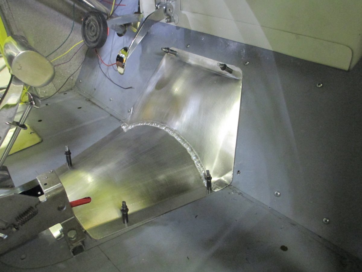

    I spent the day fabbing a tunnel cover for this Deuce sedan. IMG_3779.JPG IMG_3786.JPG IMG_3778.JPG

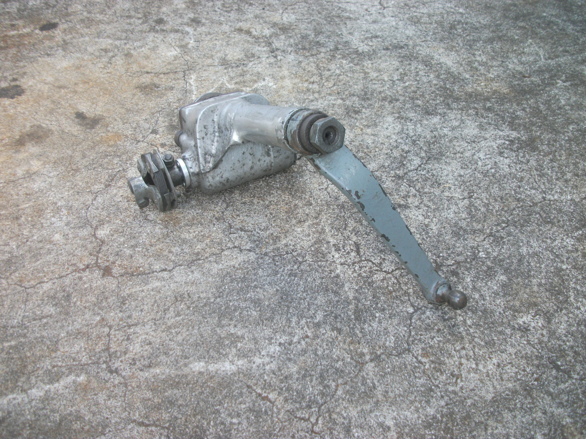

    The new radiator should arrive anytime, in the meantime I stayed busy fabbing and installing some hidden hood hold downs on the 32. I also started on a new Track Roadster, by digging out all my patterns for the project, and getting the ch***is ready for ***embly today. The patterns were used to build 10 cars, I haven't used them for 10 years. On the 29 RPU I have been thinking of a Vega cross steering. The ratio of those steering gears is 22 to 1, I would like something a little quicker, and have an in line Howe steering quickener that would get it to around 15 to 1. Not sure what to do. IMG_3836.JPG IMG_3847.JPG IMG_3829.JPG

    "I would like something a little quicker, and have an in line Howe steering quickener that would get it to around 15 to 1. Not sure what to do."
    Lengthen the pitman arm on the Vega. Should be an easy task for a fabricator like you. See you Saturday.

  16. Gofannon
    Joined: Feb 8, 2007
    Posts: 993
    Gofannon
    Long pitman arm would help. I was going to use this early 50's Chevy truck arm on a reversed HT Holden box until I found an old sprint car box. Those arms should fit a Vega box.

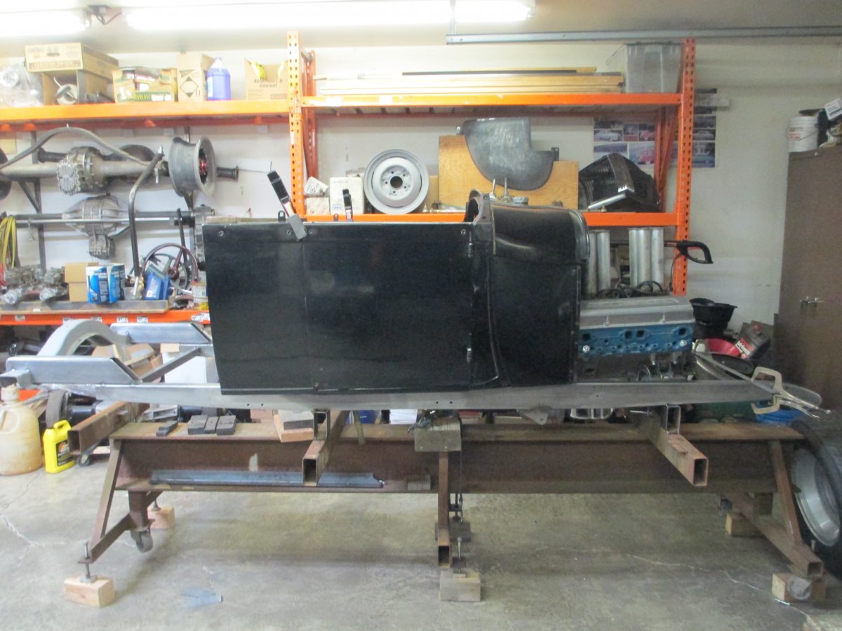

    Thanks Mike ! I got the ch***is racked up, tacked up, the floor swept and now time for dinner ! IMG_3858.JPG IMG_3859.JPG IMG_3860.JPG

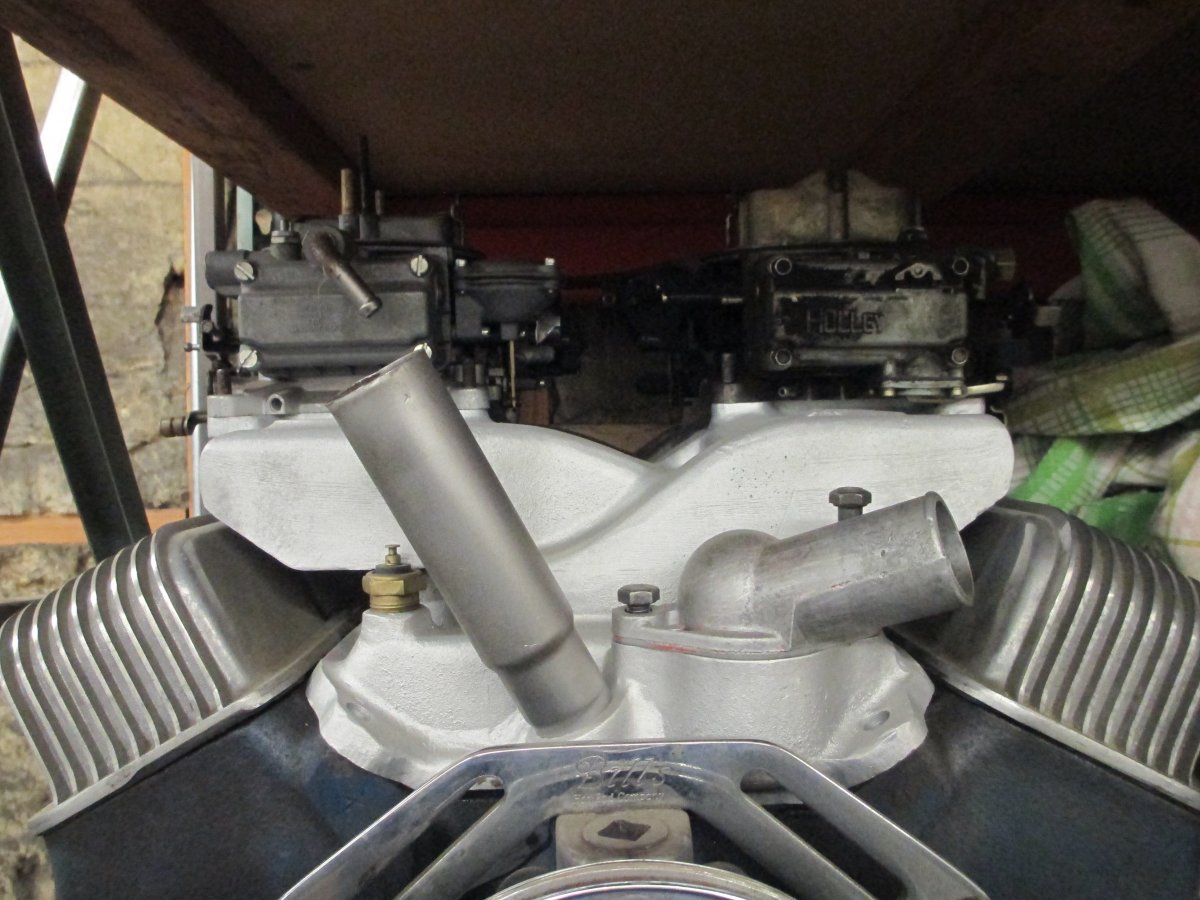

    My schedule should have me back on it Monday, but for now, this is the setup I plan on using for the street engine. I will need another 390 Holley carb. IMG_3916.JPG
