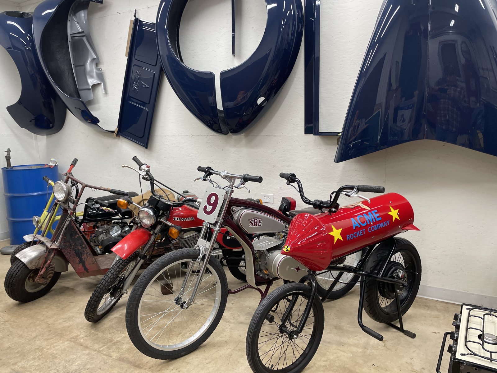

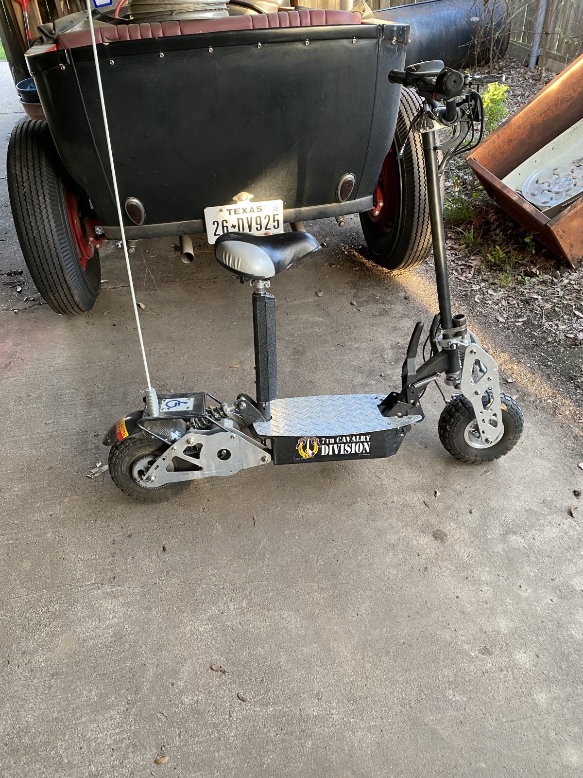

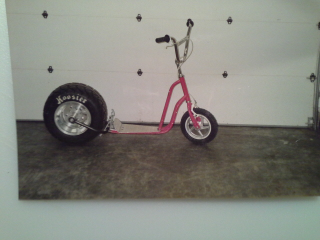

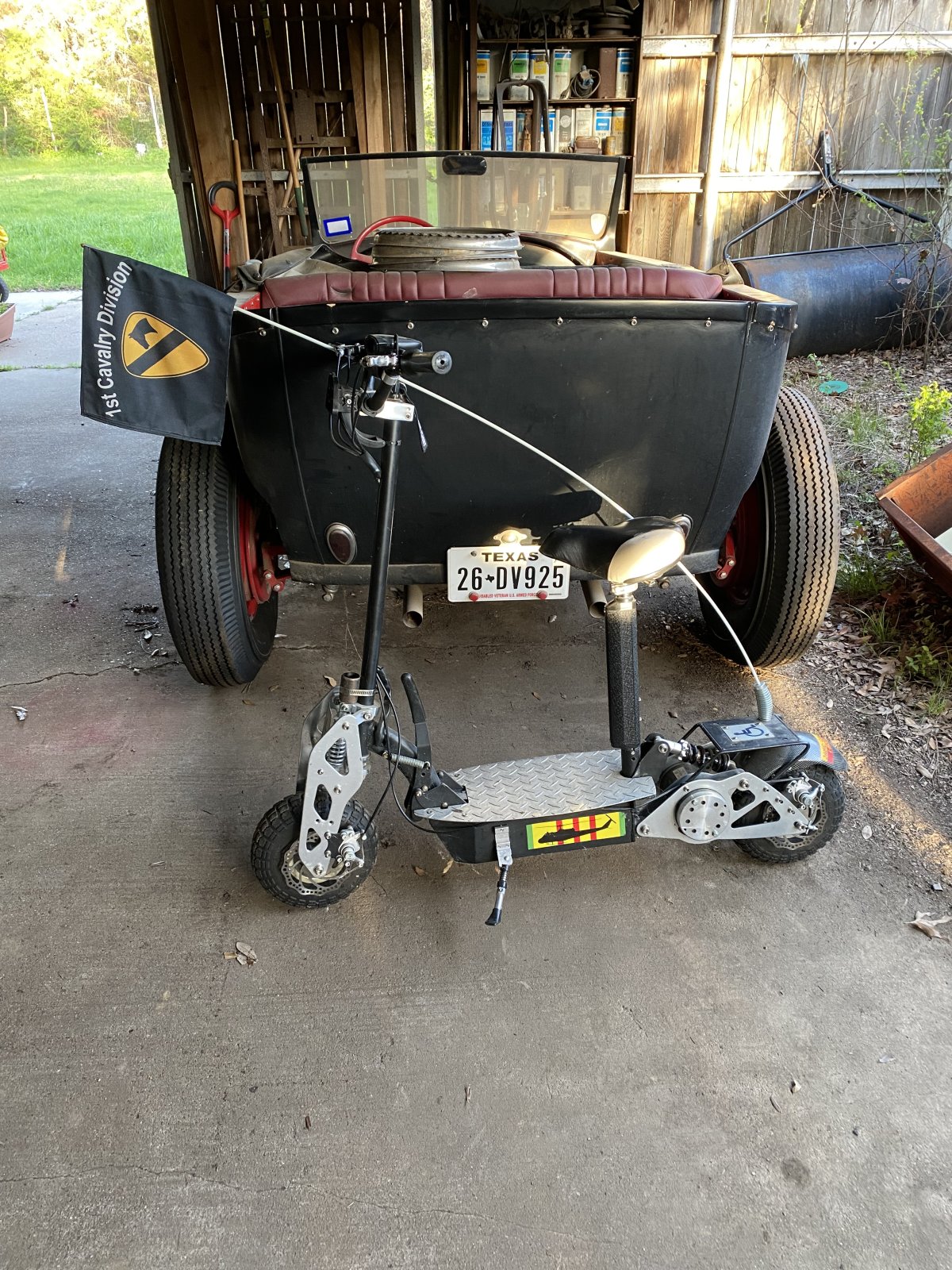

    I did two miles around PIR with this one at the swap meet, no blood but I could barely walk when I was done.
    Note to self.......switch legs every once in a while!

    Never had much luck on my son’s Razr scooter but that motorized one definitely has me thinking that it’s something I could put to good use. Thought it more of a pain in the ass with not much reward for the effort. Got pulled over by the state PoPo between Toutle and the track last year simply due to not paying attention to my speedometer. Just cruising along and taking in the sights. It’s a fun event and I’ll be there again this year.

    The thing has six gears and nearly threw me off mid way through second gear.
    Actually all three of my scooters could be (anyones)!
    I also have a leg powered Bonneville themed one.

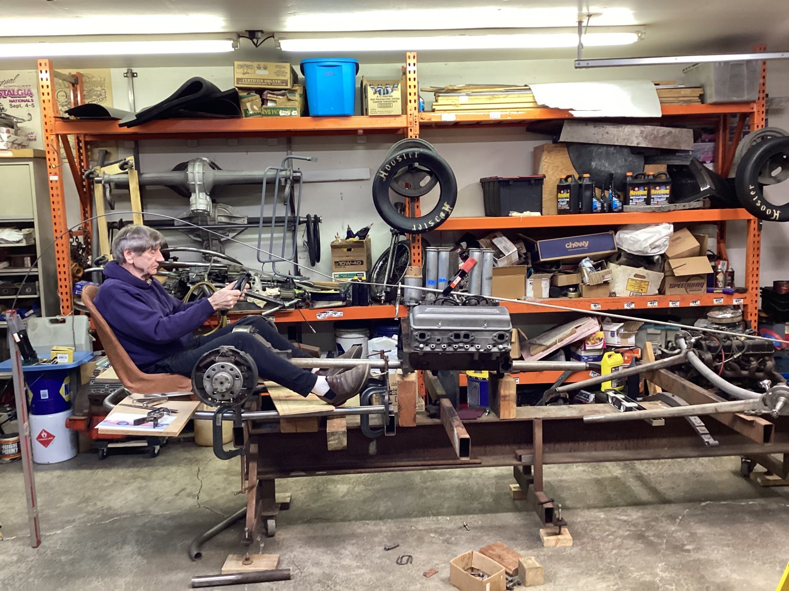

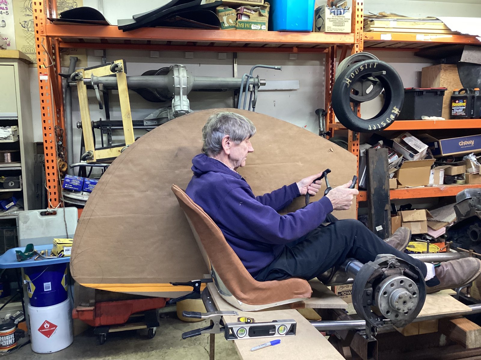

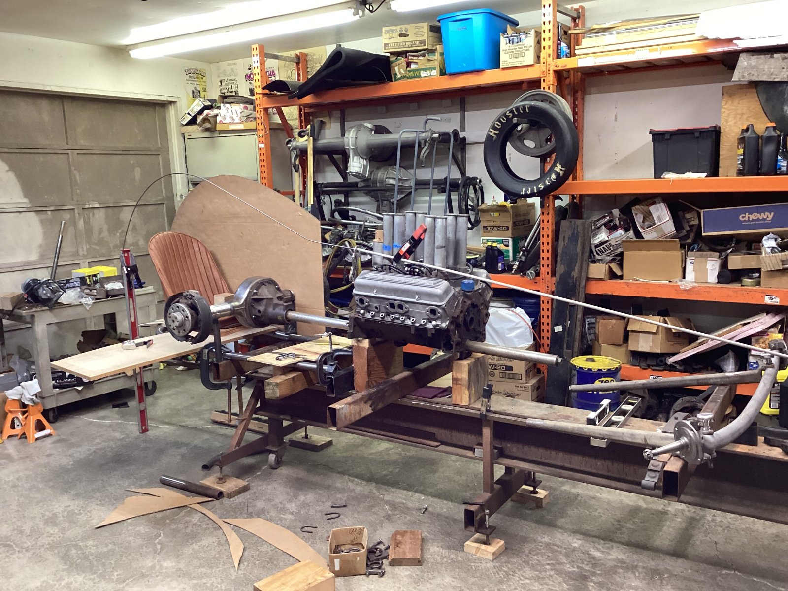

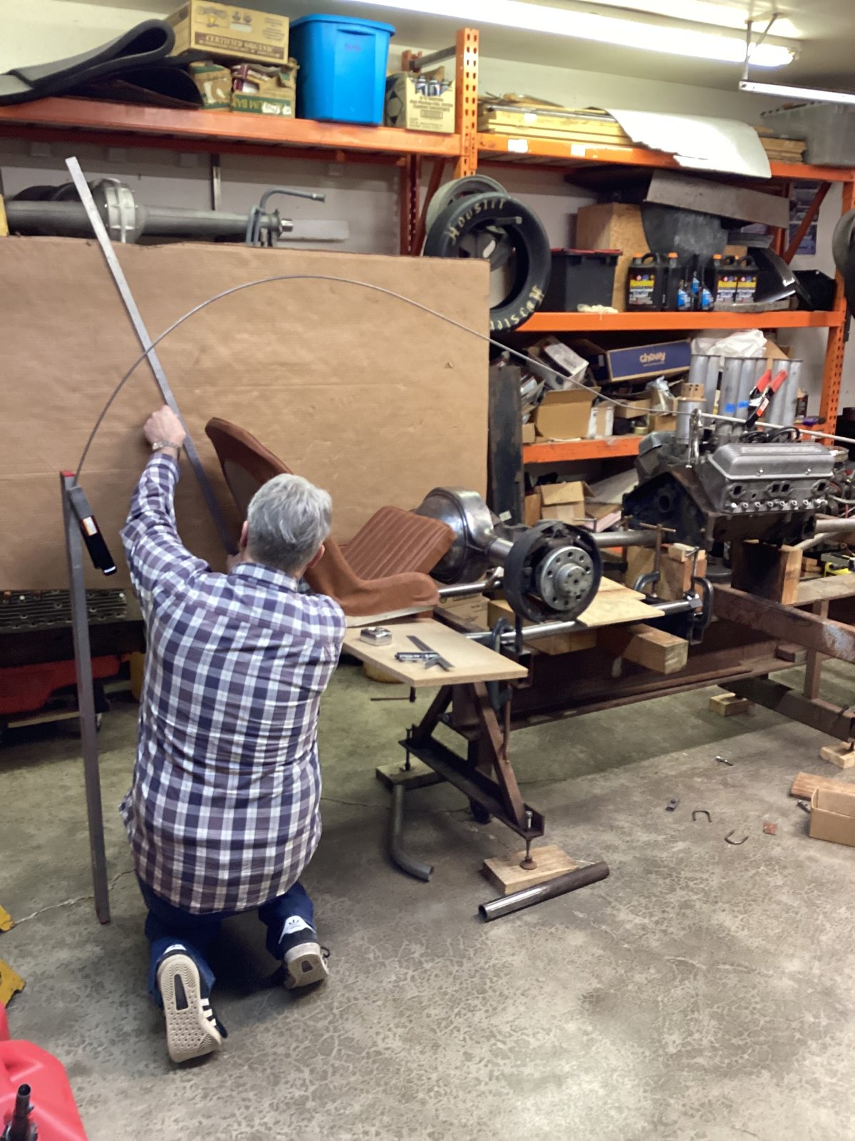

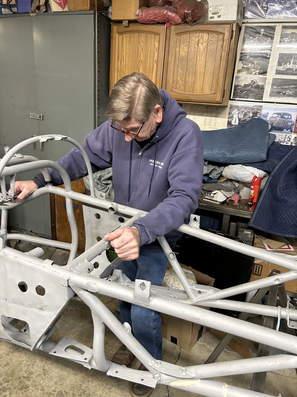

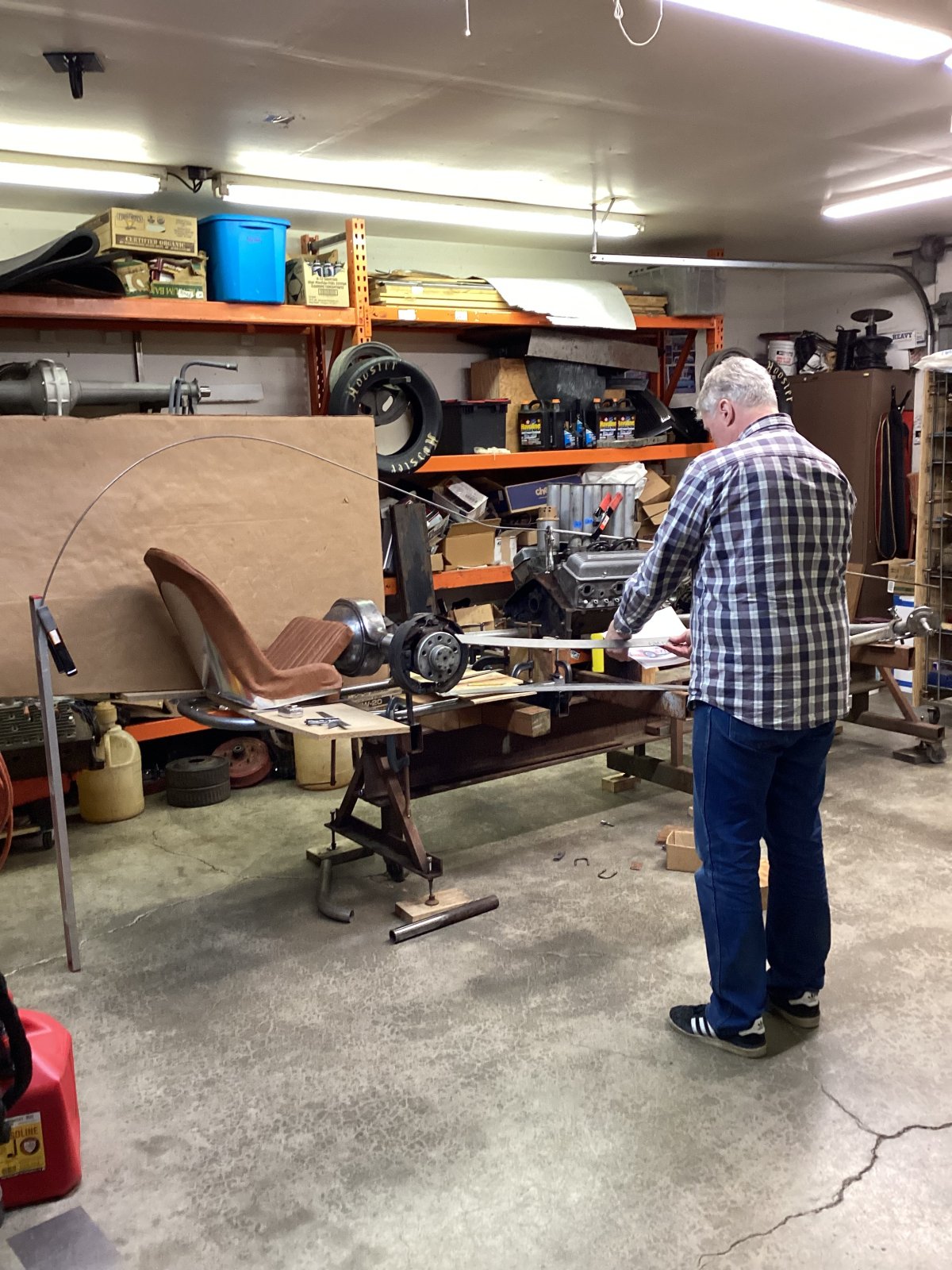

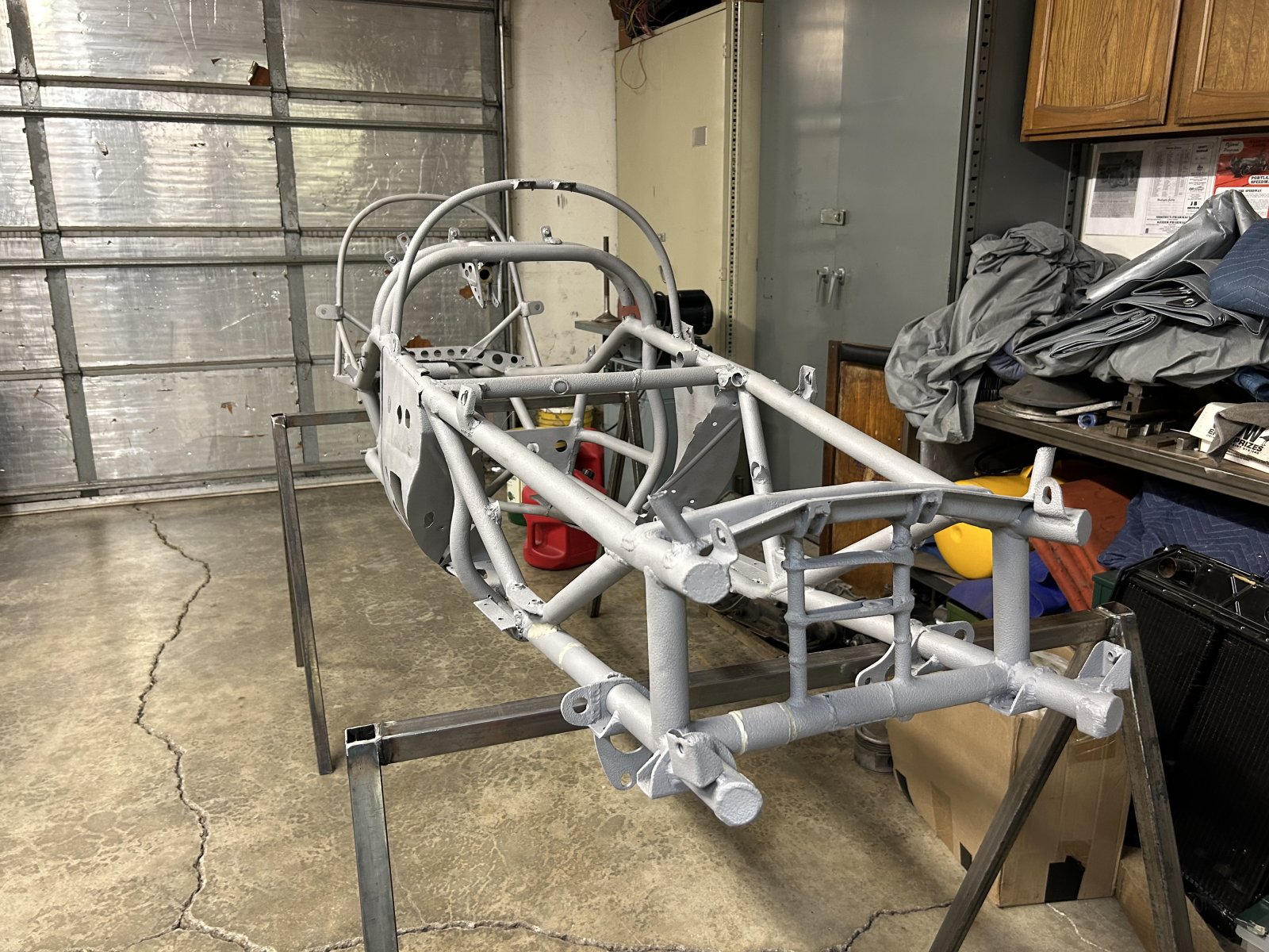

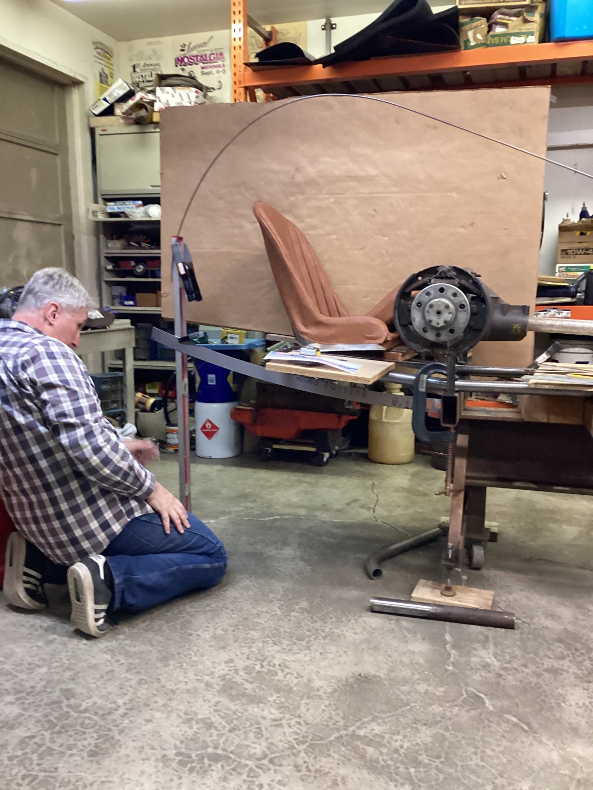

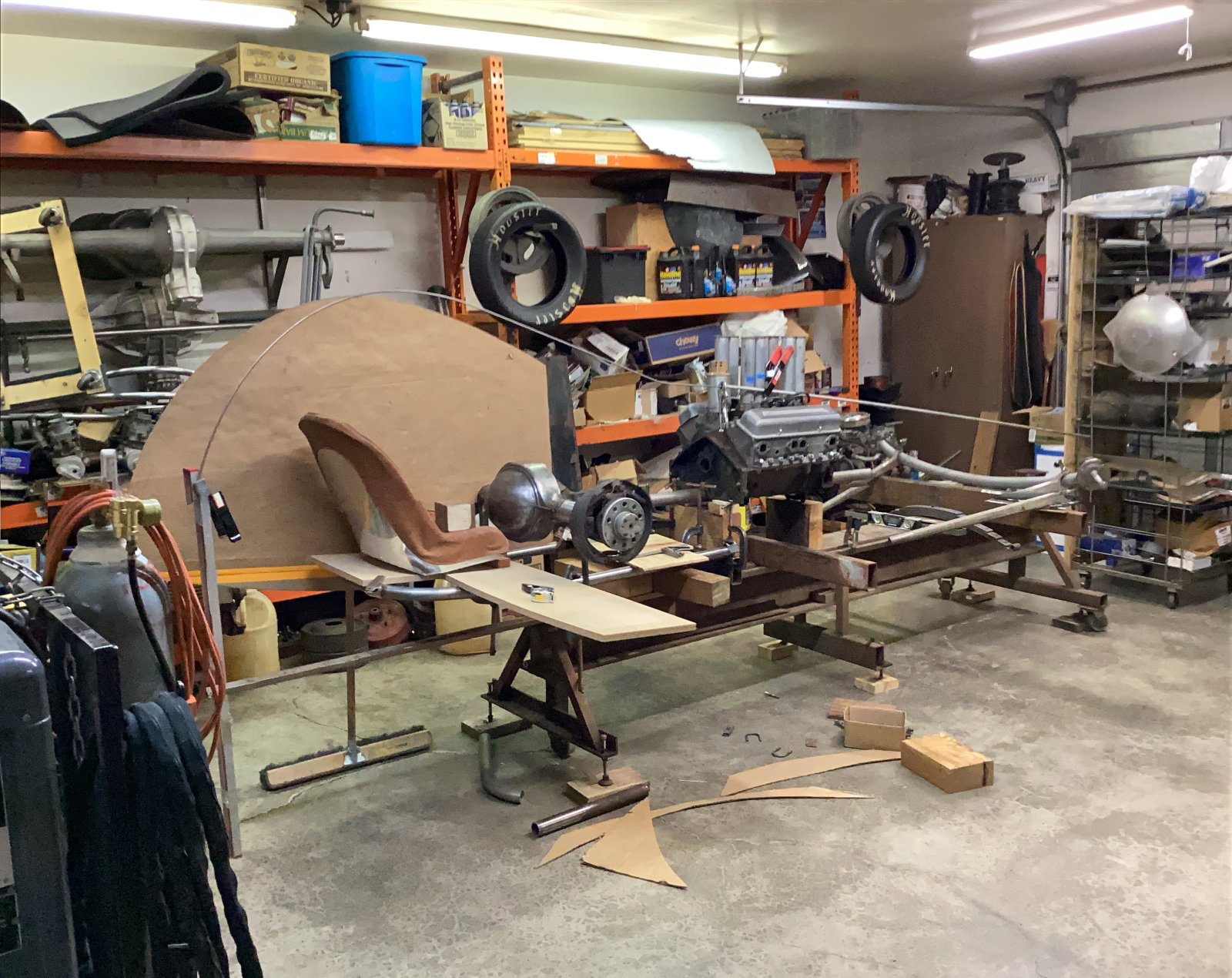

    Today, Chris Kopp came up to help me with placement of the seat, and get a rough idea of the profile of the car. We got close enough to set the shoulder hoop as well. Pretty happy with the shape. Also, I got a new ipad, for better picture quality ! IMG_0016.jpg IMG_0019.jpg IMG_0020.jpg IMG_0022.jpg IMG_0025.jpg IMG_0027.jpg IMG_0027.jpg IMG_0030.jpg

    Suggest you try it with helmet, fire suit & actual seat you will use. Last picture not much room above your head.

    Pics might be out of sequence…
  10. Larry Anderson
    Joined: Jul 15, 2013
    Posts: 317
    Larry Anderson
    Go back and take a look at the cockpit in the original. It’s pretty cozy unless you’ve got the build of a ball turret gunner.

    Mike, there will be plenty of shuffling of parts, and I will be sitting somewhat lower, as the seat will be an aluminum liner form fit to my rear. Just remember, this ain't my first rodeo, I started back in the 60's. Here is a shot from '68.

    Kinda looks like the focus was the shape and they were sneaking up on dimension.

  15. chriskopp
    Joined: Apr 21, 2014
    Posts: 17
    chriskopp
    We made good progress Marty.
    Getting a basic outline / silhouette of the body shape done gives you a template to work with towards the chassis dimensions. I’m pretty sure we can move or grow the body anyway direction you want for your comfort. Don’t forget we’re gonna put an escape hatch in the belly pan in case you can’t get out the top to satisfy the tech guys…
