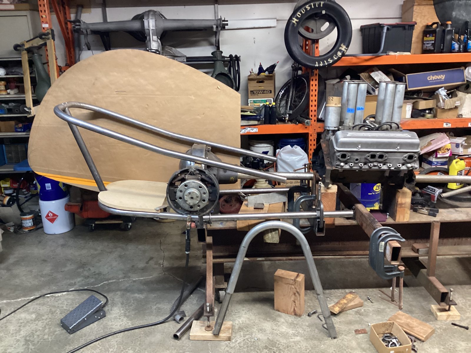

    The tubes I bent for the rear section, didn't come out the way I wanted, and I had to make some changes. the lower tube is now correct for length and shape, and I put together a mockup of the shoulder hoop, to check for fit, before bending the real product. I was also able to borrow some wheels and tires, for mockup as well. These are 10" wheels with 11.5 tires, I am still on the search for some solid Halibrand, 15X8, with 5 on 5" bolt circle. The tire will be 9" wide. IMG_0081.JPG IMG_0093.jpg IMG_0092.jpg IMG_0091.jpg IMG_0090.jpg

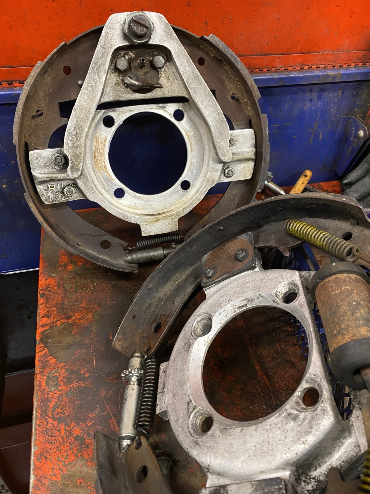

    I finally cleaned them to check for names. Found none. There is a 102 RH cast into both of mine. I guess I have two right handers (one has a rear wheel cylinder and one has a front), but it sure looks like they could fit on either side. The bolt pattern is the same as an early Ford spindle, but the casting at the top is in the way so a 37-41 spindle won't drop in there. Haven't tried a 48 spindle though. I bet they were made for use with the truck rear axle stubs, commonly also used on the fronts too. I'll have to dig even deeper to find one to try it on.

    Mine are like yours, but are drilled in the Later Ford 9" Big Bearing (1/2" bolts) pattern.
    I'm sure you're right about the truck spindles. That was the go to for the stock car boys.
    I'l have to look again for the numbers.
    brEad and Outback like this.

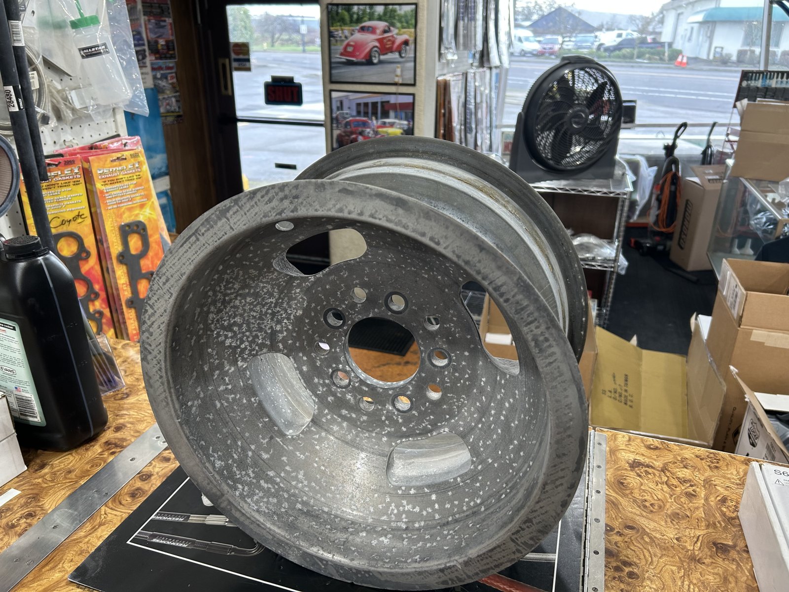

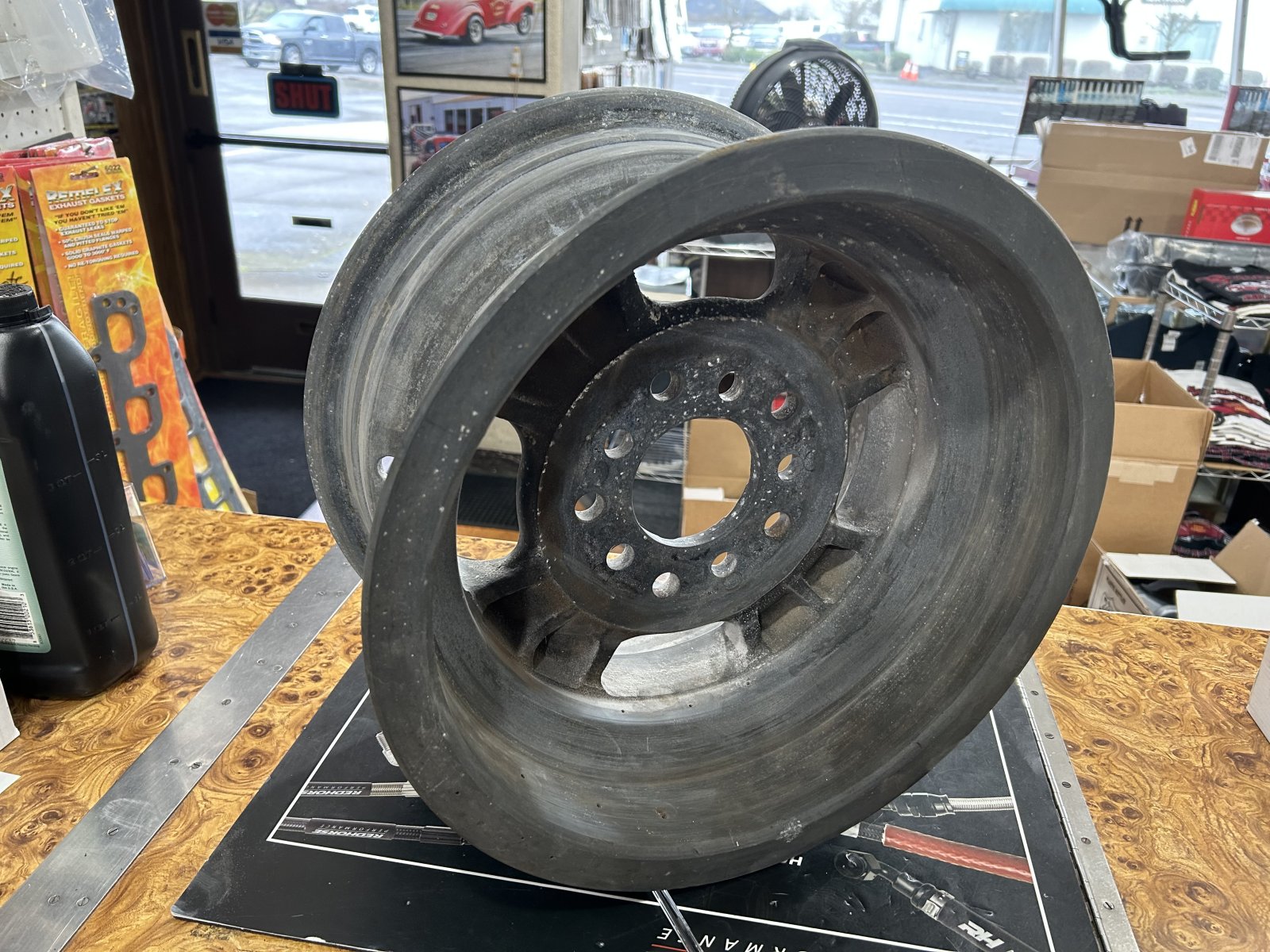

    I was able to make a deal on a pair of these Palimides, close enough for me. Like the ones I ran back in 1986 . IMG_1708.jpeg IMG_4519.jpeg

    R H does not mean right side. Frankland Engineering part number. Aluminum ones tended to break at the mounting holes. F E came out with steel ones. I have the open F E backers on several of my cars. I have 1 set to sell. HOT ROD Chassis-custom one of a kind. 006.jpg

    I’ve had some others in the past, and I do have a single steel one now too. It doesn’t have any numbers or brand on it either.
    That 48 spindle just barely fits in there.

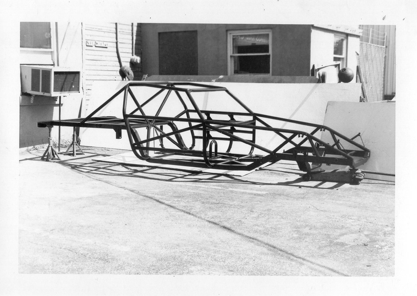

    I TIG welded all my super late model chassis much to the chagrin of the stock car racers. The left door bars and the main roll bars were mild steel. The upper nose bridge bar was.065" wall 4130. All the rest was .049" wall 4130. No flex chassis. A good example of how my cars handled 1990 img261.jpg NASCAR North Grand National race. Tom Rosati led for 164 laps and lost a cylinder. 36 laps on 7 cylinders. He won the race. Picture of my short track late model chassis.

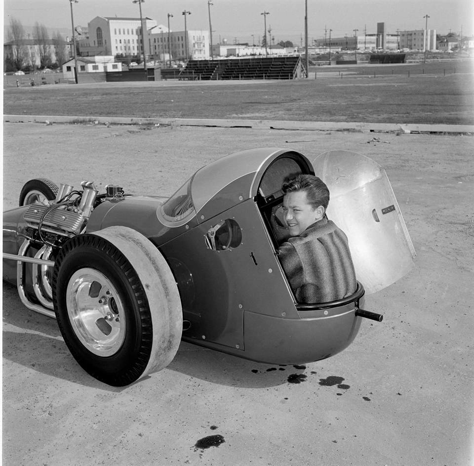

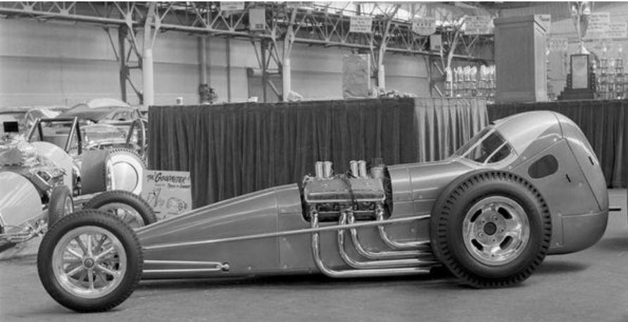

  24. Marty, the enclosed dragster belonged to Gary McArthur, and was named "Americas Most Beautiful Competition Car" at the 1960 Oakland Roadster Show. I t did indeed have Palimedes 4 slot rear wheels and was powered by a 461" Oldsmobile engine. The body was built by Jack Hagemann. It was a very good looking dragster.
    Mick
    bchctybob, brEad, The 39 guy and 3 others like this.
  25. Here's a couple shots of it at the Oakland show.
