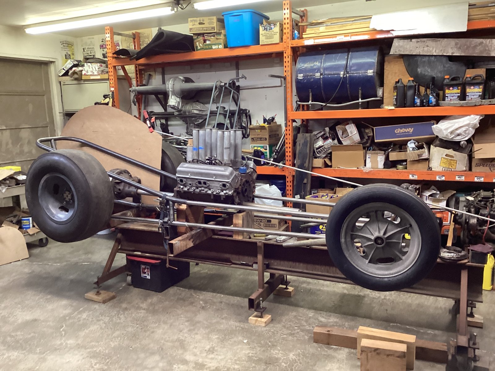

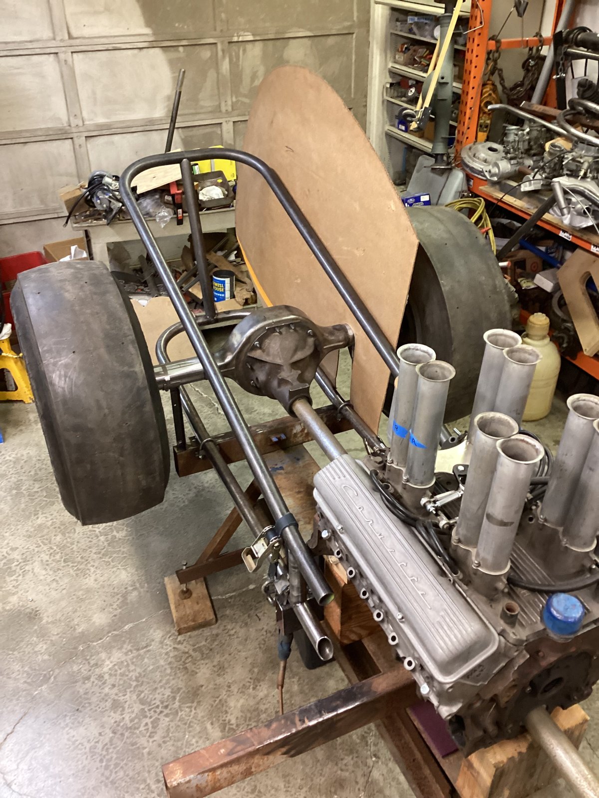

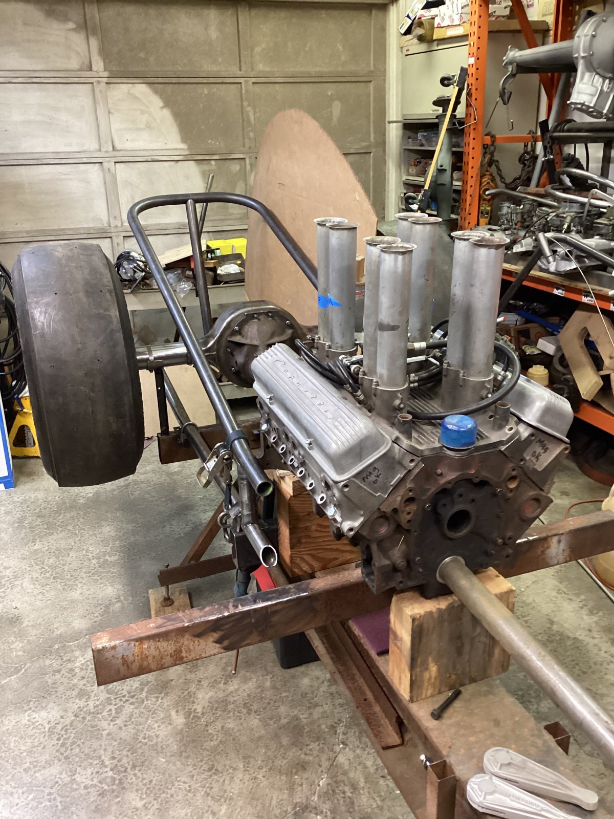

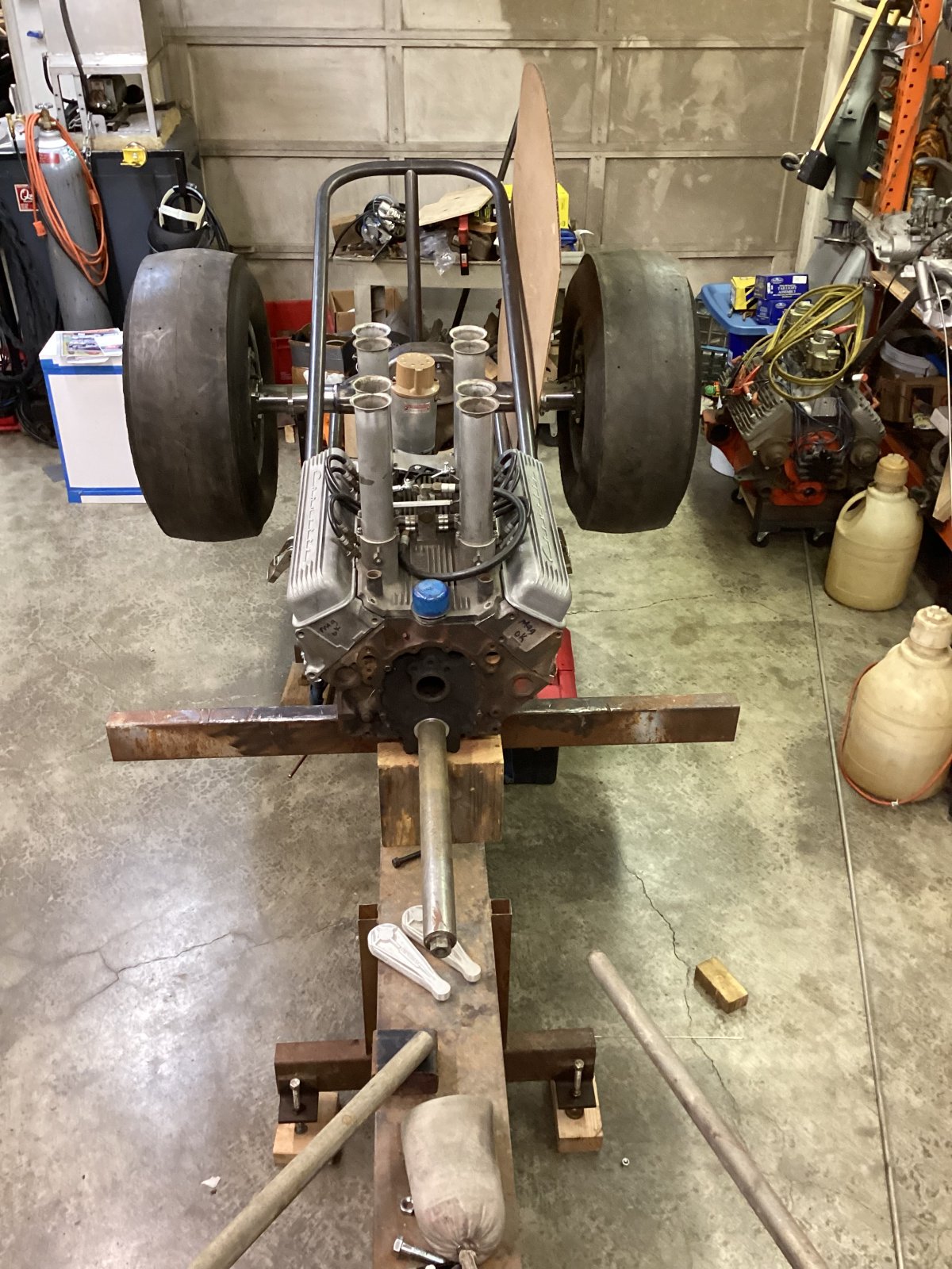

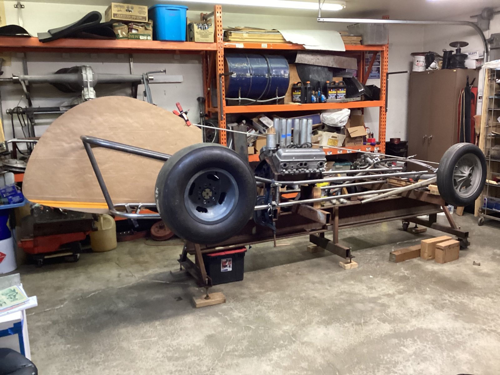

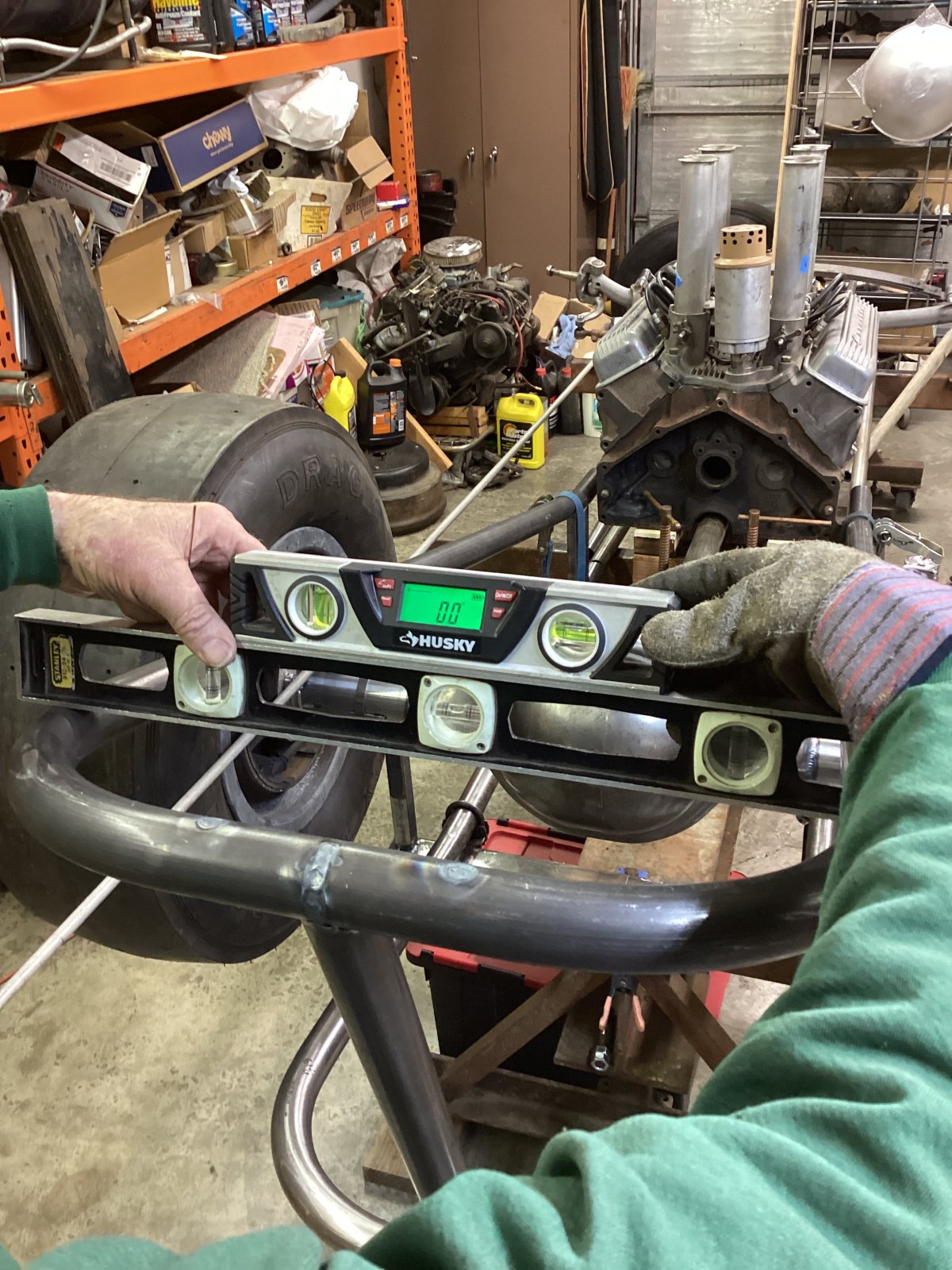

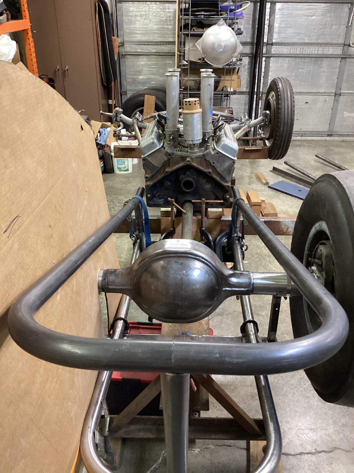

    Got a late start today, but got things racked up. I use Cool Mist for lube when notching tubes, to control the mess, fine sawdust works great. Since I am not an Engineer, and never make scale drawings of my projects, and while working alone, sections of tubing can be awkward to handle. In this case I made a guesstimate of the height of the the upright posts at the motorplate area. A couple modifications to get the correct angle for fit, I tacked them on, and was able to get the shoulder hoop in place temporarily. It was also a gamble on the bend angle at the front, where the front tubes will telescope. @chriskopp I will be looking for you on Thursday, to finalize the the front network of tubes to fit inside the nose section. IMG_0117.jpg IMG_0118.jpg IMG_0119.jpg IMG_0122.jpg IMG_0123.jpg IMG_0124.jpg IMG_0125.jpg IMG_0127.jpg

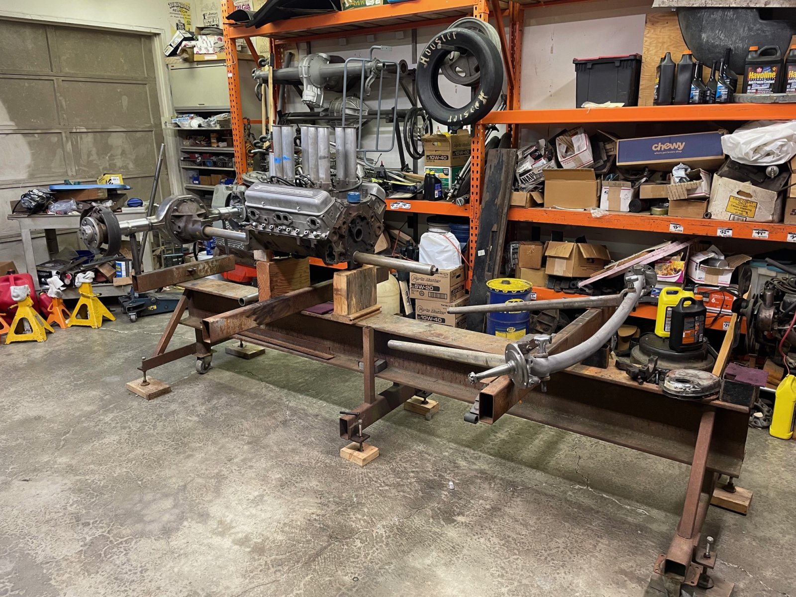

    Chris and I are going to start around 10, it's going to be a short day as we are only going to get the the the front tubes roughed in, for width at the nose. I am picking up a shorty Glide on Sat, so I can finalize the engine location. Also, I ordered a Strange steering box this morning, and need the other half of the pinion coupler. One of the next things will be figuring out what to use for radius rods, as the original had pretty long ones, around 42". 092. Vincent-Santos Top_Banana Famoso 3-60 Doug_Peterso (002).jpg
