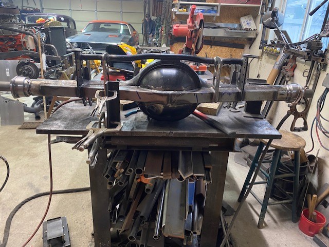

    Sounds like fun! Always a blast when it's a close race running side by side, hope that's the way it is when we go at it. Happy New Year to you as well. The car has new coat of paint, the 468 is done, just got finished with back brace on the rear today, housing ends tacked in place, waiting for new rear brakes and axles to arrive for a trial fit before final welding. Then there's the rest of the to do list, ugh! Take care, John

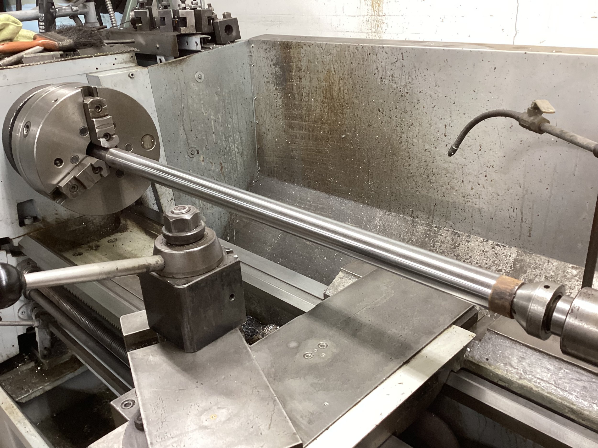

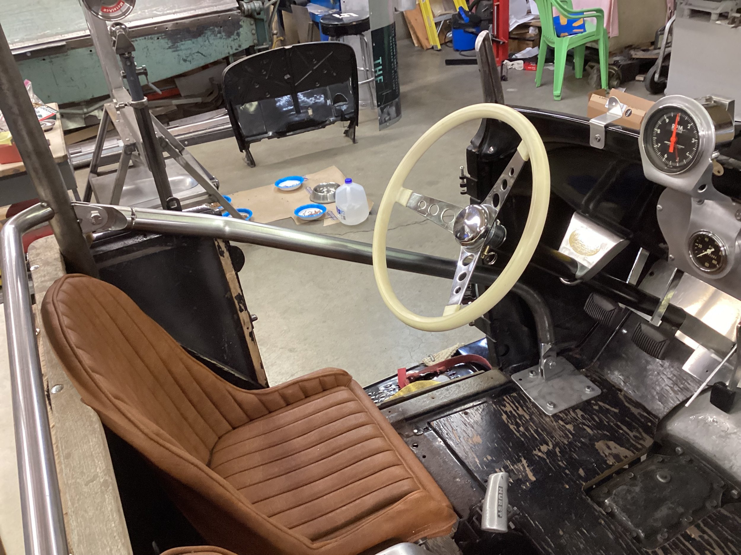

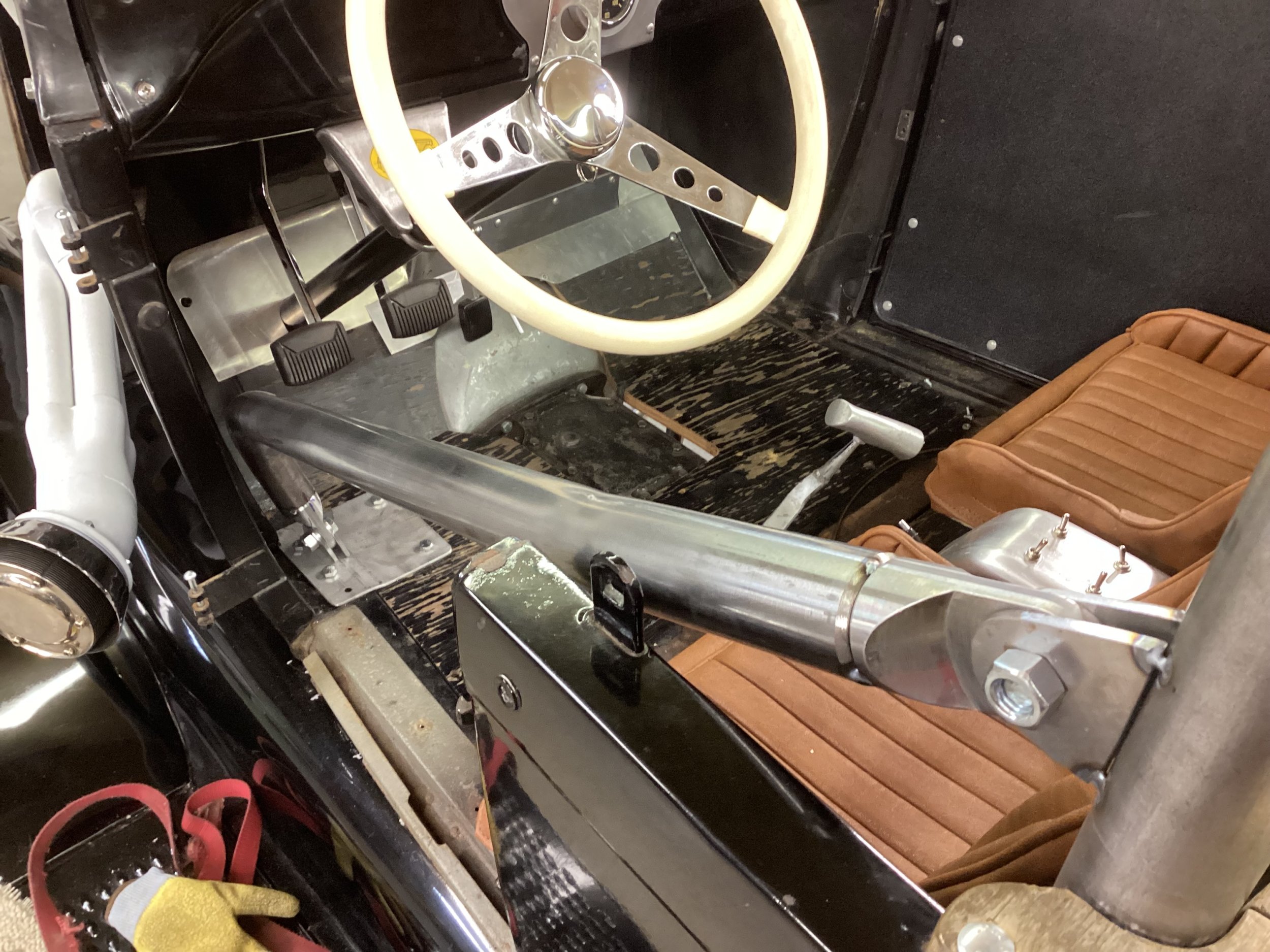

    I finally got around to installing the mandatory side bar. It's some of the same 1-3/4- .125 wall 4130 that I used on the rest of the bar. It was a little rusty, but I looped some Emery Cloth around it, and clamped it down under the tool post, and shined it up.

    Marty, what do the rules say about a floor mount? Just wondering if the plywood floors would be an issue? It looks great btw.

    Root, it has steel brackets on each side of the rail. On the side with the plywood there will be steel sleeves welded to the bottom of plate that reach through the plywood, for solid contact to the gusseted lower mount. I am also going to skin the plywood with aluminum, top and bottom.

    More importantly, ask him if he has ever done it by wrapping the emory cloth around the tubing and gripping it with a closed hand (thumb under tubing), I bet his answer would be............
    Only one time!

    I also learned to run the spindle in reverse to have the the tension on the cloth on the top. Big difference.

    Bruce, I just ran it manually.
