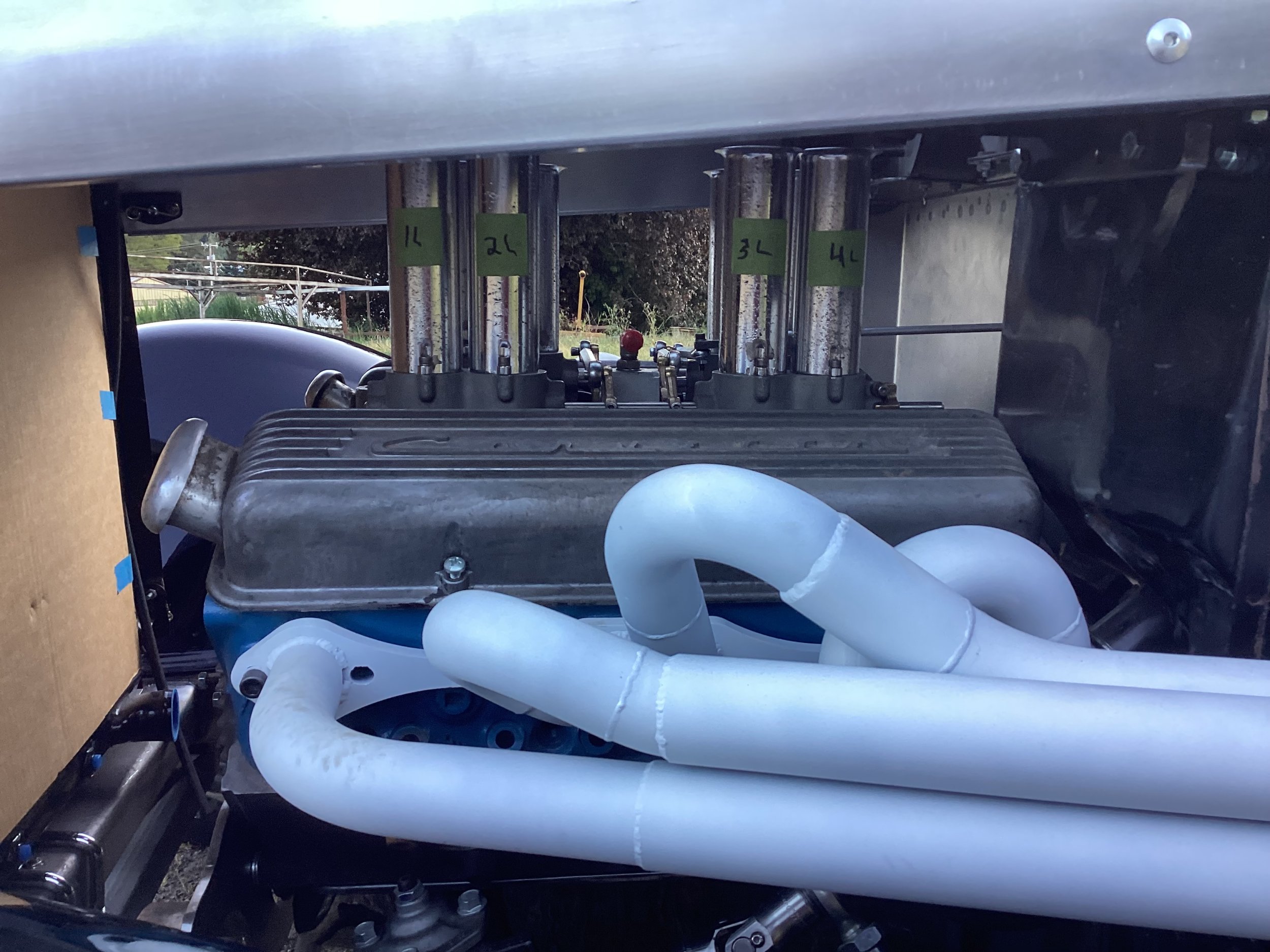

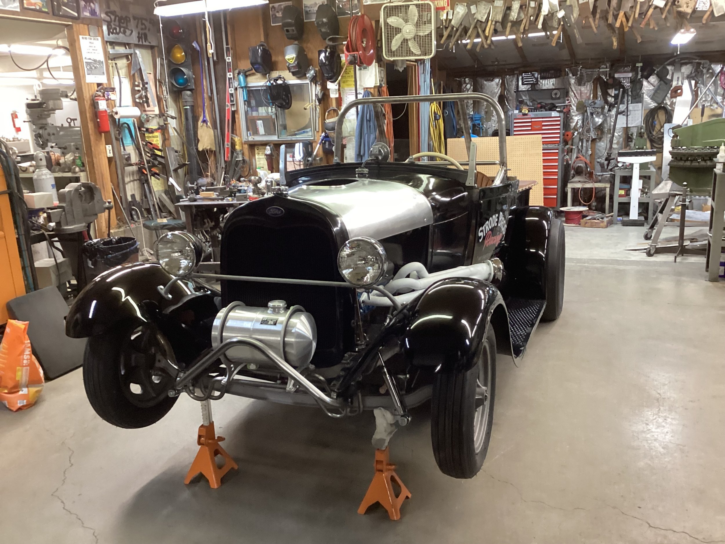

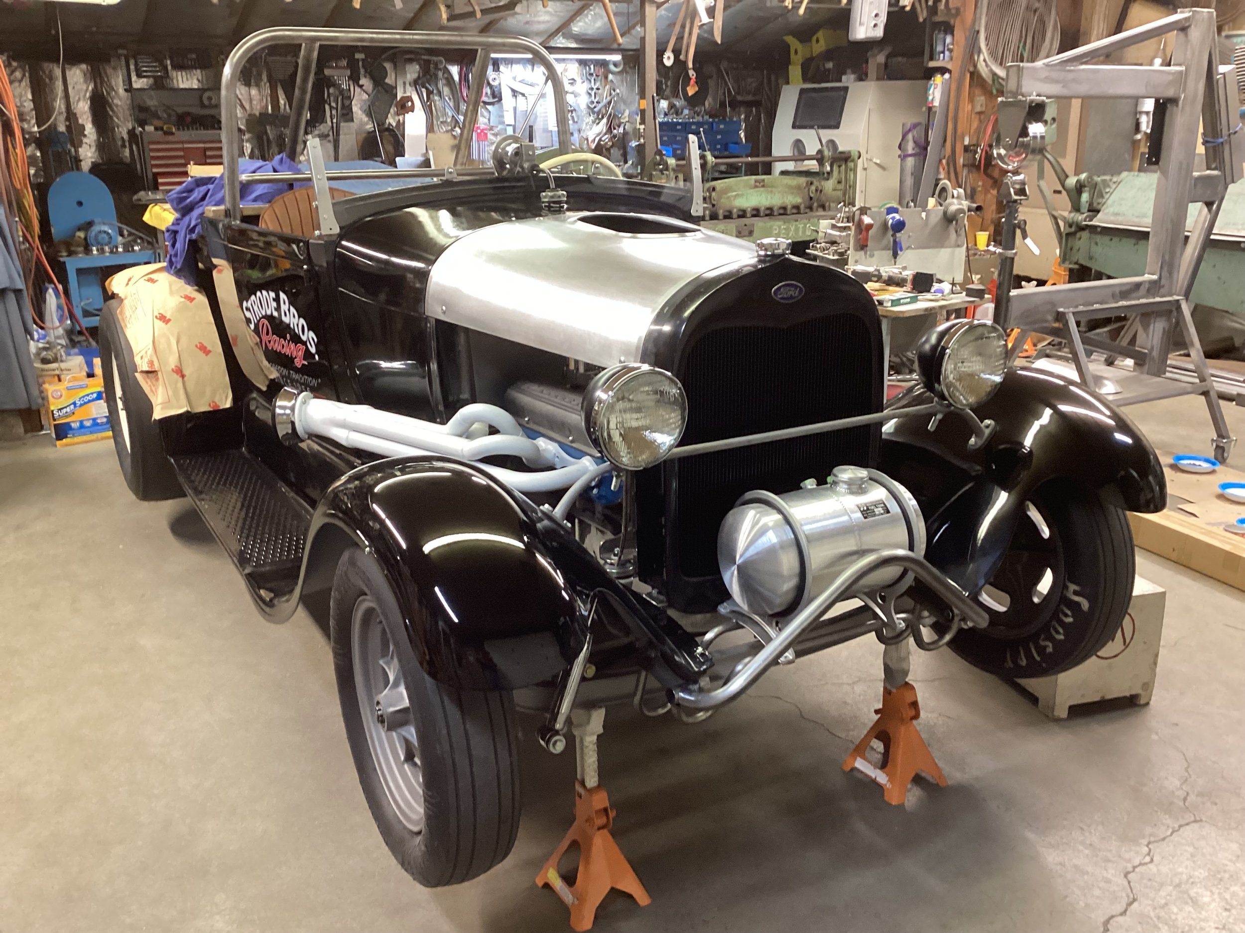

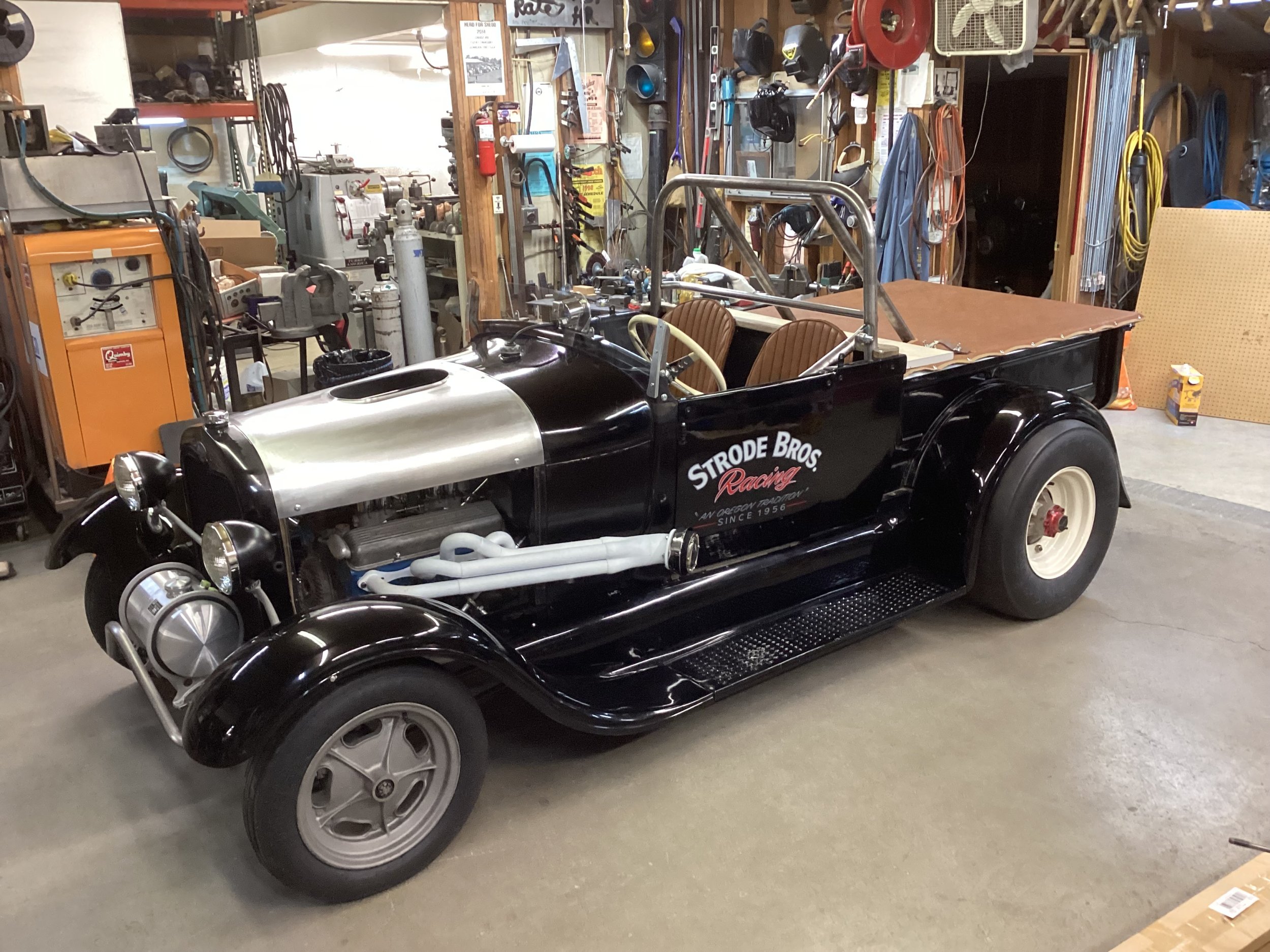

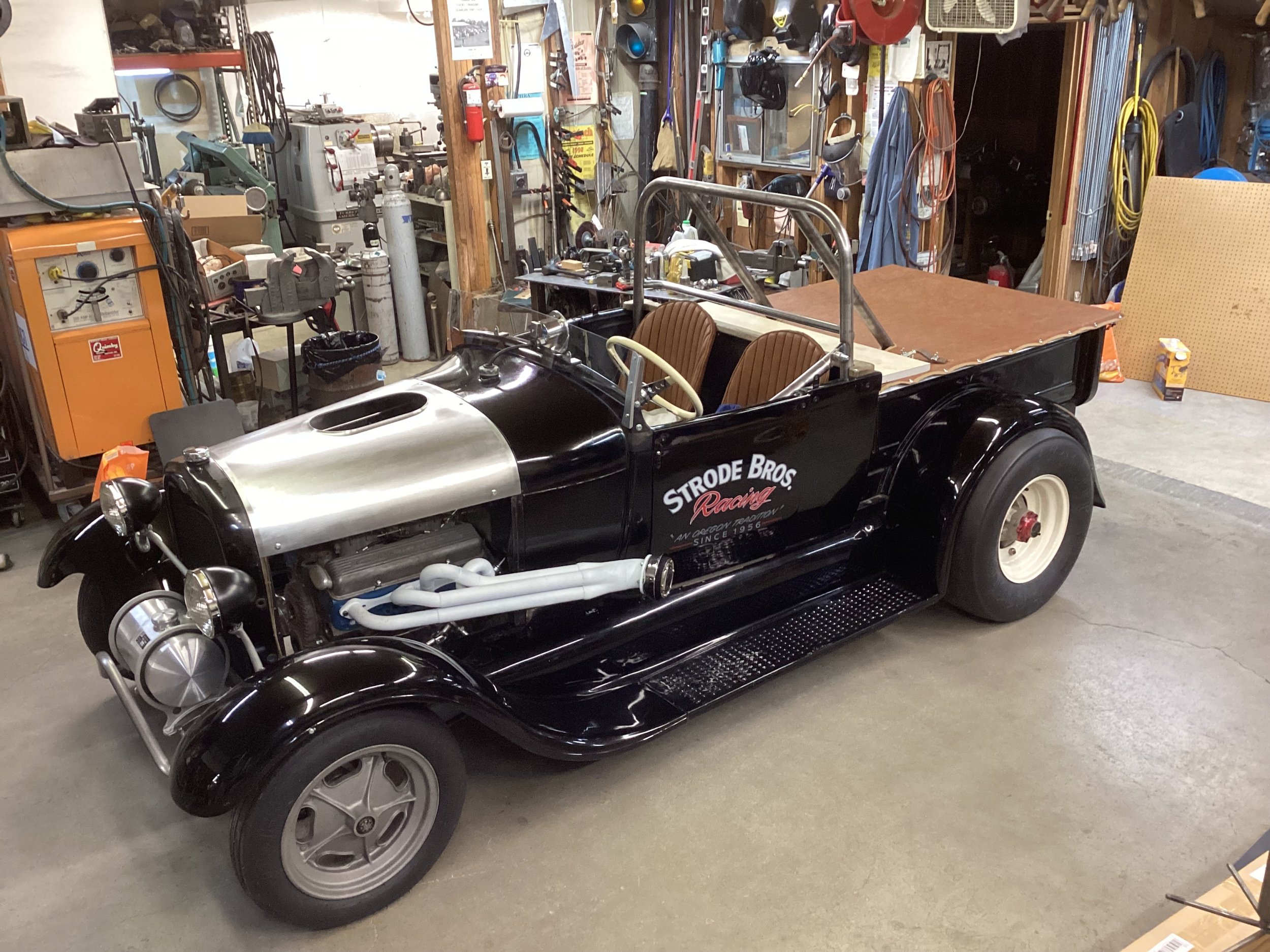

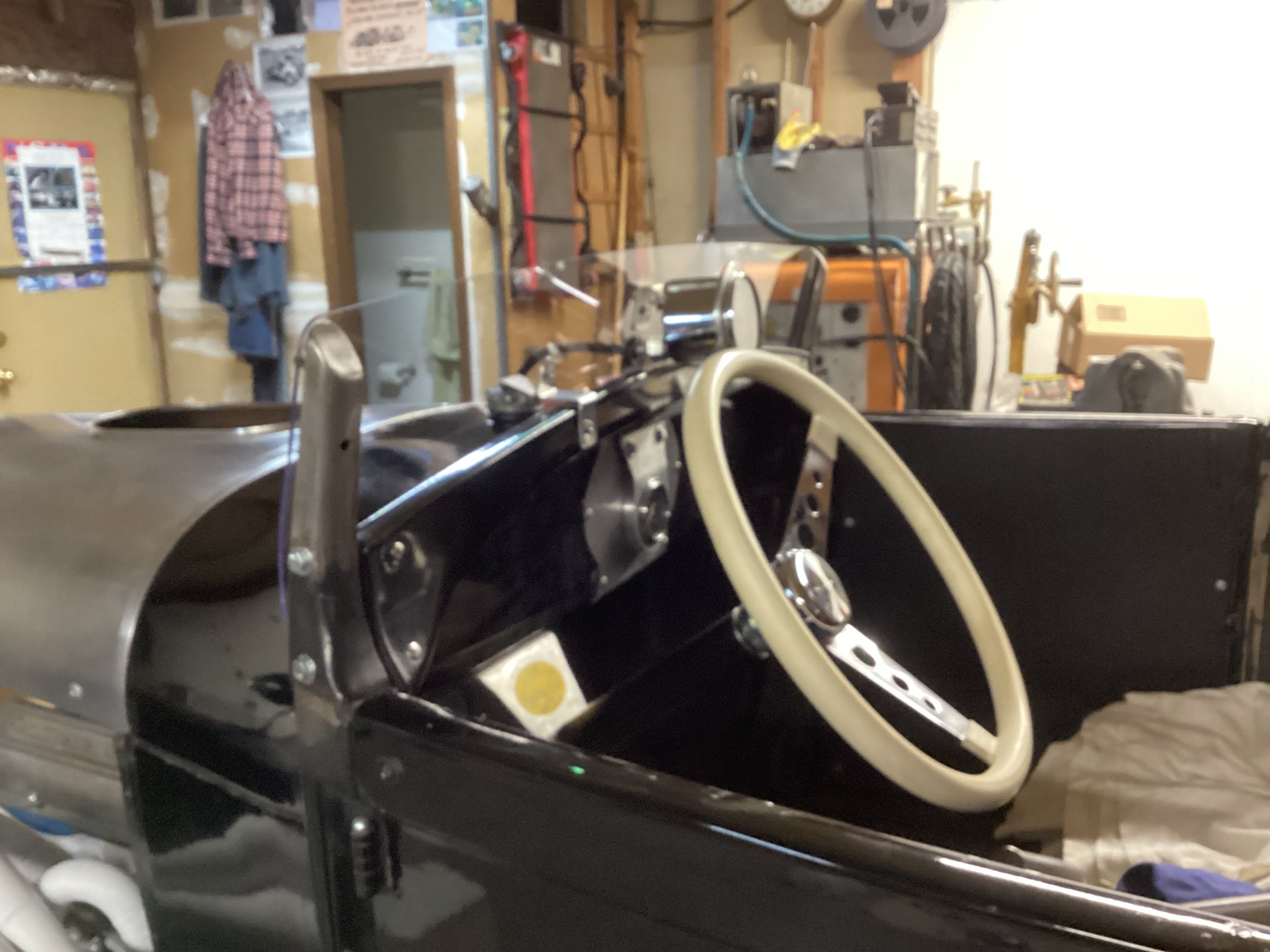

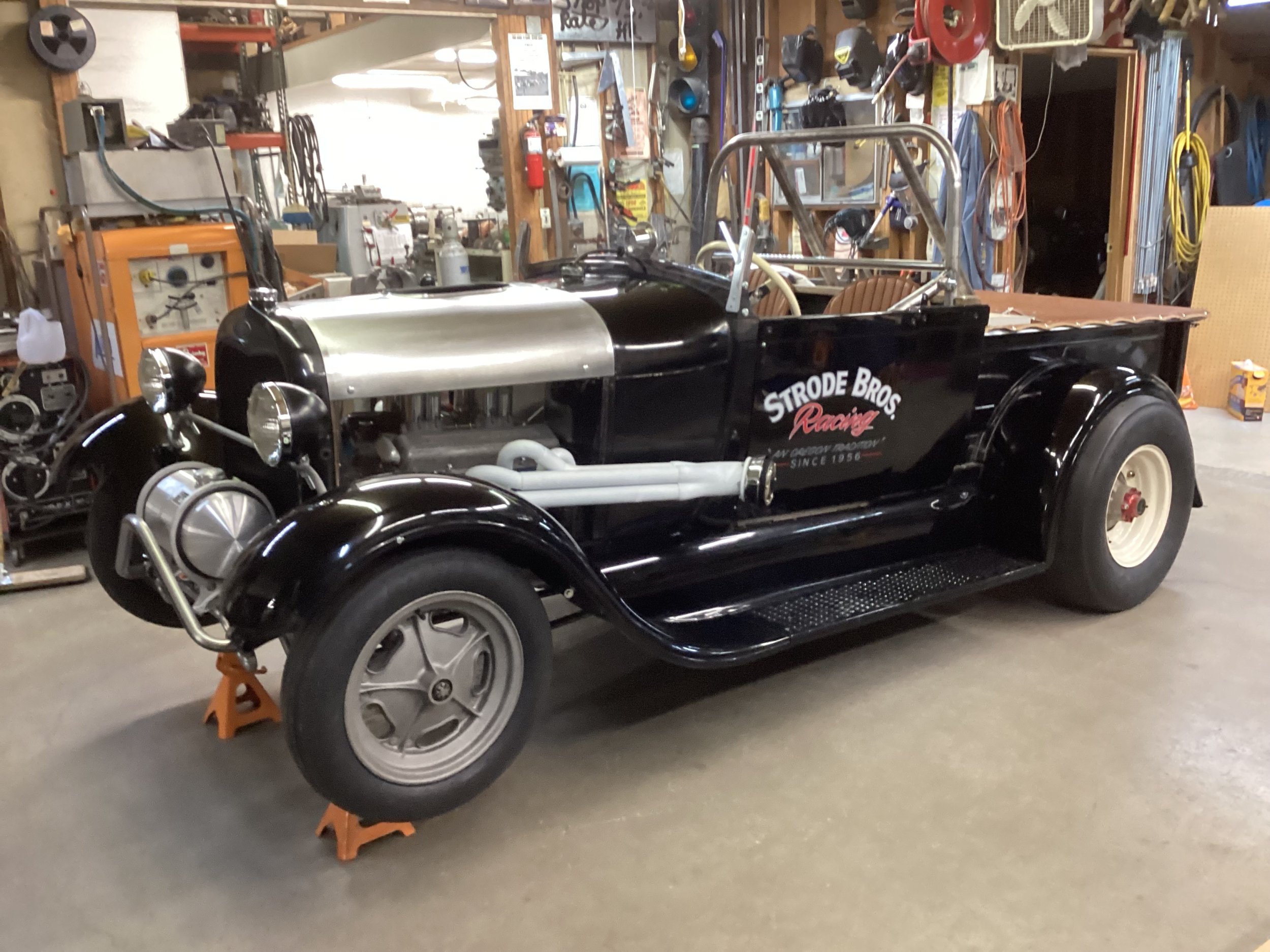

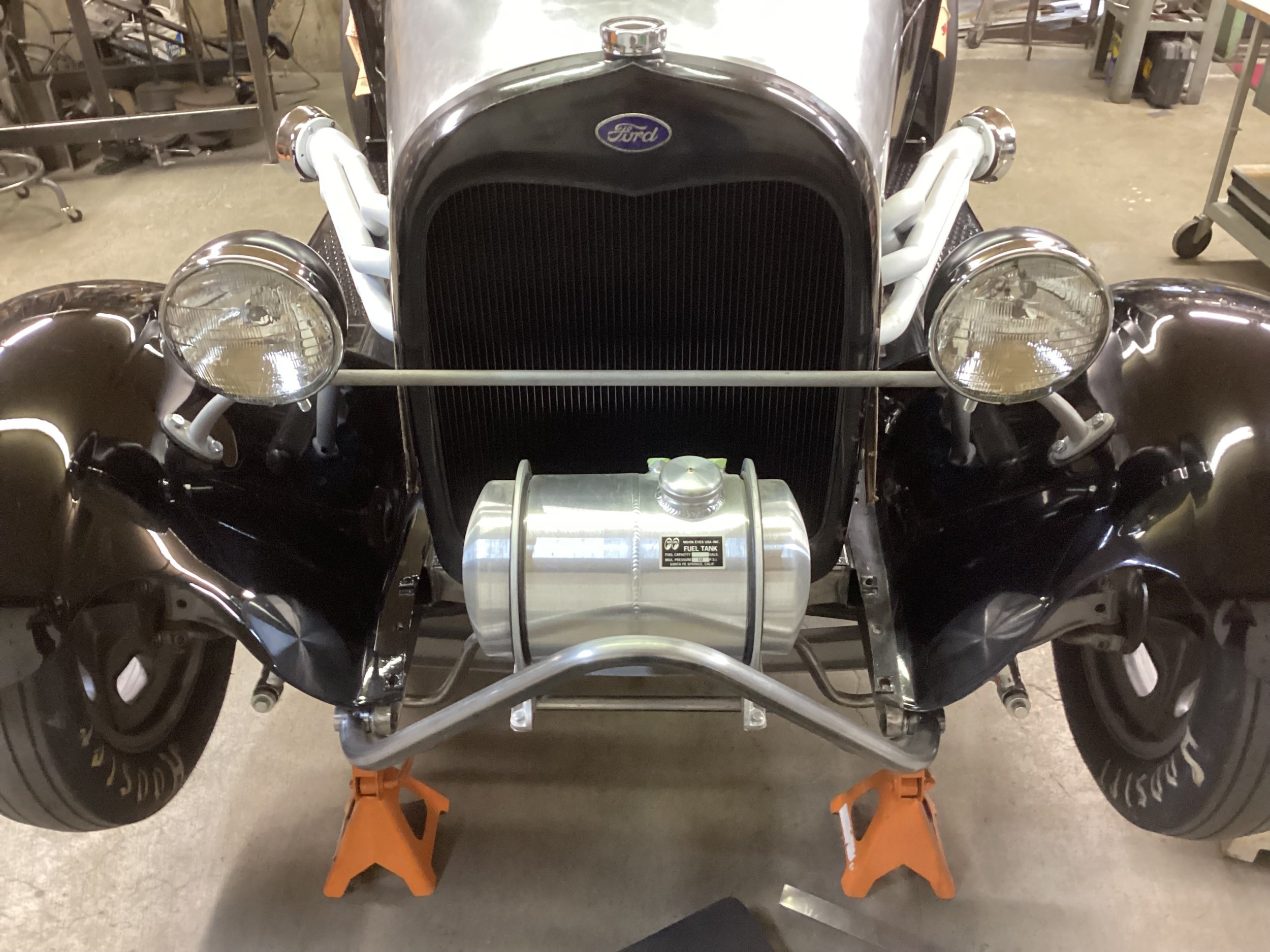

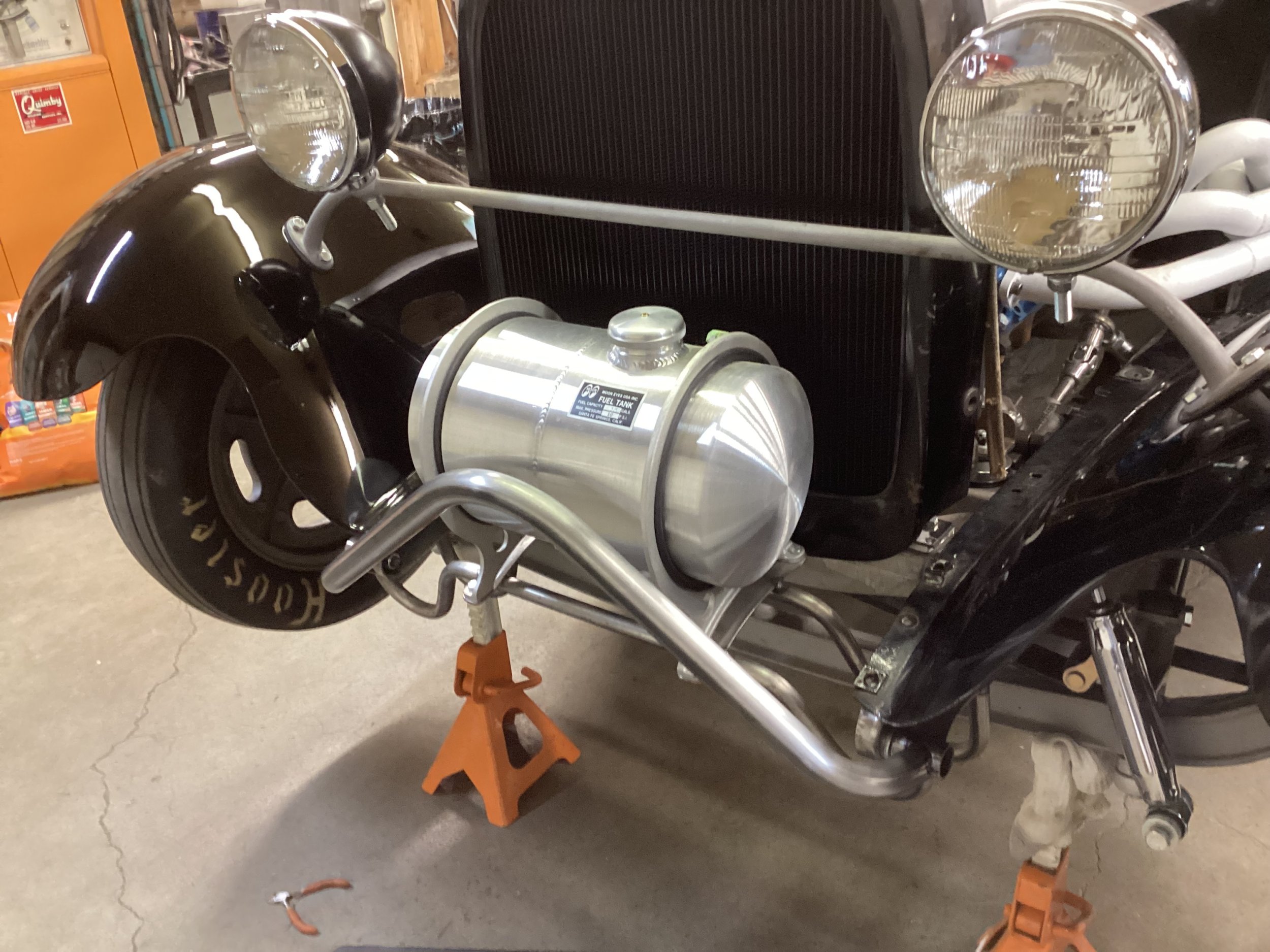

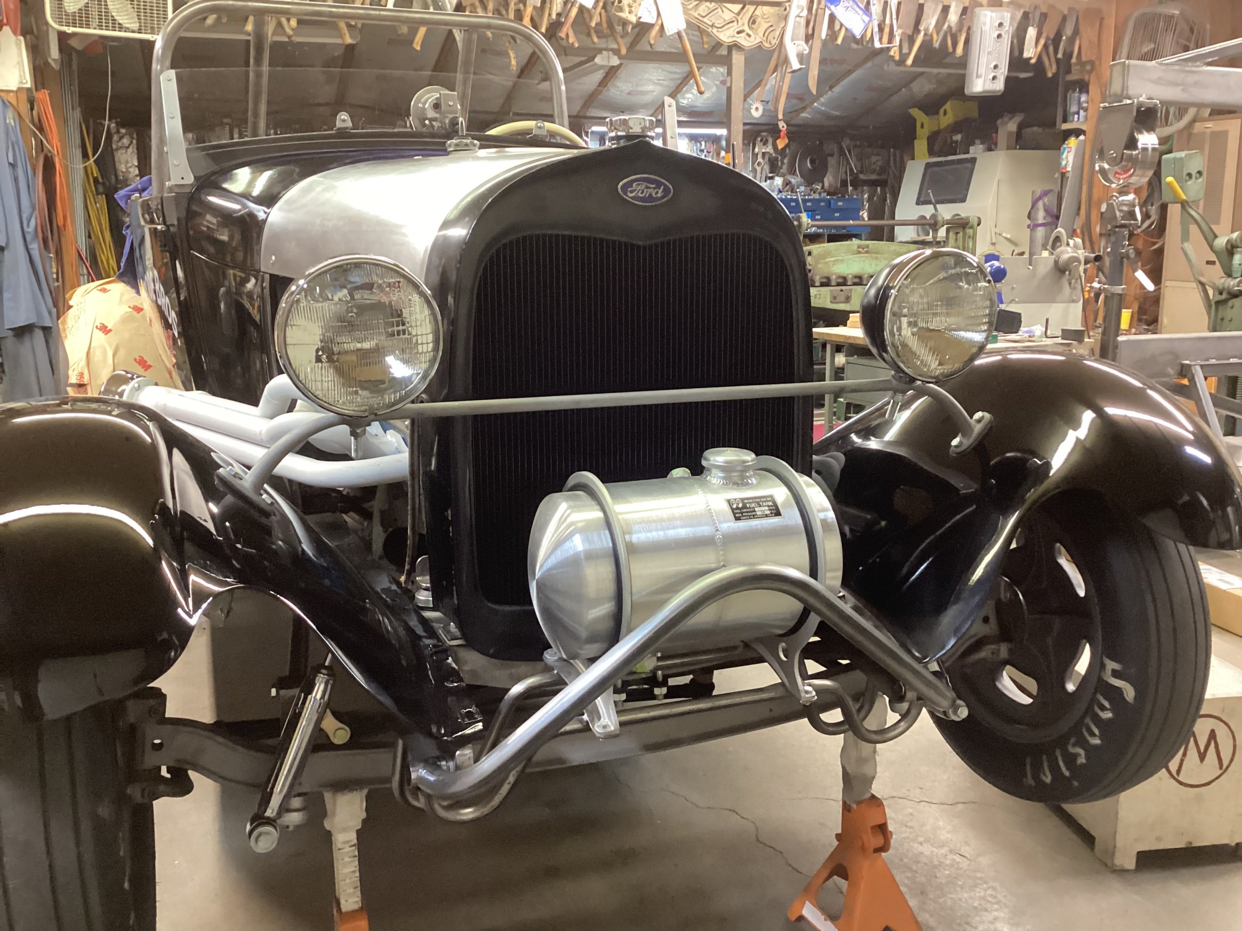

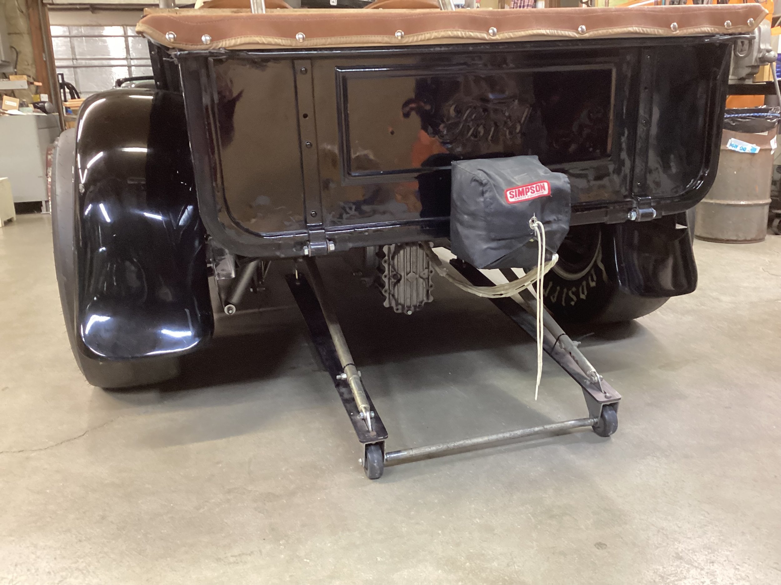

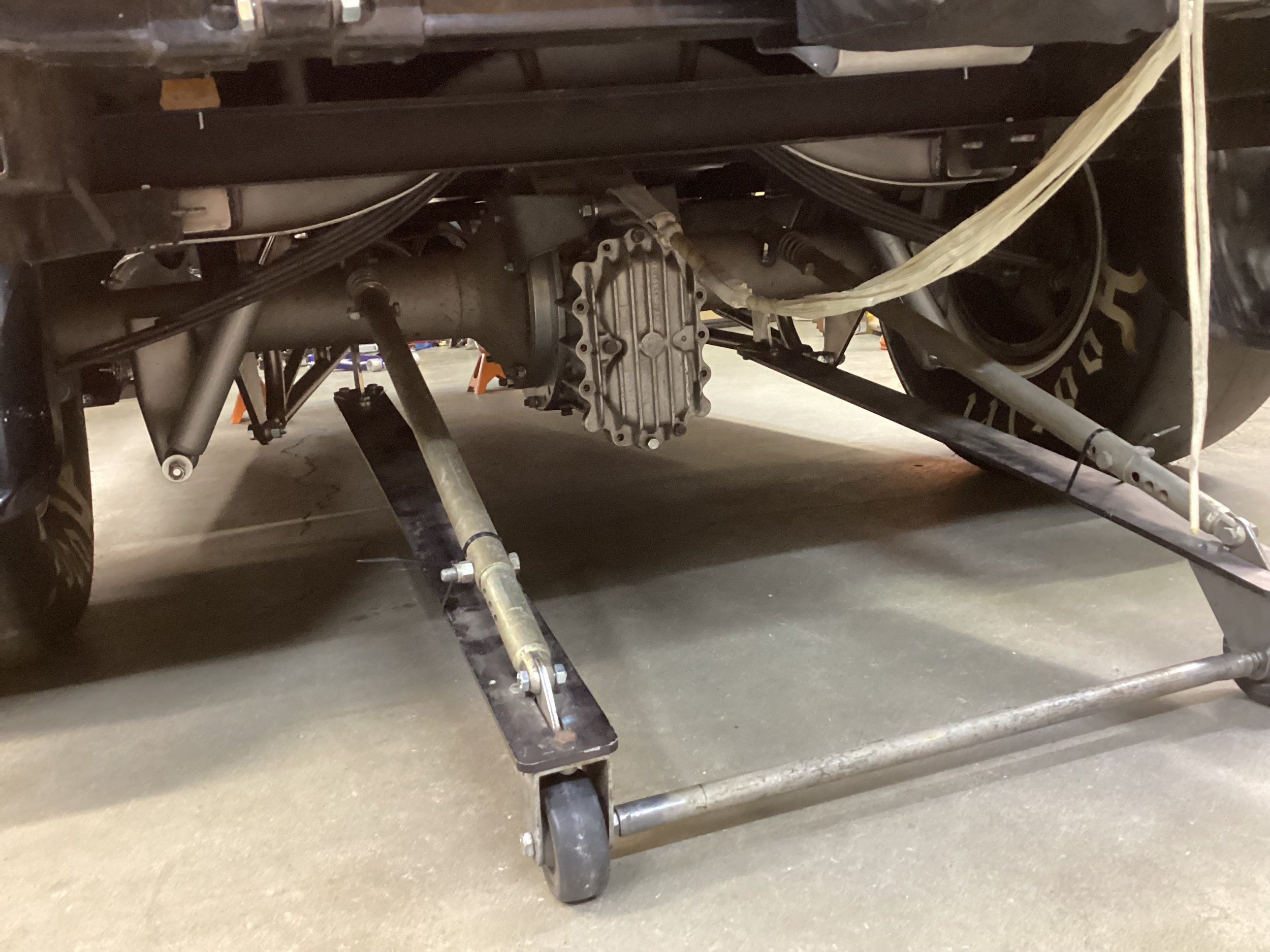

    With the construction pretty well done on my '29, I thought I might as well get it out in the natural light, so I could look at it one more time from all angles. I am getting ready to tear it apart for finish welding on the ch***is, and off to Powdercoat. I plan to electroless nickel plate the ladder bars, front hairpins and other under car pieces. Also, Karl Petersen is going to paint some of the body parts including the hood and cowl, to match the old paint. It's down to cam selection for the 331 Chevy. Still lots to do, but I want to run it this Summer !

    You may have seen this array of parts for my roadster, I'm really a fan of how electroless nickel looks, I hand prepped mine with Scotchbrite before sending it to the plater, has a soft satin finish.

    Doug, open wheel oval guys have been using it for years, I do like the look ! As far as running it, I am banking on July. I would like to take it and the Banana to Bakersfield in October to run !

    I like the front tank rack!

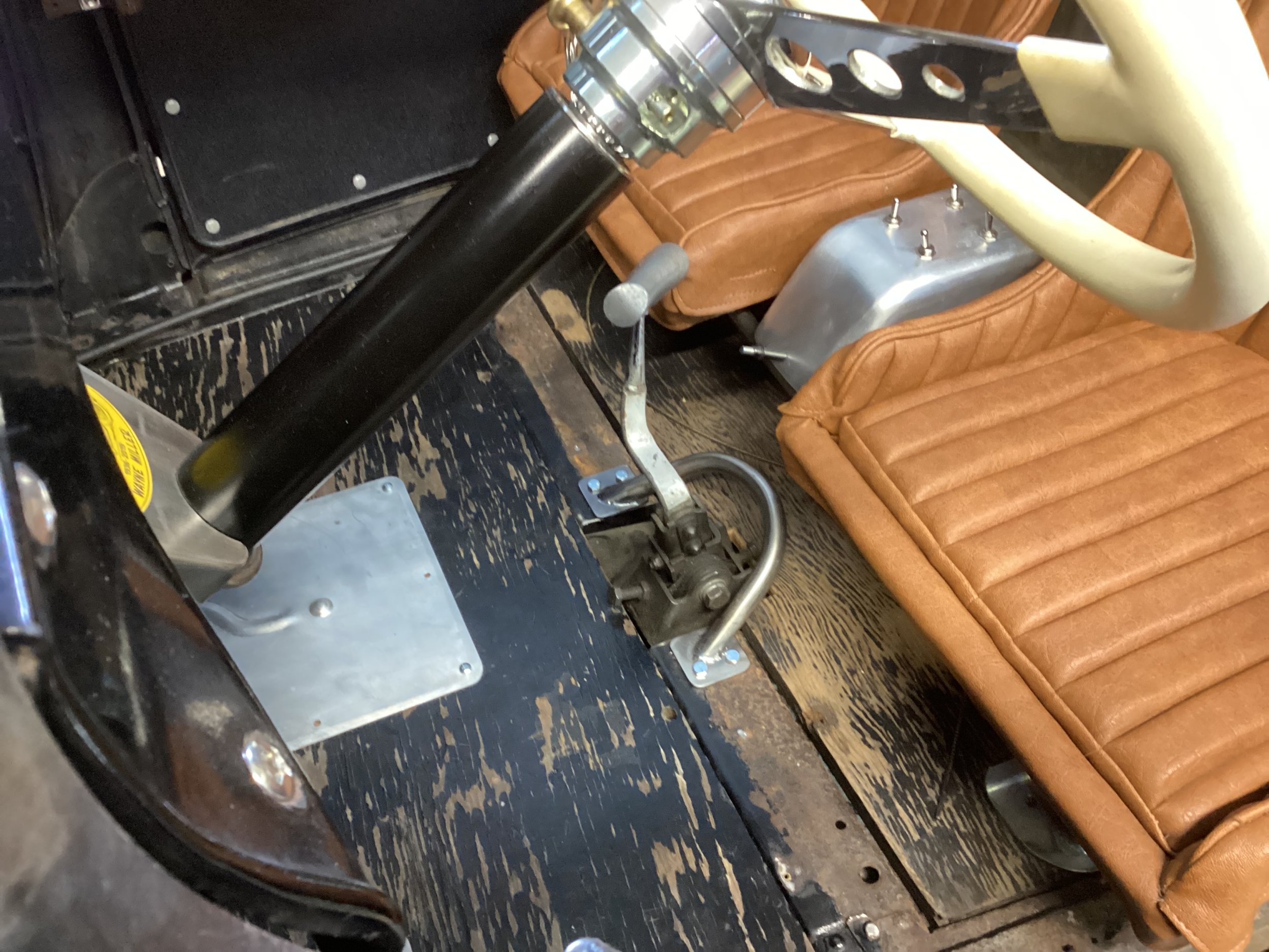

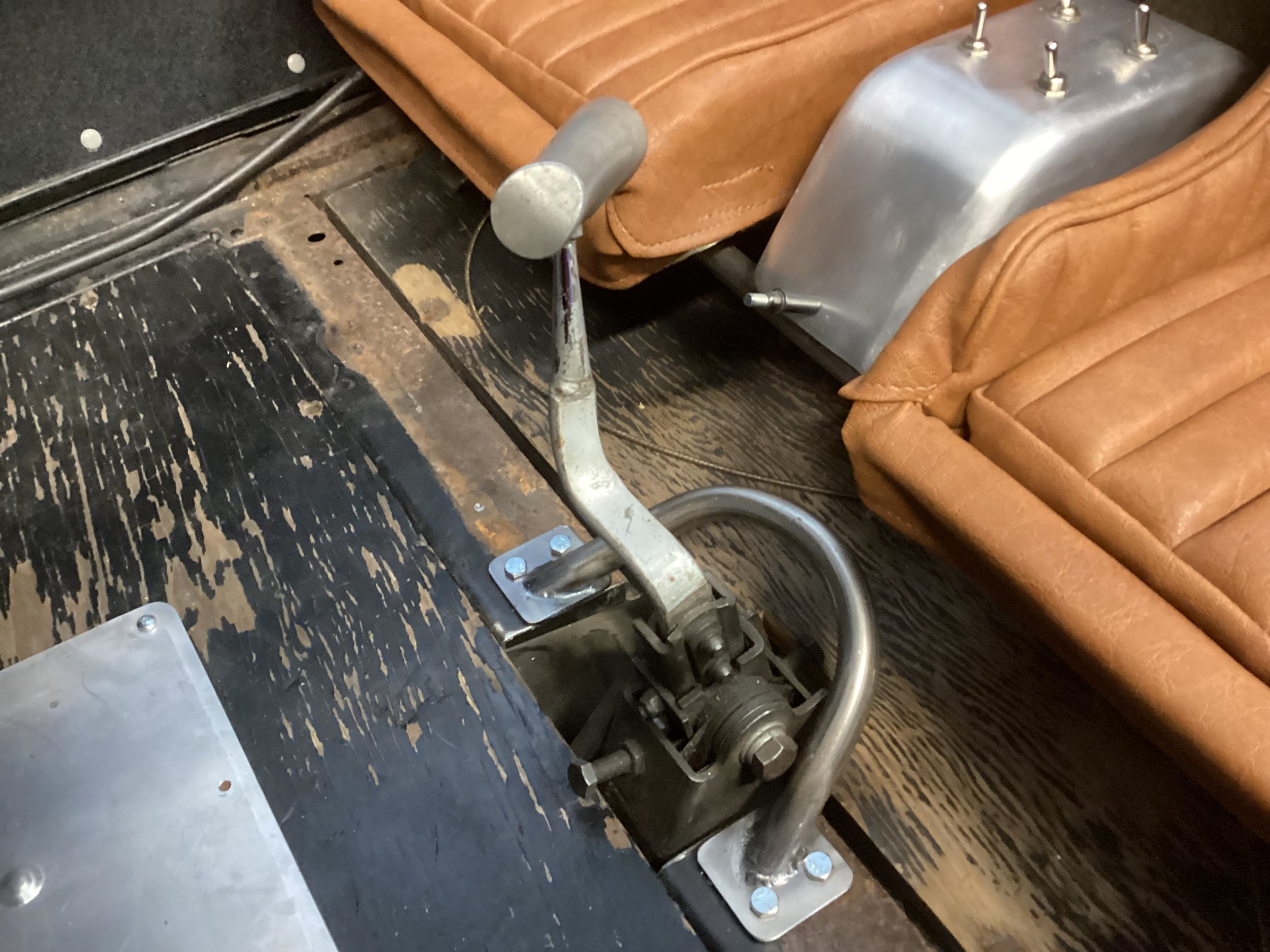

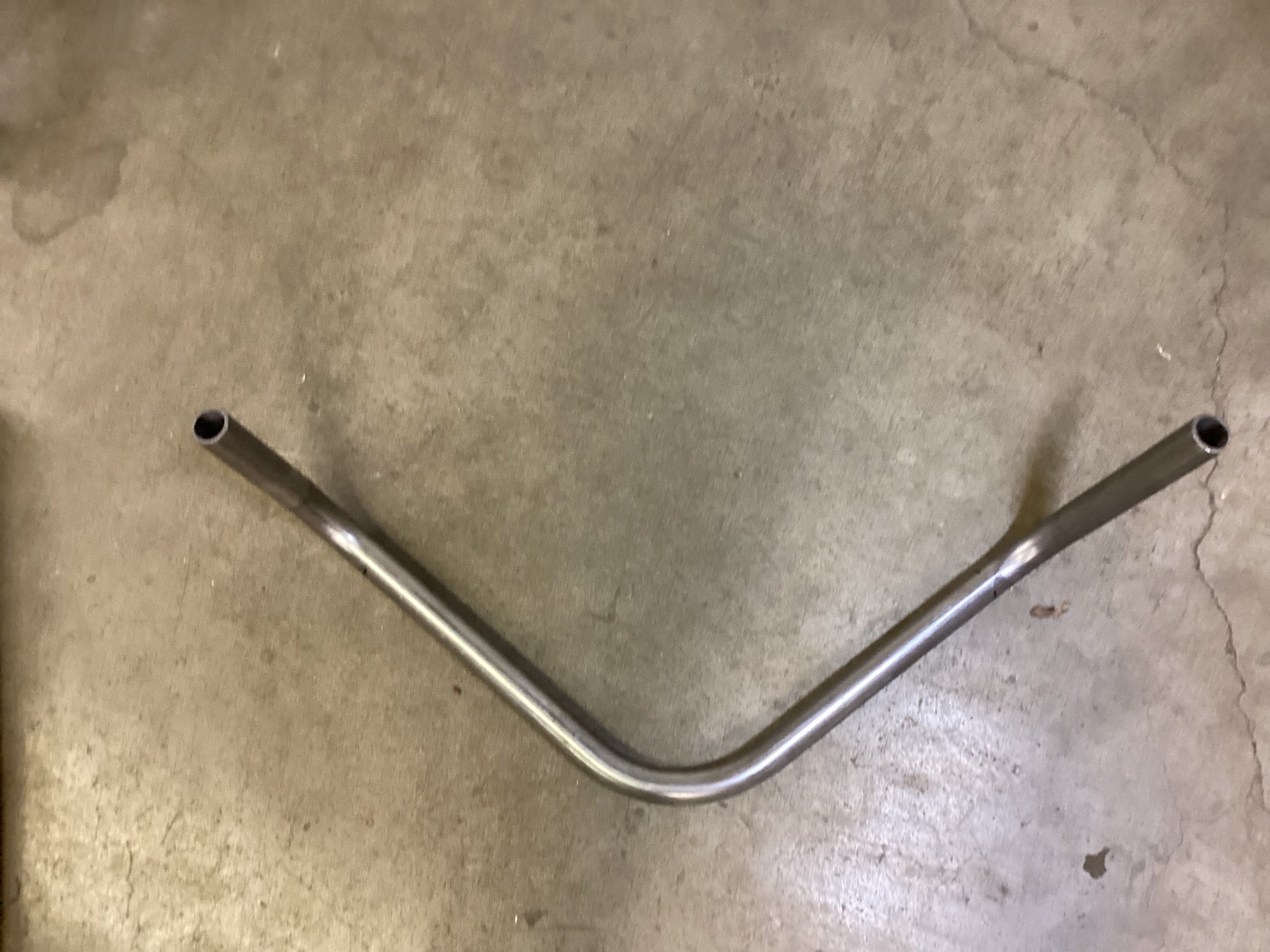

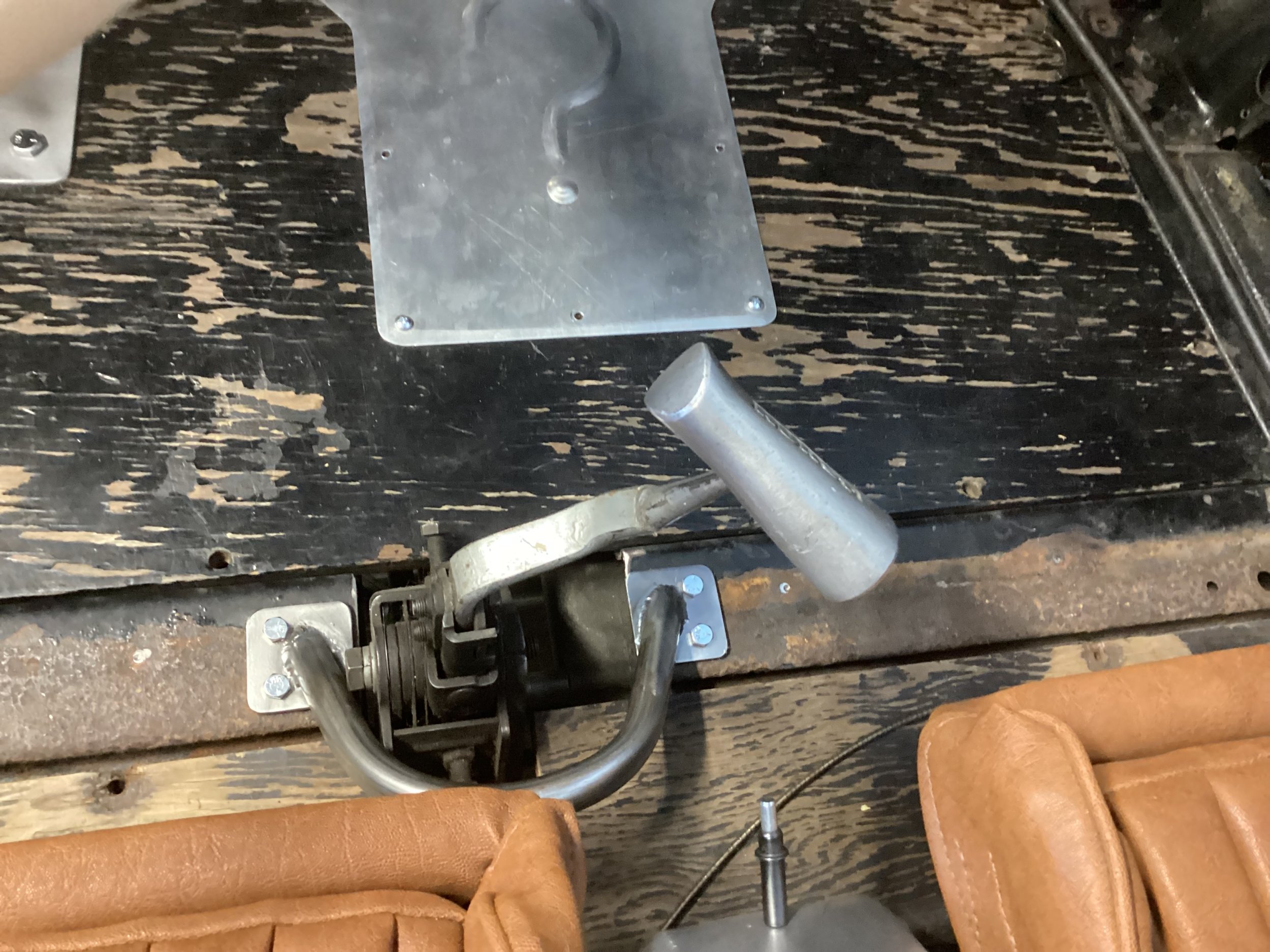

    Thank you my friends for the positive replies. You might get a kick out of my problem solving method. With the engine moved back and the Hurst Super Shifter on the Toploader, I needed to remove a section of the cross channel in the floor frame, so, I came up with this solution for support. I am going to have a thin, textured rubber mat covering the floor, so this tube will be bolted down on top of the rubber and exposed. It's a Race Car/Hotrod, not a Street Rod ! IMG_1544.jpg IMG_1543.jpg IMG_1542.jpg

    Inquisitive minds want to know what is hiding under that aluminium cover.

    I do remember them, it a 2.78 1st gear Toploader, that I last shifted 50 years ago, in my Altered Roadster.
