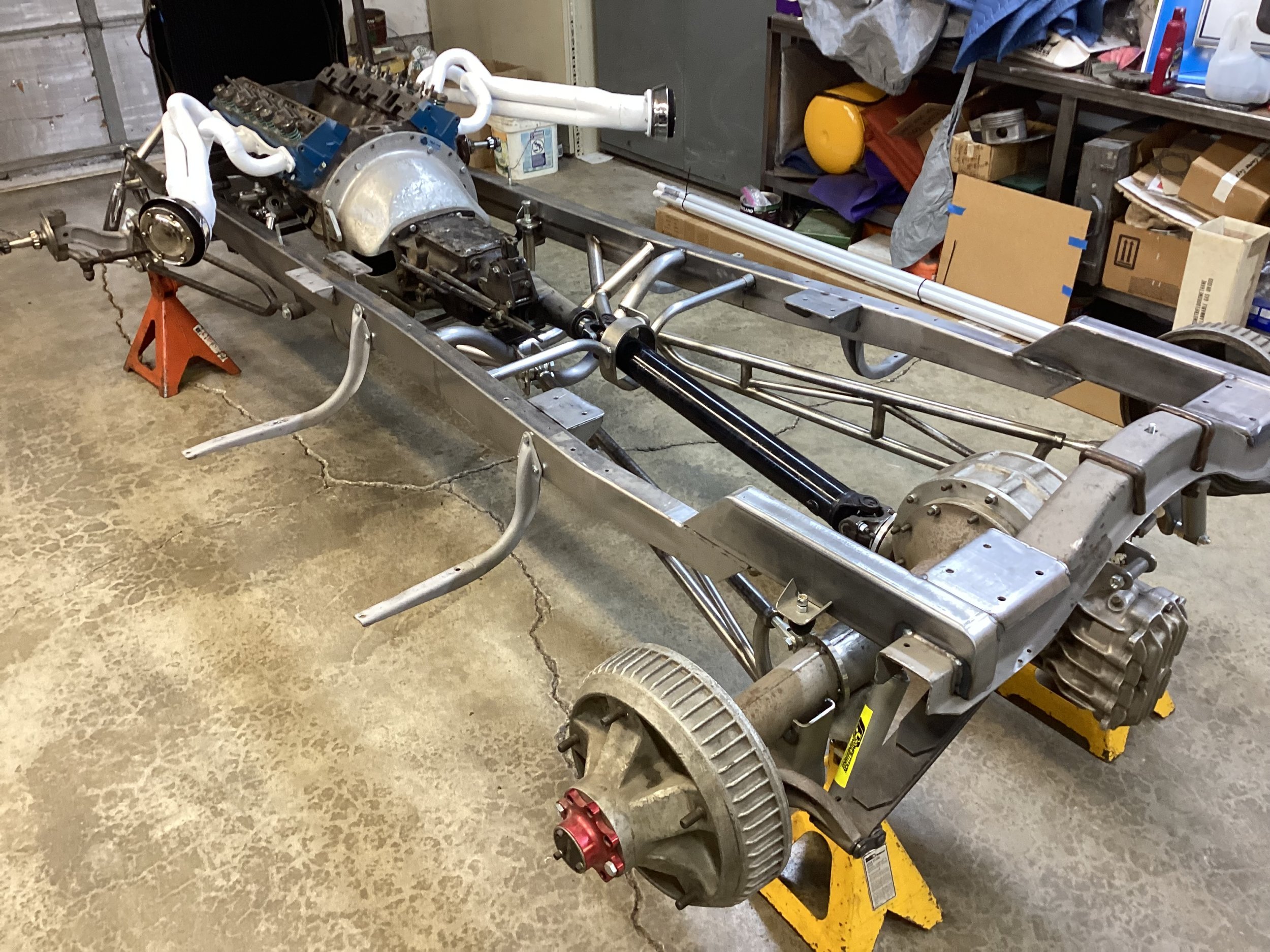

  10. Marty Strode
    Joined: Apr 28, 2011
    Posts: 9,710
    Marty Strode
    I stopped by to see my friends at DVC Machine, Dennis and Dave are doing a great job on the 327 for the RPU. It is a culmination of parts from friends and family. The block was given to me by John Rigert, a std bore 1966-275 HP. The crankshaft was out of a stash of parts from my late friend Frank Lynch. Dave decked and bored it .030 to fit the Keith Black pistons, and re-conditioned a set of rods. After balancing the ***embly, Dennis installed a Schneider solid, flat tappet cam, 1.6 rockers, and a set of Edelbrock heads, all from a couple of engines my brother Jerry owned and raced. It will be topped off with a fresh Hilborn Injection and a Vertex Magneto. It should carry the little truck to 7 flat in the 1/8th and 11 flat in the 1/4. Now to take it totally apart to powdercoat the ch***is.

  11. Marty Strode
    Posts: 9,710
    Marty Strode
    I took the truck apart for ch***is welding, and then it's off to sandblast and powdercoat. IMG_1673.jpg IMG_1672.jpg IMG_1668.jpg IMG_1669.jpg IMG_1670.jpg IMG_1671.jpg IMG_1666.jpg IMG_1665.jpg IMG_1667.jpg IMG_1664.jpg IMG_1662.jpg

  13. tomcat11
    Joined: Mar 31, 2010
    Posts: 1,149
    tomcat11

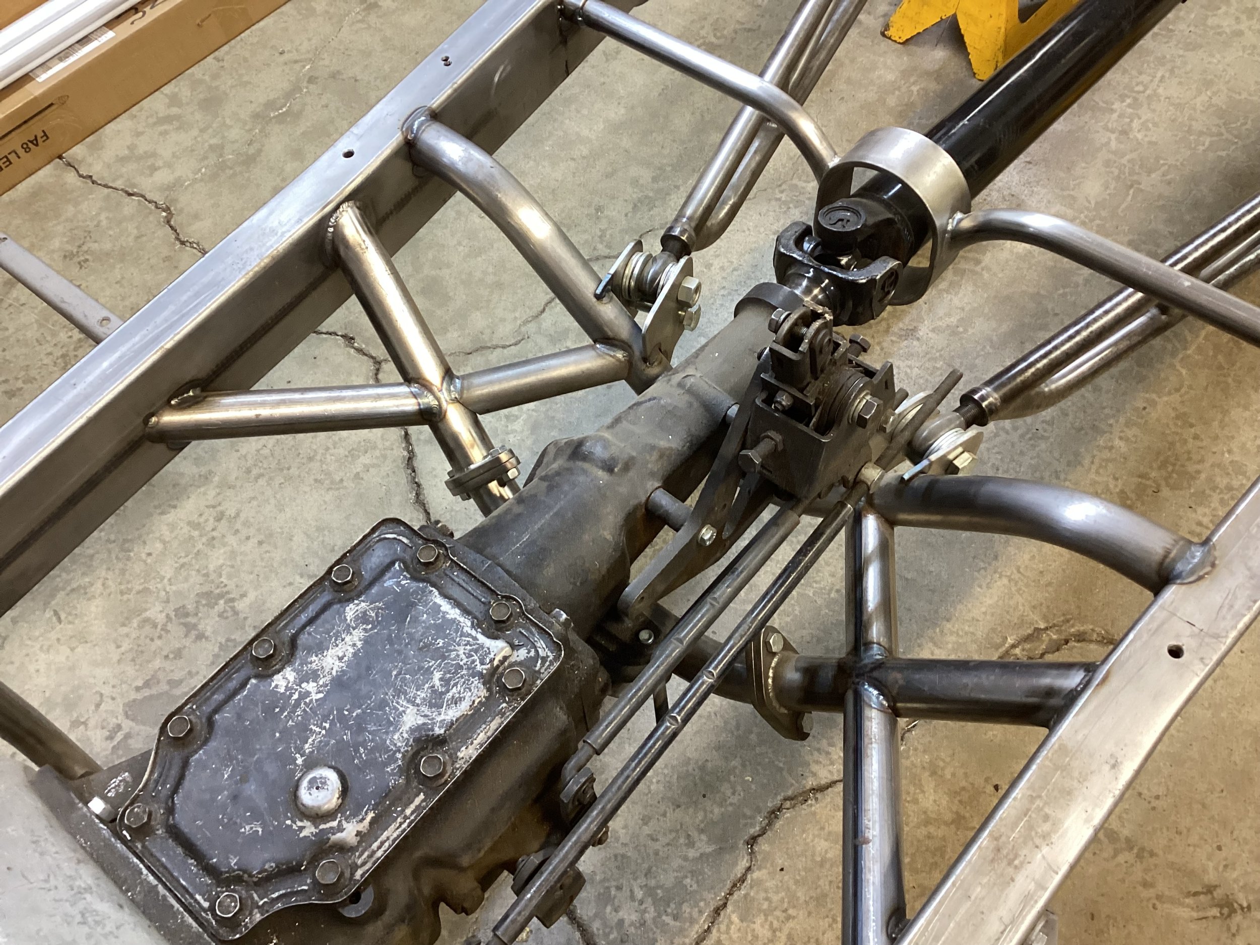

    I like how you re-forced the ladder bar crossmember and ladder bar pick up points by triangulating them into the transmission cross member and mount. Very stout with minimum material used. Nice work as always.

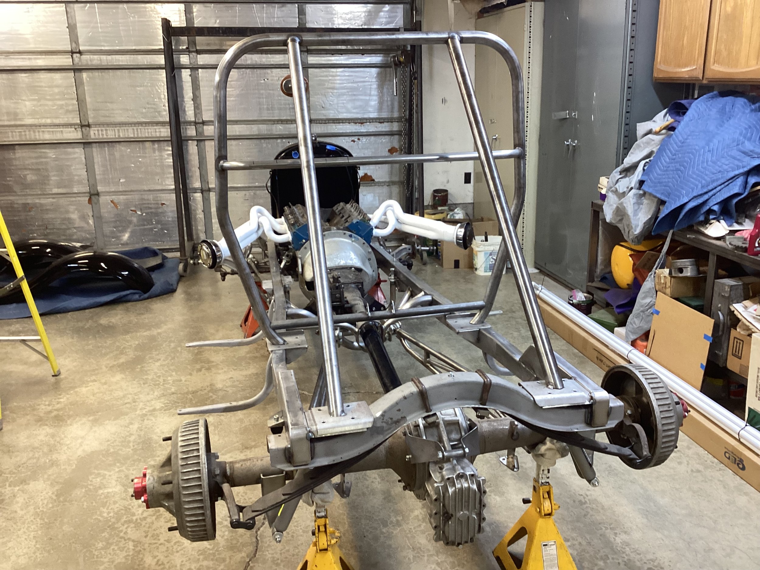

    I got the ch***is apart and finish welded everything, sandblast and powdercoat coming up. IMG_1823.jpg IMG_1822.jpg IMG_1821.jpg IMG_1820.jpg IMG_1811.jpg IMG_1812.jpg IMG_1810.jpg IMG_1809.jpg IMG_1807.jpg IMG_1808.jpg IMG_1805.jpg IMG_1806.jpg

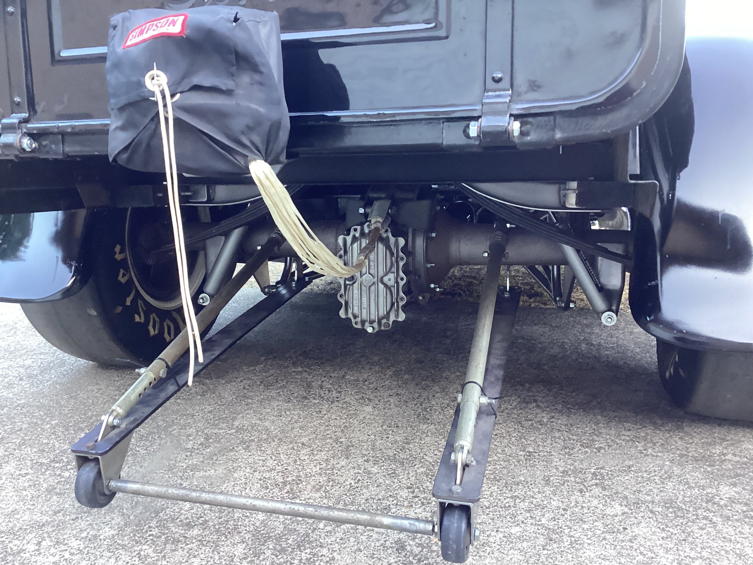

    Marty, I always enjoy homemade tools and their uses. Saw this in this tread in the picture with a dis***embled quick change. It is obviously a wood baseball bat. How was it made and what do you use it for? IMG_4622.jpeg
    porkshop, Thor1 and Sharpone like this.
  30. Marty Strode
    Posts: 9,710
    Marty Strode
    I normally use it for Tuck Shrinking on my stump. I used it to separate one of the side plates on the quickchange. Gives enough reach and won’t dent the aluminum. Good eye. I cut the handle off, bored a hole in the mill, then machined the handle for a tight fit in the lathe.
