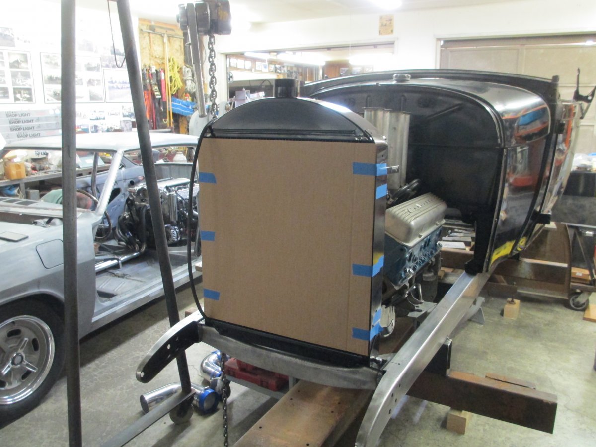

    Back on Black today. I hated to m***acre that original firewall, but time is important, and I wanted the maximum engine setback, with a flat firewall.Next will come the transmission C/M, with a removable center to remove the trans, that will come tomorrow. IMG_4083.JPG IMG_4085.JPG IMG_4086.JPG IMG_4087.JPG IMG_4088.JPG IMG_4098.JPG IMG_4099.JPG

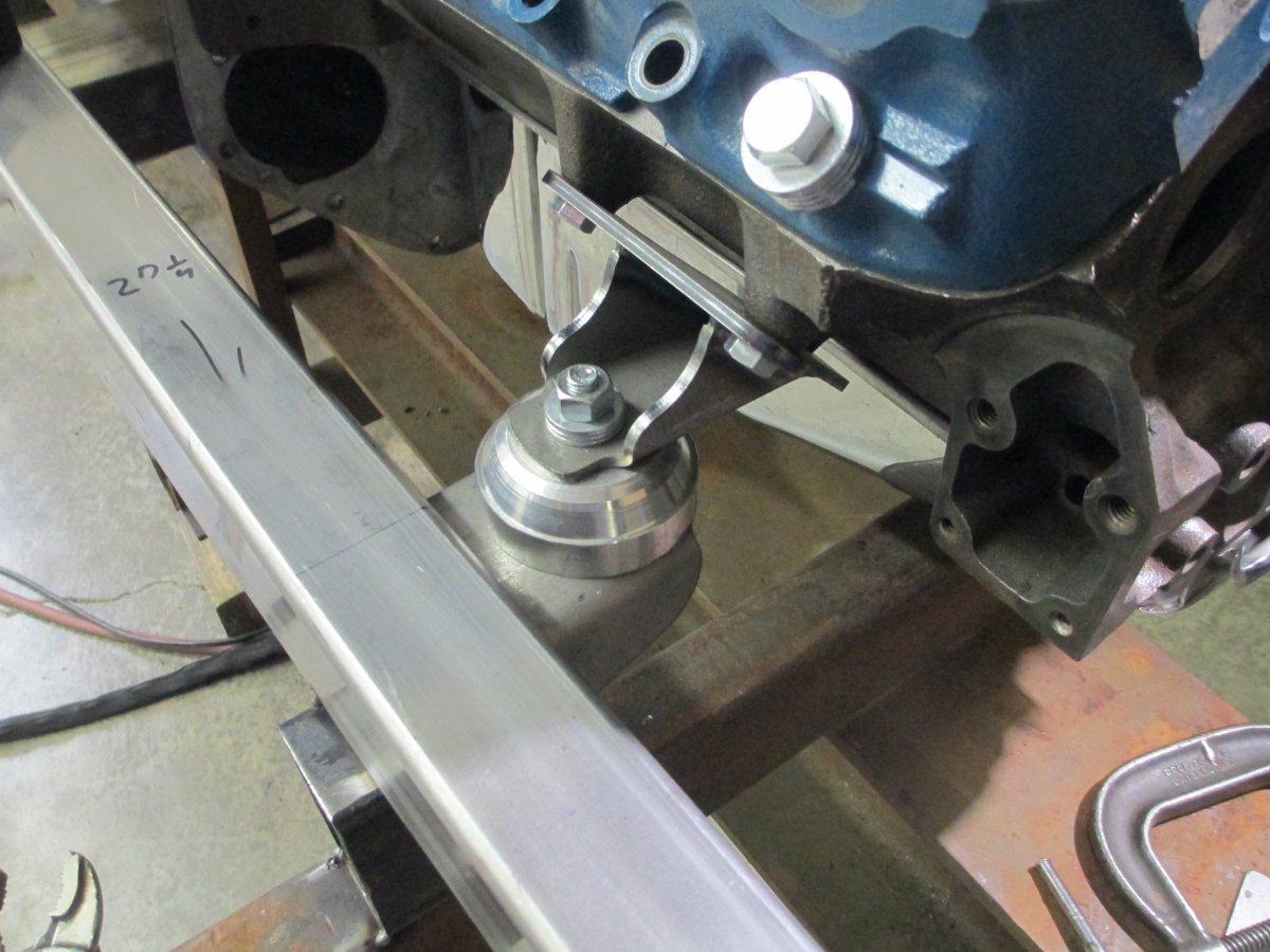

    I made a minor adjustment to the angle of the engine, lowering the rear, to compensate for the carbs on the street engine. Laid out a template for the flanges on the trans mount, IMG_4103.JPG IMG_4105.JPG IMG_4106.JPG

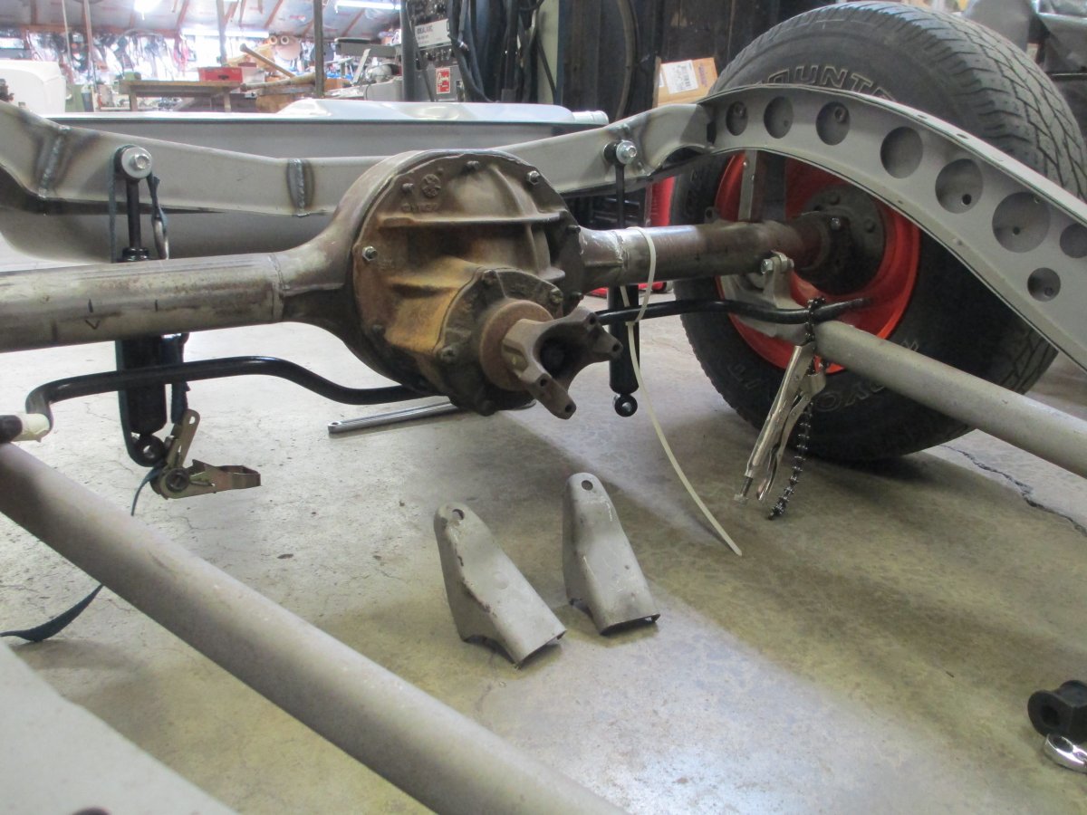

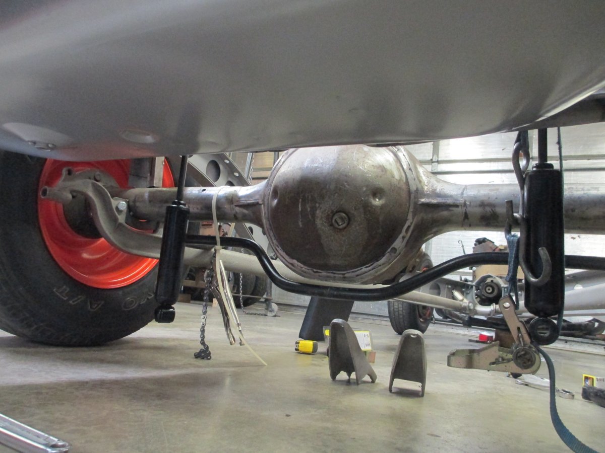

    Larry, I don't drink coffee at all, so I can't help you with that. At my age, I need to get these projects done, while I can enjoy them. Thanks for your interest ! BTW, I am fitting my '40 PU ch***is for a rear stabilizer bar and shocks, before taking taking it apart for powder IMG_4076.JPG IMG_4077.JPG coating.

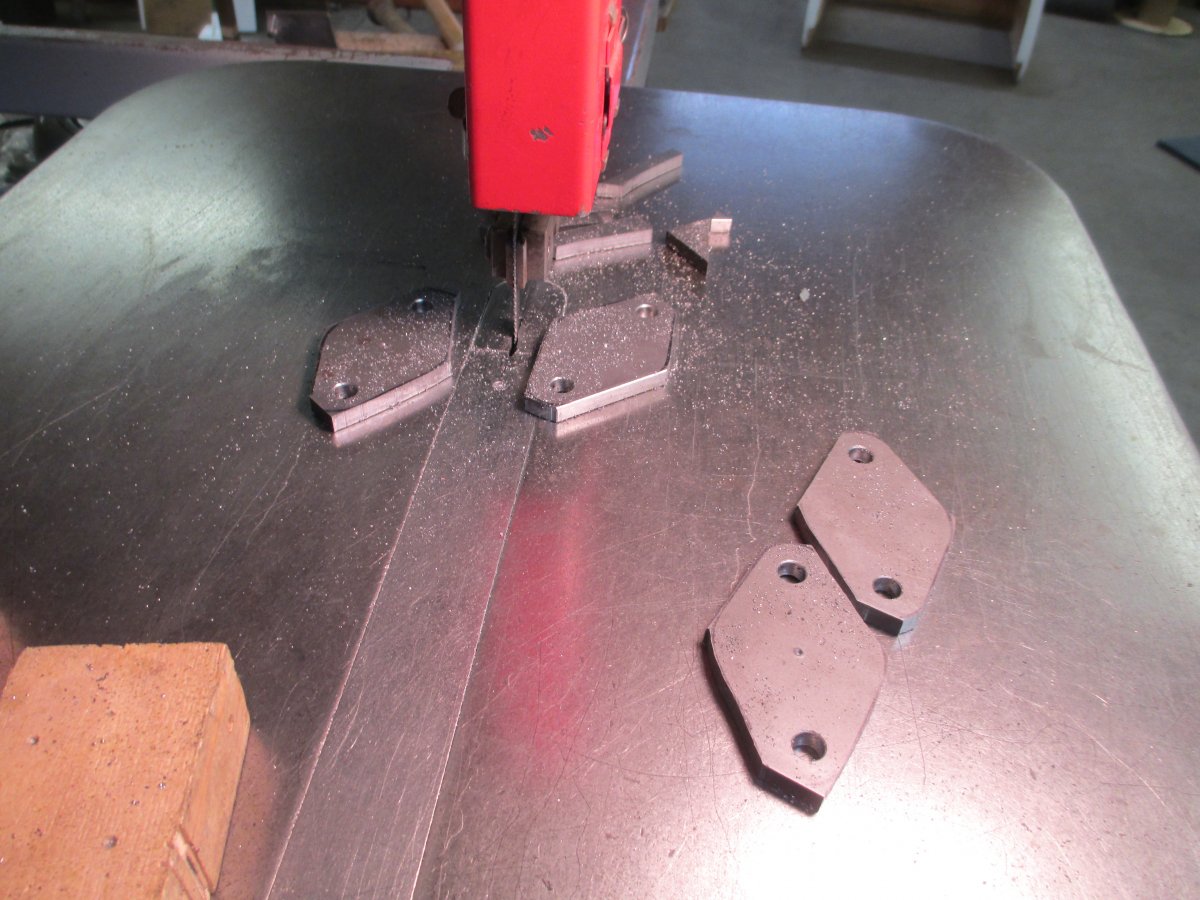

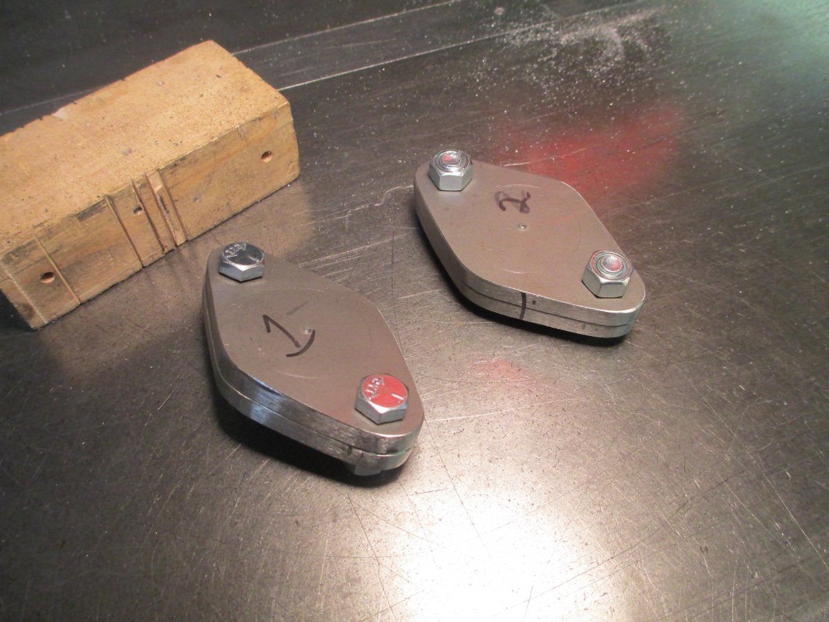

    Mike, I would like to take credit for the frame and motor mounts, but they are a m*** produced item, from the rear section forward. The trans mount would have been completed today except for time to pick up some yard art. I did get get the flanges for the C/M drilled, band sawed, and ground. Take care of your self, and stay at those projects ! IMG_4107.JPG IMG_4108.JPG IMG_4109.JPG IMG_4115.JPG IMG_4110.JPG IMG_4113.JPG

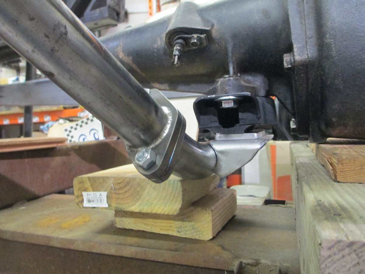

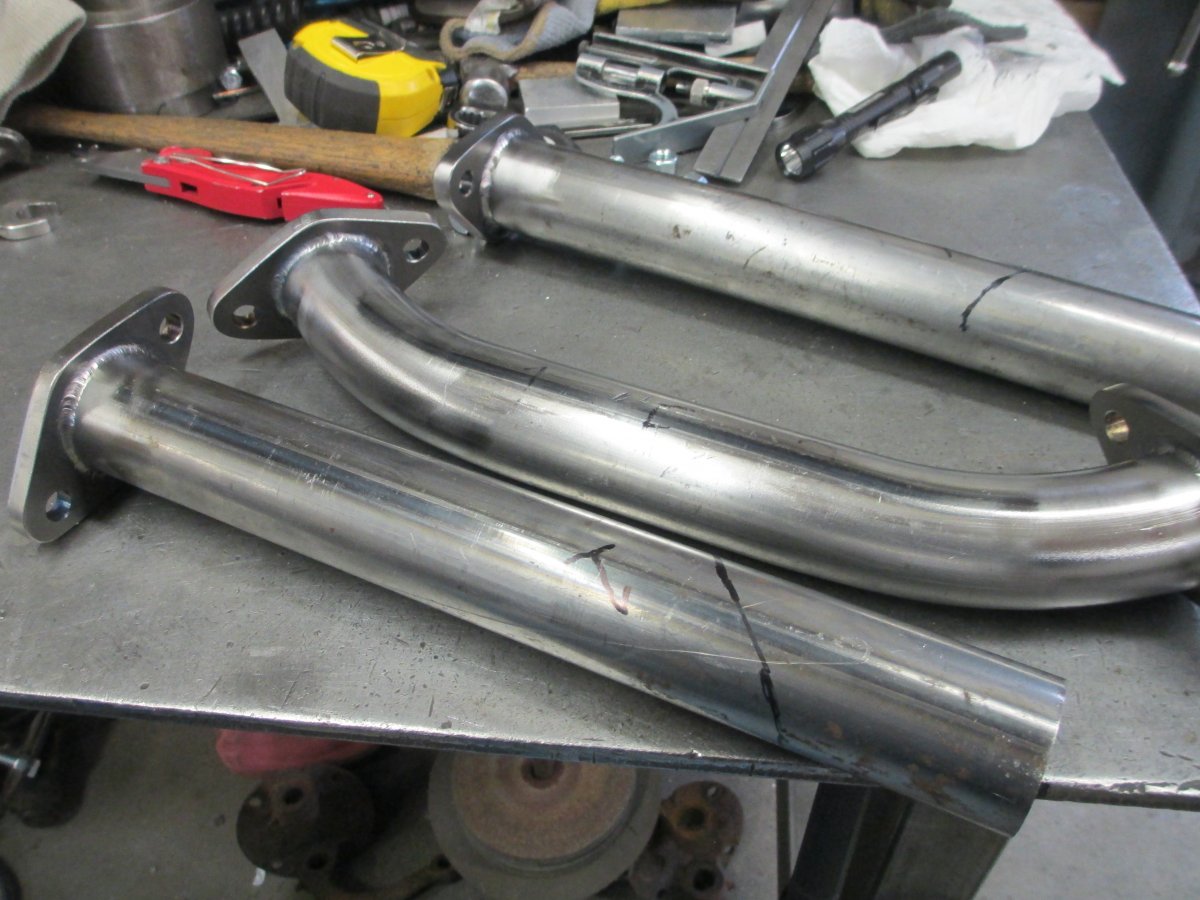

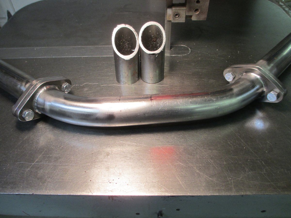

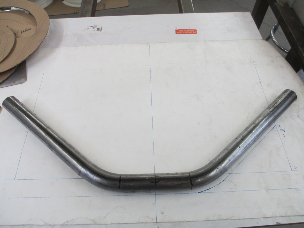

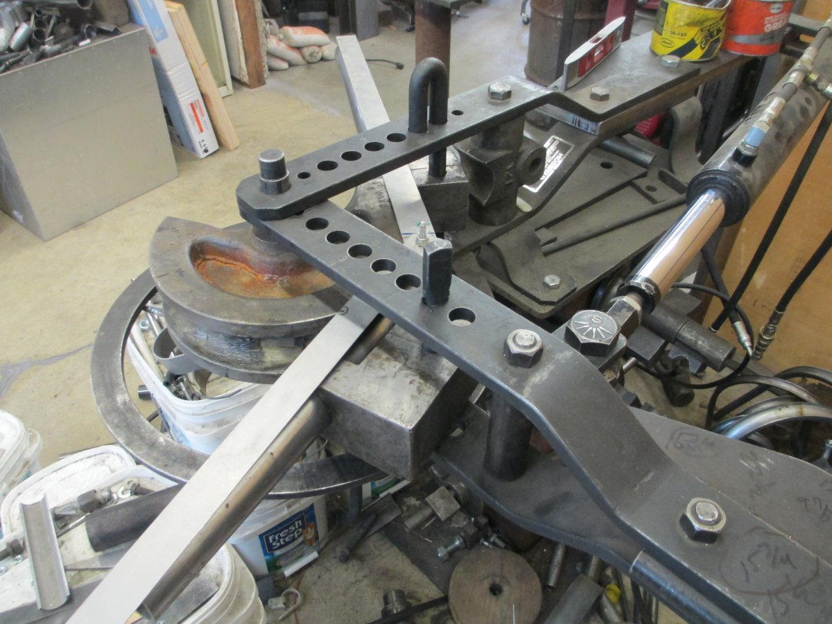

    Got the trans C/M and mount fabbed and tacked in place. It was a long process, because I wanted the center to drop out, for repairs at the track. After sizing up the width and drop of the C/M, I made a full scale 1/2 drawing to calculate the bends required. I always work off of where the bend starts, and using cardboard templates of the specific tube diameter, and bending dies I have available, to make the layout. After figuring where the flanges needed to be, I cut the center out. With the flange thickness at 5/16"x 2= 5/8", that is how much the side tubes needed to be shortened to maintain the profile. Install is next. IMG_4118.JPG IMG_4119.JPG IMG_4122.JPG IMG_4123.JPG IMG_4125.JPG IMG_4127.JPG IMG_4129.JPG IMG_4132.JPG

    With the side tubes trimmed at the proper angle, cutting out and bending the mounting plate was next. With it tacked in place, after a good look, it will be welded in. The next thing will be pulling it from the ch***is jig, and putting it on wheels next week. Then the fun begins !!!!! IMG_4133.JPG IMG_4135.JPG IMG_4137.JPG IMG_4138.JPG IMG_4140.JPG IMG_4142.JPG IMG_4143.JPG

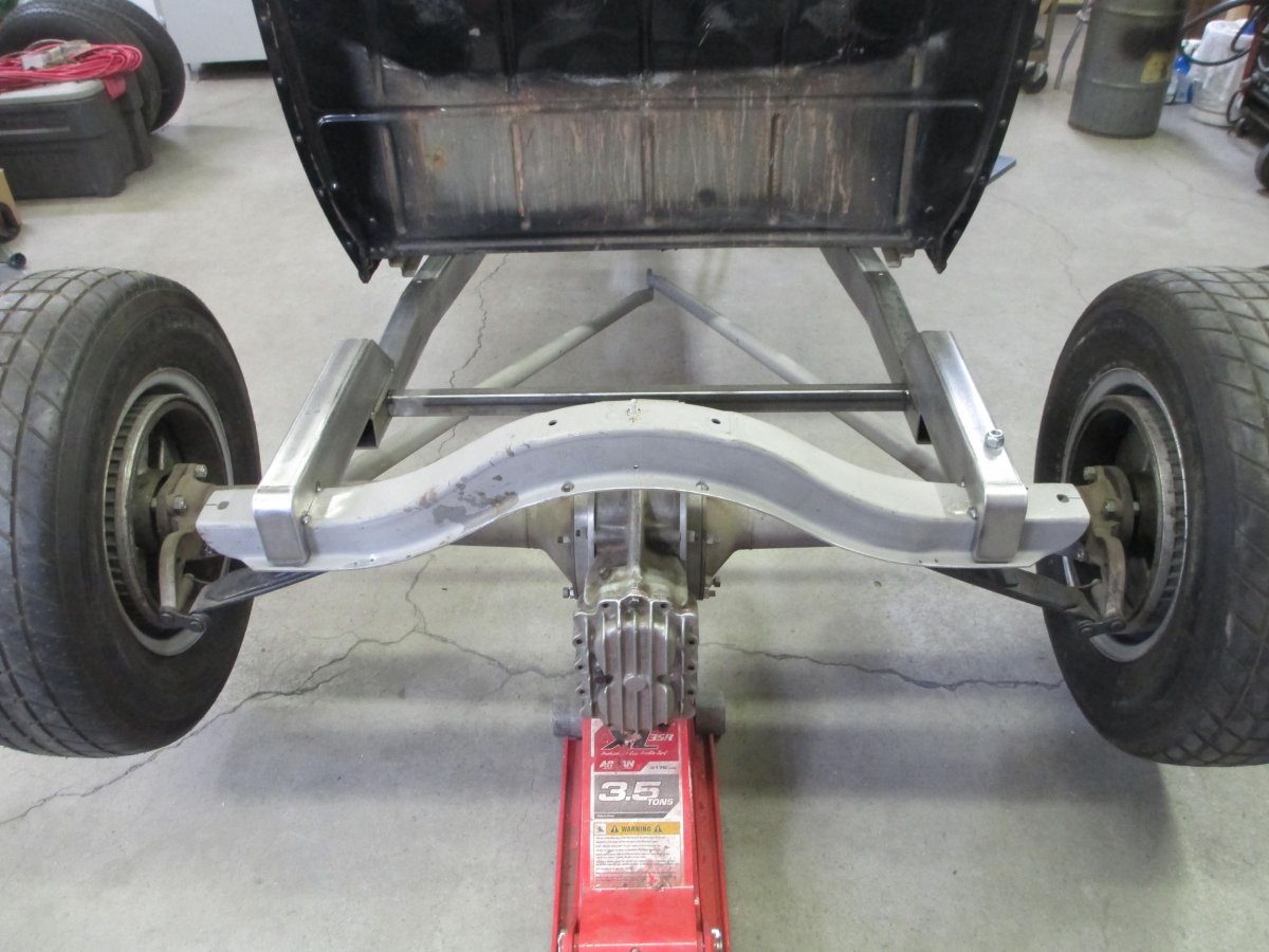

    Got the ch***is welded up (with the exception of the rear section) pulled it from the jig and swapped places with the Track Roadster. It will be a roller in a couple days. IMG_4149.JPG IMG_4156.JPG IMG_4161.JPG IMG_4162.JPG

    Bob, It will be triangulated fore and aft and tied into the ladder bar C/M. When I drop the clutch @ 7,000 I don't want any flex !

    It was a thrash, but I got the rear axle in place and on wheels today, had to get the starter rebuilt on the fork lift to get the QC off the wall. IMG_4214.JPG IMG_4215.JPG IMG_4217.JPG

    That QC looks good back there, Marty. I was hoping you would show us how the axle housings (trumpets) were modified to maintain the right spring perch width and how the ends were adapted for the Wide 5 snouts.
