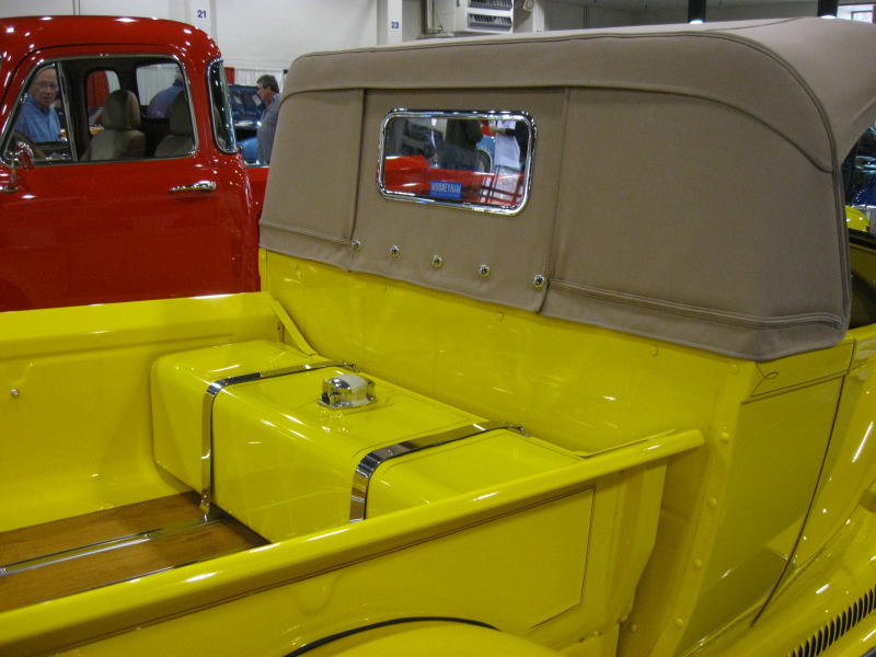

    I am starting back on this one tomorrow, and give the Track Roadster a rest. I have been trying to decide what to do for a fuel tank, and my problem is solved. Rotten Leonard sent me these, all he had left from his stock. A 36" tank in the front of the box should look great, and hold in the neighborhood of 12 gallons. When running the Injected Engine, I plan on having a Moon Tank up front, and want to try E-85 Gas, or possibly Alcohol. Thanks Rob, progress resumes tomorrow ! IMG_4549.JPG IMG_4550.JPG

    GNRS top shot.jpg Marty, my sheet metal guy made this tank for me. It holds 16 gallons.

    Marty Strode
    Beautiful job on that tank Dean. A friend sent me an oval shape tank volume calculator, and if I build the tank 36" long, with those ends, it will hold 14-1/2 gallons.

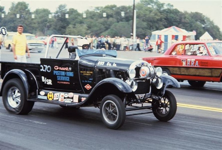

    Marty...really enjoyed going through your build chronicle. Here is a couple early shots of dad's roadster...

    Great shots Chris ! How big was Jim's engine at that time ? Also, When were those pics taken ? Please feel free to post any other shots of that great little truck. Your Dad is a Genius, but you already know that. Thank You..
  21. WestCoastChris
    Joined: Mar 4, 2008
    Posts: 175
    WestCoastChris
    from Vista
    Hey Marty....the pics are around 1963. Dad bought one of Carol Shelbys' 260s he pulled from Cobra production when the 289 was released. Dad ran a 289 later and was compe***ive, 2nd in div7 in 69. He built the Boss 302 in 70 and debuted it in Ontario and catapulted.
