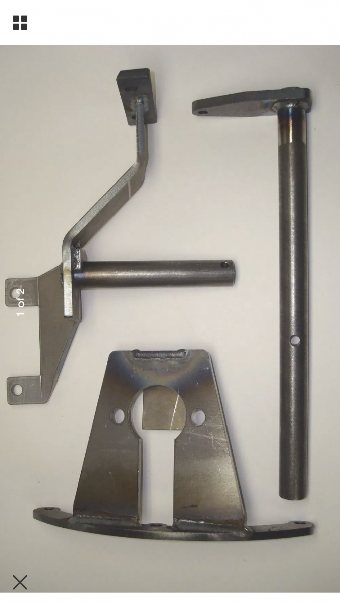

    I was surprised to recently receive an alert regarding a new "like" on a post I made to this thread back in 2015. I'm glad to see that you are back at work on your tudor, and was interested in the Bert's Model B conversion you reference above. I am just finishing putting a hopped-up B engine and transmission in a 1930 coupe using a set of Auto Specialties motor mounts for a B in an A frame that I bought back in about 2008 or so, after I had fabricated mounts for my roadster pickup as referenced earlier in your thread. I knew that Bert's had acquired the remaining stock and patterns for the motor mounts when Specialty Auto quit making them a few years ago, but was unaware that they were making a conversion kit for pedals and e-brake as shown in your post above. Did their kit include a wishbone adapter, and if so can you post up some pictures of it? I ended up fabricating a pedal mount and wishbone mount because I didn't think anything was available and didn't check beyond Cling's who makes the adapter parts for the V8 transmission conversion.

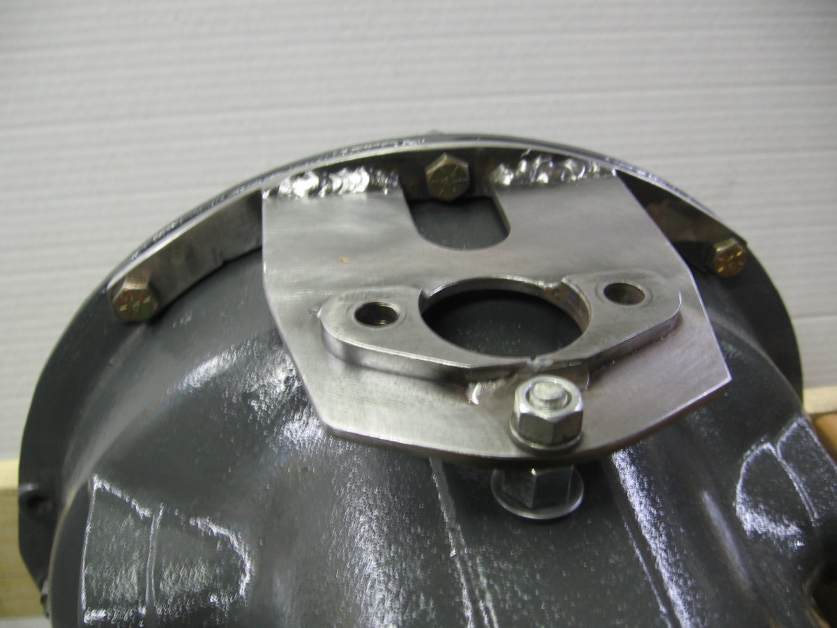

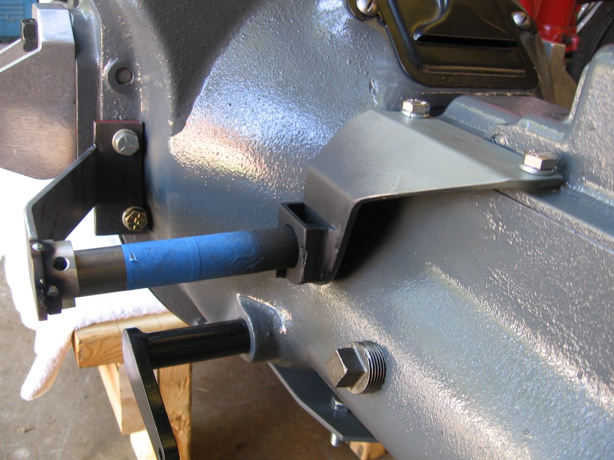

  21. 12secvx
    Joined: Sep 17, 2015
    Posts: 69
    12secvx
    0CD6B70A-588A-4CCC-B592-AEBDC5452A4B.jpeg 8B4EBB37-8079-42DC-B341-92E2F439C025.jpeg View attachment 4062917 View attachment 4062917 9E66AA2B-D98B-47F8-A762-EAB58C21763E.jpeg
    Yes here is a picture of Bert’s kit I used it came with a wishbone mount. Nice project very similar to mine.
