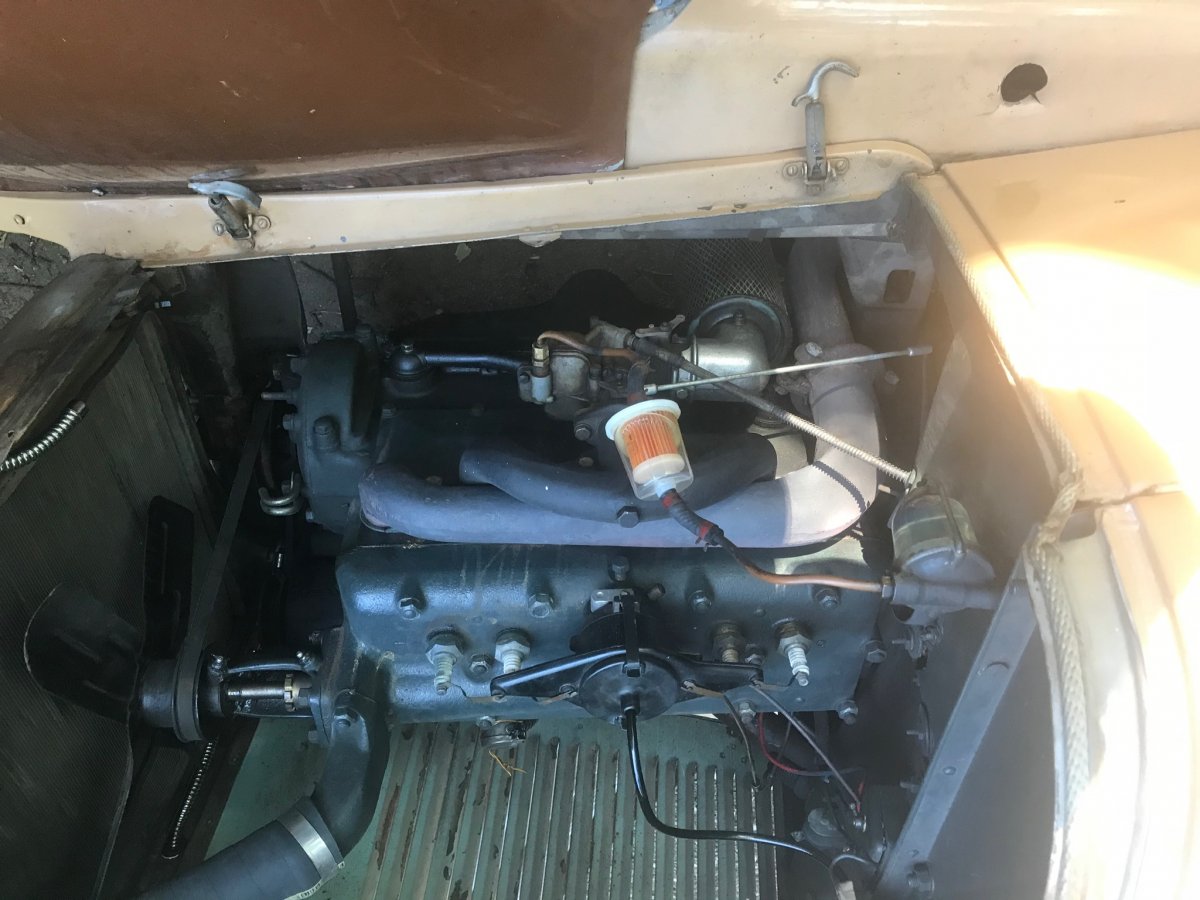

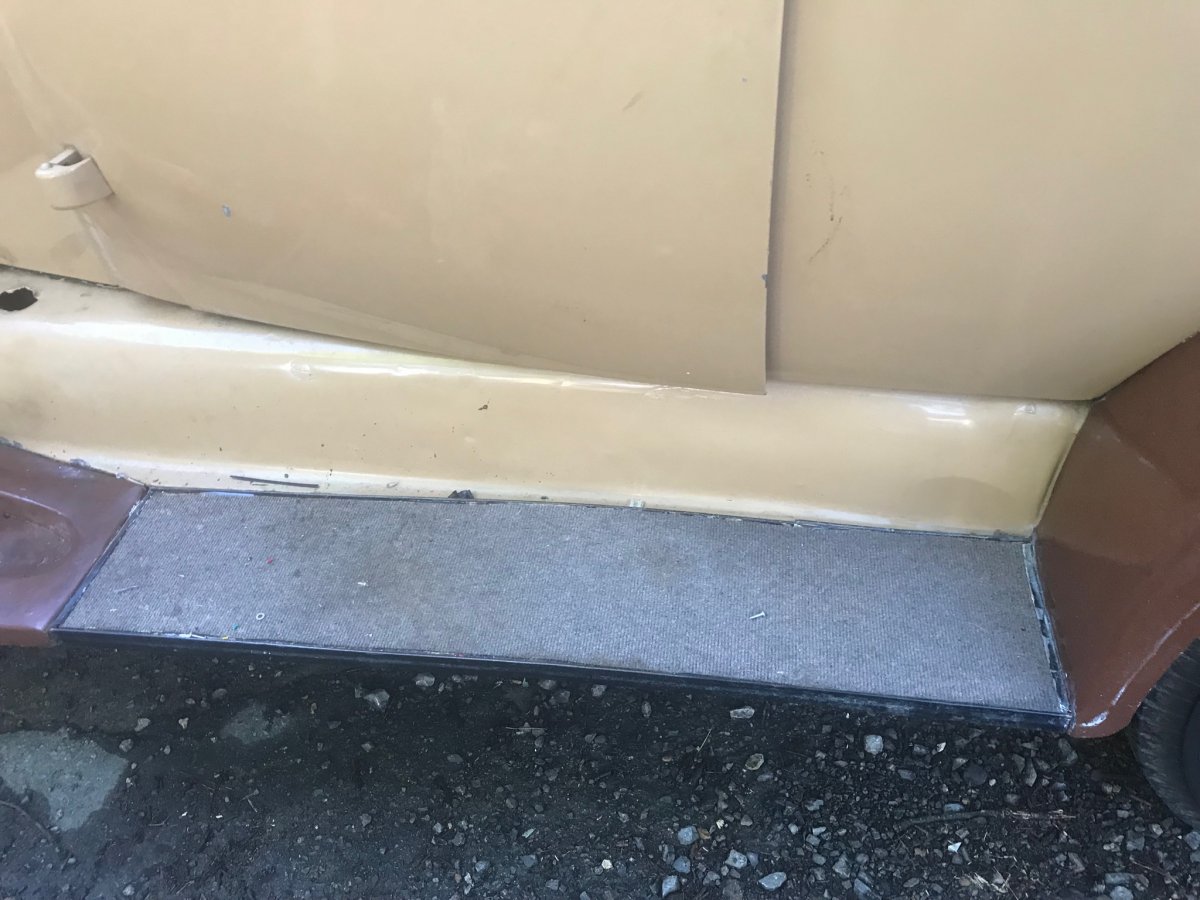

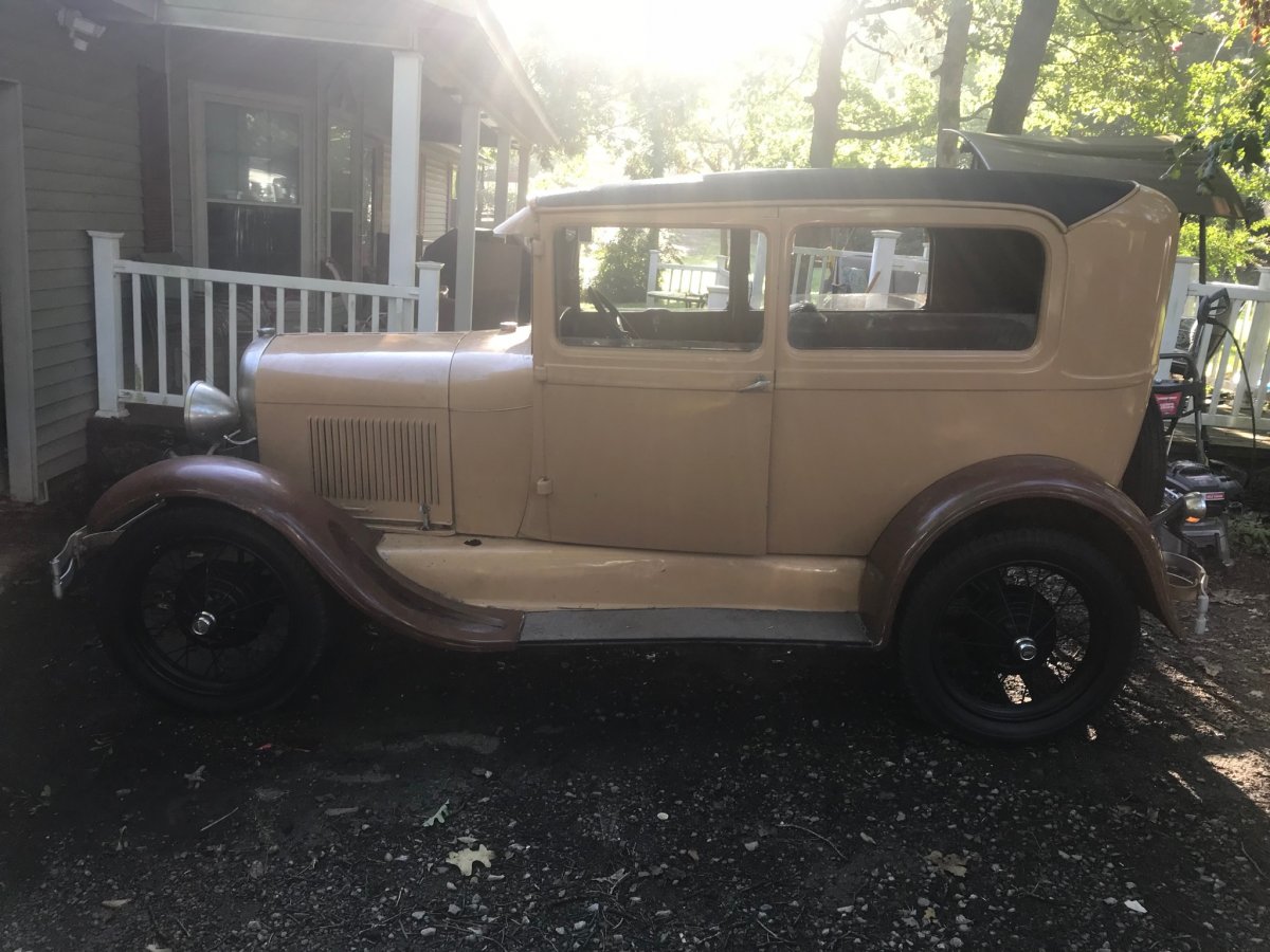

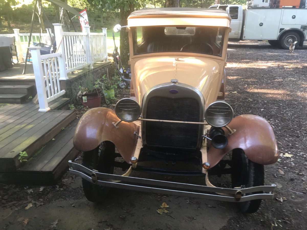

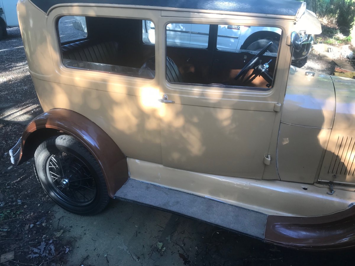

    Here are a few pics of the car I’m starting with.
