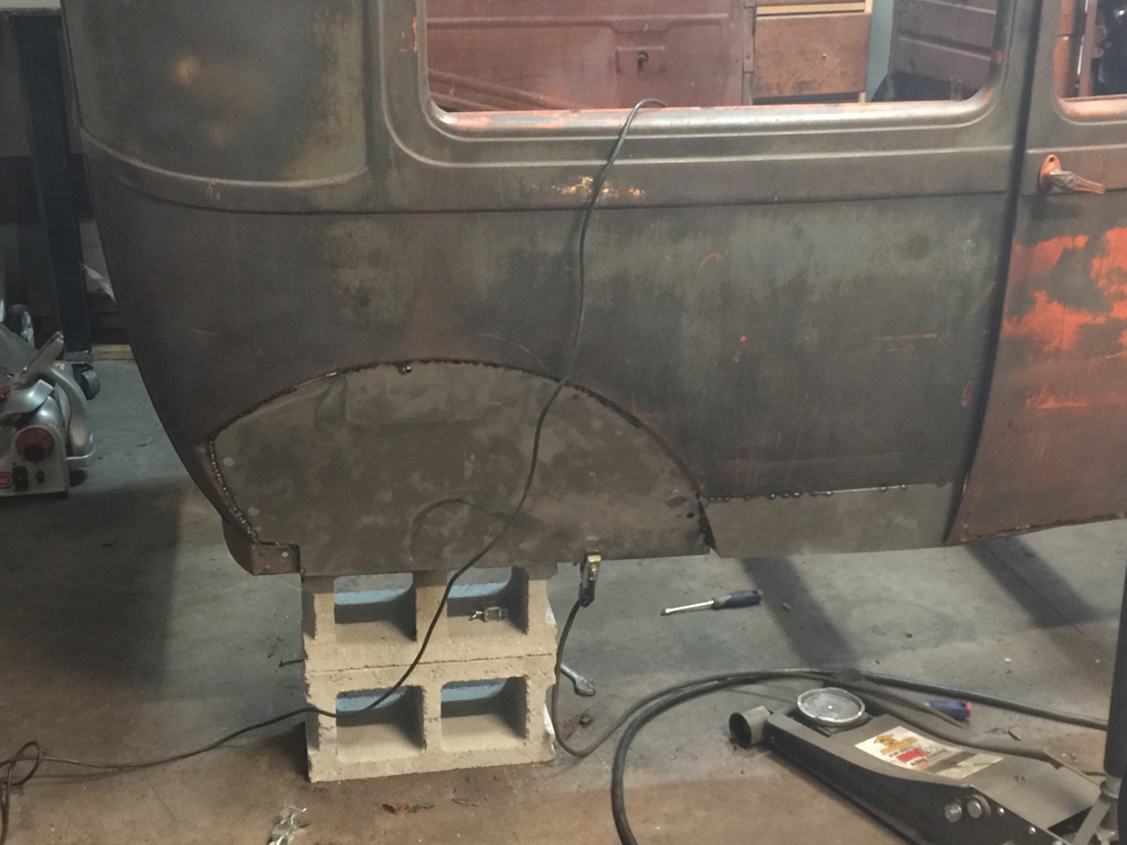

    Started on the body work. Strengthen up the body with some 1x1 square tube and started cutting out the rot.

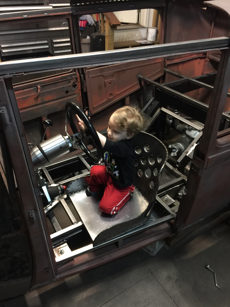

    Moved on to building the floor. The car is heavily channeled. Again used 1x1 square for the floor. ImageUploadedByH.A.M.B.1448033055.320042.jpg ImageUploadedByH.A.M.B.1448033088.757979.jpg

    My son was pretty excited at this point because he could sit in the car finally. ImageUploadedByH.A.M.B.1448033167.050235.jpg

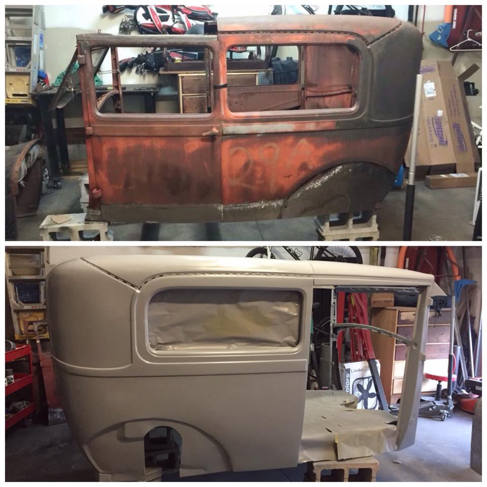

    On to the bodywork. I now officially hate sanding. Lol. I used SPI products for all the primer and paint. Barry at SPI was very helpful. ImageUploadedByH.A.M.B.1448033894.612470.jpg ImageUploadedByH.A.M.B.1448033921.532016.jpg ImageUploadedByH.A.M.B.1448033954.650631.jpg ImageUploadedByH.A.M.B.1448033971.085550.jpg

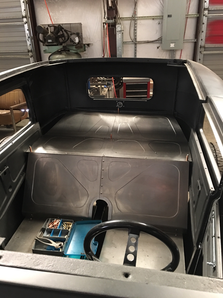

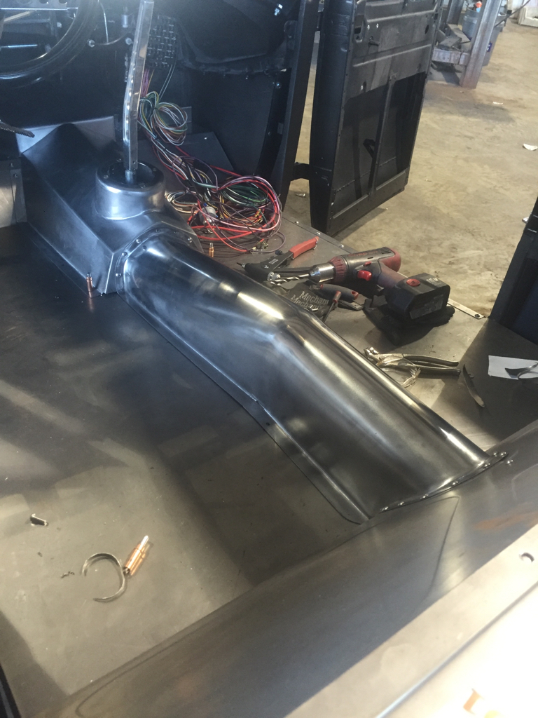

    Took the car down to MarsFab to get the interior tin work done. Chris Marshall does amazing work. He normally builds some crazy off road rock crawling buggies but his work definitely translates over to the hot rod world also! He is about halfway through the interior at this point. Can't wait to get her back. Here is where I currently am with the build. ImageUploadedByH.A.M.B.1448034579.938569.jpg ImageUploadedByH.A.M.B.1448034600.777085.jpg ImageUploadedByH.A.M.B.1448034617.977684.jpg ImageUploadedByH.A.M.B.1448034634.496681.jpg ImageUploadedByH.A.M.B.1448034650.316524.jpg ImageUploadedByH.A.M.B.1448034661.283040.jpg ImageUploadedByH.A.M.B.1448034675.353411.jpg ImageUploadedByH.A.M.B.1448034683.970606.jpg ImageUploadedByH.A.M.B.1448034694.422833.jpg ImageUploadedByH.A.M.B.1448034707.057682.jpg ImageUploadedByH.A.M.B.1448034715.109827.jpg

    The sheet metal work on the interior turned out nice!
