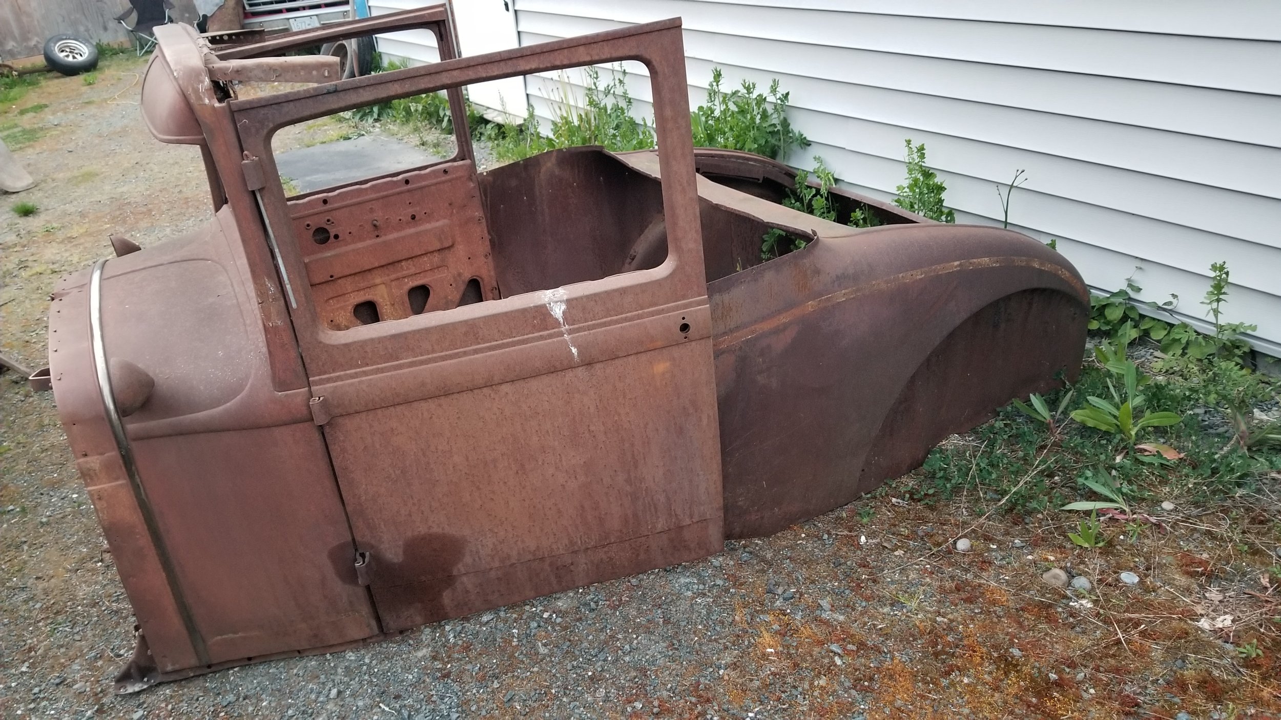

'27 Whippet Willys ? very close but that bead below the trunk is missing and the trunk seems narrower from side to side...
Thanks @choptop40 Erskine's seem to have quite a different rear 1/4 profile from what I could see... Well no one else piped up with any other ideas so I rolled with the Willys as the most likely, although I'm not 100% ...the guy turned out to be very cool and building a couple really nice mild customs...he has an o/t vehicle just painted and needs space so the roadster must go! but to be honest its not really my style also a bit more than I wanted to pay for a starter...but I bought those rear 1/4s because....well I thought I had an ace up my sleeve!...you see there was a guy selling the remnants of another project which included a painted Willys frame and front spring, a dropped front axle, hair pins and the front half of a body, doors and cowl...yup a '27 Willys for $500.! I couldn't get a hold of the guy and make the deal fast enough!.....only the axle and hairpins were sold and he had abandoned the body and frame elsewhere never to be seen again and very likely scrapped. More later....

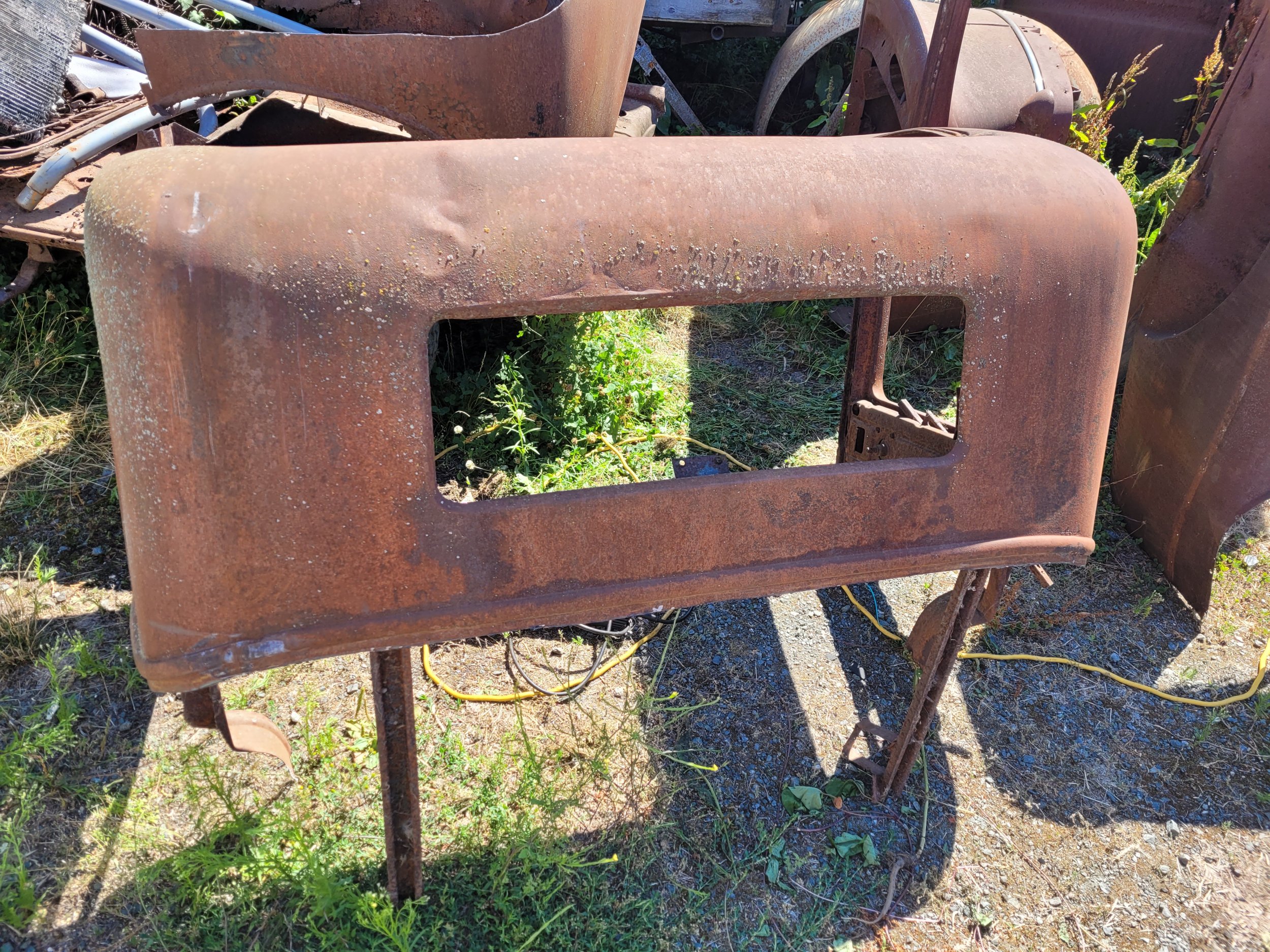

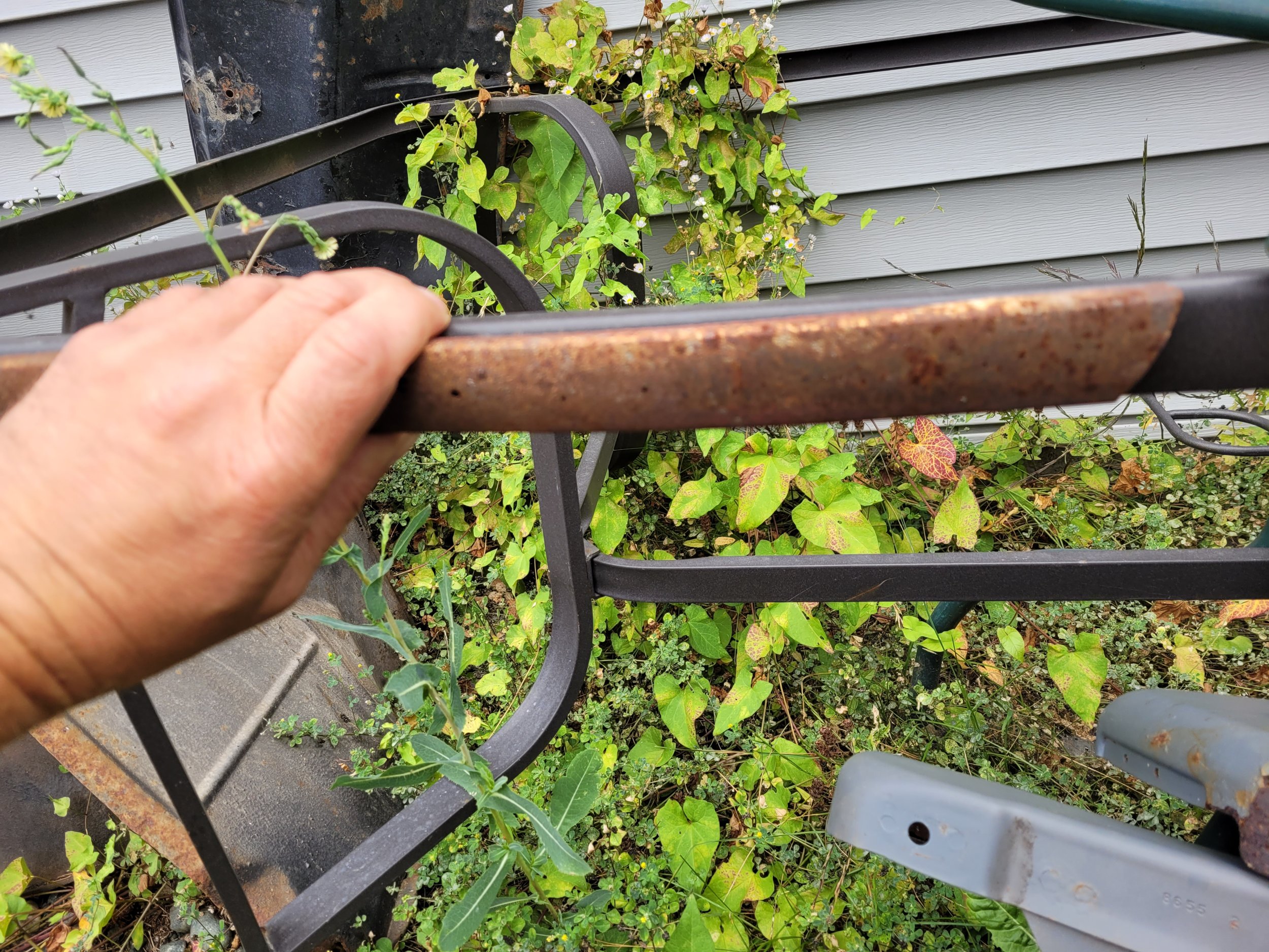

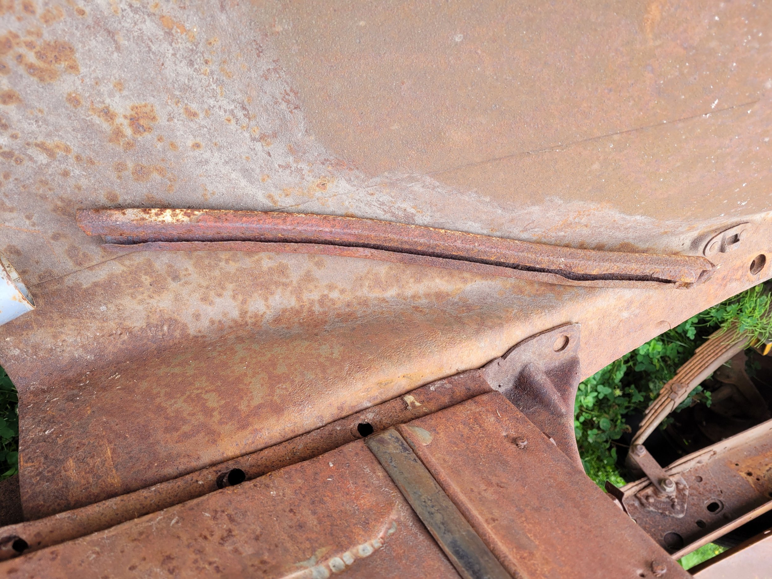

I'm going to raise the rear 1/4's so they don't have that 1920's turtle deck look lower than the rest of the body...to that end I'm going to add a few inches to the bottom of them in front of the wheelwells. I would like recreate these '29 body beads on these earlier 1/4s ...I think I'll add them externally rather than try to hammer them in...anyone have any ideas where I should look for some 1/2 round stripping? Think easy to find or create...like something you'd find at the hardware store...any ideas throw them out there - thanks!

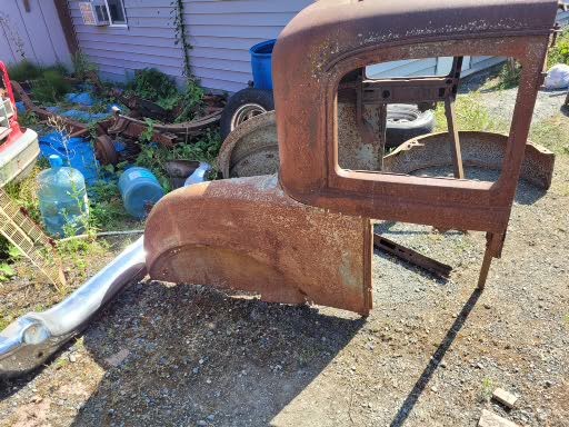

well this '30 Dedsoto followed me home...she was the victim of a fire many years ago and sat up in the dry part of our area...I know you're thinking what does this have to with a Willys coupe? well there's the last missing component...a frame! she's 13 feet long stem to stern which is getting away from the stubby little coupe I had in mind but I'm not fussy...I have a chopped up mangled Model A frame I was working with and some ideas for an elliptical spring set up (which was really getting away from the simplistic quick and dirty concept of this project) so this is a big step forward...it's got springs etc. so I can literally bolt my axles right on to it...I have 2 old axles to work with '23 Packard and '32 Buick whichever bolts in, steering gear from a '54 Buick, a 283/PG combo and a '57 Chevy rear axle... and I've been working on a tubing inner structure to replace the non existent wood...other parts I will use off the Desoto are the fenders(maybe) the door posts (or one cut in half) , roof side panels and the rear of the roof & back window for the 3 W coupe, and possibly the all steel inner panels from the front doors as they're currently just skins
So we decided the best thing to do was bring my roller axles there and bolt them under the car...seller was a super nice guy and gave me a hand and even delivered it! So first I tried this combo... But it just wasn't working for me...while I was there he gave me a little tour of his beautiful property and huge shop....and I spied a pair of '20's something coupe rear 1/4s...he had aquired them through an "all or nothin" deal and didn't need them so gave me a great deal on them... Since the Willys is just a sheet metal skin at the moment having the other 1/4's got me to thinking...hmmm maybe I actually have 2 cars here
So to that end... There's no turning back now lol!....since neither pairs of 1/4's had a body bead line I'm going to incorporate the body bead of the Desoto into the rear section...slipping it down until the curvature of the bead under the rear window (which rises up) meets the top of the Chev 1/4's

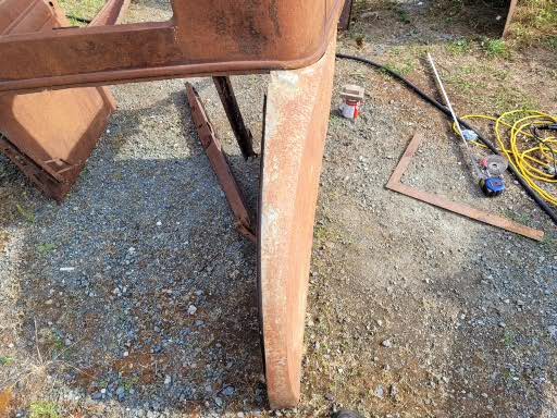

I was nervous but there comes a time when you have to make that first cut.... **Ignore the length of that 1/4 window...it's going to be a 3W....I left it there because it's going to be one of the most crucial cuts and I don't want to fuck it up! Also helps to get the bead line square with the door edges.... Proud of that... I suddenly hit the first big snag of fitting two different makes of car together... If you look at the rear roof panel and the door below a trained eye can see that A) the rear 1/4 window tapers down at the rear... B) the upper body bead follows that taper... C) the front doors taper up 5/8ths from front to back! Uggg oh crap! I started to envision extremely difficult things like: cutting a wedge shape up into the gutter/body bead of the roof or even worse trying to wedge chop a square door top!! fuggedaboutit! both options would look like warm dog shit! measuring up from the side body bead the 19" I needed would move the doors farther forward making a huge side roof area...too ugly for a 3W and a rather odd looking 5W ... then it dawned on me...maybe the Plymouth engineers had already solved the problem for me...(once again ignore the large 1/4 window!) the door tapers....yep if I suicide the doors flip 'em side for side I can move them back to a point where both the top bead and side beads line up... add a couple inches to the front of the 1/4s and Bob's yer uncle ...whew!
