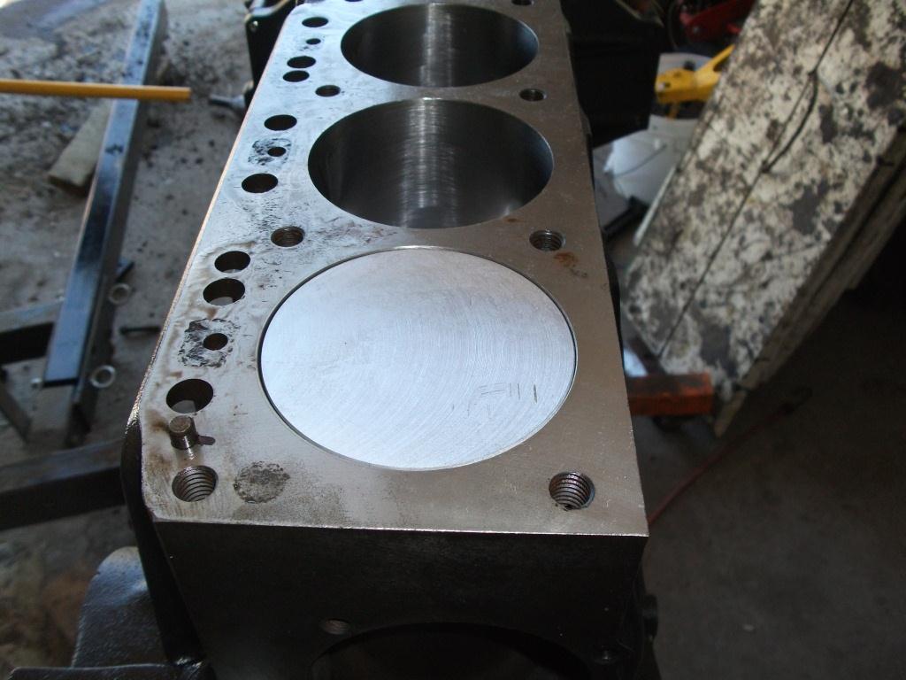

  1. When I do the heads for 250s we remove the post and plug but use a countersunk hex head bolt below. Last one I did was 2000 so I forgot where my customer got his bolt from. He is also a mechanic (I did all the machining) and we didnt second gues each other. On the flow bench the lump or floor plates as I call them were worth a huge improvement. I did them first in plasticine for the flow test. He made the ruff plates as I asked and installed them with JB weld filler and I did all the porting after. I was surprised how well it would flow when we added the floor plates. Engine is still running and apparently well. Now known as FourAmerica vintage stock car (35 Chev) and last I heard it was running in Florida somewhere. Headstuff all applys even though it is a 250.
    Re pistons. Probably buying a set of those trick pistons would be the cheapest improvement you could make in the long run. A couple of extra hundred bucks for never having a problem is often a real bargin especially if you dont have your own machine shop and engine building stuff. As much as it might be a pain it is probably money well spent in the long run. (Which means you will never wake up in the next 7 or 8 years saying I wish I hadnt have spent the money. The pain will only be for a second or so right now and then will be nothing but a forgoten memory. ) BTW I applaude you refforts. Six cylinders are really fun to work with and race. All the best on you roject
    Don
  2. Joe H
    Joined: Feb 10, 2008
    Posts: 1,879
    Joe H
    Something else to think about, those piston you now have installed will never have a squish area. The small lip around the outer edge is the only squish area you have, you can deck the block to a zero deck hight and still not have the .050" or less squish due to the dish.
    Joe

    On the other side of the coin here is a pic of my 292 piston its got good squish but pump gas is a no-no :D DSCF3280.JPG

    What is stock compression height supposed to be? I see replacement pistons have a 2.010 height.
    At this point, my pistons are .020 overbore and the machinist said they did a .050 cut on the head and just a .005 on the stock deck as of monday and my chambers are around 67cc now. Does that sound about right? He tells me that I will have 8.13:1 ratio. I found summit racings compression calculator and i'm fooling around with that. I found the LPG pistons that I could switch to here http://www.summitracing.com/parts/slp-980p20
    I will call summit and see if they can get me info on the dish volume. For now, if I ***ume that they are 15cc then that gets me a 9.24:1 ratio. That should be nice for my street motor and cam right? Would I run mid grade gas? I have been looking to run off mid grade at least in order to help avoid engine pinging as well as squeezing more power out with the cam I chose.
    Is it not possible to get your forged pistons in .020 overbore size?
    oh and I watched your youtube videos. thanks for those!

    Well I talked to a guy a ross pistons and he wasn't much help. He told me to call Heckt power products since he saw the banner in a photo on Tom lowe's website :rolleyes:.
    I have been trying to get in contact with Tom Lowe to figure out my piston solution but Bob at Heckt said that he might be on vacation right now.
    In the meantime I have been calculating and it looks like If I stick with the .030 MLS head gasket I ordered and then get a set of forged ross pistons at 3.895 bore then I get my quench area to .045 without doing any additional machining. That is ***uming that the ross pistons have the .015 piston to deck clearance that Tom's says his have though.
    Using a compression calculator with the numbers I have shows that I would get about 9 to 1 comp ratio.
    What do y'all think of that for solving my quench and compression problem?
    How do I check my valve clearance? I would think it is still okay since these ross pistons have the dish in them.

    My pistons have a 2.043 CH. With the next batch I order. Could order a .020 set. It may be this winter.
    I also highly recommend the use of a tq plate for honing. The bores go square around the head bolts 1" deep into the cylinder when the head bolts are tightened.

    I wish I had known about the square bore issue before my block had been machined. How bad is it? A couple thousandths? Too much for a street motor? They didn't do that from the factory did they? I will ask my machine shop if they used one.
    It would be great if you could do the .020 bore in your next batch for me. Would that keep the price at $600 for a set? Do I want press fit or the lock rings? The lock ring wrist pins mean that it would be easy for me to install the pistons by myself correct? I can definitely wait until Christmas and then they would be an awesome present to myself!

    I have the honing info on my website. It is about .004 bulge at every head bolt 1" down in the block. It is serious.
    He did not use a tq plate. There are very few of the around. I do rent them.
