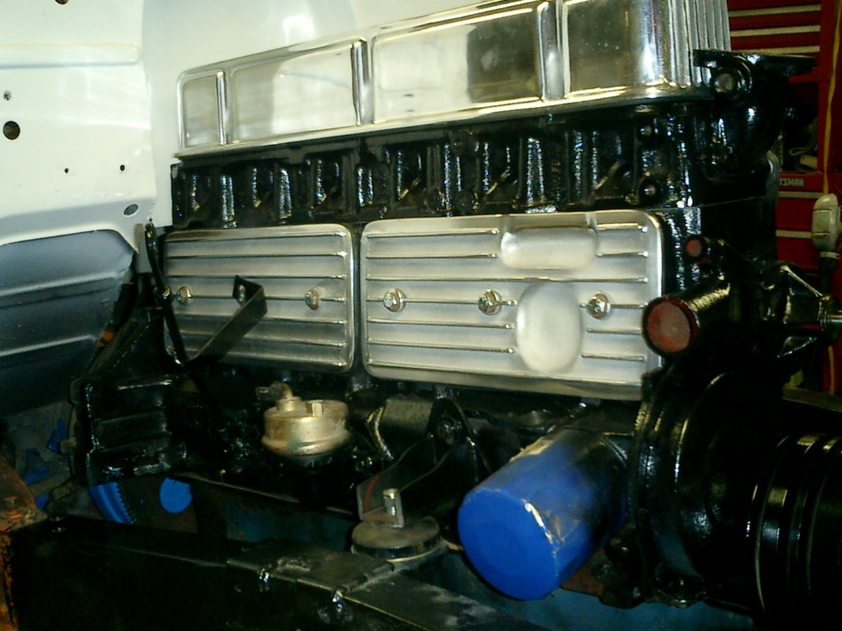

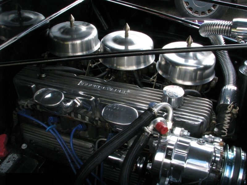

    I've had mine since I built my car. 292, .030 over, 270 wolverine Cam, Ported, Polished, 3x2 Holley Webers and of course Langdon's Split Manifold. coupled with a NWC T-5 from a v8 Camaro and 10 bolt Nova rear. Unbelievable Chevy Motor 2.jpg Chevy Motor 1.jpg smooth power and loads of torque!
