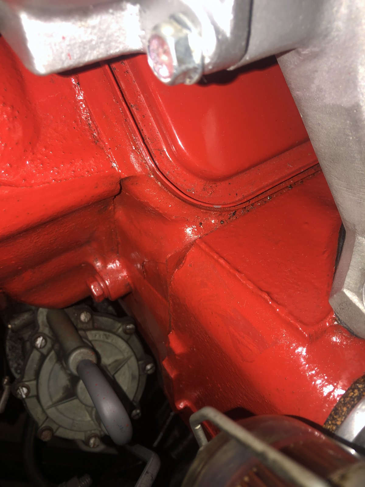

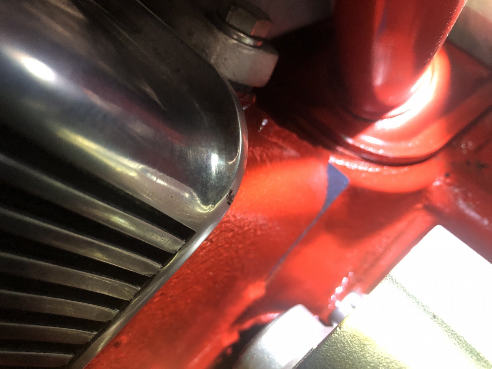

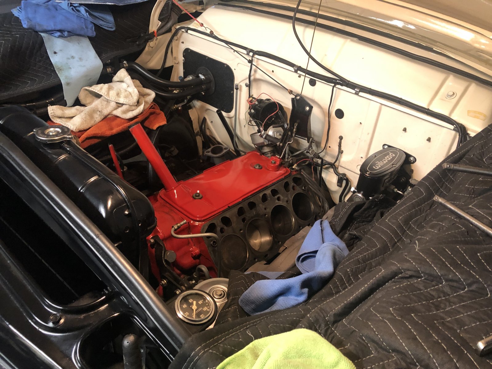

    Mine didn’t.. I’ve have both heads off to install better valve seals. I cover all holes with paper towels and used a razor blade and a vacuum running all the time. I cleaned the head side with a wire brush on a drill. I used gaskets from “Best” and the intakes with the exhaust crossover restrictors.
    You must put on the head gaskets correctly. “Top” only means top for one the other goes upside down. There must be a corner of the gasket at the top on the front on both sides if correct . I’ll include a photos for both sides the right one didn’t get painted… The 3rd one is showing both heads off in the car. B649A053-BD81-44D6-894E-7C9327A9588F.jpeg 00A102A3-CEE0-4B73-8D40-A588270C1986.jpeg 0E63BE62-FA82-4410-A6DD-ABCF1C250584.jpeg
