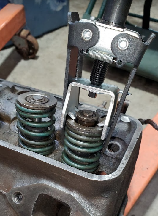

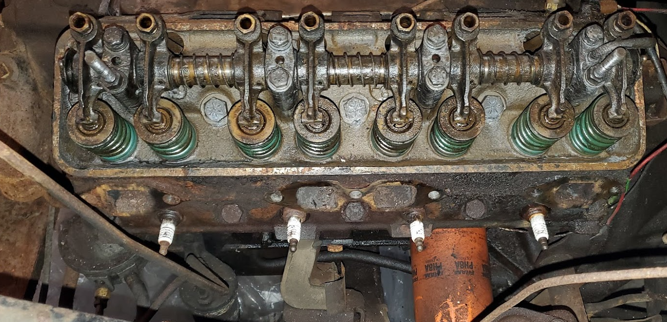

    Clearly I am trying to remove the valve spring - and it is not playing out as I expected.
    I was expecting to see 2 little c-shaped locks wrapped around the valve stem - essentially resting in a cup shape on the retainer. I was going to use a magnetic pickup to catch them. Instead there is this cup shaped retainer within the retainer? A 2-piece retainer? It is not in the shop manual pictures like that.
    Am I supposed to tap or press that down out of the way? I tried one other spring and it behaved exactly the same.
    PS - yes I know I am using a borrowed spring compression tool that no one will like, but it did compress the spring and stay put through the process.

    Put a washer over it so only retainer clips will p*** thru.

    You should be able to tap the retainer cup down. Tapping on one side should release it. Burned oil and the taper fit holding it in place. Before I use a spring compressor I like to tap on all the retainers to loosen them.

    Those are the "valve rotators" iirc. The keepers just haven't been dis***embled in a while. Try twisting it around, too. Might have to get more spring, another coil further down, with the tool.
    There's nothing "wrong" with that tool as such, but it's made for spring removal with the engine still installed. If the heads are off there are better ways.

    I was pretty happy with that tool overall, it was close, but it was even able to remove and install the springs directly underneath the brake master cylinder.
    Took my time and frequent breaks and managed not to lose any of the 32 valve keepers down inside the engine or watch them ping off somewhere on the other side of the garage.

    Yes, they do get stuck pretty tightly. Use one of the little "magnet on a stick" thingies to catch the keepers. Stick the little magnet to one side of the retainer and sharply tap the other side of it. Done carefully the keepers will stay **** and won't go flying. I do this a lot and have never had a problem with this method.

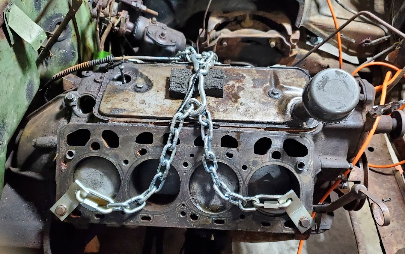

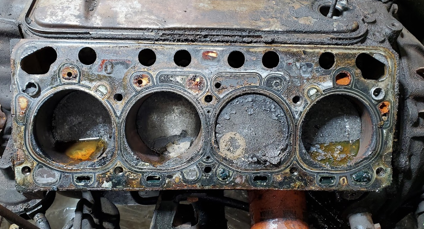

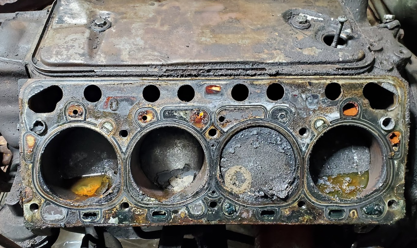

    It did move ... I beat on the piston tops with a hammer + a stick and it moved.
    Back and forth about 1/2 ~ 1 inch of piston travel with me turning the crank bolt. I am sure I gave it another whack with the pistonator, but whatever happened after about 10 minutes of joy it stopped. The car has so far been unwilling to let go ... but I don't have it out and the pan off yet.
    The rocker arms and shafts look ok to me - they are oily anyway

    Are you able to get to all the rod bolt nuts to remove or at least lower the crank some?

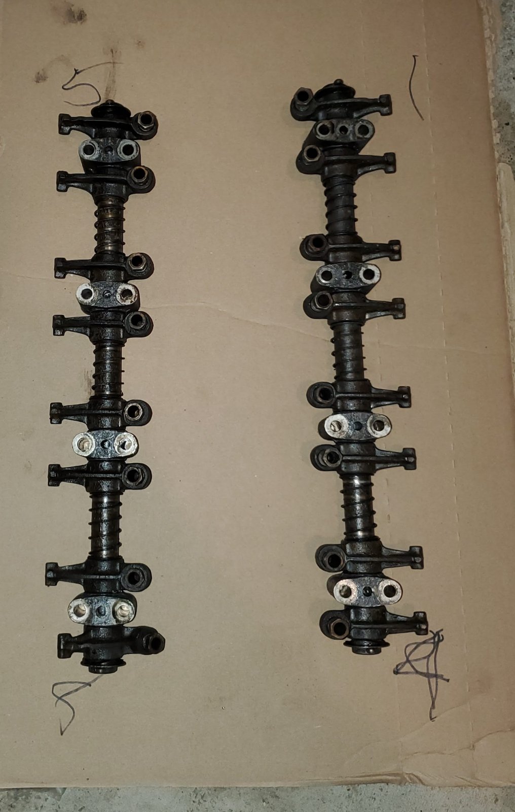

    OK, what you want to do with those rockers is slide 'em over to the side against the spring tension and then look on the under side of of the rocker shaft, that's where the load is, and where galling and scoring occurs especially without any oil. Y-Blocks were famous for poor oiling up top.

    Pull the pan and see what you find. If it’s a broken rod binding up, that’s way different than a stuck piston. Give us a couple pictures of the car, and your ***essment of rust. Condition of interior, etc. Which transmission it has. It all plays into the decision.
    Building a performance y block is expensive. But a simple rebuild on a stock engine isn’t so bad. Probably less than an engine swap. More than a sbc, but not much worse than an FE.

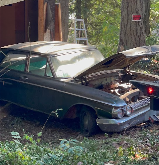

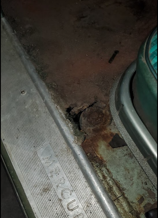

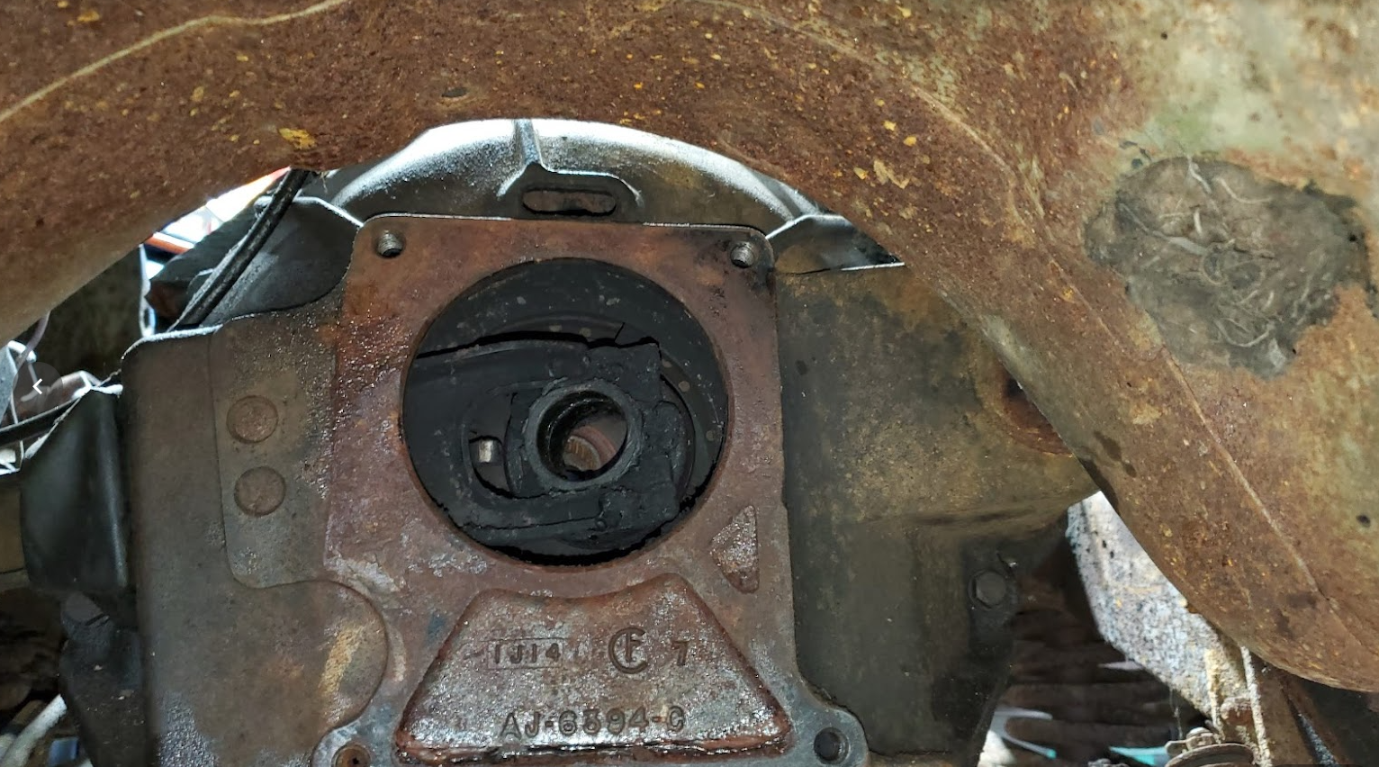

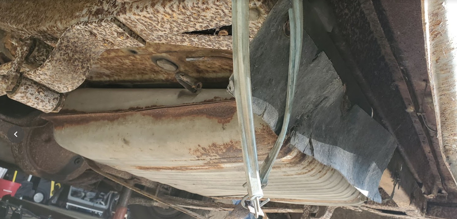

    Body wise - It has been repainted - it should be white and green and it is not quite the correct green. There is bondo under paint on the bottom of the two rear fenders. There are 4x6 inch "vent holes" at the top front of both rear wheel wells (inside the trunk space) and a hole about the side of a playing card under the drivers left thigh. The frame & drive shaft are covered with this leopard spotted rust. The floor pans are otherwise OK - but the floor pan supports have been eaten through in a couple places where they arc into the tunnel. Most of the rubber stoppers and supports are toast.
    I have no good pictures of the bent front left fender or the bent hood / grille center front. I am sure it was run into a post at some point. You can guess that the hood latches were frozen open. And it needs back gl***.

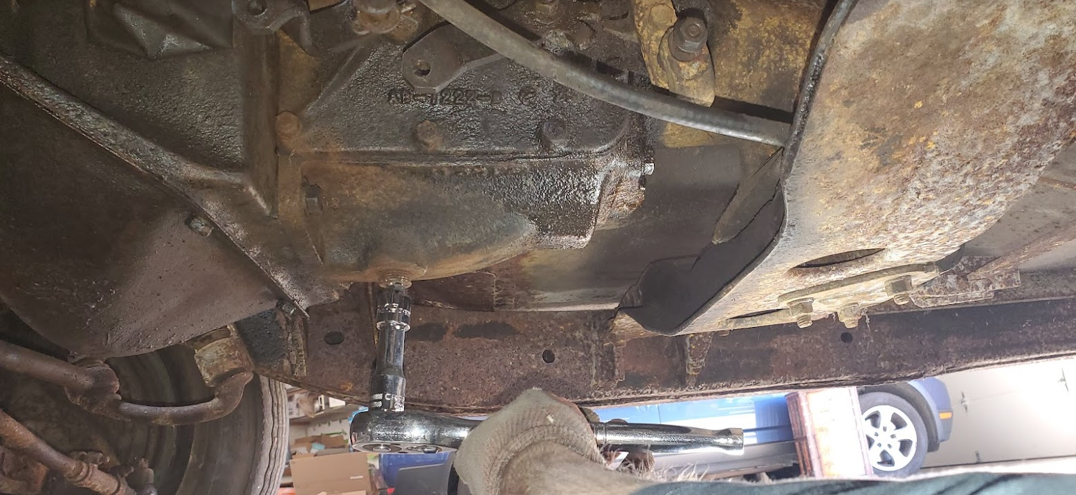

    It has a Ford 259 3-speed manual (9 bolt side loader) transmission. It had plenty of oil in it, but I pulled g****nuts off the drain plug. I have not opened it. It shifted smoothly enough (under no load).
    It had plenty of water in it when I opened it in spite of someone having stolen the radiator. Didn't realize there were pet****s to drain at the bottom - who would have thought I needed to - but the heater core and the cylinder heads both wizzed a quart or 2 all over my floor.
    It had some oil in it that did not smell like gas, water or burnt tires. It was DARK, but it was also that graphite stuff ... so I don't know. It showed on the dipstick, but did not seem to have much when I drained it. I got way more out of the ******. None in the filter - which surprised me.
    I have 2 cylinders that won't hold oil on top for long. They both correlate to the very dark and sorta dark exhaust ports. Me thinks she smoked from a lot from #1 & some from #6.
    I decided the brakes and fuels lines are getting a redo. The master cylinder was bone dry - and single barrels scare me. The gas tank is solid, but the gallon or so in there smells like lacquer. But the wheels turn - even the E-brake worked.
    In my opinion, rust wise - aside from the holes I mentioned - it needs a good scrubbing and some POR15. I have wire wheeled some of the parts I have taken off and they come out looking decent.
    I would not put a SBC in here. The reason to go 352 FE or 390 FE (1961~1964) is that they came in this car, with that same ****** - so I can mount one to the whole without a bunch of fab (I hope). I would like to find the version of that transmission that had an overdrive, but that is on the wish list for now. I do not need that to make it run.

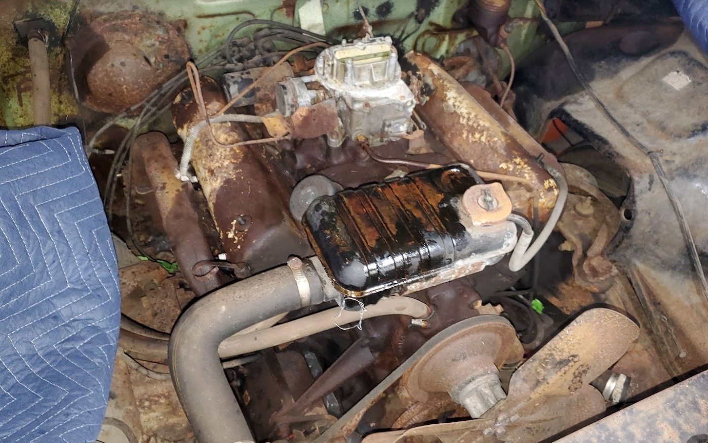

    This is its current state. I plan to lift it this out this weekend and wrestle it onto a stand.

    Here's a rocker arm too far gone. A few thousandths is one thing, this won't work.
