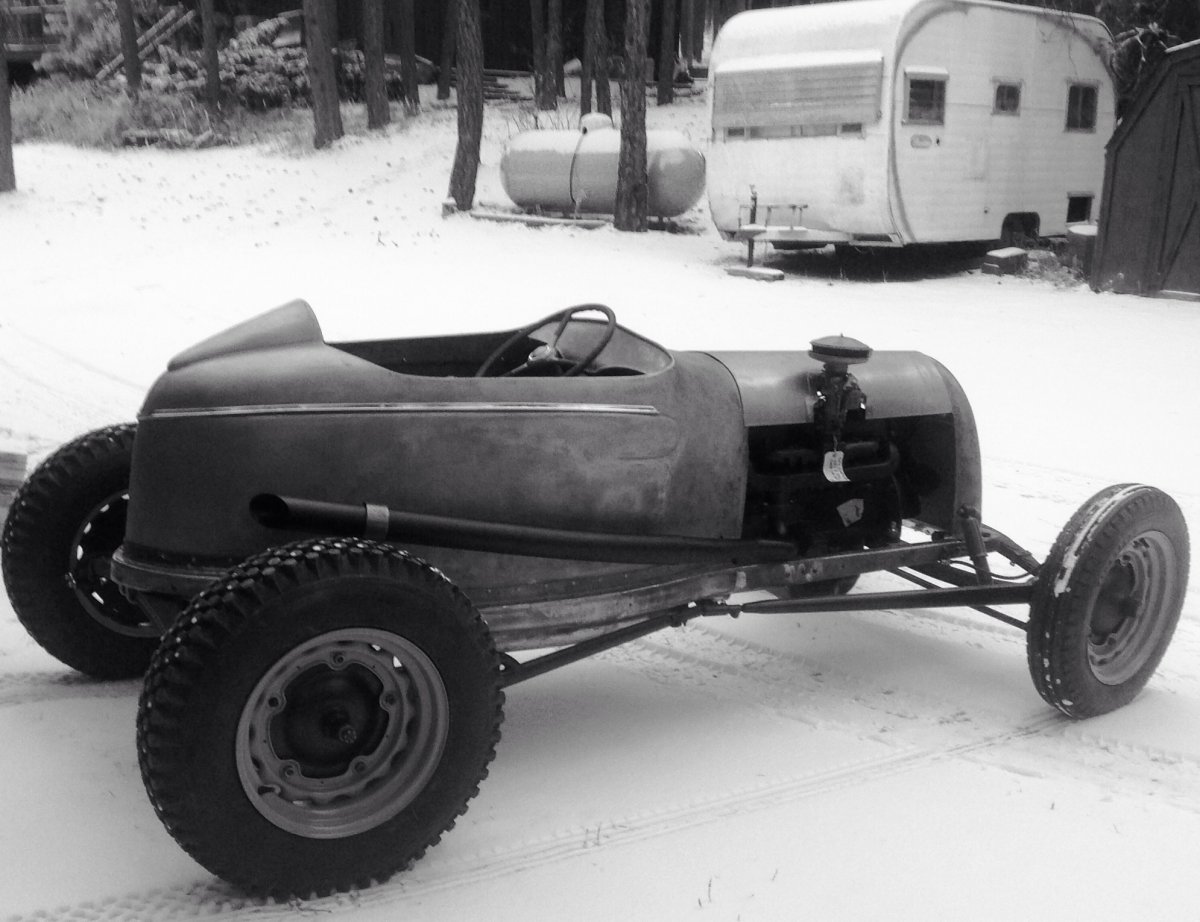

    I'm going to brush/roller Rustoleum my single seater. The stuff I read said if you let it sit long enuff you can color sand and buff it. image.jpg

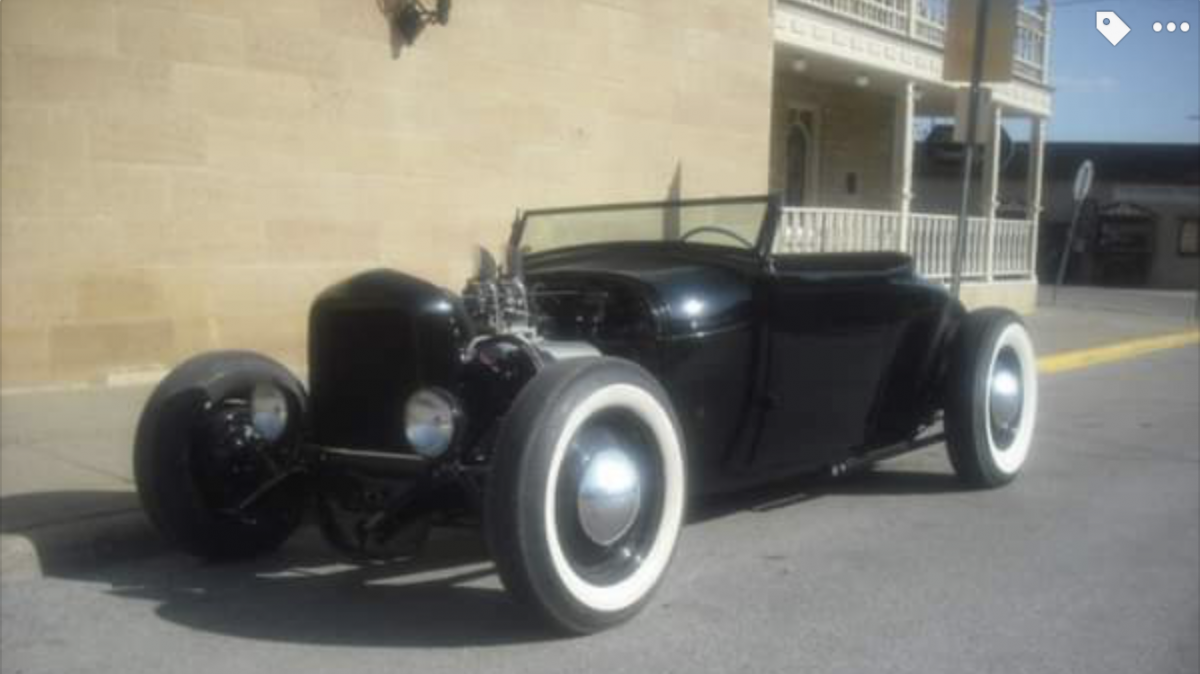

    1A6422D8-DEB5-483C-802D-D08457FF6075.png 89EF63F4-59CB-466D-90D2-037C655642AF.png I painted this car with tractor paint from fleet farm in 2009 , it looked like an authentic good 50s paint job I had it till 2012 I think it went out east and I lost track of it so not sure how well the paint has held up but I used Valspar alkyd enamel, acrylic enamel reducer and hardener , it was hard to get the paint to lay down and I got 3 runs in it trying ,they were a bit hard to sand out as it took a long time for paint to cure , I was happy with the results but in all honesty at 40.00 a gallon for cheap tractor paint, the cheaper acrylic enamel automotive paints aren’t much more money , and you get a better selection of colors than farmall red, johndeere green , and black
    Not sure what you want to accomplish with clear but I would rather just go a single stage acrylic enamel if you look into eBay , summit or even paint guru on here you might find something closer to the price point you want

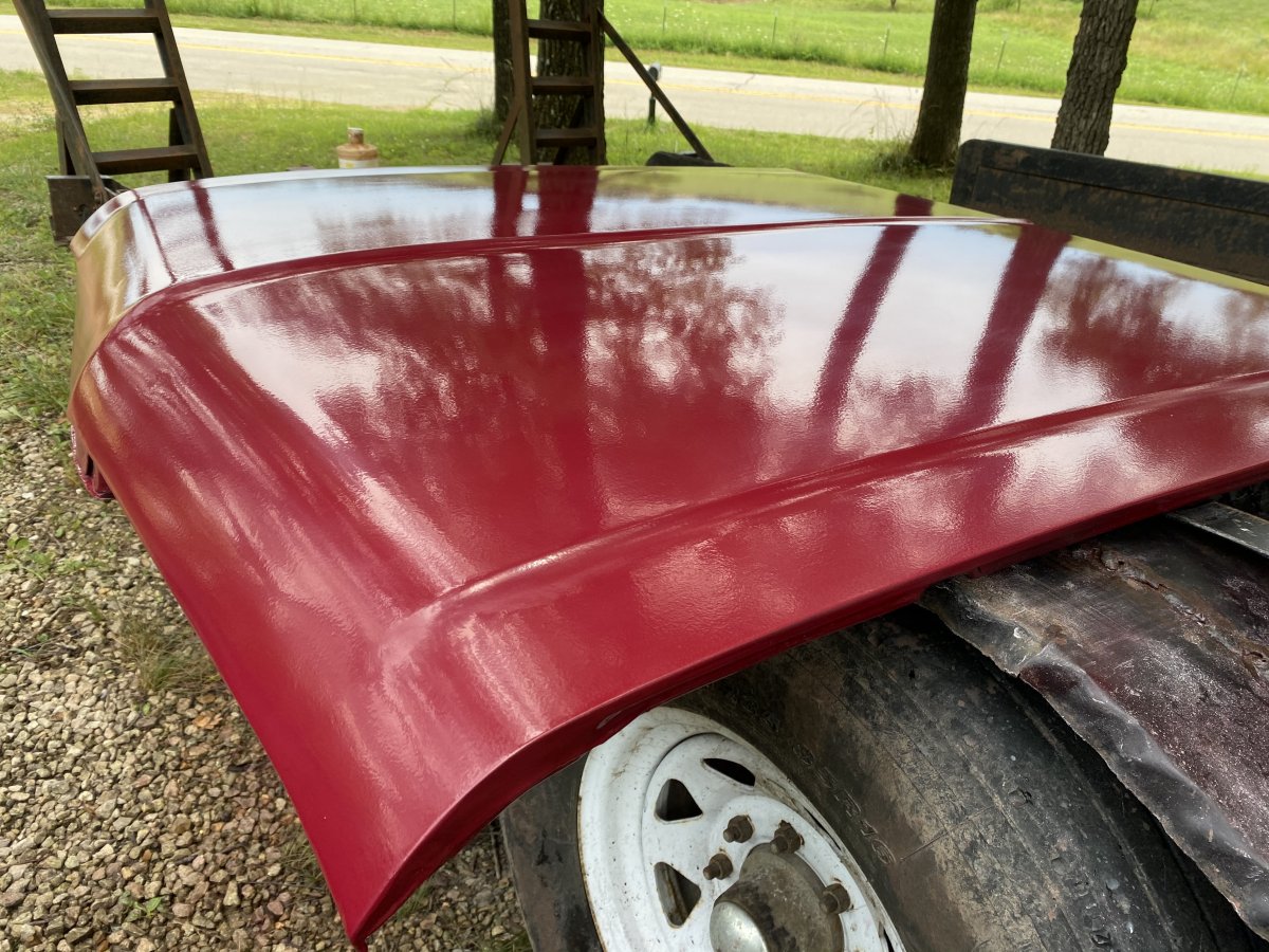

    I’ve used Rustolium on my daily driver, semi-flat black. The paint looks fine, about 4 years old. Since I’ve mixed Rustolium with generic enamel hardener, that works better. On my Nova hood, I sprayed 2 coats of Burgundy Rustolium and hardener, then followed that up with a 50/50 mixture of Rustolium and cheap urethane clear coat. It looks just fine, and color sands and polished like any other auto paint. The hardener makes the paint dry to the touch in about 30 minutes, important to me because I paint outside in my driveway. This is all quart cans, NO spray can stuff.
