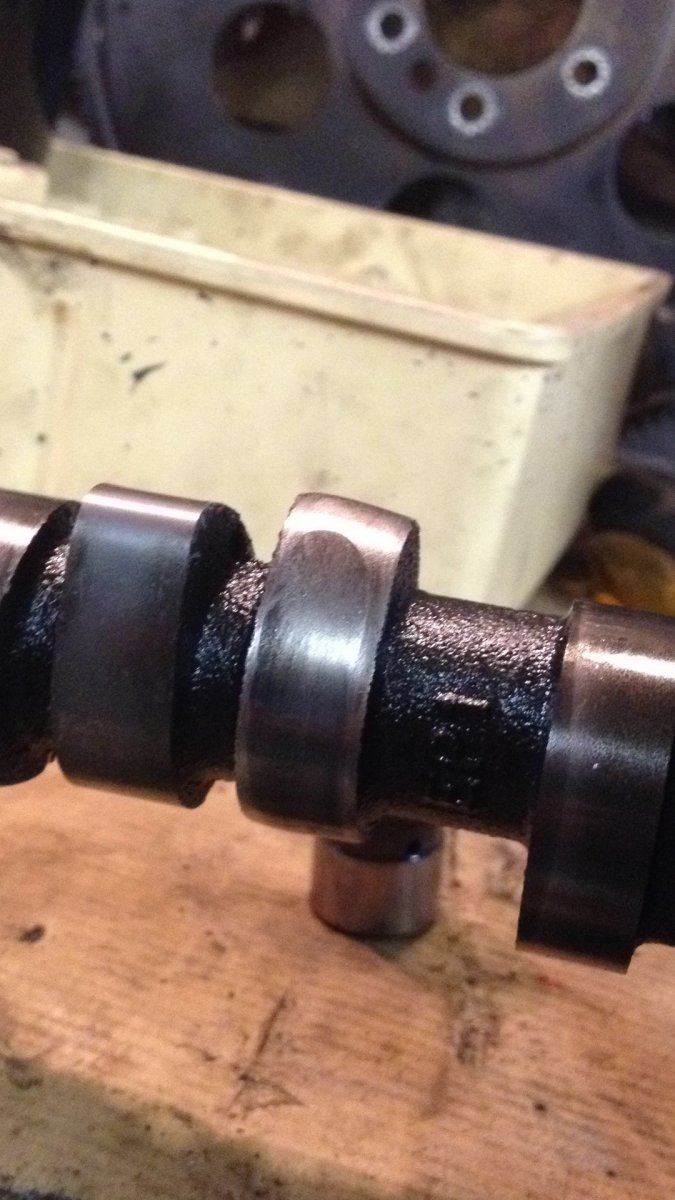

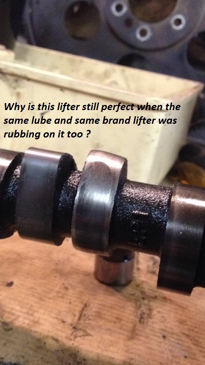

    As I rescaned thru this thread I saw a picture of a bad lobe by Baumi. He mentioned soft lifters maybe causing the problem. That caused a thought spark that I have to wonder about when lifters/lobes fail. It seems logical that in the millions of lifters produced that some will be of inferior quality......even in the same batch of lifters from one manufacturer there COULD be an inferior one. BUT given the number of cam/lifter failures I have to question whether the lifter or cam really is the problem. We also question the oil and lube products used for installation. Logic seems to dictate that if only one lobe failed, the lube was sufficient for all the others. Also, the lobes and lifters for all other cylinders were fine. If lifters were all soft or lobes not manufactured properly, then it stands to reason that all should show signs of duress.....even if they aren't as bad as the one in the picture. It doesn't seem logical that there are so many cam problems and they almost always only affect one (or two) lobes. So what I am thinking is that varnish in the lifter bores may build up to the point that one (or 2) lifters don't rotate because of the varnish/tight tolerance. That will cause failure on even good parts. Lobe /Lifter damage is a problem for all manufacturers, so you have to think its caused by something beyond their control. When you replace the parts, minute differences in manufacturing tolerance might let the next lifter rotate. Maybe the varnish got wiped out during the lifters demise. It just seeems to me that the base cause of these failures might be lack of lifter rotation rather than poor quality parts. Anyway, something to think about.

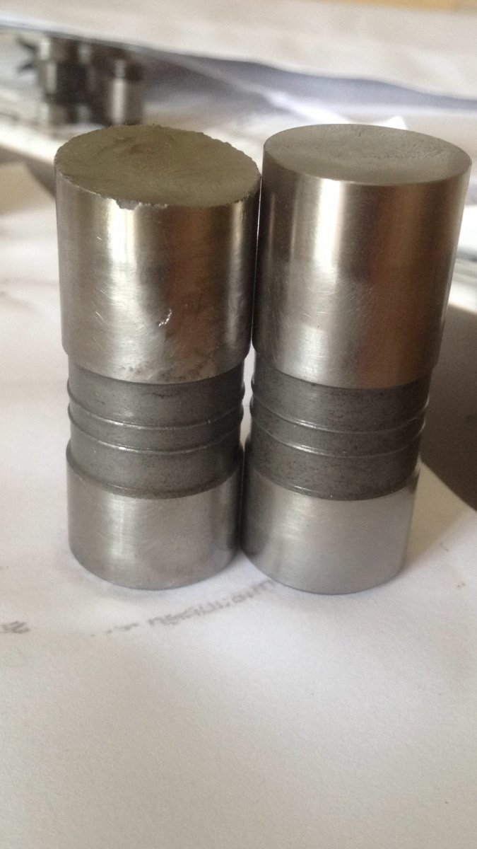

    Of course varnsih could make a lifter stick, plug an oil gallery , whatever. But that block was clean as a whistle, it was a low mileage std bore LJ 327 block. Like I said, comparing my old 327 GM cam and lifters to the repro parts, you can clearly see and feel the differance. I won´t blame the cam, I figure the new core was ground to spec , then hardened, but the bad ( soft) lifter could be damaged using simple pliers, were others couldn´t be hurt. But all of them sound a lot duller than the factory GM ones. Maybe it isn´t even due to the hardened layer, but the material under it is too soft. Think of stepping on a sheet of ice when the ground underneath is not frozen yet? The hard ices cracks off. Not so if the ground underneath is solidly frozen. I hope I can get my point across, my native language is not English , so I´m kind of challenged when it comes to explaining complex things like that. What I´m trying to say: The new lifters feel a lot weaker and softer than the old factory parts. And I´ll go out on a limp and say, when I bought a simple Edelbrock Performer RPM cam and lifter kit in 2006 it had the same feel to it like all the cam and lifter kits I bought before that and all the factory cam and lifters that I dealt with. These new enginetech cam and lifter kits are different. Just my opinion, I´m no engineer, just a hairdresser, hahahaha

    You explained well. I'm an old machinist so I'm familiar with hardened steel. The thing about many harder surfaces is that they are only hardened on the surface and when that hardened area is breached, softer metal resides underneath. Think about a nitrided crankshaft where the surface is hard but the rest of the crank is soft. It resists flex better that way than hardening the whole crank. When installing a new cam it is good practice to make sure the lifters rotate freely even though everything appears to be free. I don't doubt that the quality of some lifters is questionable. EngineTech to the best of my knowledge is not considered a premium brand, but more of a "jobber" type of part. I found an article on lifters and posted it above this. Its worth the time to read it. There is lots of information today about the quality or the lack of it and who actually makes lifters for many supposed quality brands. Its confusing at best to know if what you read is true and factual or just internet bulls**t. Kinda like walking across that slippery ice........
    Myself, I just prefer spending the extra money for a roller cam as I feel they usually have fewer problems. There are apparently two companies using the name Johnson in their lifter manufacturing. Only one of them is the correct one. I just bit the bullet and spent the extra money to order their "made in America" roller lifters. As far as I know they quit making flat tappet lifters because of the metalurgical issues with suppliers. So, I ordered their product instead of Comp which had been my favorite. I looked up the reviews for Comp lifters at Summit Racing and found there were way too many complaints. Now I have to decide who to buy a quality camshaft from..........
