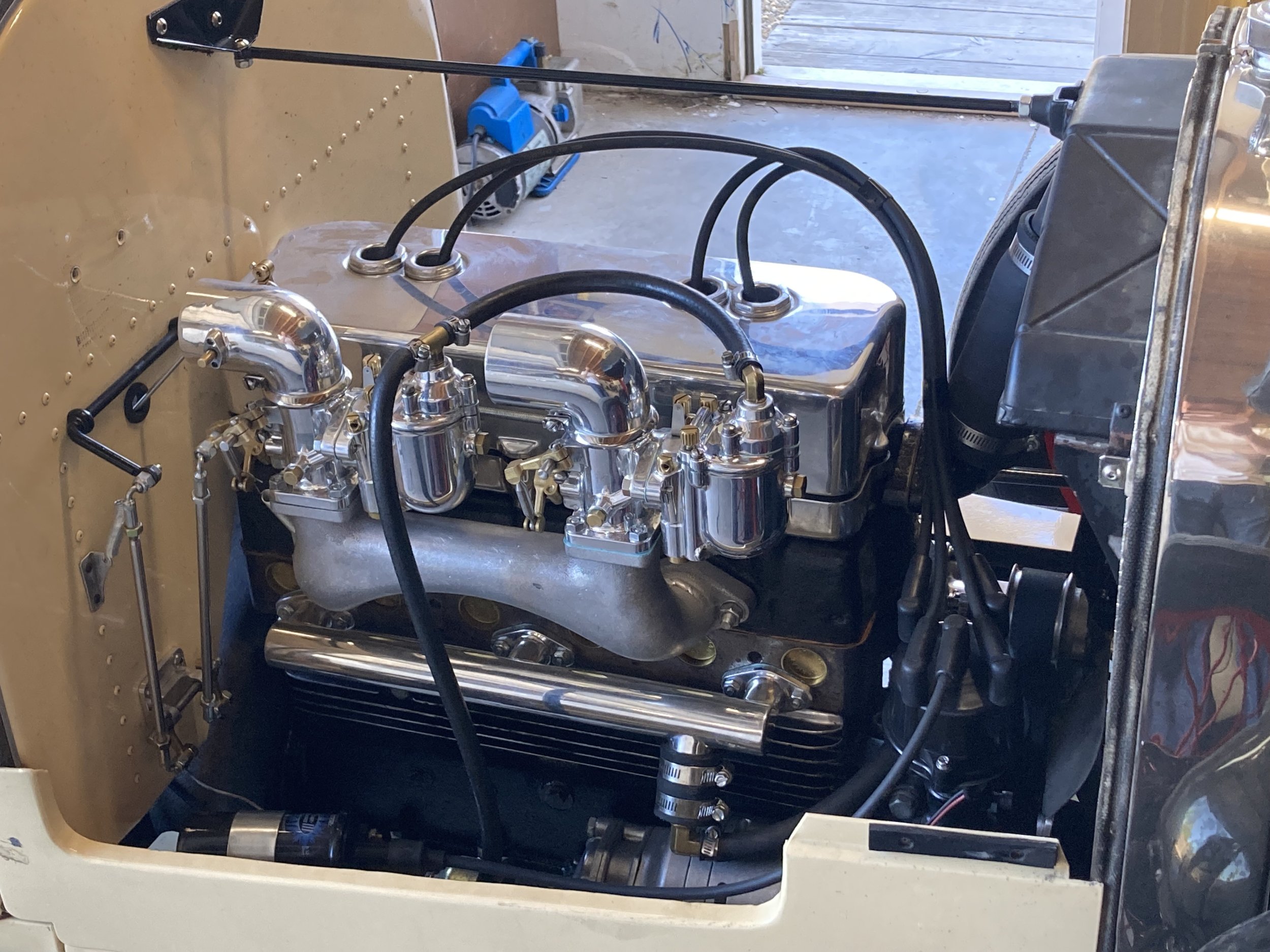

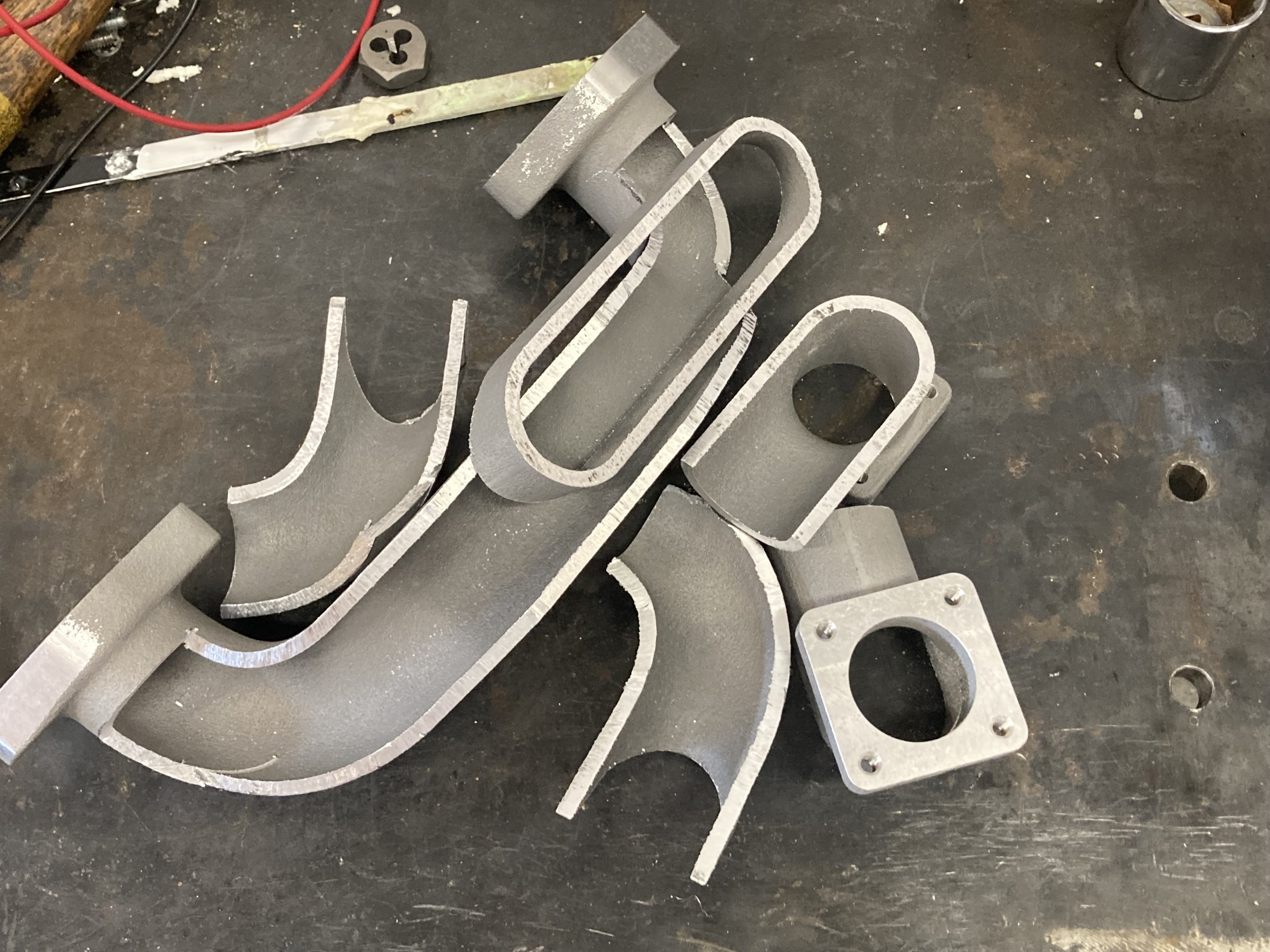

  17. Kevin Pharis
    Joined: Aug 22, 2020
    Posts: 749
    Kevin Pharis
    from Califunny
    An *** or not… Henry designed these engines around what we consider today to be ****py oils, ****py gas, and ****py roads, for utilitarian purpose.
    I have created several manifolds for T and A engines. The manifold pictured above was custom cast, then cut apart and reconfigured to resolve drivability problems on my T. If you want to think outside the box you better be prepared to invest time and money. Or you can always just order what already is available…
    Deutscher, jet996, 62pan and 2 others like this.
  18. Joe H
    Joined: Feb 10, 2008
    Posts: 1,948
    Joe H
    Kevin, do you have a picture of the manifold before cutting it apart?

  29. Kevin Pharis
    Posts: 749
    Kevin Pharis
    from Califunny
    The custom cast manifold that I cut up was originally designed to mount 2 Winfields close together for a plenum style manifold. Very similar to the “Equalizer” produced by Yapp. It worked great…! While the car was sitting still. My carbs were mounted sideways (as so many early race car pics supported was possible), but this led to extreme lean/rich running conditions during turning, accel, and decel. I suspected this would happen, but dramatically underestimated the severity. With the carbs oriented properly the carbs perform very well
  30. Kevin Pharis
    Posts: 749
    Kevin Pharis
    from Califunny
    The symptom was progressively worsening, and eventually horrible popping out the carbs under load. Since I had machined absolutely everything from scratch, of course I ***umed that something I made was functioning improperly. Endless tuning of the carbs ensued, resulting in no improvement. Sidedraft adapters were made so they the front and rear ports were isolated, problem was more noticeable with rear port.
    Carbs were swapped and the problem stayed with the rear port. Head came off to reveal that the valve seats were not installed properly and so were causing the Siamese intake charge to ignite.
    New seats and a valve job later, the popping was fixed, but the carbs had been heavily tweaked. Started with each carb individually, then after the manifold was reconfigured, the carbs were tuned as a pair
    Also made some venturi reducers to correct some overcarbing “bog”
    Still some work to do to clean up a few details, but it’s finally runnin better than ever!
    Beanscoot and ALLDONE like this.
