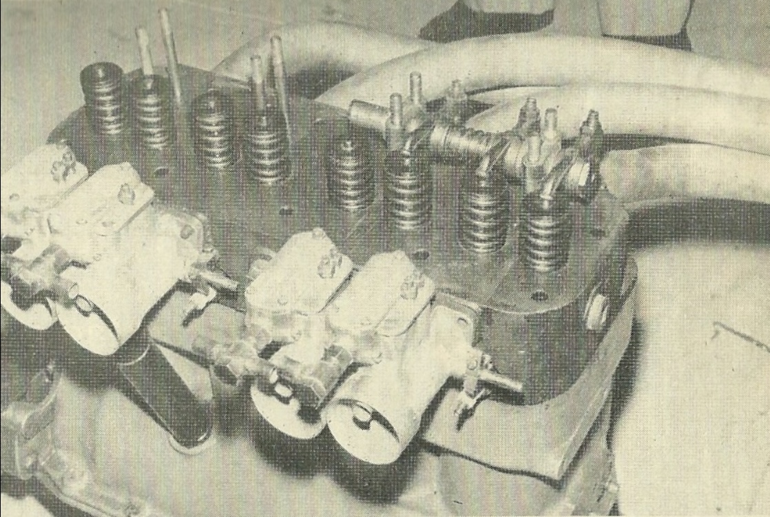

    Ed Winfield figured out the siamese port issue with his 2 up 2 down engine circa about ‘26. This T engine had a special crank made to alter the firing order so that the siamese ports had evenly spaced pulses, similar to that of the inline 6 and 8 cylinder engines. This flathead engine utilized a single carb, outran the overhead valve guys, and reportedly shook like hell!
    Winfield eventually developed a push rod head for a Model B engine. He was sure to incorporate 4 intake ports, and special built direct coupled carbs

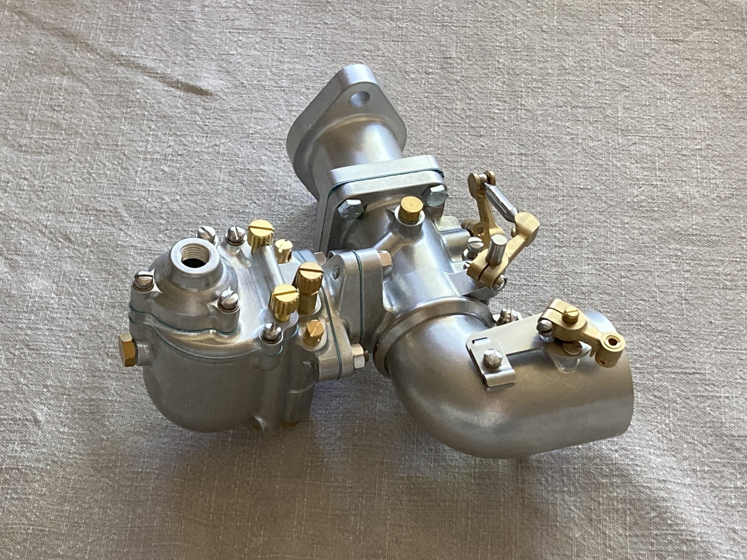

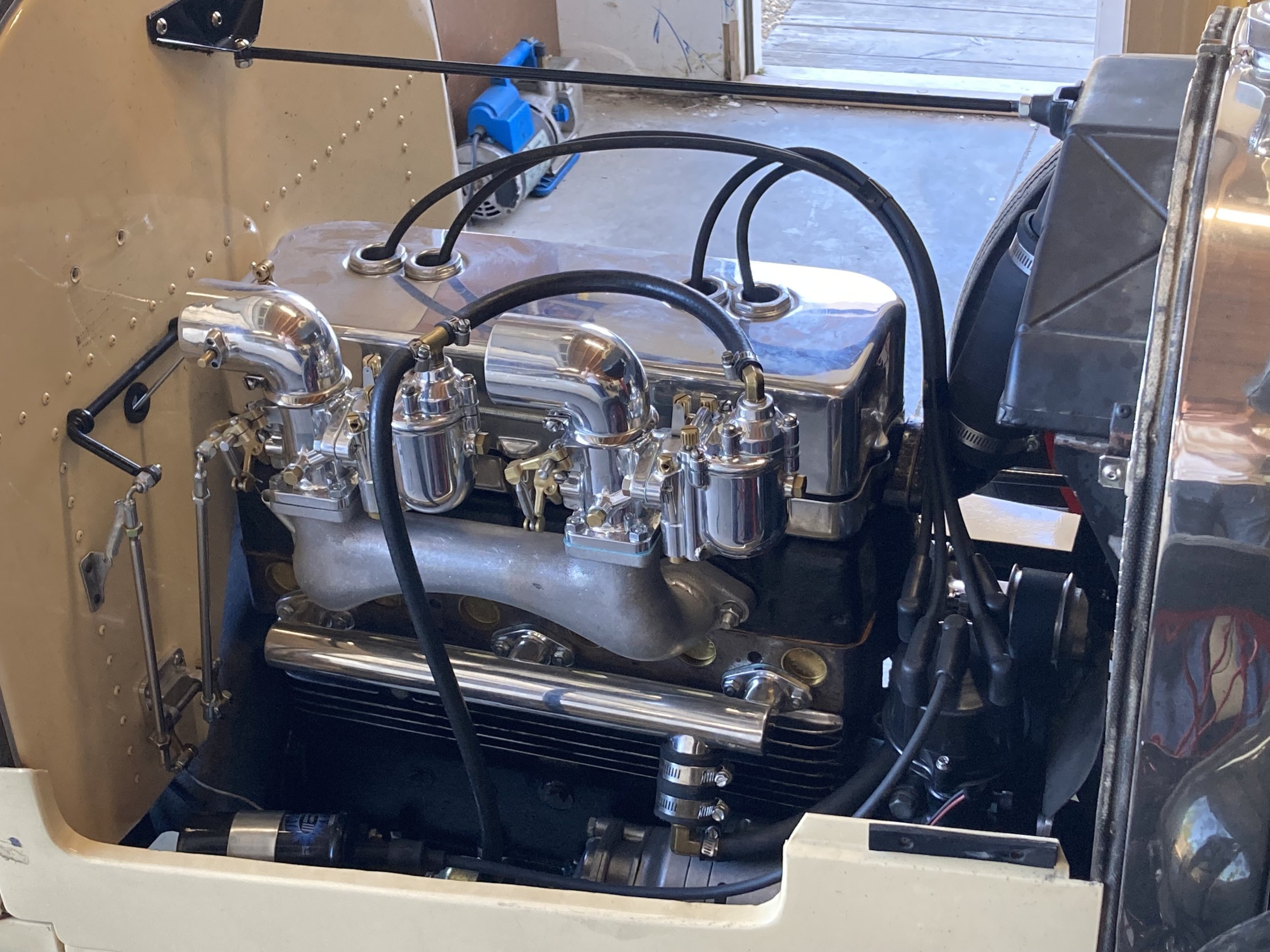

    a million thanks for the post.... thats what it all about , not good with spelling or words... but here goes the carbs I got have venturi reducers and are 26mm... i'm thinking to try one as a single..... here's what I've noticed with the down draft carb manifolds... all the ones I have....they puddle fuel in the manifold...and I can see where they go nuts with on off throttle and back and forth side to side driving... my idea... is the best way is fuel injection... and my thought is one carb close to the intake port is as close to fuel injection as one can get... I was even thinking of a screen to bust the fuel drops to put more of a mist into the manifold....on my banger, when you go to WOT.. it looks like a garden hose spraying in to the manifold,... I had a banger manifold with an intake leak, running a 81 stromberg w/35 jets..... the puddled fuel would leak down the side of the block... soooo... Im thinking there is sleeping power hiding in these bangers.... just gotta wake it up...I'm gonna keep trying stupid stuff...with the hopes of stumbling on to some thing..but I still say.... these little motors pump a ton of air. my 31 blows stuff off the peg board when I rev it up....some how one needs to figure out how to bust the big drops of fuel into a mist...

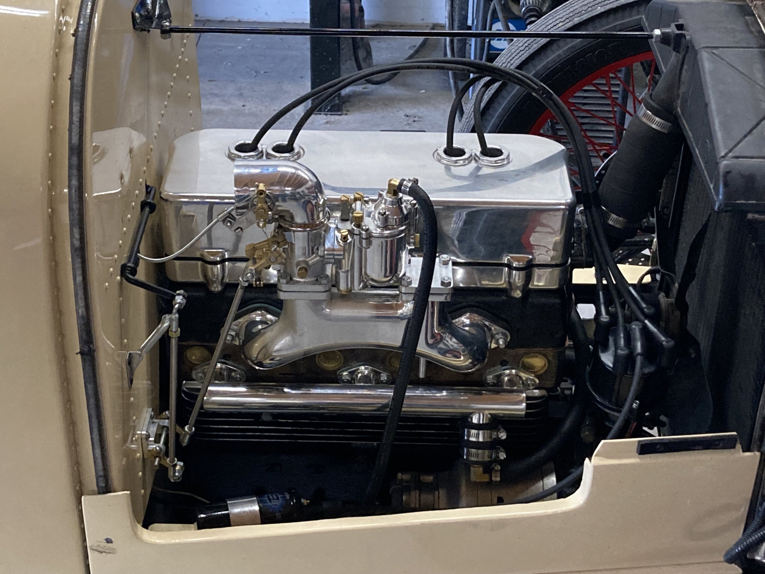

    so what I'm thinking, it wouldn't take much to get more than 10 hp per cyl.....and getting the carb closer would stop all the area that causes the puddling

    so my thought was... making the short manifold out of stainless , and welding it to the header flange... kind of a pre heater plenum... and hopefully the carb sprays more mist , compared to what the carb on it now does.....
