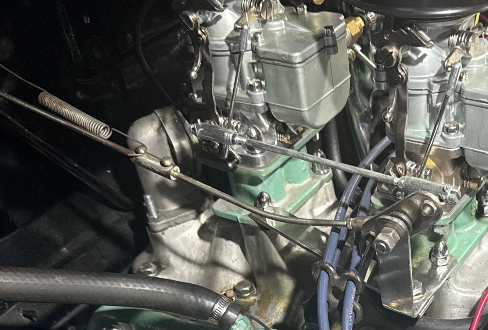

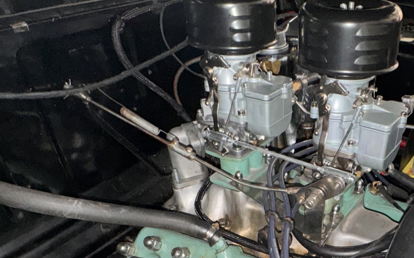

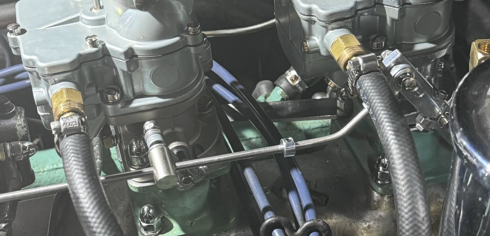

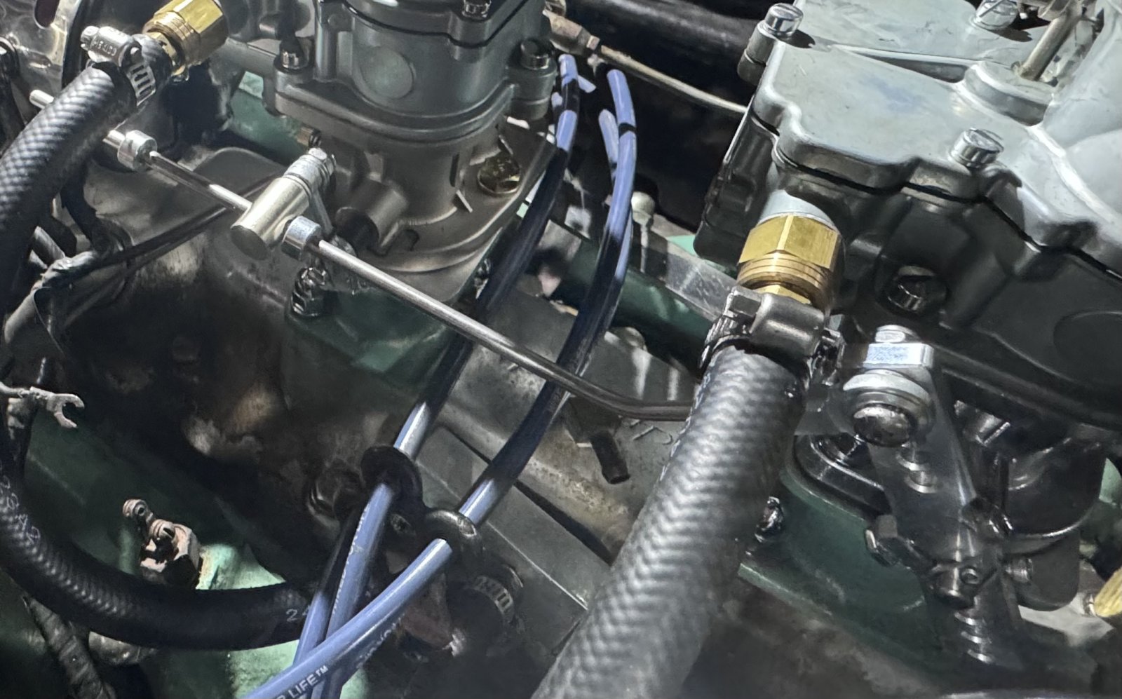

    Good afternoon…I know this post is from several years back however I believe it may apply to my question and application. It seems that my 2x2-97 (aftermarket carbs) setup (8BA) has the throttle linkage on the p***enger side of the carb. Is this proper or is there a better more efficient, less h***le, simple, and clean way to have this hooked up? I feel like there’s a lot going on. Please see pictures. Do you still sell the linkage and what does it look like installed? Thank you in advance for any ***istance you can give. Stay safe, blessed, and be well.

    Uncle Max is the best Stromberg rebuilder there is, and he deals all the parts that Stromberg sells. Look at the Stromberg website and you will find a nice linkage that connects the carbs on the left side. Then just connect the pedal to the rear carb on the right side. Order all the stuff through Max.

    Thank you kindly @alchemy. This is great info. This is exactly what I was looking for. I just couldn’t wrap my head around why both carbs on the p***enger side have all this linkage. As you can see in the pics I have a CP progressive linkage on the driver side but the p***enger side looks all complicated. So, just to confirm…I can ditch all this linkage on the p***enger side and just connect a rod/linkage from the pedal to the rear carb and I’ll be good to go? Thank you again for the information.

    Your pics are small on my phone. Can’t tell what is connected on the right side. Maybe the chokes? Don’t need throttles connecting on both sides. And actually I would run straight linkage on a dual carb, not progressive.

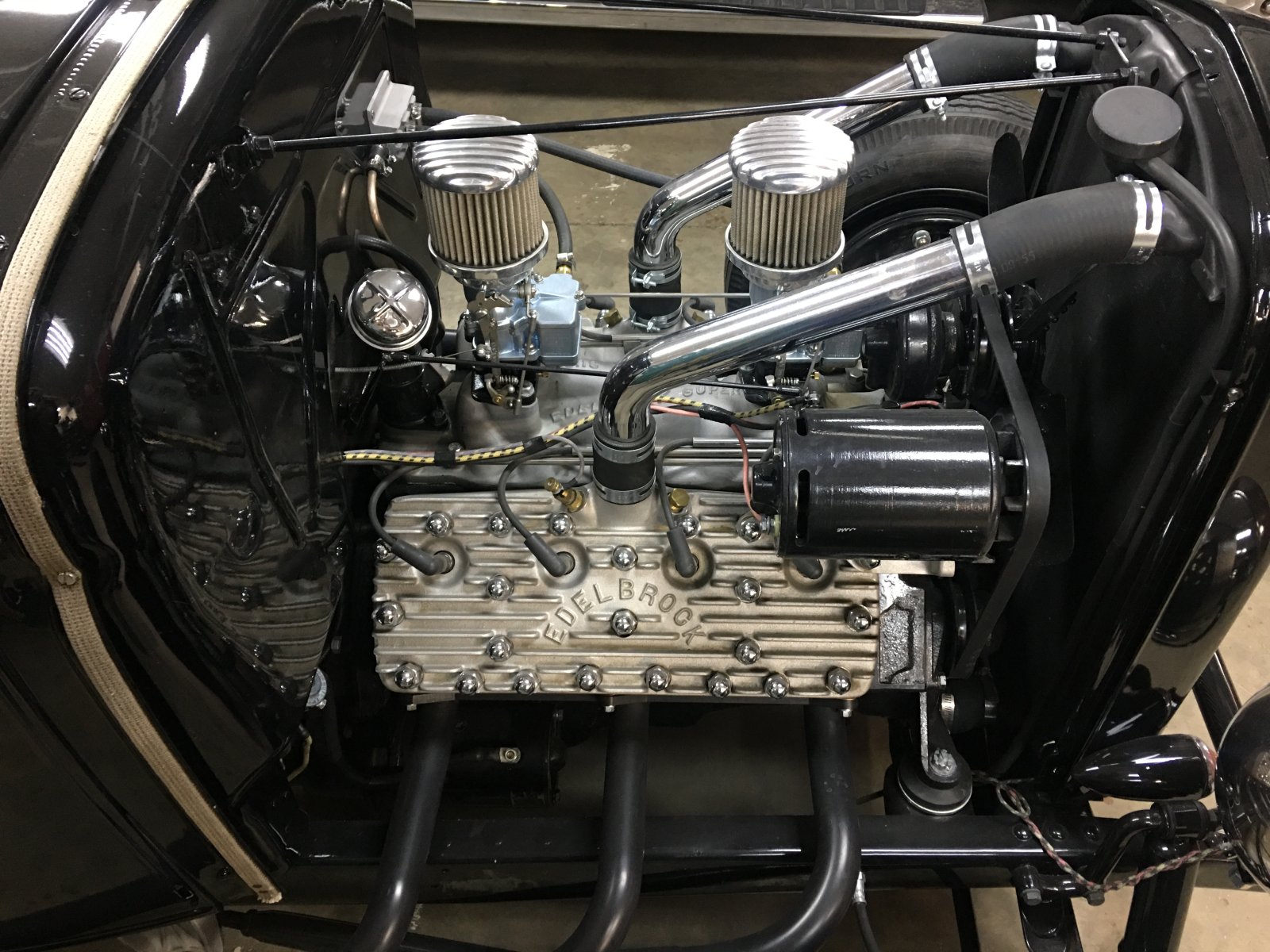

    Homemade but works great. Original Ford linkages cut and fit

    @alchemy Ok, copy that, yes chokes on both carbs. I’ve been seeing a ton of commentary on my searches and this seems to be the consensus more than not on the progressive linkage. Thanks again for the info.

    @wheeldog57 thank you for sharing the pics. That’s what I’m looking for, just a simple and reliable linkage setup.

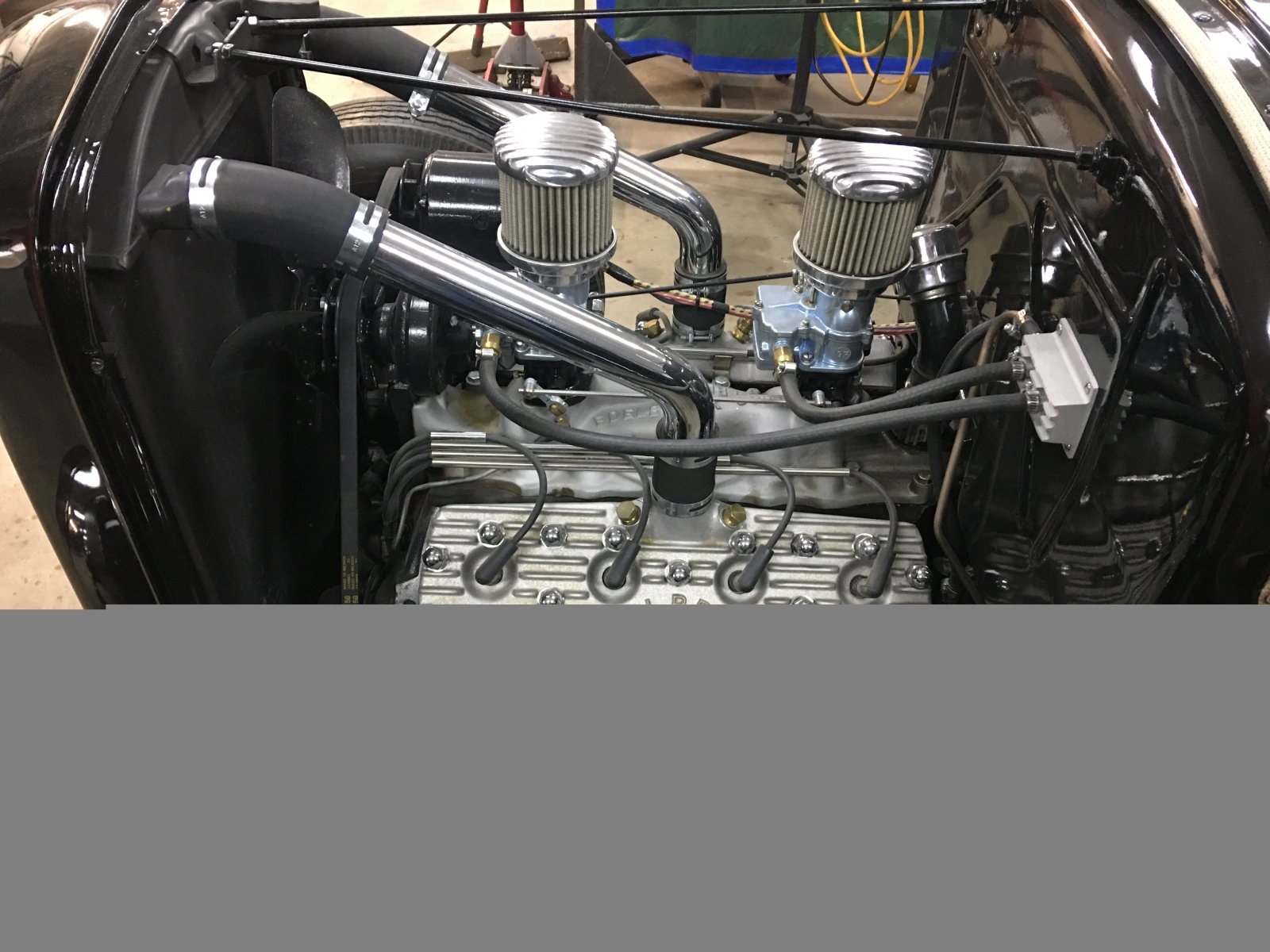

    Dog bones and non progressive linkage on drivers side for 2x2 set up, throttle pedal on p*** side. You have to synchronize your carbs to idle the same vacuum rate at idle, then hook the drivers side link together. IMG_0718.JPG IMG_0723.JPG

    @1935ply Great, thank you for sharing the pics. Looking for something just like this but obviously my carbs are shorter a distance apart.
