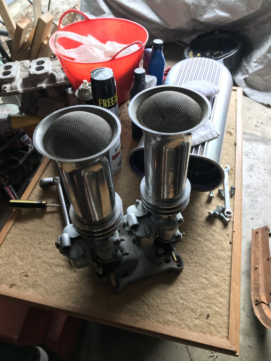

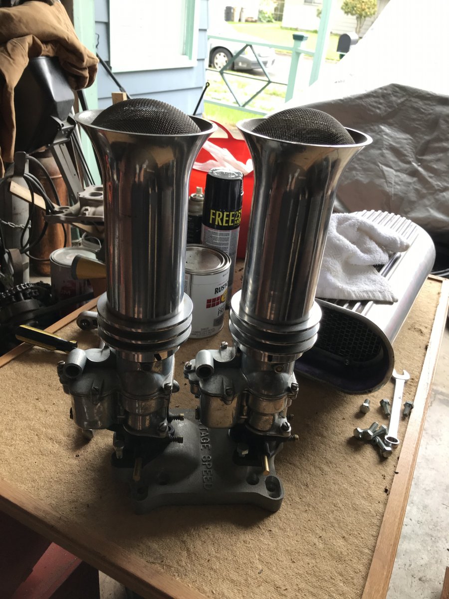

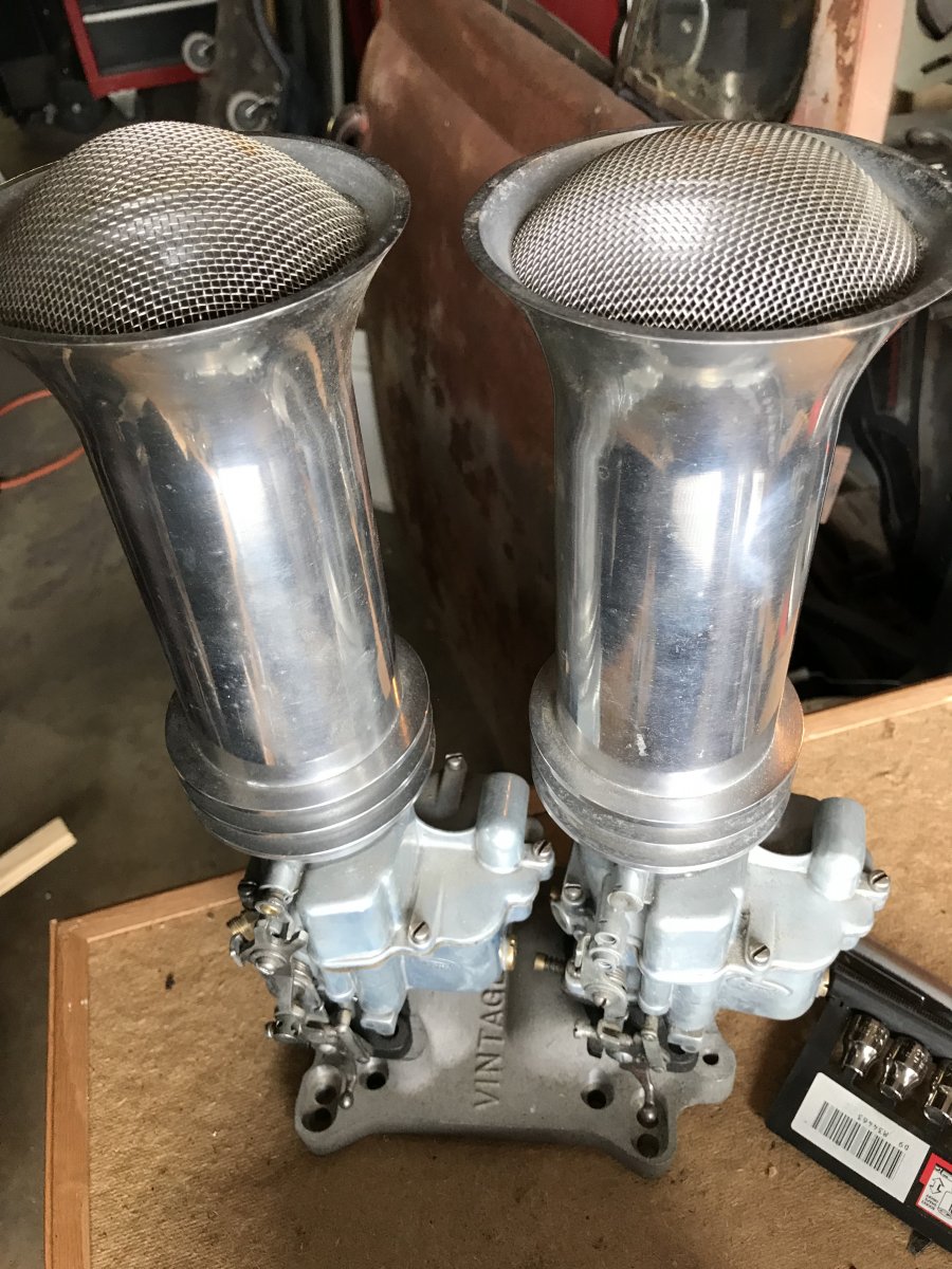

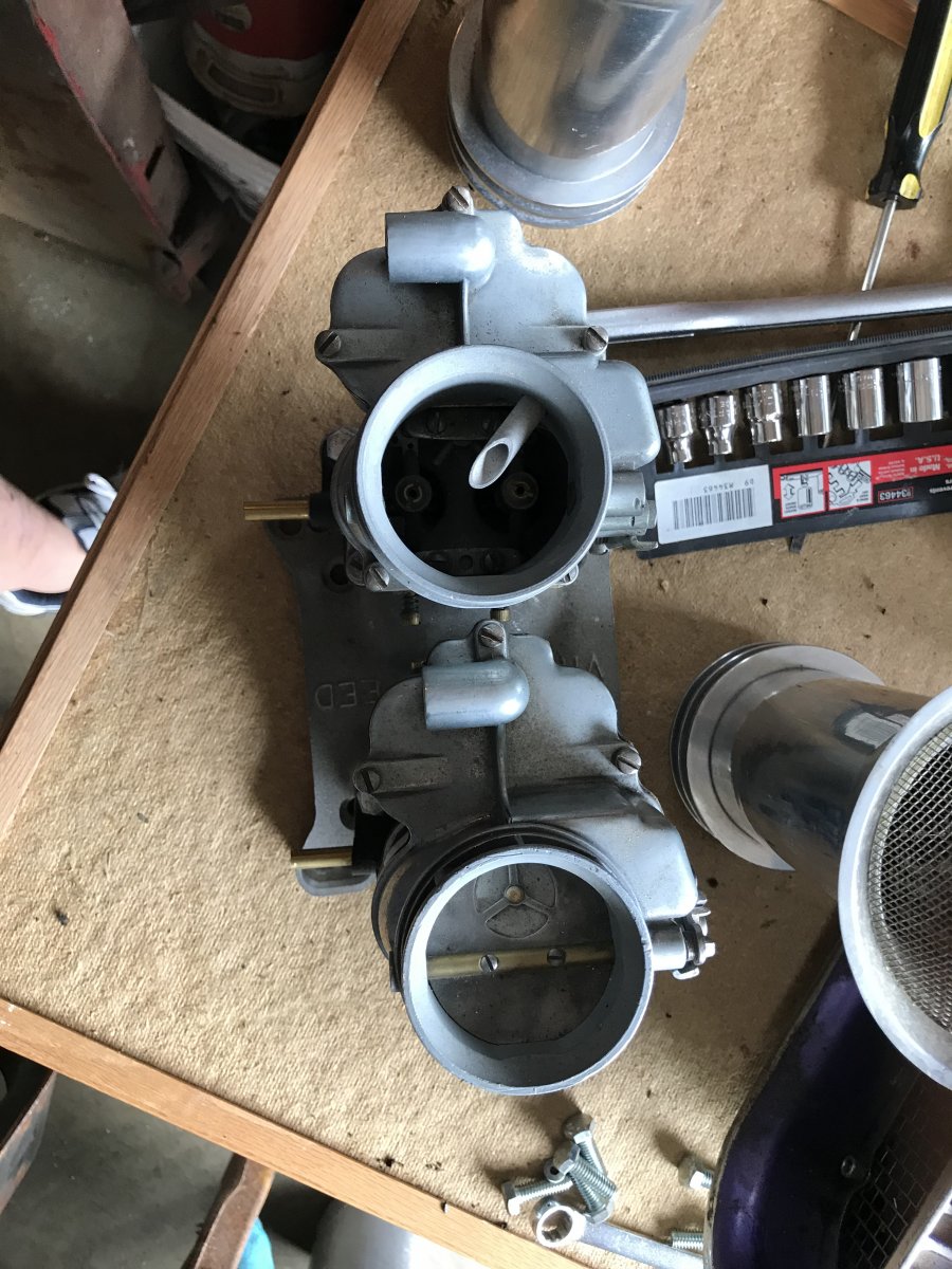

    Oh oh I have the finned adapter as well even a couple of those finned Maund stacks.

    Do you have pictures? That sounds like a pretty cool setup. I was looking at running finned stacks as well. I've got a set of MT finned valve covers to go on it. Probably paint them to match the block and polish the fins.

    Let me get some pics for you.
