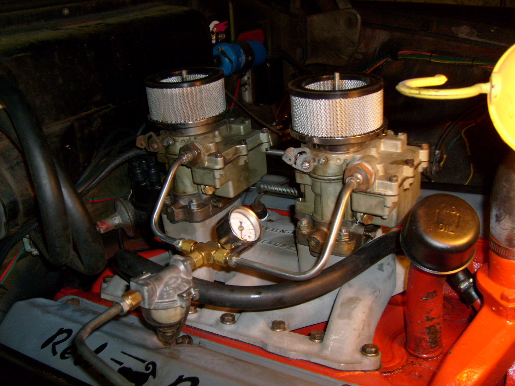

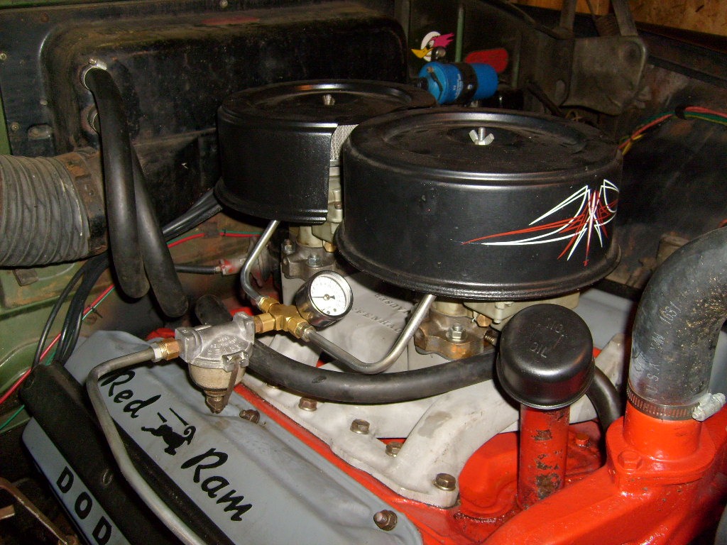

  10. junk yard kid
    Joined: Nov 11, 2007
    Posts: 2,717
    junk yard kid
    So i got a sample pack of wire mesh from mccaster car. My friend jimmy (jimmygrrr) on the hamb, had already made these air cleaner inserts, which work good but the air filter got dirty fast. Not just in the openings but the whole thing. So i made these out of the finest screen in the pack. I just cut it with scissors. Im gunna see how it works and maybe go with bigger openings in the screen. Maybe even two screens. The screens are only 12 inch squares so they are a little small on there own but the filter top and bottom held it good on its own so that is an option.
