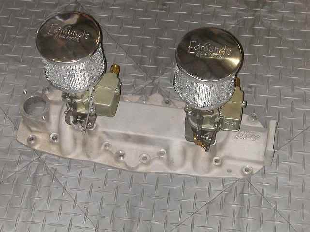

  12. Eric, What are you getting for a pair of the Edmunds air cleaners? Either the small ones pictured or the larger ones. Thanks...

    VAPHEAD
    I am on vacation starting today,will be back on Jan.5th.
    By memory the SHARP is $215.00?
    I carry all the generator bracket styles made.
    Send me a 'PM" and all answer any questions when I get back.
    ERIC
    (I don't remember the price on the air cleaners,but I do remember they are a little pricey)
