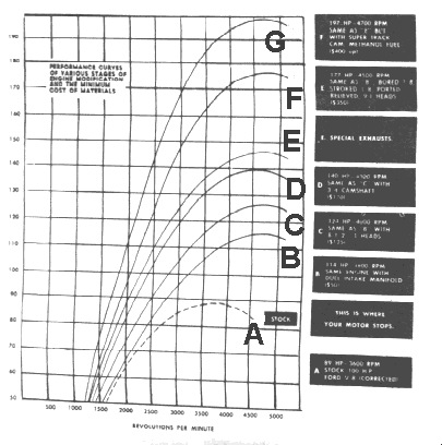

    Old dyno test from California Bill Fisher's Ford Speed Manual, 1952 Edition. You can read the full article at http://www.35pickup.com/mulligan/hotrod.htm
    <DT>A 89HP at 3600RPM - Stock 100HP Ford flathead V8 (corrected) <DT>B 114HP at 3800RPM - Same engine with dual intake manifold. <DT>C 124HP at 4000RPM - Same as B with 8.5:1 compression heads. <DT>D 140HP at 4400RPM - Same as C with <SUP>3</SUP>/<SUB>4</SUB> race camshaft. <DT>E 145HP at 4500RPM - Same as D with special exhausts. <DT>F 177HP at 4500RPM - Same as B, bored <SUP>1</SUP>/<SUB>8</SUB> inch, stroked <SUP>1</SUP>/<SUB>8</SUB> inch, ported, relieved, 9:1 heads. <DT>G 197HP at 4700RPM - Same as E but with super track cam and methanol fuel. </DT>

    I've got that book & have read it a few times - neat stuff. I love those old dyno tests...wish they'd show the torque curves with the HP curves...
