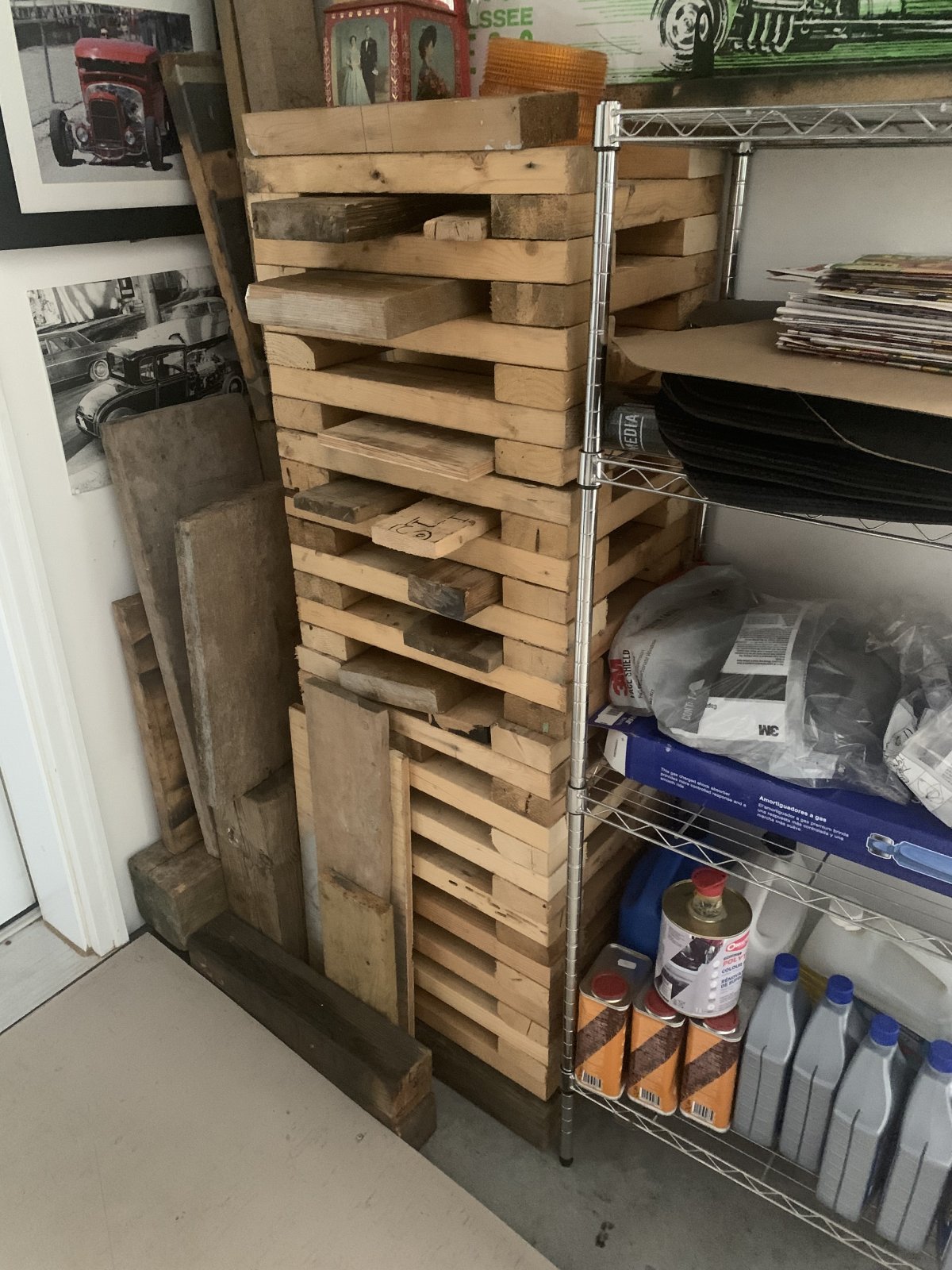

    Very Handy.I built mine(4) a few years back and keep them stored for my projects.
    18x18-2x4's
