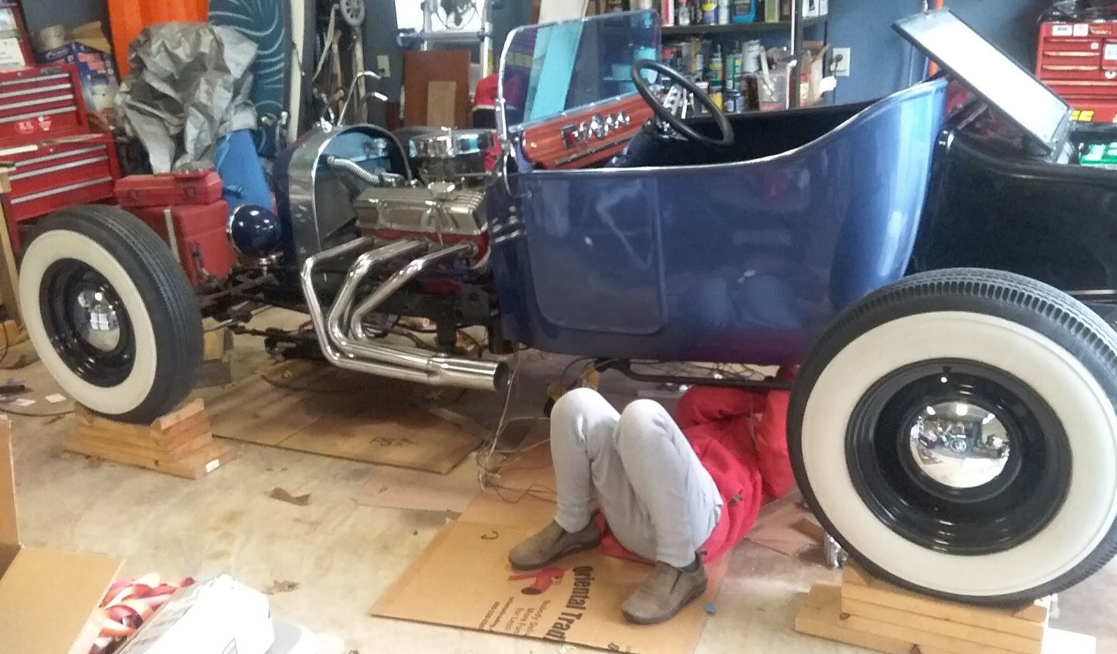

    I didn't think this would bring out so many ideas. Never thought about using different types of woods. Didn't think short (16") pieces of wood would collapse. Great answers.

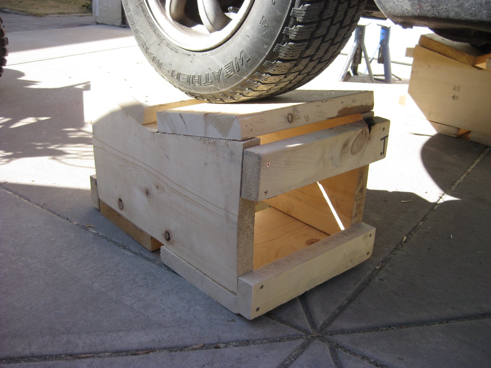

    Man, those look scary! I would not be crawling under a car resting on those stands.
    in fact most of the stands posted I wouldn't trust, the engineering skills on these stands is really suspect.

  4. OLLIN
    Joined: Aug 25, 2006
    Posts: 3,150
    OLLIN
    I just did this too. I had to lift the body up real high to take the rear and spring out in one piece.
    I did mine 16" because the 2x4 comes 96" long, so there was no waste.
    In the past Ive made them out of "Pallet stickers" I believe they are called.
    Go behind the Home depot and ask them. They will probably give it to you free..

  10. Blues4U
    Joined: Oct 1, 2015
    Posts: 8,221
    Blues4U
    from So Cal
    Yeah, and rat rod guys probably say the same thing when they are criticized for the poor engineering they use in their builds. Come on, we should be better than that around here.
    I would say that the cribs created with 2 x 4's stacked in alternating directions are the best designs, but unless these are made with a hard wood, and I don't think any posted are, at most I would keep the weight at 1000#'s per crib, and that would make me queasy. Let the weight down slow and watch for bending of the boards, and if they bend, don't go with it. You're approaching the structural limits.
    But these, no way, these are a death trap waiting to happen:
    The biggest problem is a lack of strength in horizontal forces, those things are gonna collapse like a house of cards. Those wood screws holding things together are not up to the task. And the tops are a simple V pattern with no blocks to keep the wheels from rolling.

  18. goldmountain
    Joined: Jun 12, 2016
    Posts: 4,987
    goldmountain
    Thank you for the input. I admit that the cross bars screwed into the end grain isn't very strong, the boards across the top and bottom should work out.
