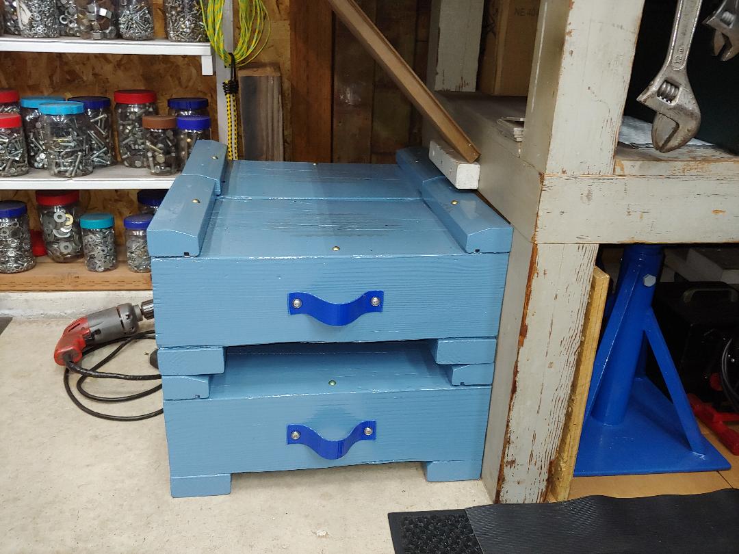

    The casters are scaffold wheels, the whole thing comes apart and stands against the wall when not used. What does scaffolding weigh? "You shoulda used wood! Waste of money and material!" Ok, maybe next time. Yes, that's a Duesy Murphy Roadster body, currently there's Deuce 4dr body on it. Safe n effective.

    I was surprised by all the negative comments on my stands since they seem to be very sturdy and I prefer them to jackstands. But since I am not a structural engineer, don't want to be a candidate for the Darwin award, and you guys might be right; a recall was in order. I have added some straps. IMG_1792.JPG

    Looks plenty solid to me goldmountain, your initial posting got a poor review because of the sun glare & casting shadows & like myself many I'm sure were scratching their heads, good to see you heeded the word with regards to fastening in the end grain.

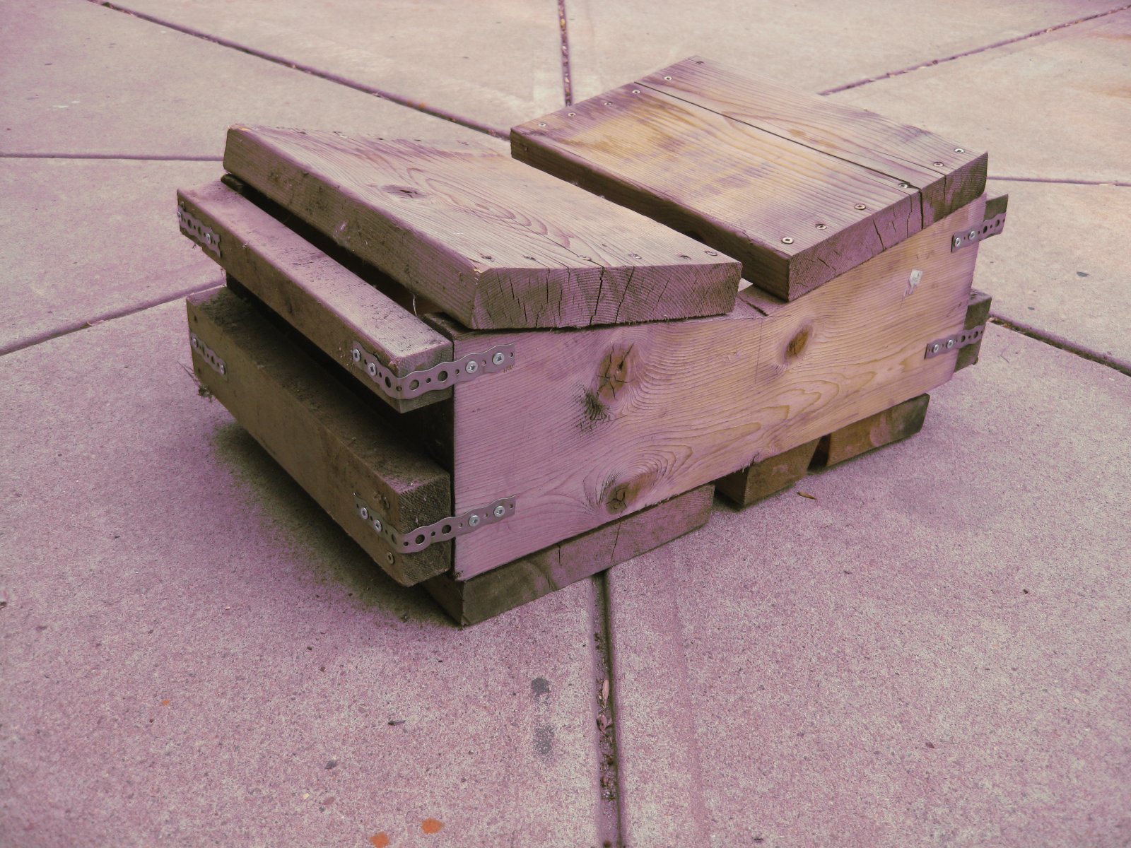

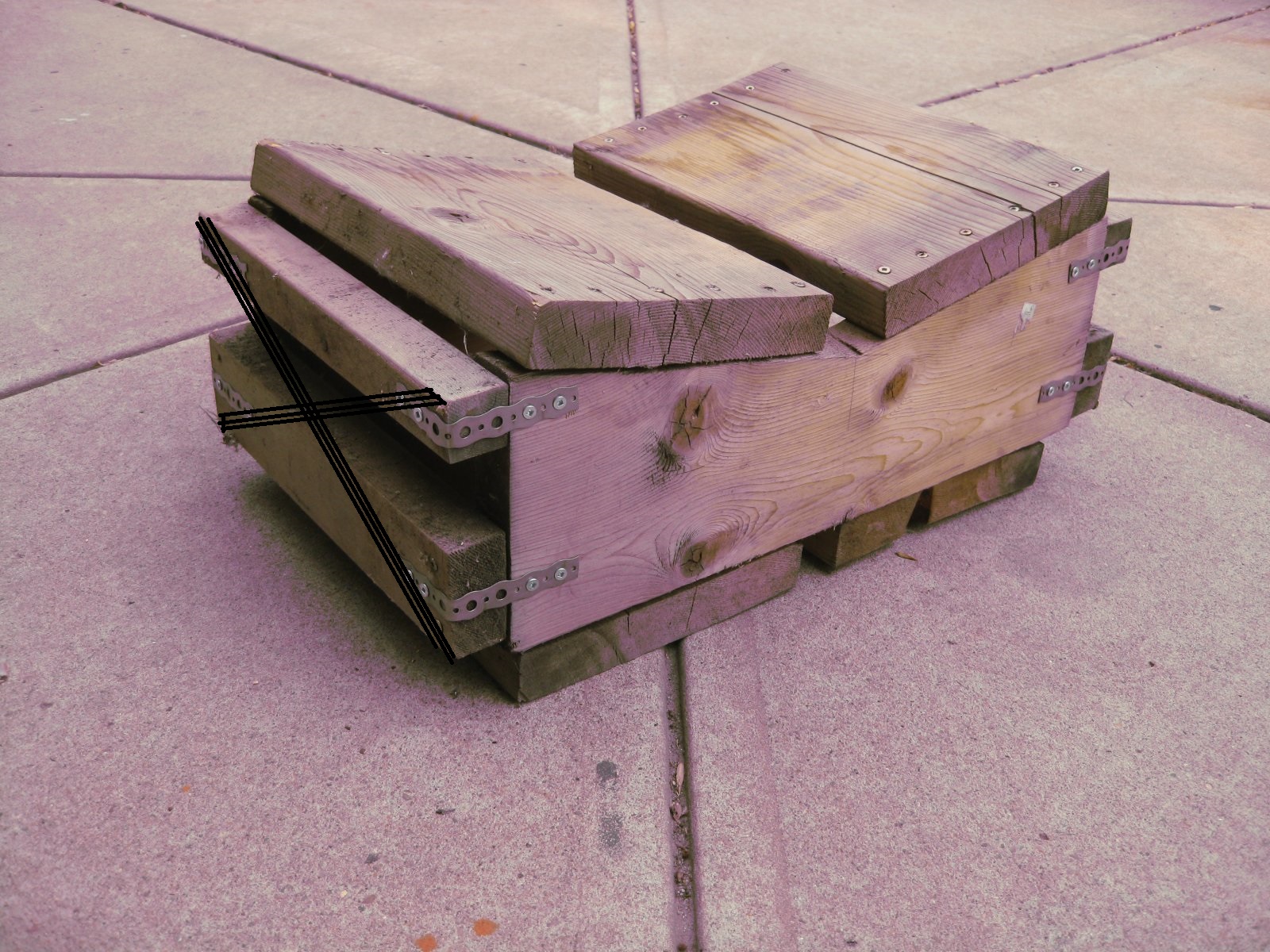

    I'm sorry man, I don't want to criticize you, but those straps aren't going to do ****. Think about it, if you have 4000 #'s of car sitting on those stands and they start to go, do you think those little straps are going to do any bit of good at all?
  13. AccurateMike
    Joined: Sep 14, 2020
    Posts: 833
    AccurateMike
    Think diagonal sway braces, like shelving or scaffold. Completely loose the horizontals. They will twist right out when it parallelograms over.
    No horizontals, strips of flatbar. Your car is light. Mike

    @AccurateMike is right. Those straps aren't doing much, because the horizontals they're holding aren't doing much. You need something to resist lozenging, i.e. deformation into a parallelogram shape. Flatbar could work, as could diagonal wooden braces in both directions, wedged between the uprights. They obviously don't have to be in the same plane. 2"x2" should do it.

    Just add a small piece of 2x4 under each cross bar in the stack, you now have solid wood top to bottom.
    Using an online calculator, Douglas Fir has a .003" deflection rate at 10" span with a 1000 lbs on it, laying flat. Half that with two pieces of wood. The tire also spreads the load out across the span. If it makes you feel better, add one layer of 3/4" ply wood in the center of the stack.

  20. Or as I mentioned in a previous post, just sheet the ends with some plywood tying in the top, bottom and both uprights to triangulate everything. Just ditch those 2xs that are strapped alltogether

    He has at least 26 screws holding one side together. How much has it weekend the side end cap.

    My problem with this set up is no diagonal support, like you mentioned! That space in-between the 2x4s should be filled in with a 2x6, to prevent sideways collapse. As for the car setting on the two 2x6/8s , that should not be a problem. I regularly drive my 30,000 lbs motorhome up on one short 2x8s like this and have never broken one! There are two ,here , supporting one wheel on a heavy car would only be 500 lbs per board. My motorhome puts close to 8000 lbs on the boards. Granted the span is not quite as far as this…..but close.
