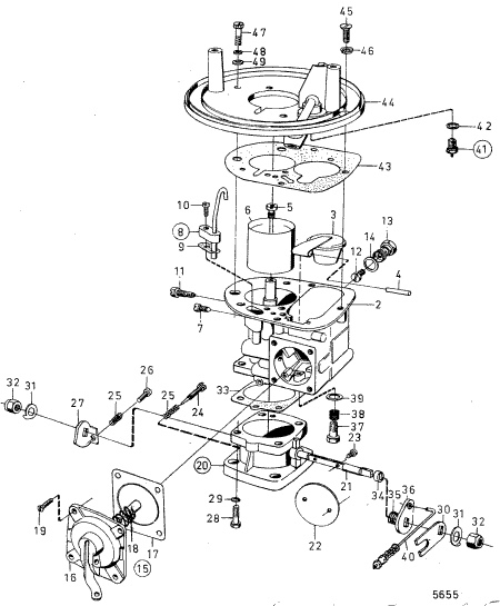

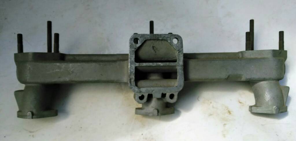

    On that subject, this is an intake for Volvo B18 & B20, the 1.8/2.0l 4 cylinder little brother of the 3l six you got your carbs from. Origin unknown, but it allows the use of either one or two 1 3/4" SU carbs.
    loudbang and volvobrynk like this.

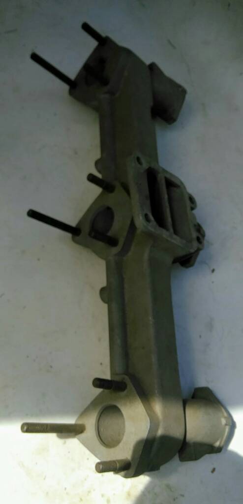

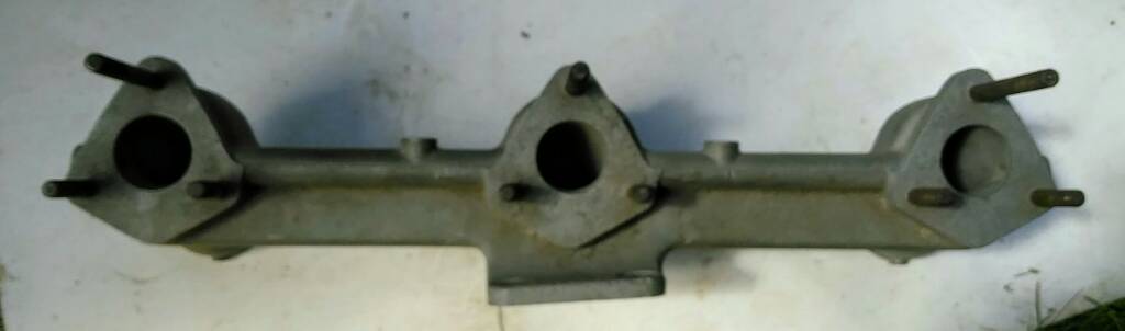

    Yes, and that is from a B20B, B18D looked different
    This is the desires B18D separated cast Alu intake
    This is the B30A intake
    G-son likes this.

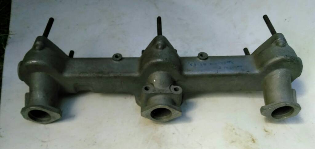

    Some one say Corvette intake......just happen to have one...... I have more pics if interested if your looking to fab one up.......[​IMG][​IMG]
    Sent from my QTASUN1 using The H.A.M.B. mobile app
    loudbang, volvobrynk and 6inarow like this.

  11. Rusty O'Toole

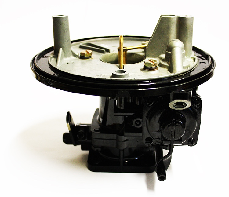

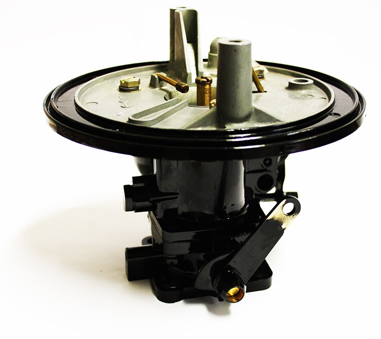

    I got three carbs in my stash, that is a matching set of 3 Solex 44 PA1 downdraft carbs, that's 1.73 inch bore, with a 1.25 inch Venturi.
    It's surpose to flow ballpark off 200 CFM, can be a little more depending of year. Some sources say 210 CFM.
    Will this be more fitting for a stock 235?
    Or should I just spend more money on a third SU HIF6?

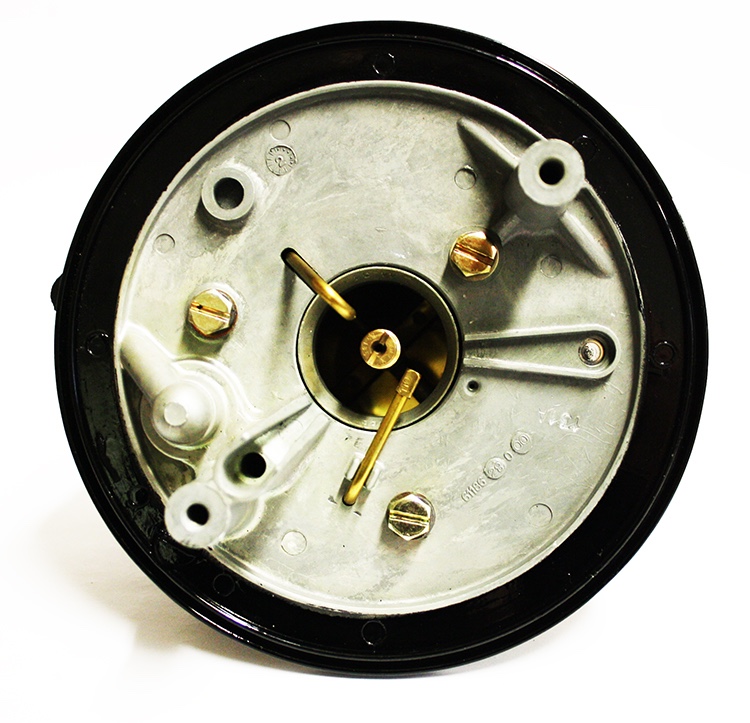

    This is the carb in question
    tb33anda3rd likes this.

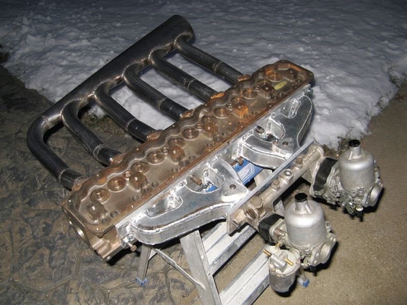

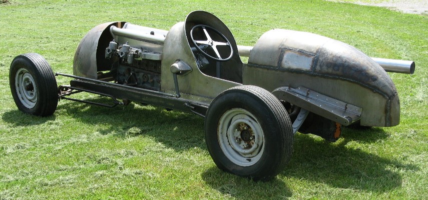

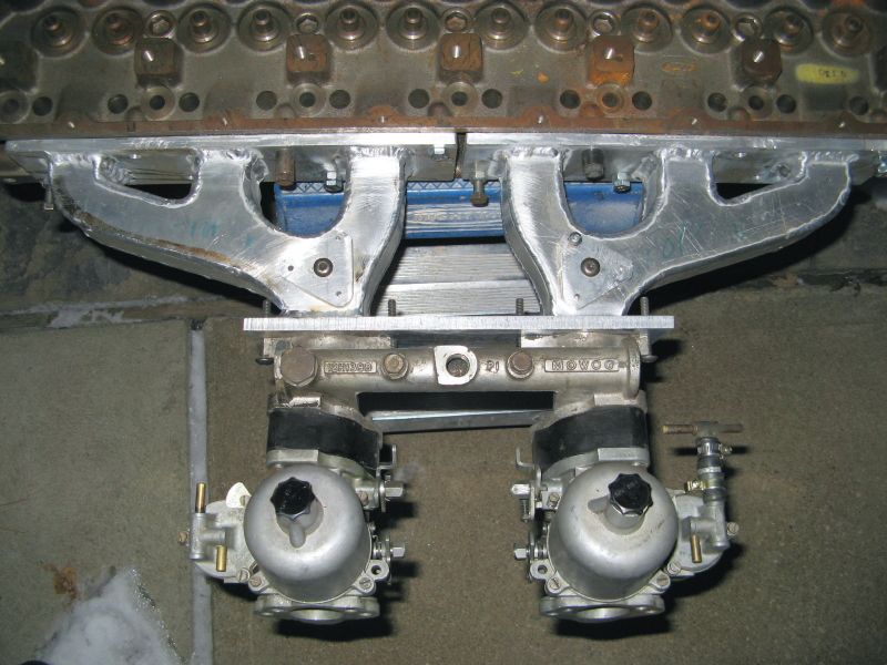

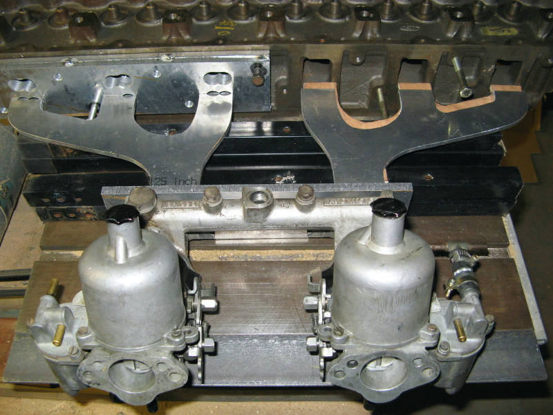

    Volvobrynk, I think you are following my champ car build thread, but you mentioned you like the 300 Ford and if you haven't seen this 2 x SU intake I made here are some more pics. I plan on two HS-6s.
    If that is not enough I'll build an intake for three SUs.
    Or five.
    Or six.

    Volvobrynk, if you go with the downdraught Solex 44pai carbs on an unmodified Chevy 235 inline 6, 2 carbs are all that you need. I have used 3 of the Weber 34 ICH carbs with 29mm chokes (main venturi) on a modified 250 inline 6 but with the larger 31.75mm venturi size of the Solex, I would suggest staying with a pair of them. If you want to use your original iron intake manifold, weld or braze 2 carb base plates to it evenly spaced between the 3 port openings and blank off the original center carb mount with a blanking plate.
    Beautiful work, Frenchtown Flyer! Love the dual SU intake!

    The HS3s pictured have been replaced by two Mikuni copies, roughly equivalent to HS6s. These Mikunis were used on a Datsun 240 / 260 Z. Although originally fitted to a smaller engine. The Zs revved to a higher speed than my 300s so the airflow should be about right at 4500, my engine's sweet spot.
