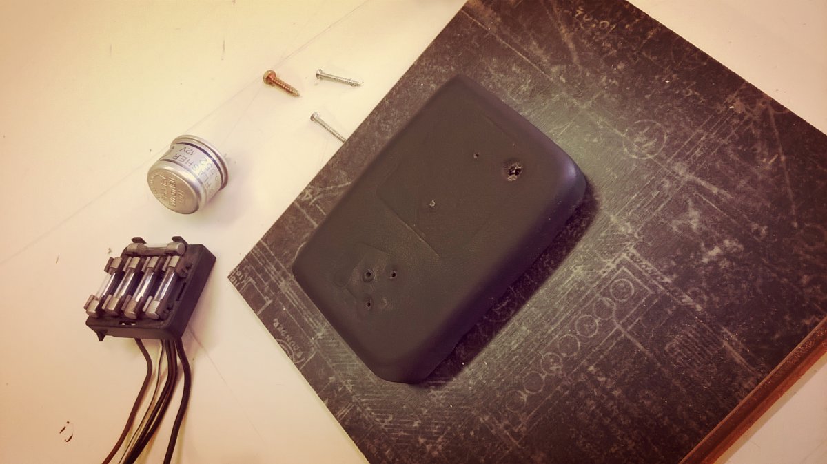

    The basics of the panel revolve around a hand me down motorcycle fuse block with gl*** fuses. A headlight socket that serves as a plug for a flasher and a cheap sample of Pergo flooring for a base...

    To mount the fuse block and flasher, I covered a s**** of wood with leather and routed the wires thru it.

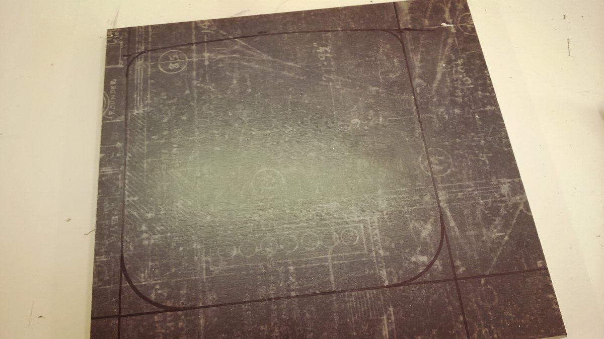

    fuse panel 3.jpg Next I cut the Prego sample base (cost 75 cents) to create a sold mount for the panel. Once mounted, I attached the buss block to direct the voltage.

    How do you know which wire the fuse protects? Bob

    You choose the circuit... the panel feeds power to all the fuses from the switched circuit and the power out of the fuse feeds what you decide... I.E. Horn, Gauges...etc...

    What is inside the box on the piece of floor tile? Can you show the back side?

    He said it was a s**** of wood wrapped with leather.

    Ok, Seven wires and five fuses why are two missing?
  14. K13
    Joined: May 29, 2006
    Posts: 10,016
    K13
    The flasher has two wires.

    Hooray for gl*** fuses. What motorcycle exactly is the fuse panel off of?
    For those who need more fuses, use two.

    Thanks for the kudos... I wish I knew what the fuse block was from. I'd take an entire stack!
    In reality it's only 4 fuses. The top horizontal mounted fuse is a spare.
