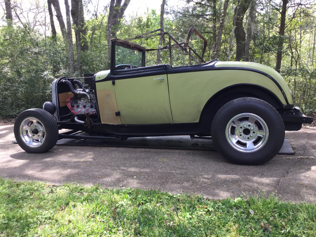

    image.jpeg image.jpeg I have a 2:75 gear in a 9 in with a relatively small flathead.I have to be running80 to engage 5th gear as the engine lacks the torque to pull 5th until higher illegal speeds. I think your 3:54 gear is good for the t-5. My Henry cabriolet weighs 2200 on the scales.
