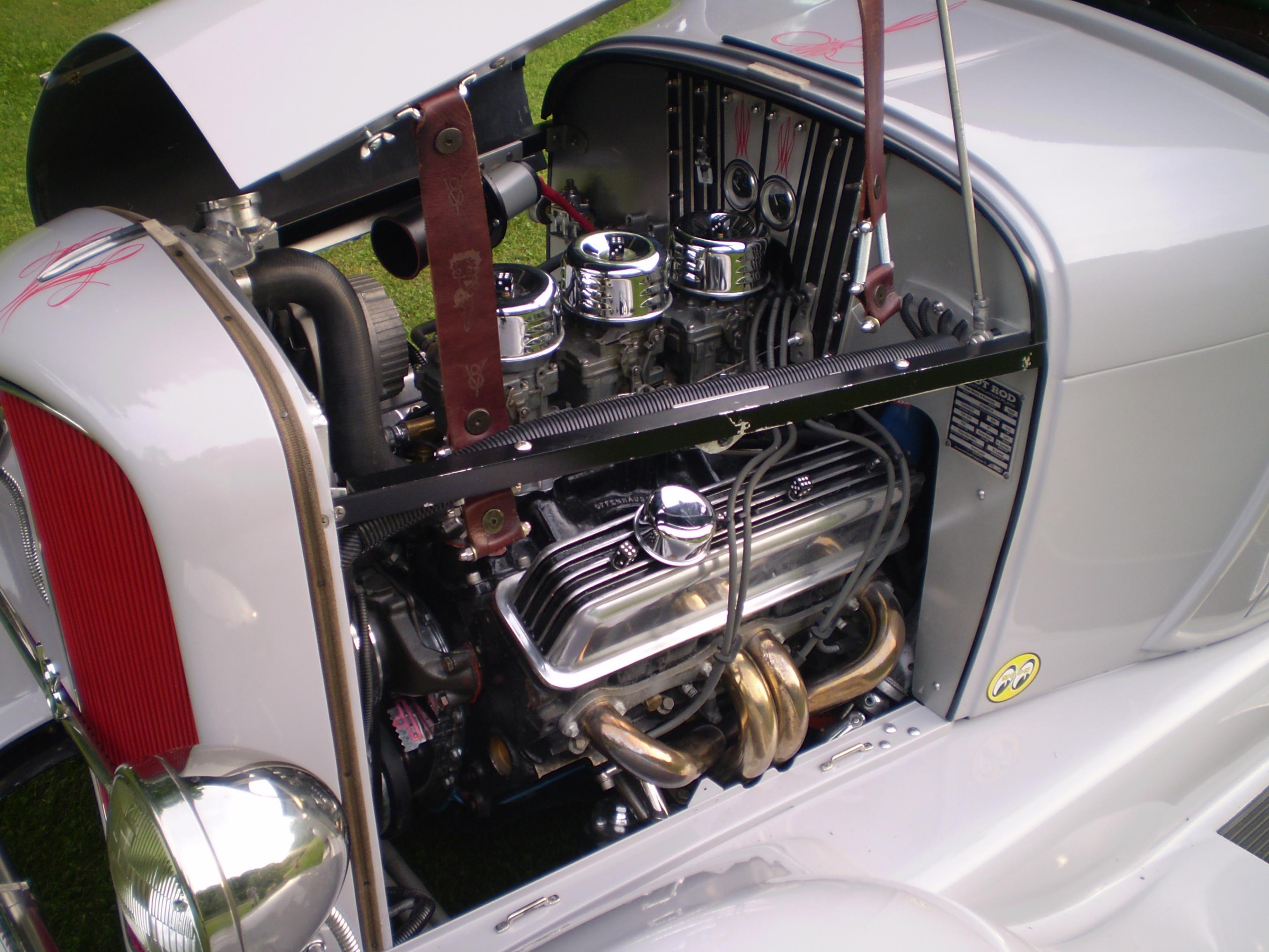

  11. Von Rigg Fink
    Joined: Jun 11, 2007
    Posts: 13,401
    Von Rigg Fink
    from Garage
    This is what I was taught too..
    Im not running anything but a stock SBC pump for my 3x2 2 jet Rochesters...I dont think they were ever regulated from the factory.
