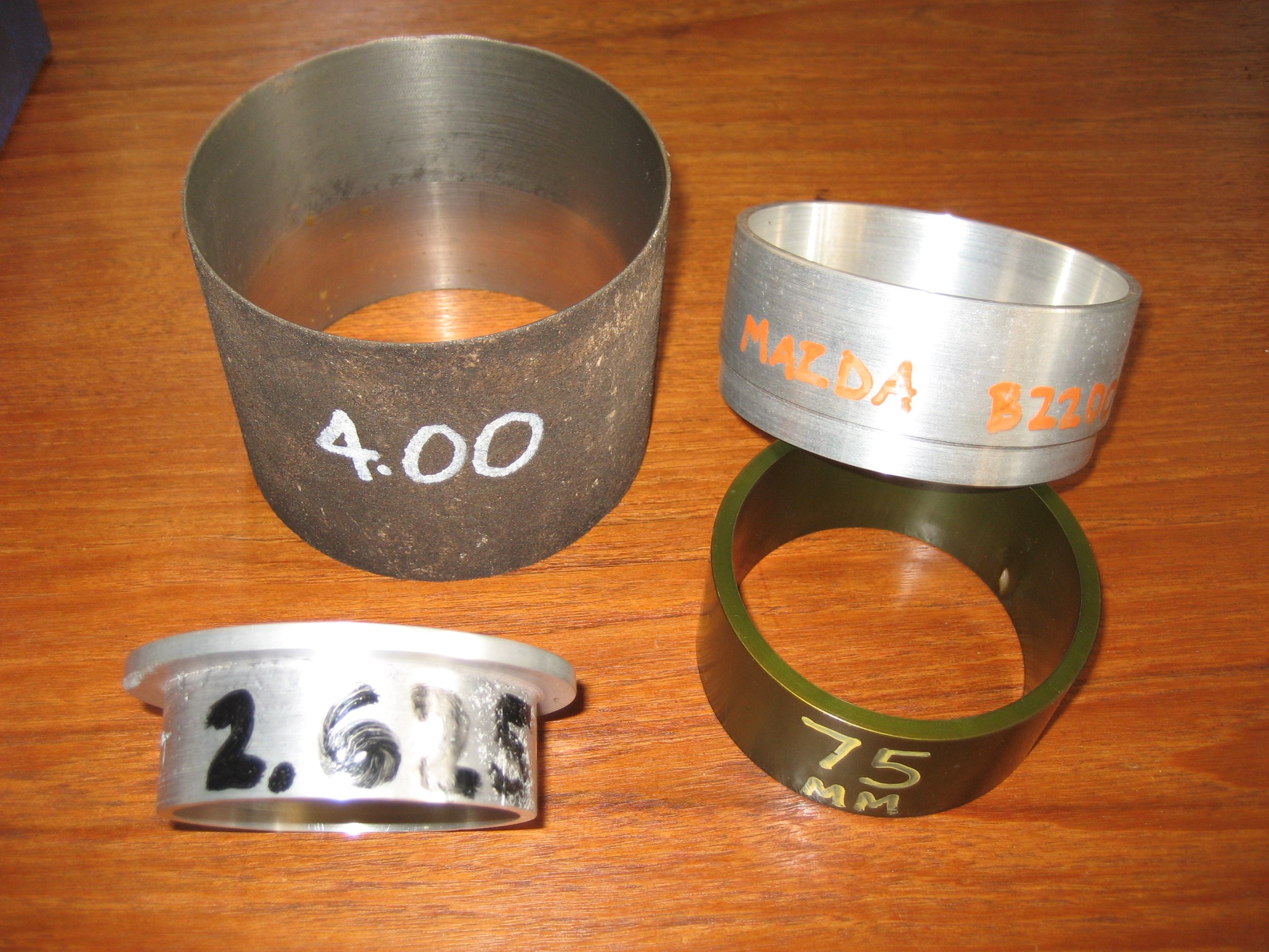

    For you guys with access to a lathe, they are a great thing to make. I made the first one a long time ago, when I didn't know how they should be done so it is way too tall (but works fine).
    Odd bits of aluminum sometimes serve as material, but my favourite is old cast iron sewer pipe, available wherever old houses are being torn down.
    Both the straight lengths and bells are handy.
    Wright & Sons likes this.

    Great idea! Now if only I knew how to cut an accurate taper on my lathe.

    For as short of a taper as you're going to need. For a ring compressor, just use the compound.

    That's what I do, and I adjust it so that the big end of the bore is a smidge bigger than the diameter of a relaxed, uninstalled piston ring.
    Regular compressors work, but sometimes are tricky for getting the three piece oil control rings in.
    Plus, it's really satisfying using the specific solid taper compressors.
    The biggest issue with making these things is to not distort the piece in the lathe chuck by over tightening, but not have it too loose so that it comes out while turning.:eek:
