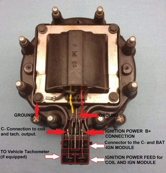

    The V6 HEI's were prone to burning thru the cap to the ground lead. Make sure the little metal snake and the black wire are attached properly and the ground lead is good.
    V8 shown but the same stuff.
    SS327 and porkshop like this.
