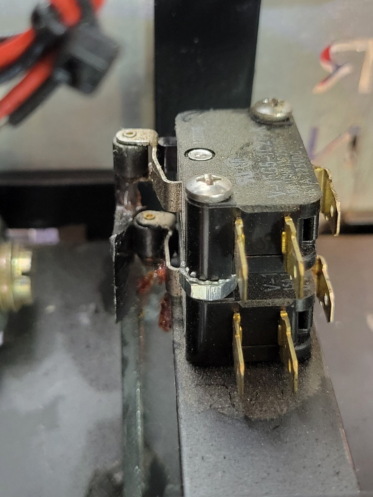

    What's that extra blade for ?
    The continuity switches blades depending on if the switch is open or closed.
    The switches are for reverse lights and the other is for neutral safety switch, which normally just have a 2 blade setup.
    Could the other blade be for turning a constant power off or something ?

  3. You have a 'common' terminal, a normally open terminal and a normally closed terminal. That is a SPDT (single pole, double throw) switch. If that were a Bosche relay, the common would be terminal 30, the NO would be 87, and the NC would be 87A.

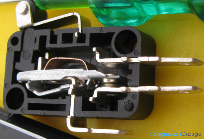

    Internals. Self explanatory.

    In the switch above, you should see markings as (on each terminal, from top to bottom)
    NO - Normally Open
    NC - Normally Closed
    C - Common
    Just like any other single pole, double throw switch

    I can leave the one side open without issues correct ?
    The common is the one on the side, the bottom right let's continuity through in the closed switch position which is what I need, so I have no use for bottom left since there's only 2 wires to hook up.

    yup, you can leave the unused terminal disconnected.
