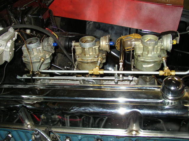

  5. Gotta ask....but why 3 carbs? I'm currently running 3 my 235 they are rocherster bc carbs, set it up with progressive linkage, runs great with the center, and there's a little more when i open it up, but i'm actually switching back to 2 carbs, ran better with just the 2 carbs, 3 are alittle over kill in my opinion, but it's a stock 235 with the exception of the fenton split....
    The last pic was what i had on it, seemed a lot more powerful, but i had issues with the carter W1's, and got pissed and put the offy 3x1 on. 3-4 years later and different carbs on the ellis intake and that will be back on the car sometime in nov.
    What are you working on car/truck? on my 54, i had to do some heavy modification to the rib on the firewall to fit the back carb in and then had to move some wiring so the carb didn't hit it.....now i'll be pissed when the 3 carbs are off and i have a screwed up firewall from them....
