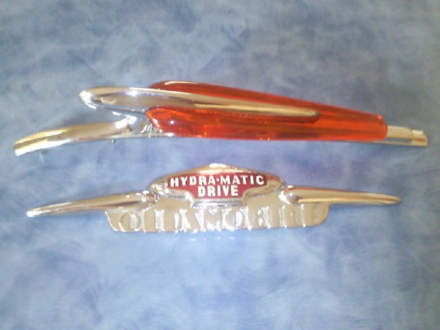

    Plenty of videos on YouTube, I had a lucite hood emblem reproduced down here by a local from the weather beaten OEM one. Some fine wet sanding and it was good to take a mold from. Had a few made in OEM colours; amber, black, blue, green and red. Grill trunk badge.jpg
