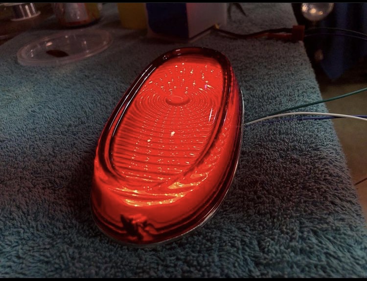

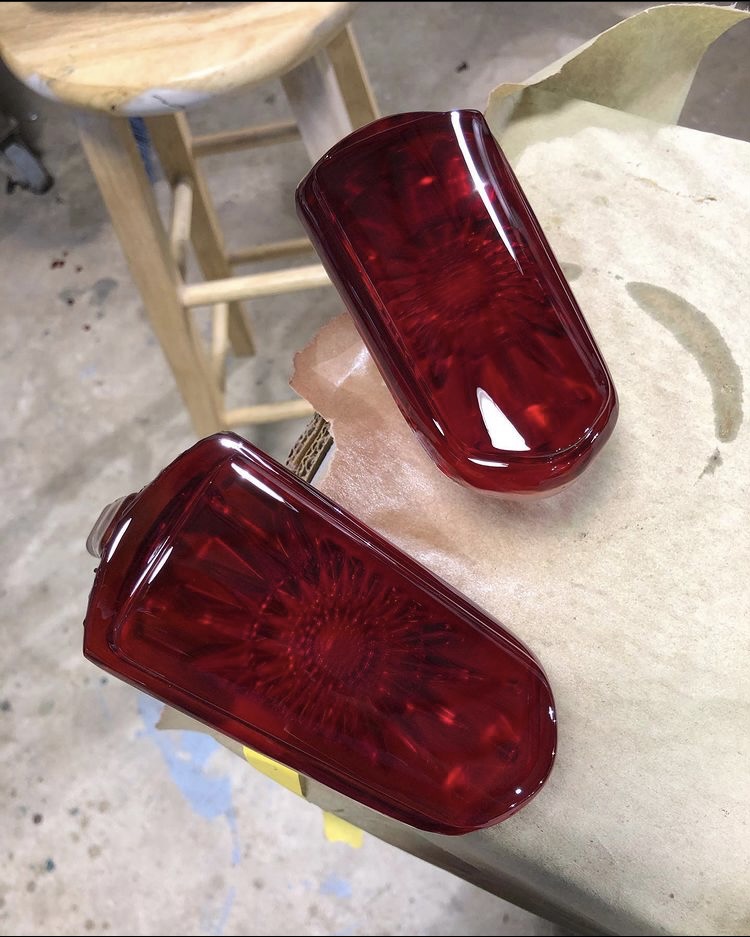

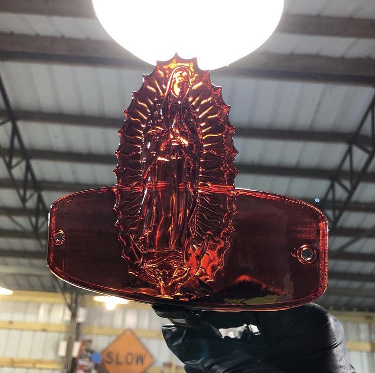

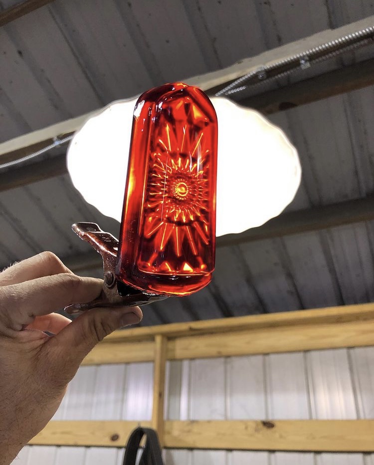

    A friend of mine makes 3D printed tail light lenses. I’m not sure what filament he uses, but he prints them in clear and then he sprays them in red candy. Here is some of his work.
    D810FFE5-0541-4EAE-B026-72C93D472BDD.jpeg DE87D32B-3DED-4E64-8787-A1FAB2147C4E.jpeg 43908239-ACFA-4AE1-B829-1661A5E570A9.jpeg 25162F6A-8B17-484B-9917-5FD5948670E3.jpeg D8F2B378-917B-4DE3-82F7-A02C11F87752.jpeg 4ADE0B28-D877-42F3-8395-D55985931114.jpeg

    Wow, those look great!
    Deuces likes this.

    Your buddy has talent. He could do a few at a time of those that are difficult to find.

    Those look good. I'm guessing he's not using a machine that melts layers of filament together though.
    Inexpensive FDM printers that use spools of material are not creating parts that look like that.
