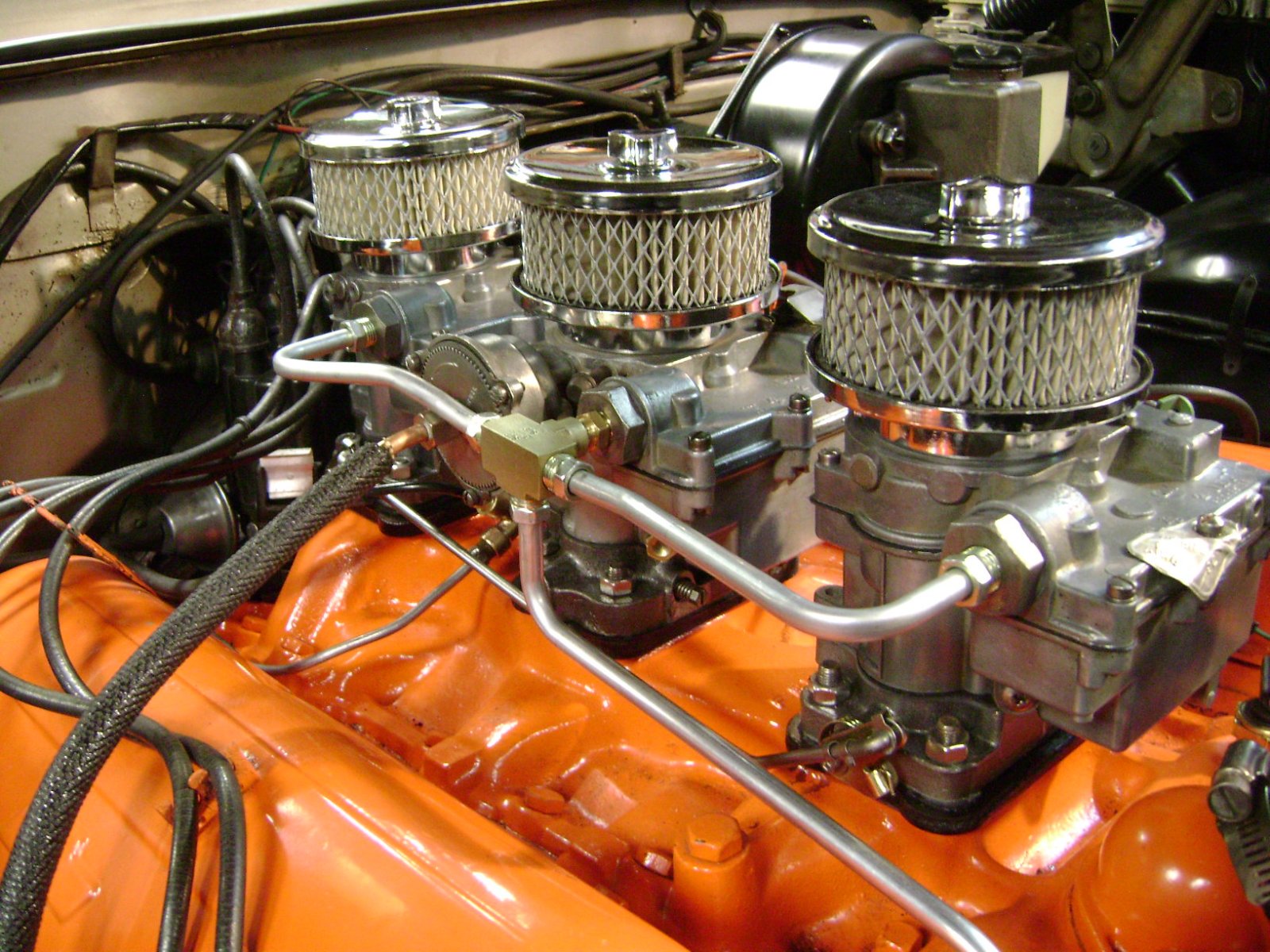

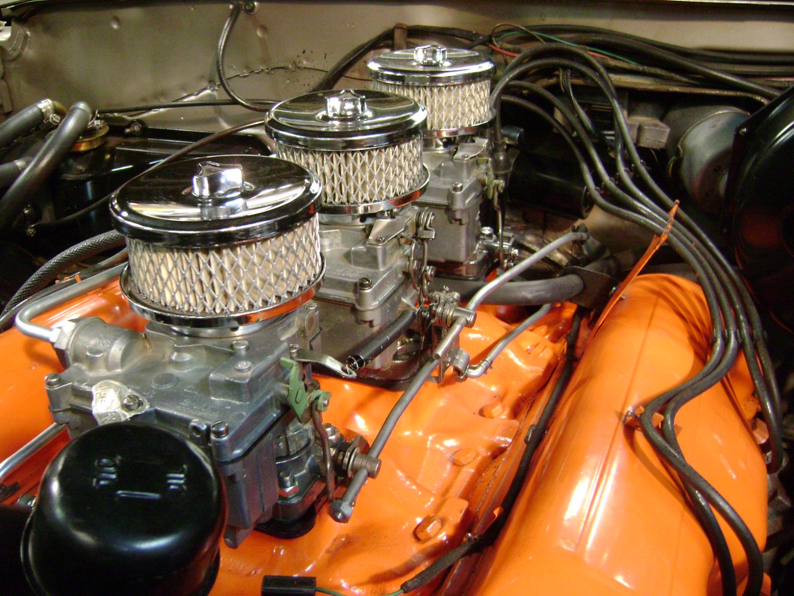

  15. BHRS
    Joined: Jun 20, 2009
    Posts: 56
    BHRS
    from Texas
    If you need help setting up your Rochesters for tri-power let me know. If they are not original tri-power carbs there are specific modifications and parts needed to convert them to work properly.
    The pic is a converted set I finished last week.

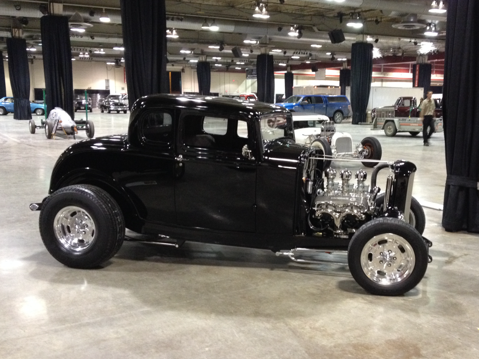

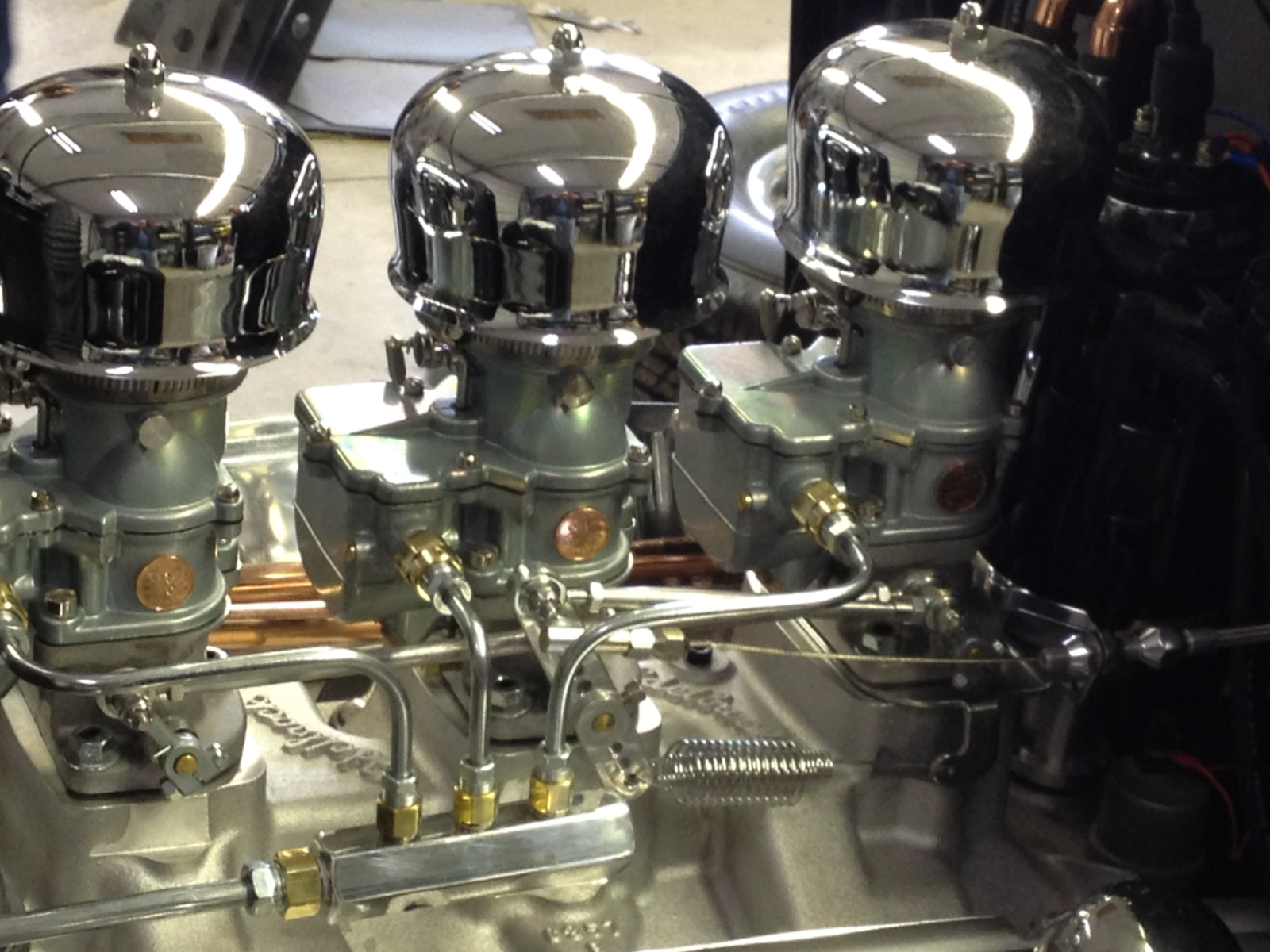

  16. RockyMtnWay
    Joined: Jan 6, 2015
    Posts: 757
    RockyMtnWay
    Tried the speedway kit ten years ago and although it worked fine at lower to mid rpm, it fell on its face at higher rpm so I traded it off for some 32 ford parts to a buddy that is still running it on his A RPU.
    The pennies are from the years my 3 kids were born.
    caprockfabshop, rod1 and deathrowdave like this.

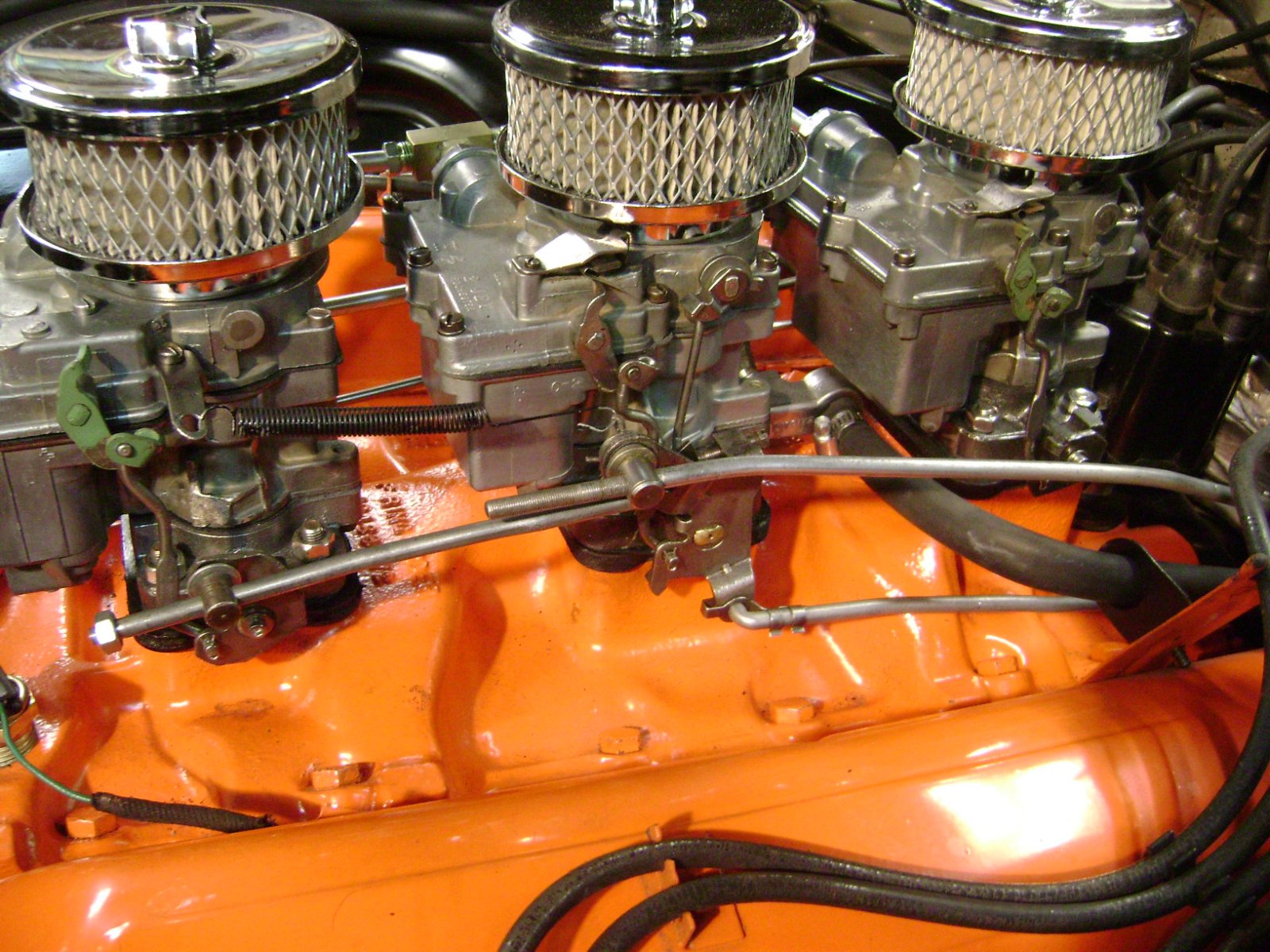

  19. RDR
    Joined: May 30, 2009
    Posts: 1,562
    RDR
    bought a 348 Chevy tri power manifold and carbs,,,,
    installed the Rochesters on a 350 SBC Offenhauser manifold
    Enjoyed that WAY more than any 4 bbl I had been running

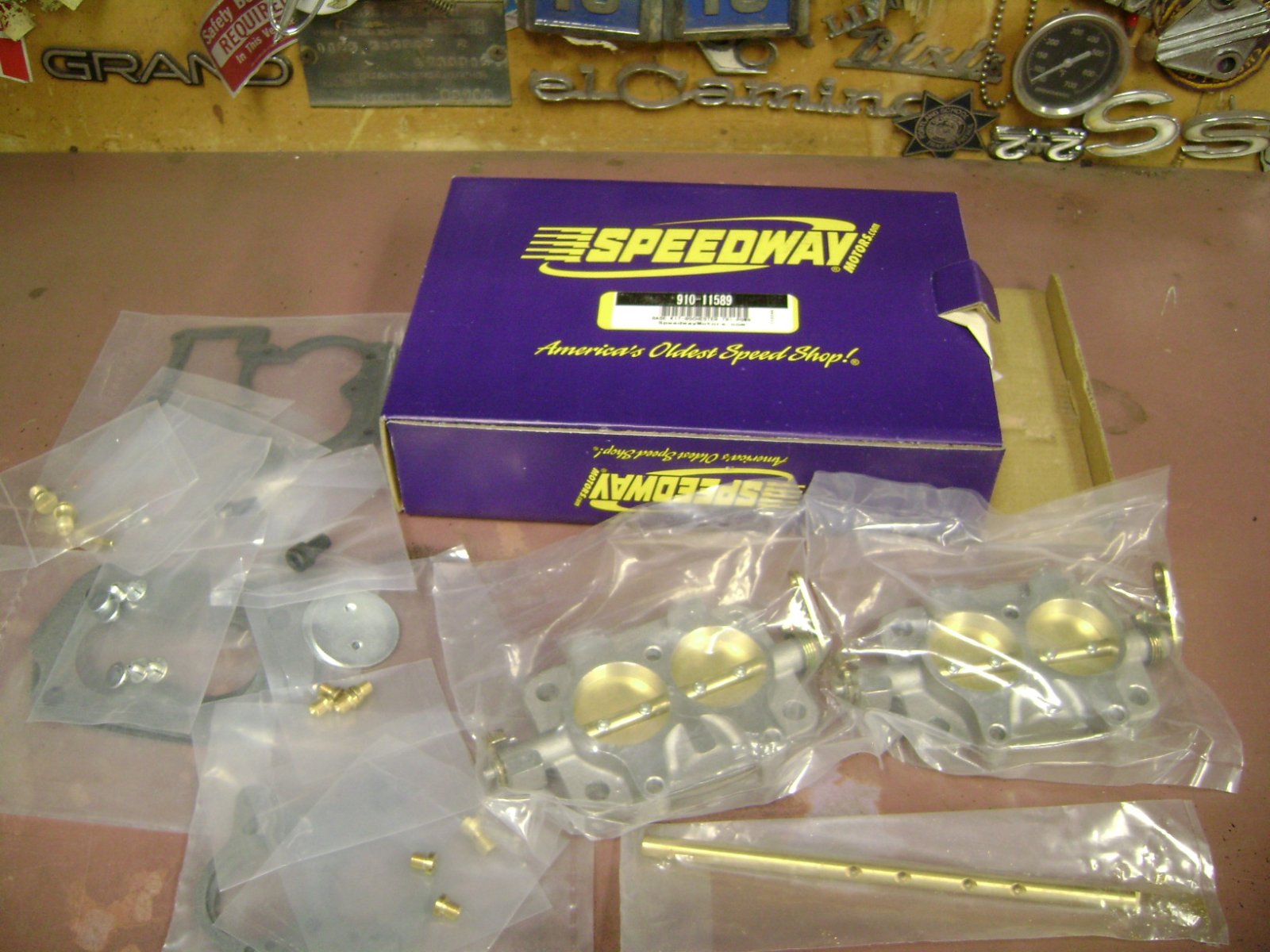

  20. LowKat
    Joined: Nov 29, 2005
    Posts: 10,017
    LowKat
    If you use Rochester cores (non-tripower) I'd suggest using this $350 kit from Speedway to make the carbs work correctly. The thick ****erfly blades in their bases are like original 3x2 so easy to seal. Has the long throttle blade shaft for the center carb. They also have the same kit w/linkage for another $100. I used a combo of linkage I had and made my own. Ended up buying the rod that connects the front and back carbs on the p***enger side from Show-Cars.com as it made hooking up the stock kickdown for the trans easier. Installed on my 348 Impala and it worked great.
    Universal Rochester 2-Jet 2G Tri-Power 3x2 Carb Kit w/o Linkage (speedwaymotors.com)

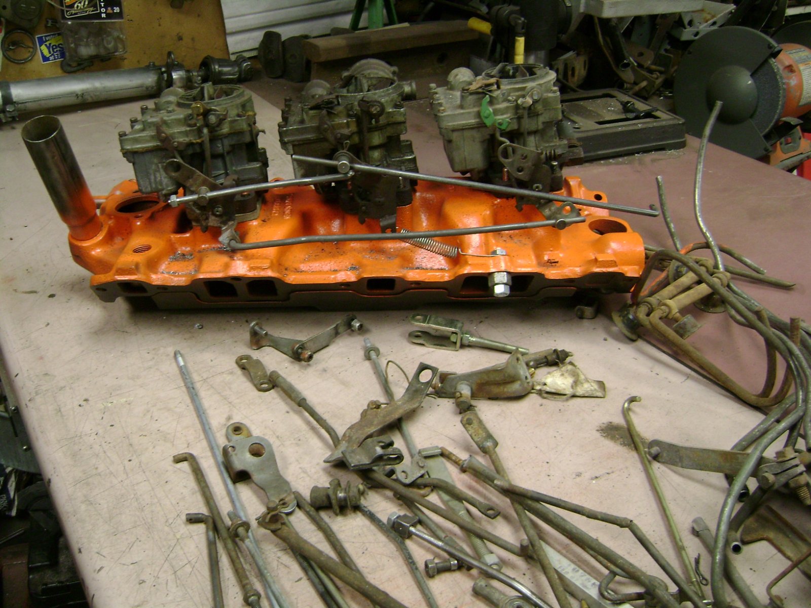

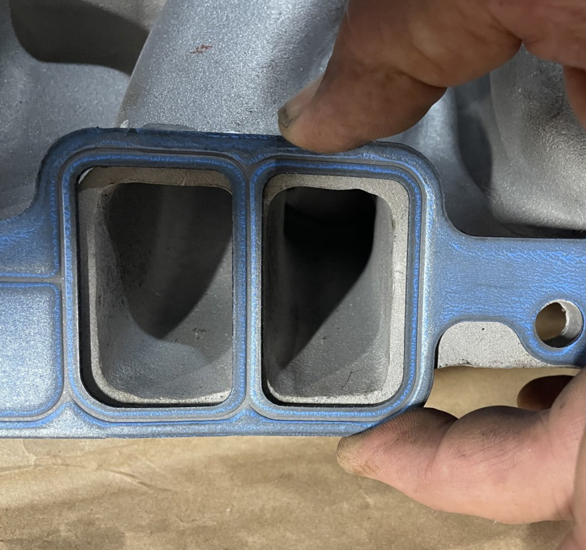

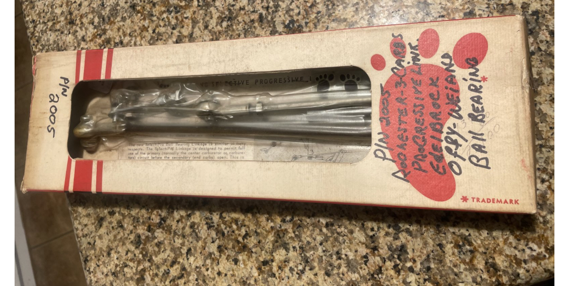

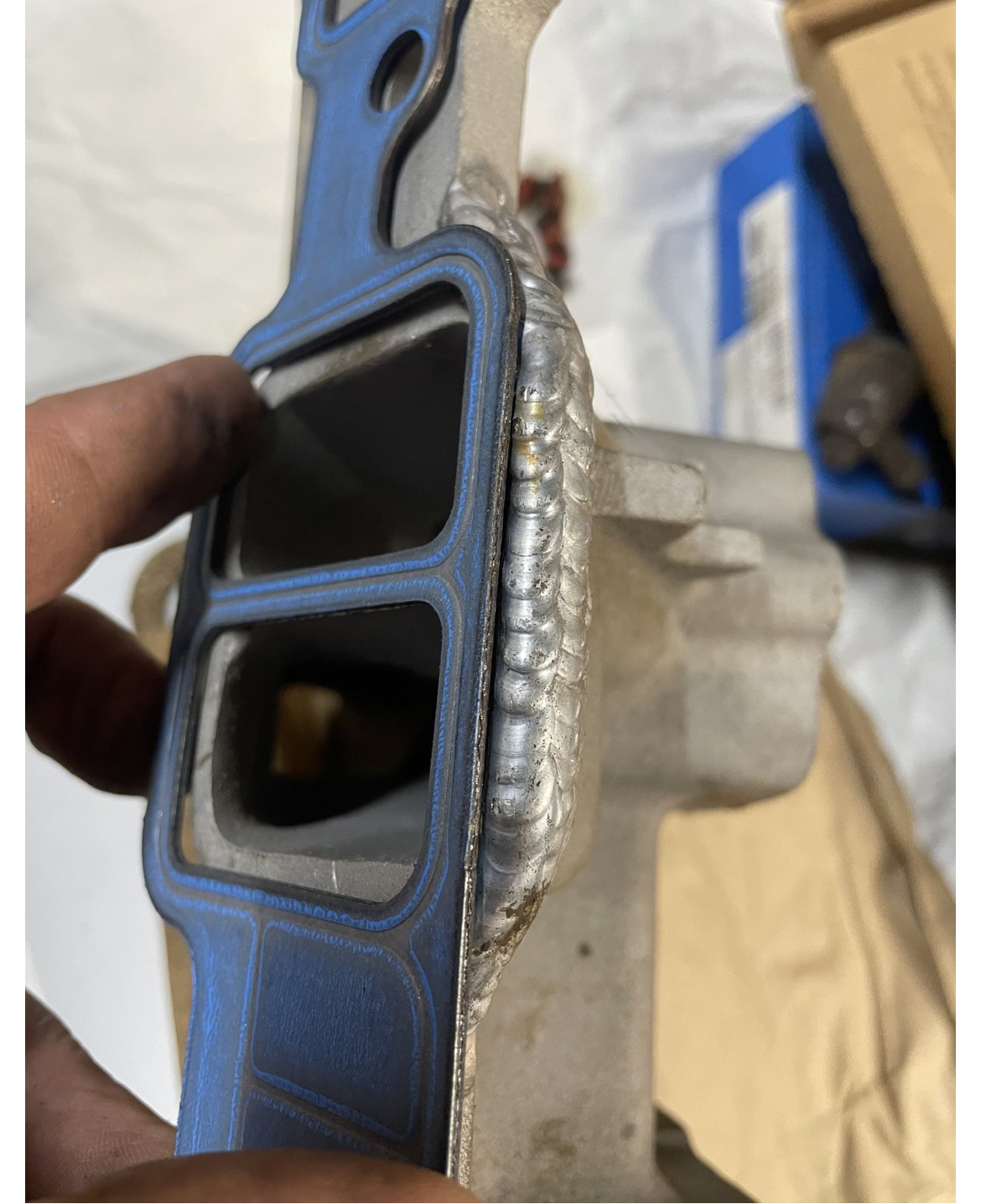

    building up the ports to work with the gaskets.
    Could of sold it but I think I got $50 in it.
    Picked up aNOS lincage set up recently
    427 sleeper and swade41 like this.

  28. Plan to blast the visible weld after grinding so it blends in
    Fingers crossed
    427 sleeper likes this.
  29. michaelvz51
    Joined: May 24, 2011
    Posts: 876
    michaelvz51
    from So Cal
    It will blend in and be camouflaged fine
    anthony myrick likes this.
  30. I’m sure it costs a couple HP with the older intake
    But I’m good. My 283 isn’t concerned
