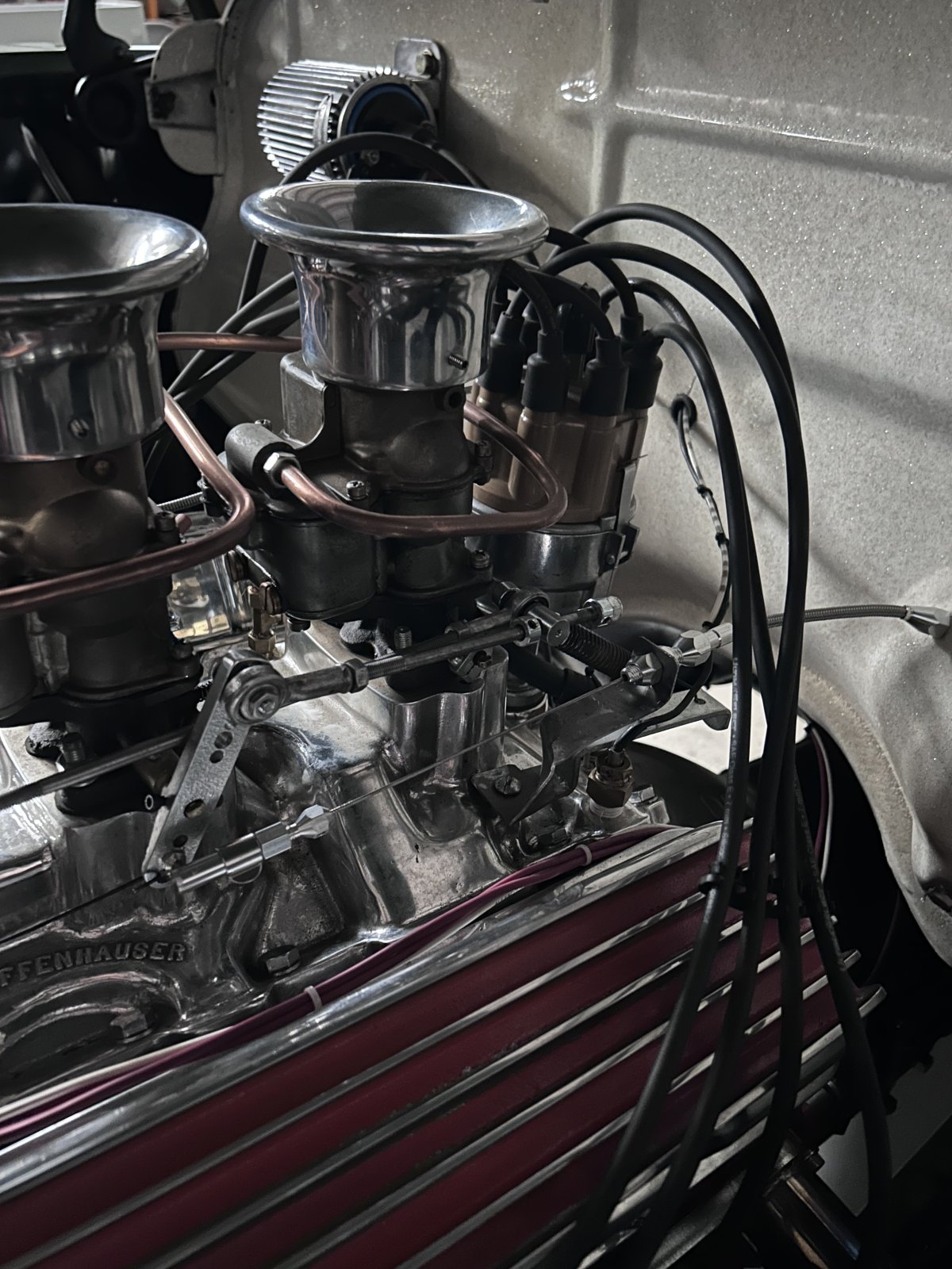

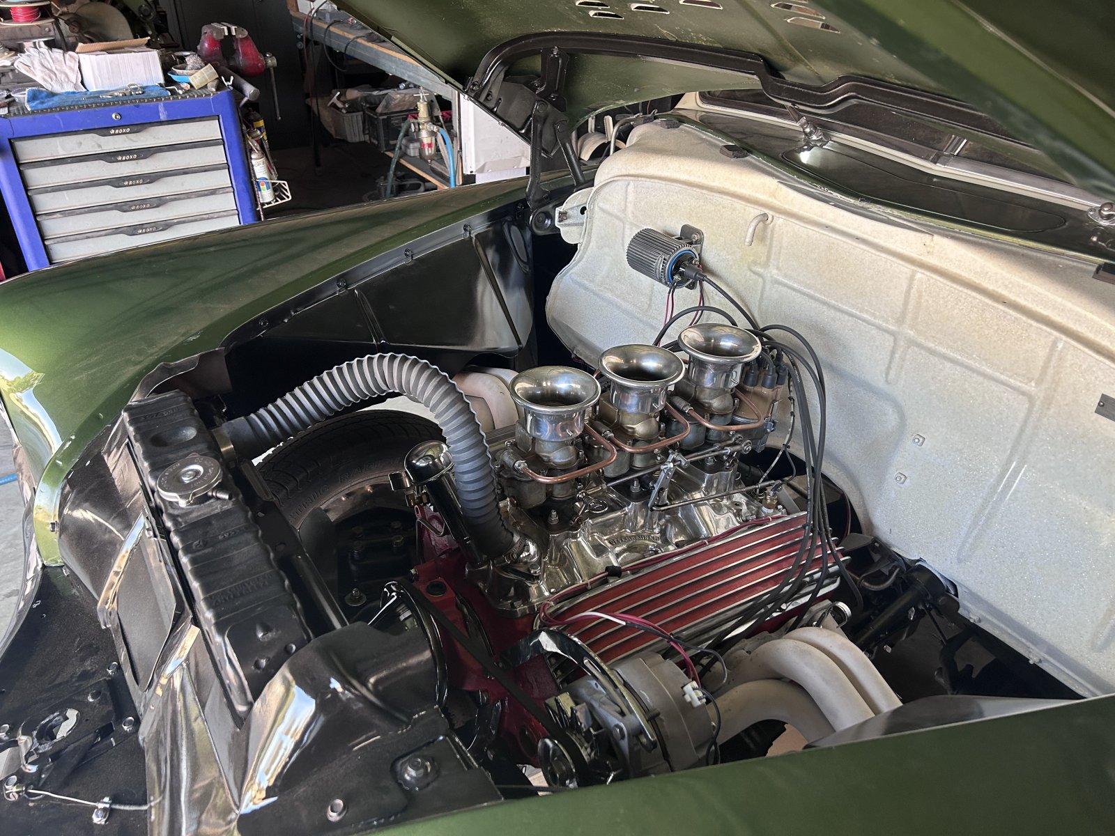

    Let me start by saying I have read more threads here and everywhere else on running an SBC with 3 94's, probably way to much for my "simple" issue:
    engine: 327 L79 clone. 11:1, Crower Street beast hydraulic cam (L79 specs), camel humps with 2.02's,
    Old School Accel dual point. Offenhauser manifold, rebuilt 94 style 2100 carbs, progressive linkage.(about 60/40), red Holley electric pump regulated at 3.5#'s at the carbs. ( all used parts )
    Rebuilt TH400 2300 stall.
    a minute or 2 after I hit 3rd gear it just sputters like its running out of gas ?? I try to feather it but it finally just dies. Pull over, turn it off, turn it on and it fires right up. if I light foot it home is does the same thing.
    My gut tells me the red pump is shutting off. Could I be running out of gas on the center carb?
    old and confused
