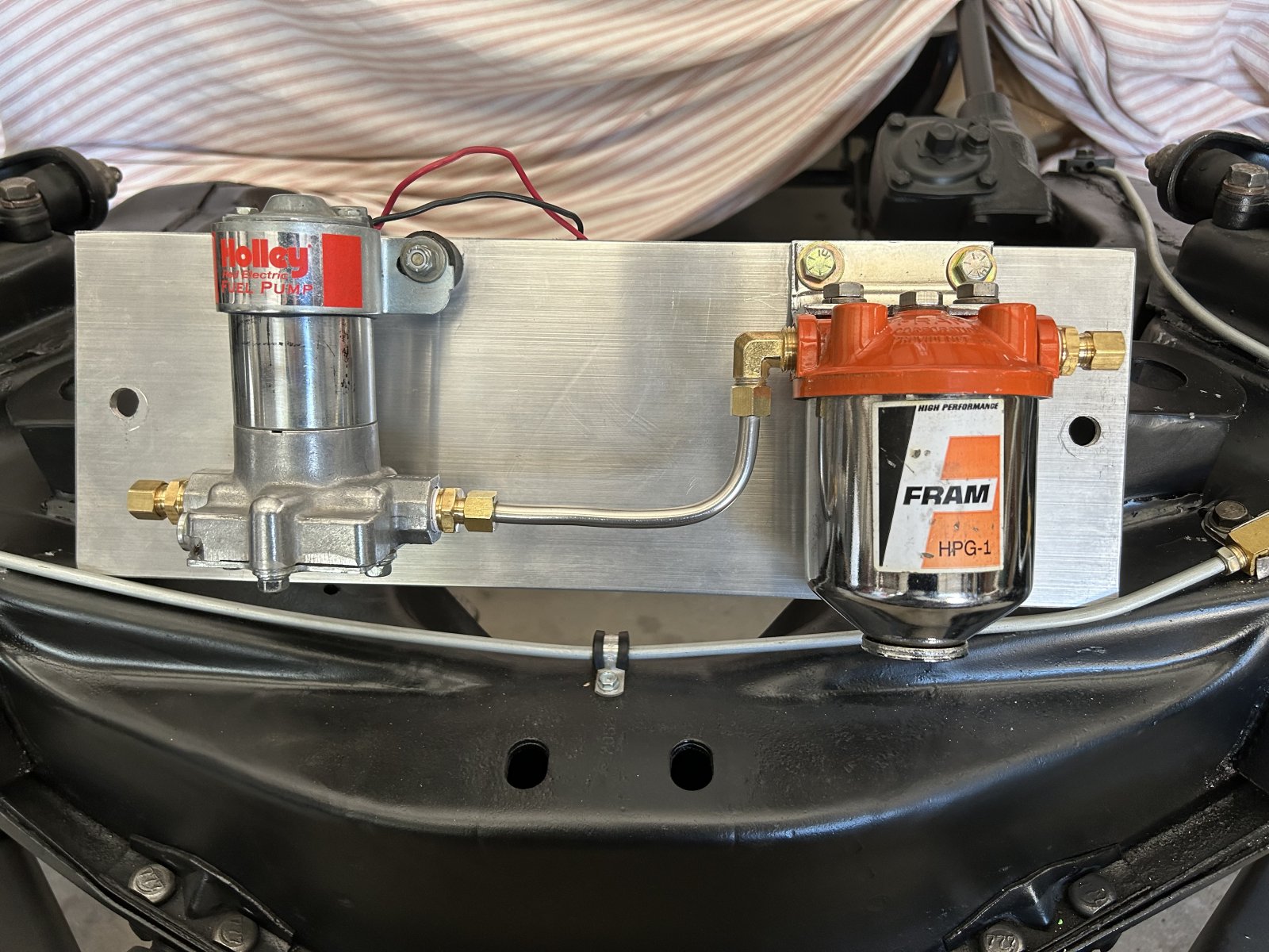

    Thanks. The lines are all 5/16 and new. I followed the factory bends from tank to engine. But I did put a pretty good bend in it between pump and filter. I will review that. I am doing my best to stay period correct but looks always get in the way

    That bend isn't your problem, it's got a much better radius than that 90* fitting going into the filter.

  26. I looked at your picture of the pump and filter canister and wasn't able to tell if the filter was going into the pump inlet. If that is the case then you don't want the filter element to be too fine before the pump, only 100 microns, then a finer filter after it. If the pre filter is too fine then the pump will struggle to draw fuel through it.
    This also sounds like an ignition coil starting to fail, stalls, starts again after sitting and revs great under no load.

    The old Fram style filter is installed after the pump, none before it (yet) :)
    I agree with the coil, its an old one that I had. Doing fuel volume test first then going straight to the coil....
