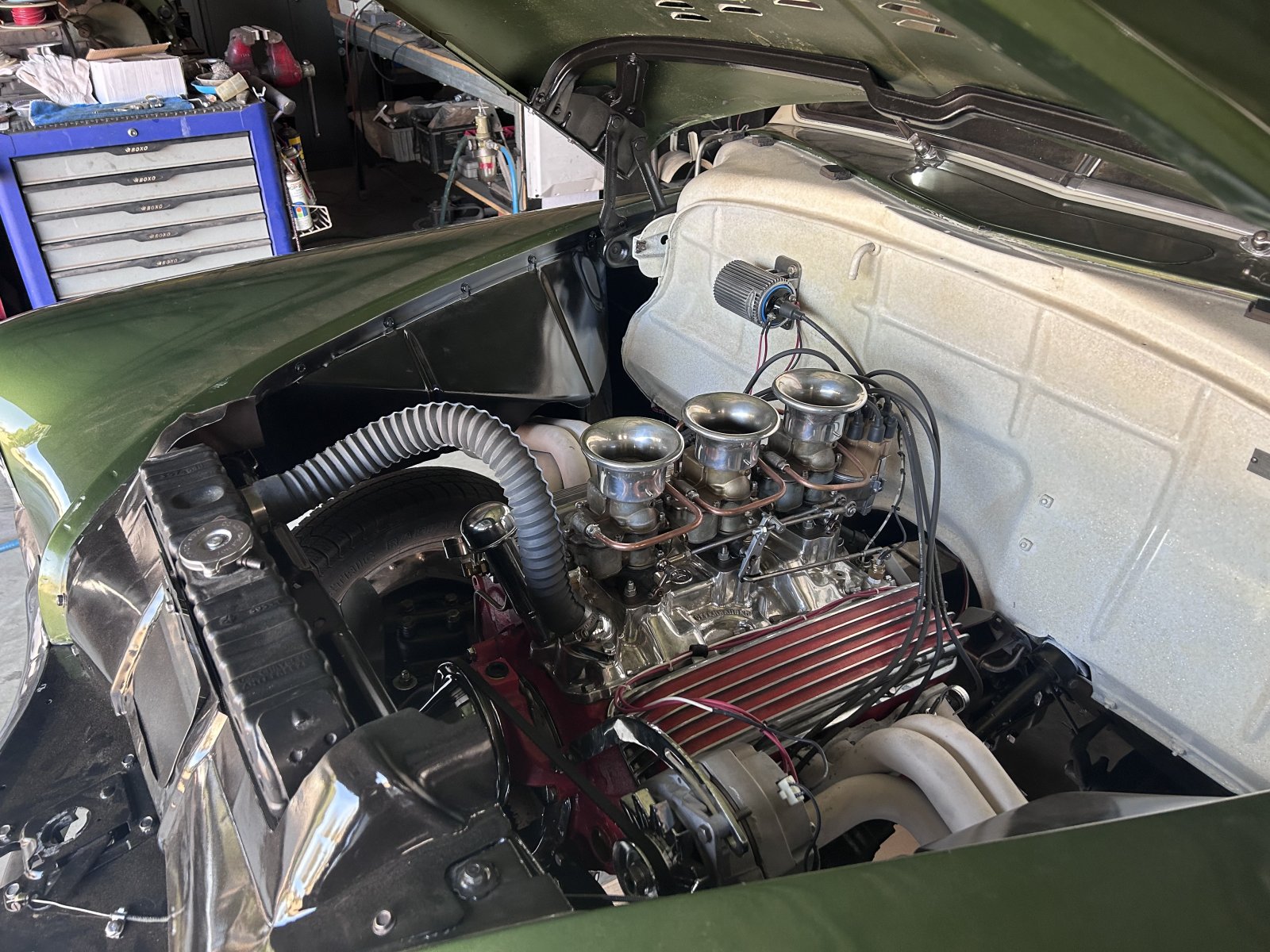

    UPDATE: Well I did not have much time in the shop this weekend but here is what I have done and found out:
    I wanted to eliminate the coil situation and since mine is mounted sideways, I replaced it with a PerTronix 3.0 Flame thrower that is epoxy filled. My old Bosch Blue failed the secondary winding tests. Started much faster and idles smoother also. BUT on the test drive it did the same thing. (sputtered) But I noticed it was almost at the same spot!
    ELECTRONIC ISSUE ? NO.
    Limped it home, let it idle a minute, turned it off, restarted immediately, let it idle and killed it.

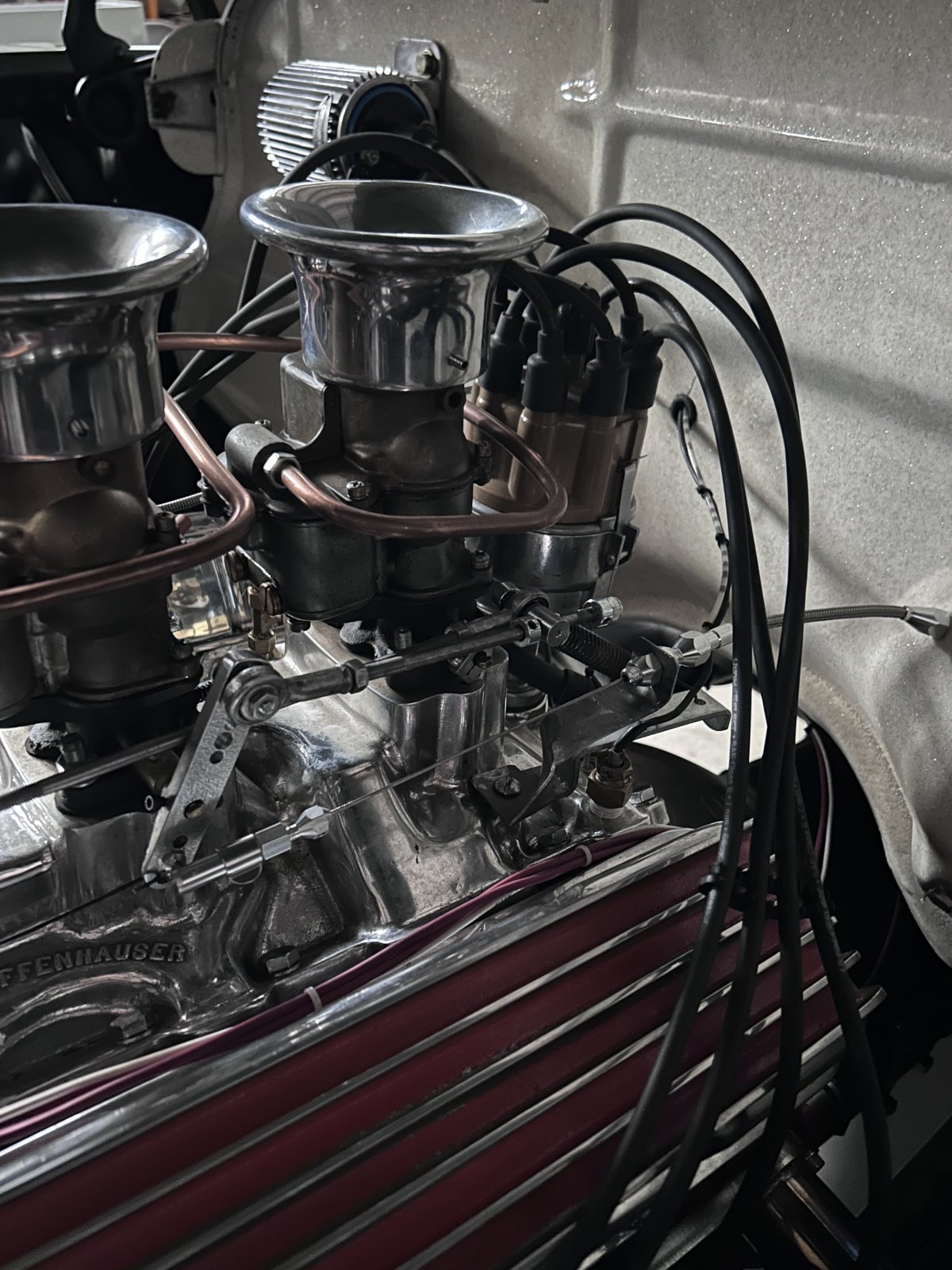

    I pulled the top of the center (primary) carb and noticed it had only an inch of gas in it.
    Checked the float level and needle/seat, all good. BUT the drop measurement was way off, way to low.
    I never even checked that. Well after setting that to specs, ( a major adjustment) I went for a drive and guess what?? NO Sputter. Unfortunately I sounds like a rocker loosened up so I just took it home.
    Now I am no carb guru and would love some explanation on whether this really could have been the issue??

  13. 427 sleeper
    Joined: Mar 8, 2017
    Posts: 3,367
    427 sleeper
    Float drop is just as, if not more critical than float level. Glad you got to the bottom of it. :cool: Drop turns the fuel on and the float level turns it off.

  18. chiro
    Joined: Jun 23, 2008
    Posts: 1,310
    chiro
    Float drop on a 94? When setting the float level on a 94 top:
    Remember that the slightest drop of the float will open the needle valve and allow fuel to enter the bowl. The amount of fuel in the bowl will be dictated by the size of the float according to the specification measurement for the float shut off of the needle valve. You set the float to shut OFF the fuel on a 94 so the bowl doesn't fill too much. An inch of fuel in a 94 bowl sounds just about right. That's what has always been in the bowls of my 94's when I have taken the tops off. Admittedly, setting the float levels on a 94 is a PIA. I've always done it with the top clamped right side up on the edge of a thin shelf with the float hanging off the edge to check for the proper measurement as dictated in the rebuild kit instructions. I like my 94's. They run great, are easy to rebuild with just a screwdriver, and are cheaper to buy than Strombergs. I don't think float drop is your issue. However, also check that your floats aren't leaking and are full of fuel. The only problem I've had with my 94's is that the needles USED TO STICK and not shut off due to ethanol in fuel (and the absence of lead in fuel) which would flood the bowls. Solved that by adding Lucas fuel system lubricant and Startron anti-ethanol additive to the fuel. The bonus of the "Lucas upper cylinder lubricant" is that it also acts as a lead replacement (see that on their website because it's not specified on the bottle).
    Bring tools with you next time out. The SECOND the problem comes up pull over, shut down and pop the tops off the carbs. That will tell the tale if you don't have enough fuel in the bowls. Compare the amount of fuel then with how much fuel is in the bowls in your garage when car was running fine at idle.
